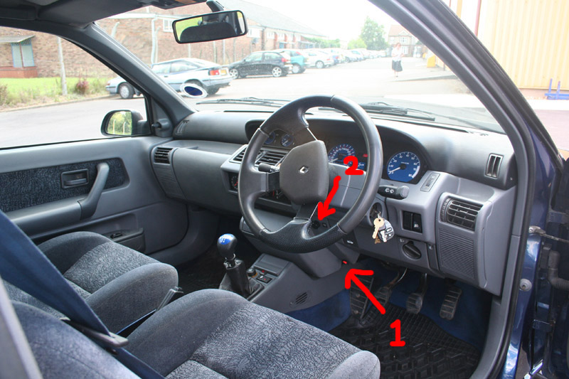

for those interested in how it works;
1. Turns it on/off
2. Dry/Wet Setting, bout 12-15 clicks between each so u can adjust how much it intervenes.
Even in the pouring rain, on full wet setting you can just floor in and it pulls nicely with no spin.
