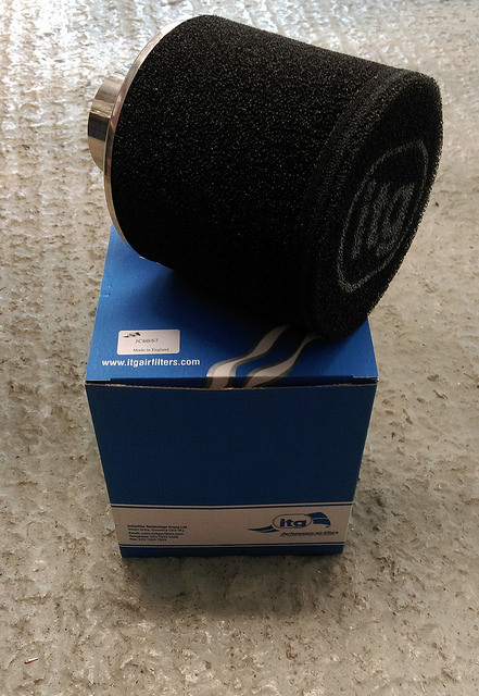

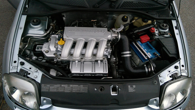

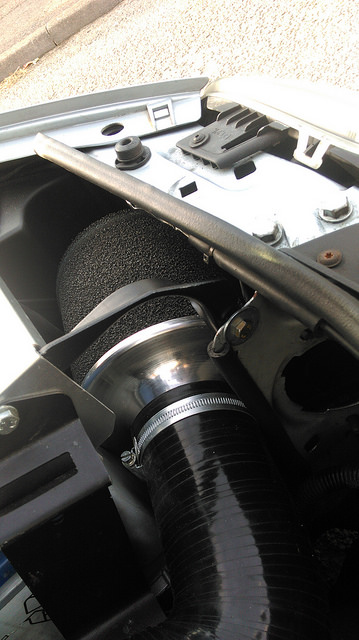

I bought the ash pipes but didnt want the brand showing so i twisted it so it was plain black and kinda OEM looking.
Breakdown of the kit:
Breather filter: http://www.ebay.co.uk/itm/300685158785?_trksid=p2057872.m2749.l2649&ssPageName=STRK:MEBIDX:IT
90 Degree bends x2: http://www.ebay.co.uk/itm/310793012250?_trksid=p2057872.m2749.l2649&var=610218955014&ssPageName=STRK:MEBIDX:IT
Ally joiner: http://www.ebay.co.uk/itm/321660872627?_trksid=p2057872.m2749.l2649&ssPageName=STRK:MEBIDX:IT
ITG filter: http://www.camskill.co.uk/m35b51s3496p63333/_ITG_-_Maxogen_Air_Filter_-_JC60_67_

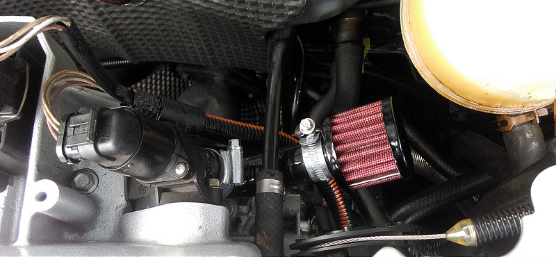

I had the jubilee clips at work so i didnt buy any of them. I had some pipe also for the breather filter.
That's just under £80. You'll be able to sell you ktec one for £120+ so there's a bit to pocket but not much. I also used masking tape to the end off one of the pipes as a guide and used a 4" angle grinder for a clean cut rather than a blade or saw. The throttle body end needs to be cut shorter and at slight angle for it all to fit.

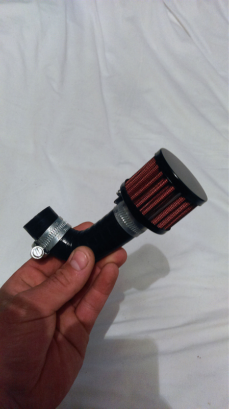

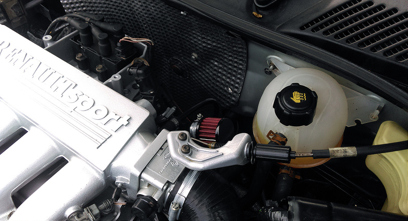

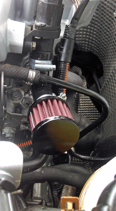

Pics of how the breather filter is:

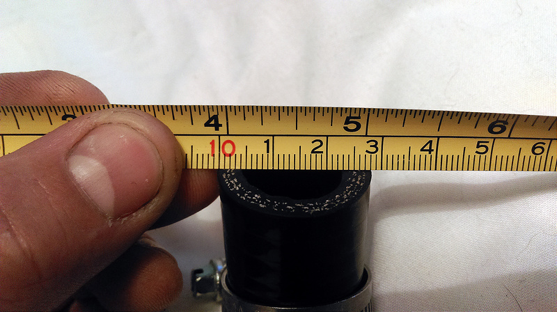

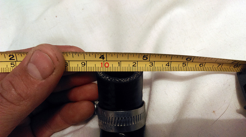

The pipe is 90 degrees and ID is 18mm, OD is 28mm. This will fit perfectly with the 15mm breather filter. You'll need a couple of jubilee clips and may need to cut the ends down on the bend for a subtle fit.

Hope that helps. I love it and it feels better than standard. Plus it's cleaner in the engine bay and removes the tight fit ph1 airbox.
