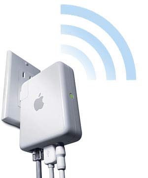

I would get an Airport Express, rip losslessly, output digitally into a DAC.
FTW
  Black S2 106 Rallye LHD
Using two laptops is overkill and it's potentially worse-sounding because a) the digital to analogue conversion at the point of the headphone socket will be poor and b) if you're using Windows XP then the Kmixer will be resampling the audio.
An Airport Express is a little gadget that receives music over WiFi and outputs it into via mini Toslink or via a little headphone socket.
The output was tested by Stereophile magazine and said to be "bit perfect":
http://www.stereophile.com/digitalprocessors/505apple/
