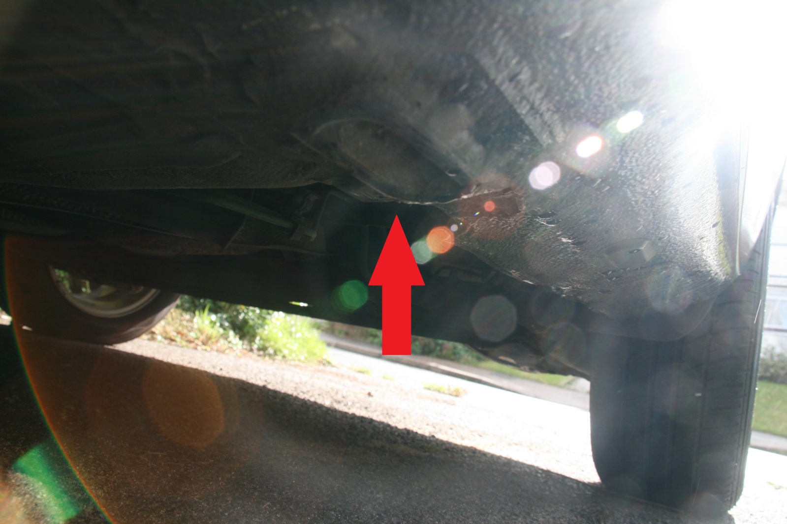

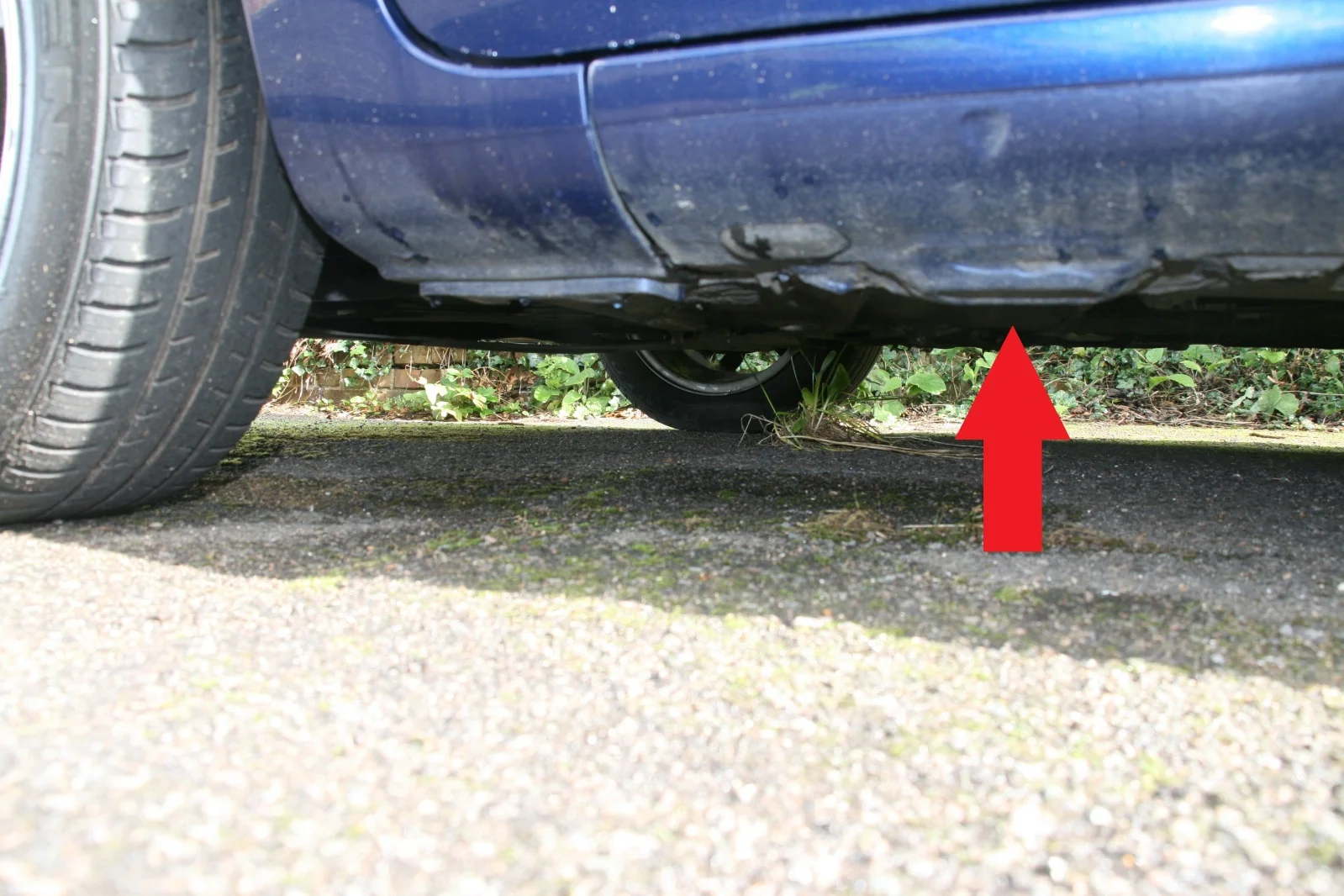

I think I know how to go about jacking the car up? First gear and the handbrake on, then the jacking points is my problem.
This is where I believe the jacking points are:

That's the jacking point. But please don't paint the calipers red. Go nice and clean with black

Thanks for that, i'm going to use a trolley jack to jack the car up, so as this doesn't have the shape the Renault one does, what shall I do to avoid damaging the car?
Put a block of wood over the jack, then place it like this over the jacking point:

No worries dude, I was like you, I didn't know how/where to jack up. Make sure to get a trolley jack too and some axle stands. Would then jack up on the chassis rail as that's a really tough part of the car, the chassis. If you can't find it, just use your knuckles and knock under the car. You'll hear when you're on the stronger parts.
Got the trolley jack and the axle stands :) I just tried jacking the car up and it went well, felt quite sturdy. Where would you put the axle stands? If i'm jacking up with the jack point on the car pictured above?
