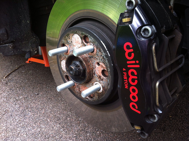

This kit uses 295 x 26 discs and standards are 280, done some digging and it looks like they are modified from Toyota discs but I'm seeing bad reviews on the discs. Don't know if Jam-sport are still using that modified disc or not but it seems the centre bore is oversized on them at 62mm which doesn't sound ideal.

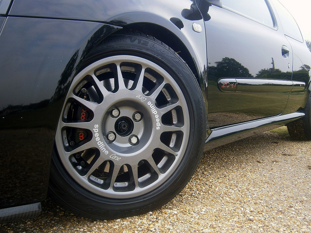

I bought the Ktec kit mate I also looked at jam sport kit but the disc but me off cause I wasn't sure if they fitted with the ozf1, the Ktec kit is really good I have turini's on atm and there's lots of space so could run 2118 I'm positive with out any spacers

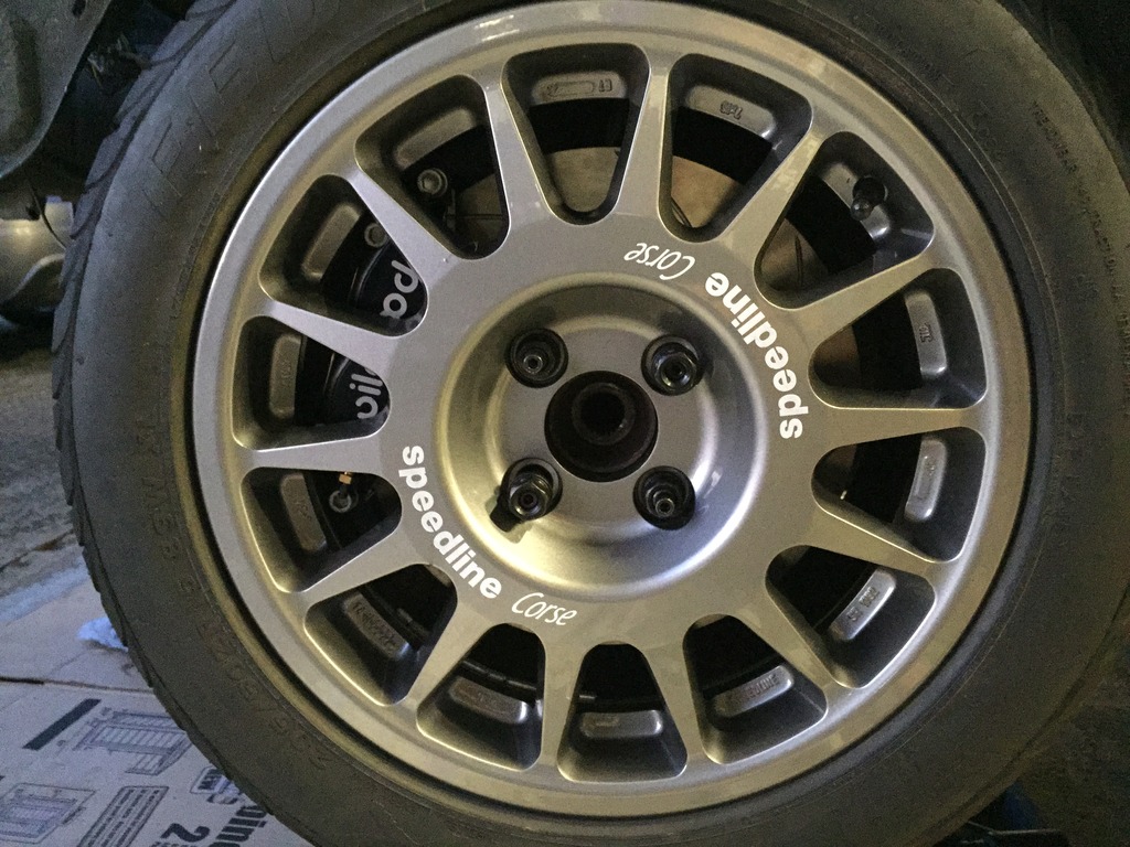

They fit perfectly under 2118 as I'm running them.
Just reading the description, it says it's a Padig disc and I believe they order bits from EuroCarParts, so once you've got the kit it'll have a part number on the box or stamped into the disc. Then yourll be able to order them from else where I guess.

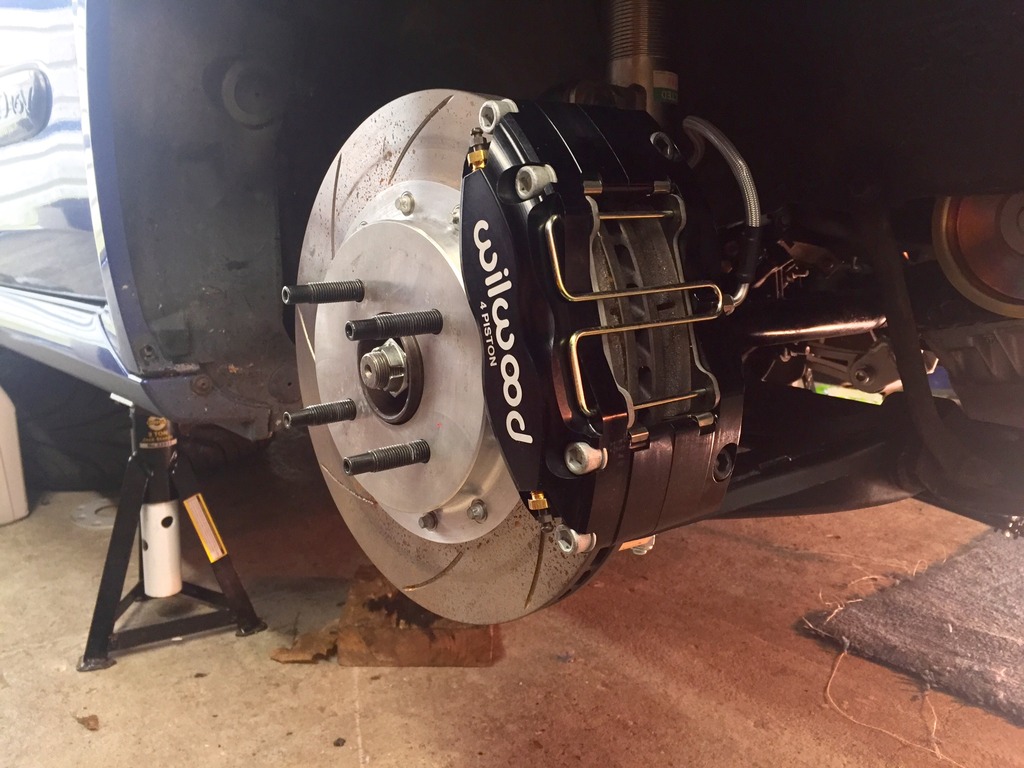

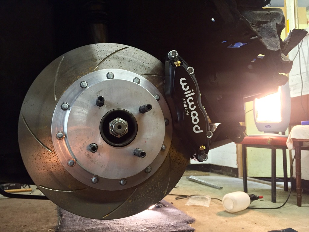

I've just fitted the Compbrake 4 pots and again like the OP seems discs are limited at 295mm x 24mm (8 stud) . Pads are fine and are the same as the Wilwood dynalites.

No mate, but TBH I didn't really look very hard for alternative discs/ set up.

You'd still need to get the centre bore and PCD altered as they're not a direct fit.
