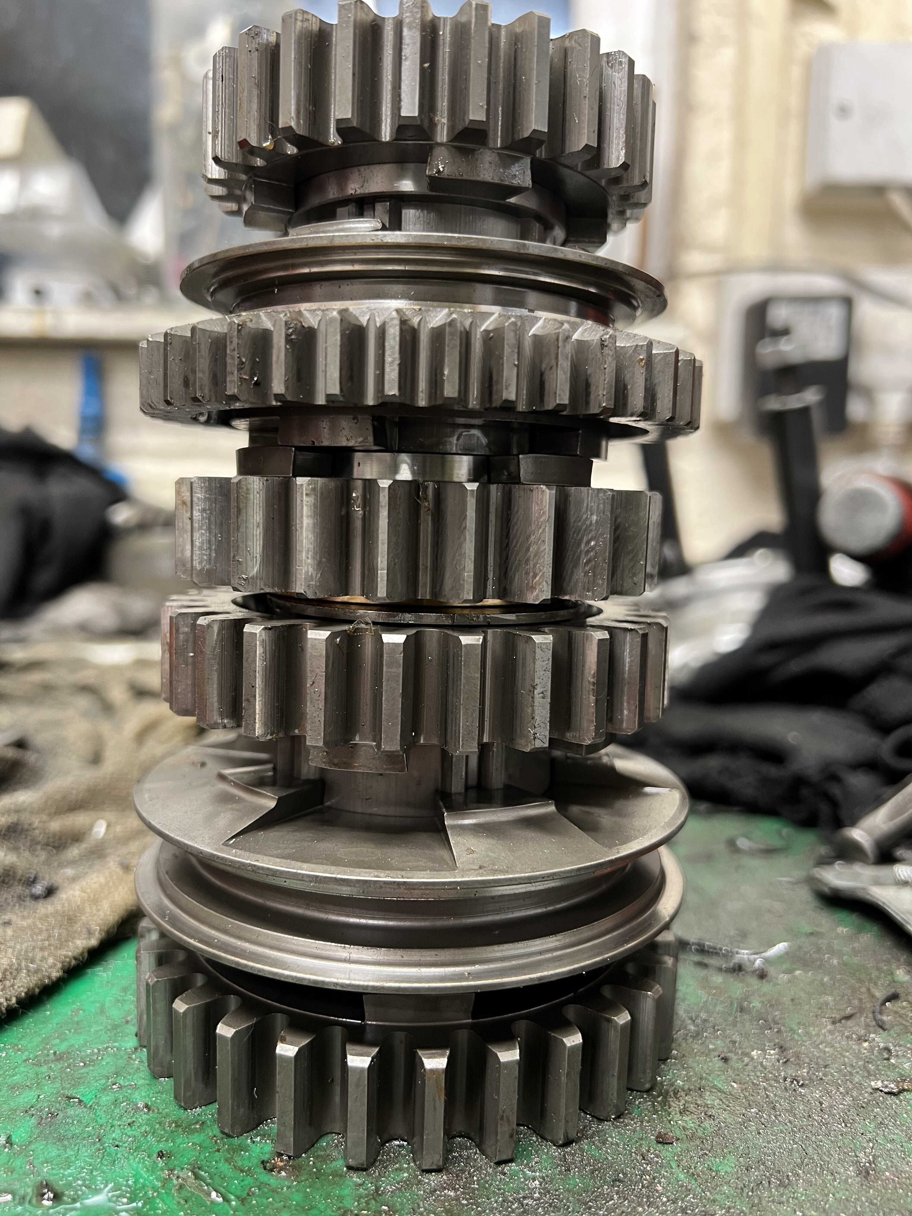

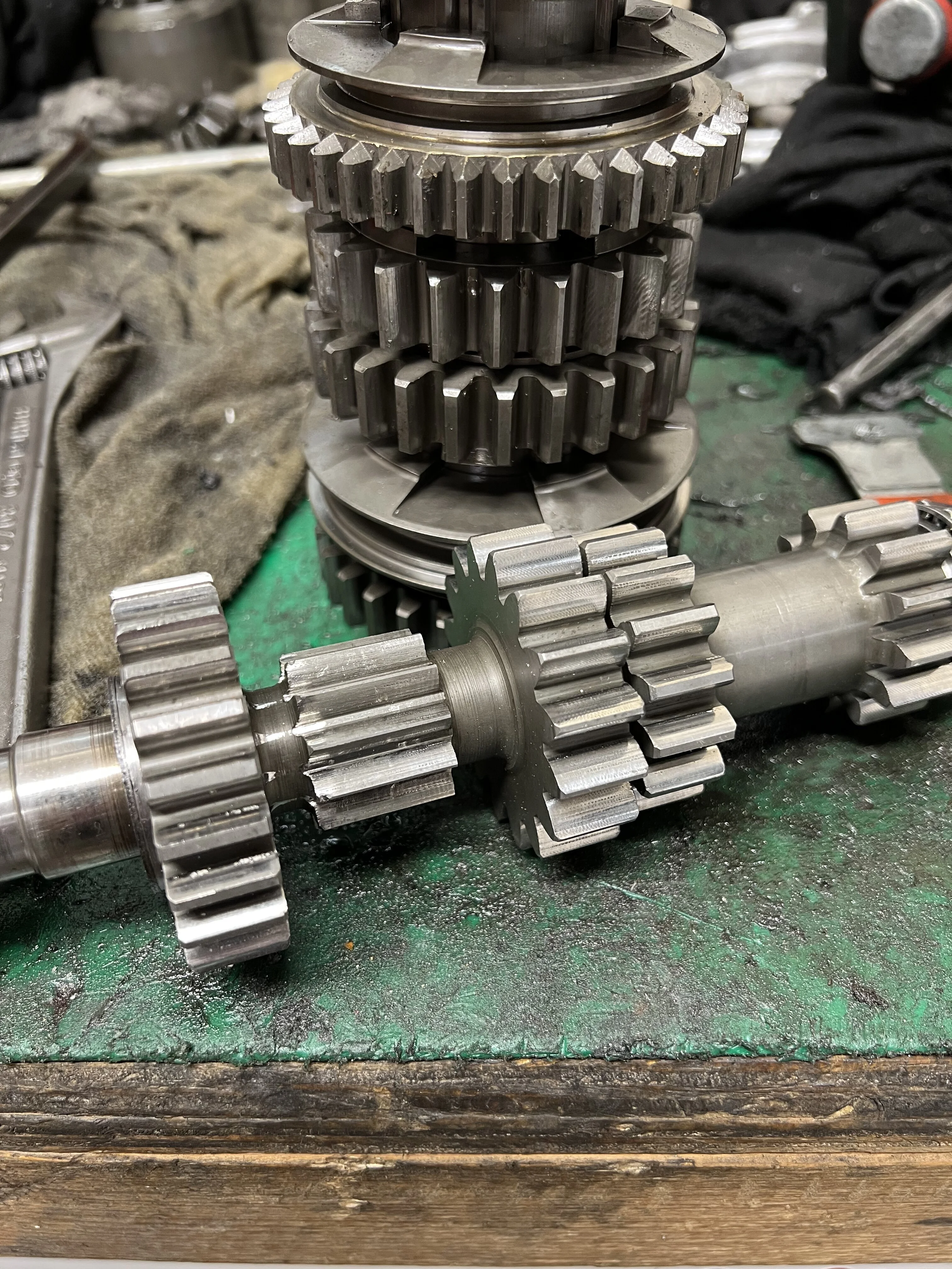

Here’s part of the Jc5 dog box kit. You can clearly see the dog engagement teeth here. There’s a lot of work needed though still. I'm wanting to do away with the brass selector forks as well, so this all needs to be added into a redesign.
  Mk1 1.8 16V Turbo
It’s difficult to say mate. The ratios also won’t suit a boost motor, but I am wanting to have it setup to work with a oe final drive should people wish.

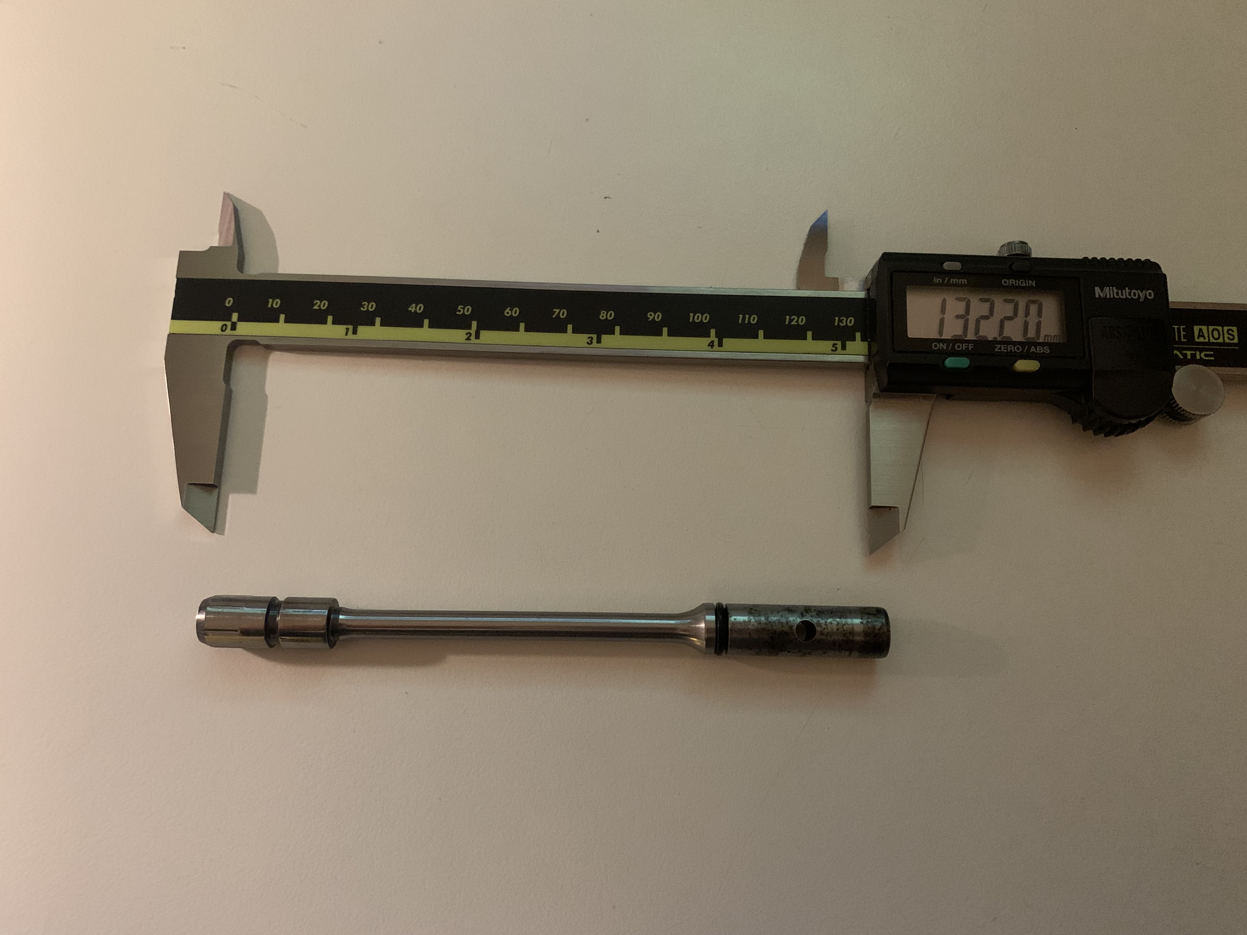

Thanks guys. Really what I want to have machined are torsion bars. I spoke to someone the other day who was very experienced but he wouldn't tell me the alloy steel used, I think he worked for gov/military..
