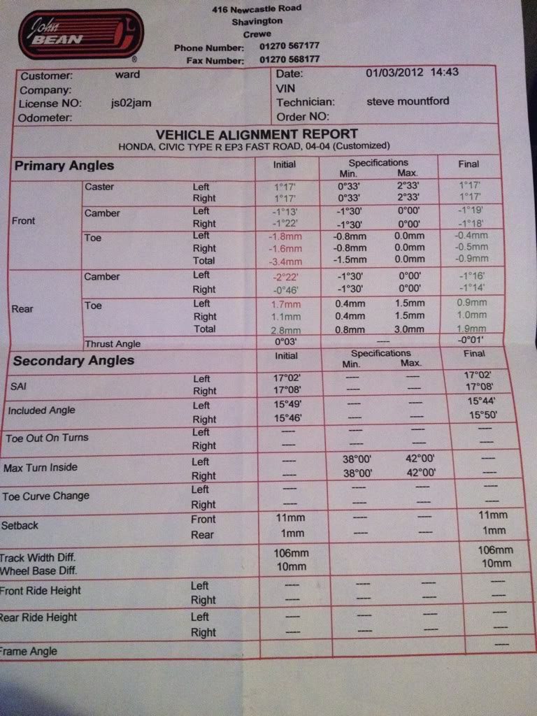

Got a slight suspension problem, where there is to much caster on the drivers side wheel, i think my shock is fooked as its very lose and you can see it wobble, so ill get a new shocker and see if that fixes it. If not ill have to have a look at the hub and wishbones etc. The wheel is about 18mm further back then the other side so its pulling to the left but only when accelerating, otherwise it fine, which is weird.
