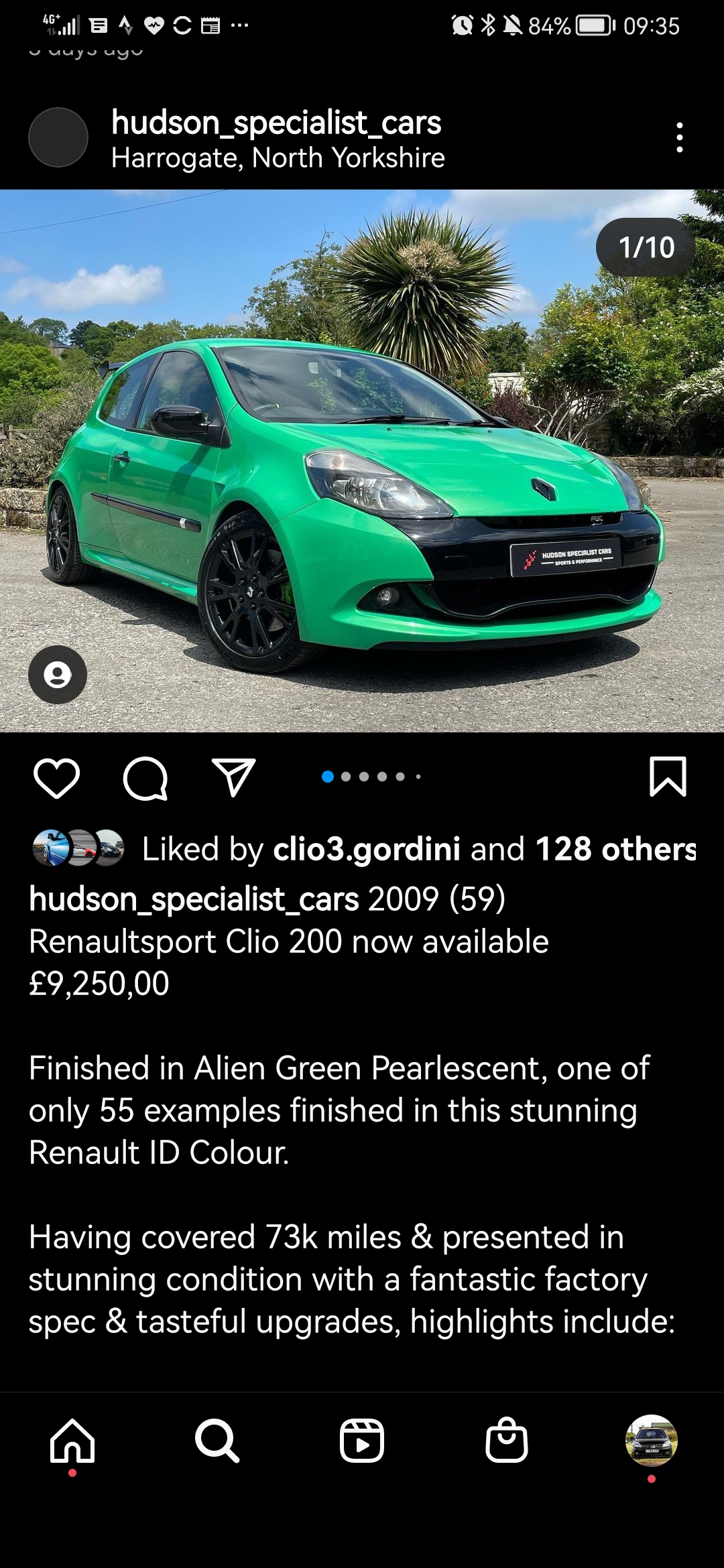

So are you keeping the car then or just looking to increase its value? HSC are selling one they bought off Facebook a while back for £8k and in surprised they haven't bought yours tbh.
Not seen that, interesting, they're local too!

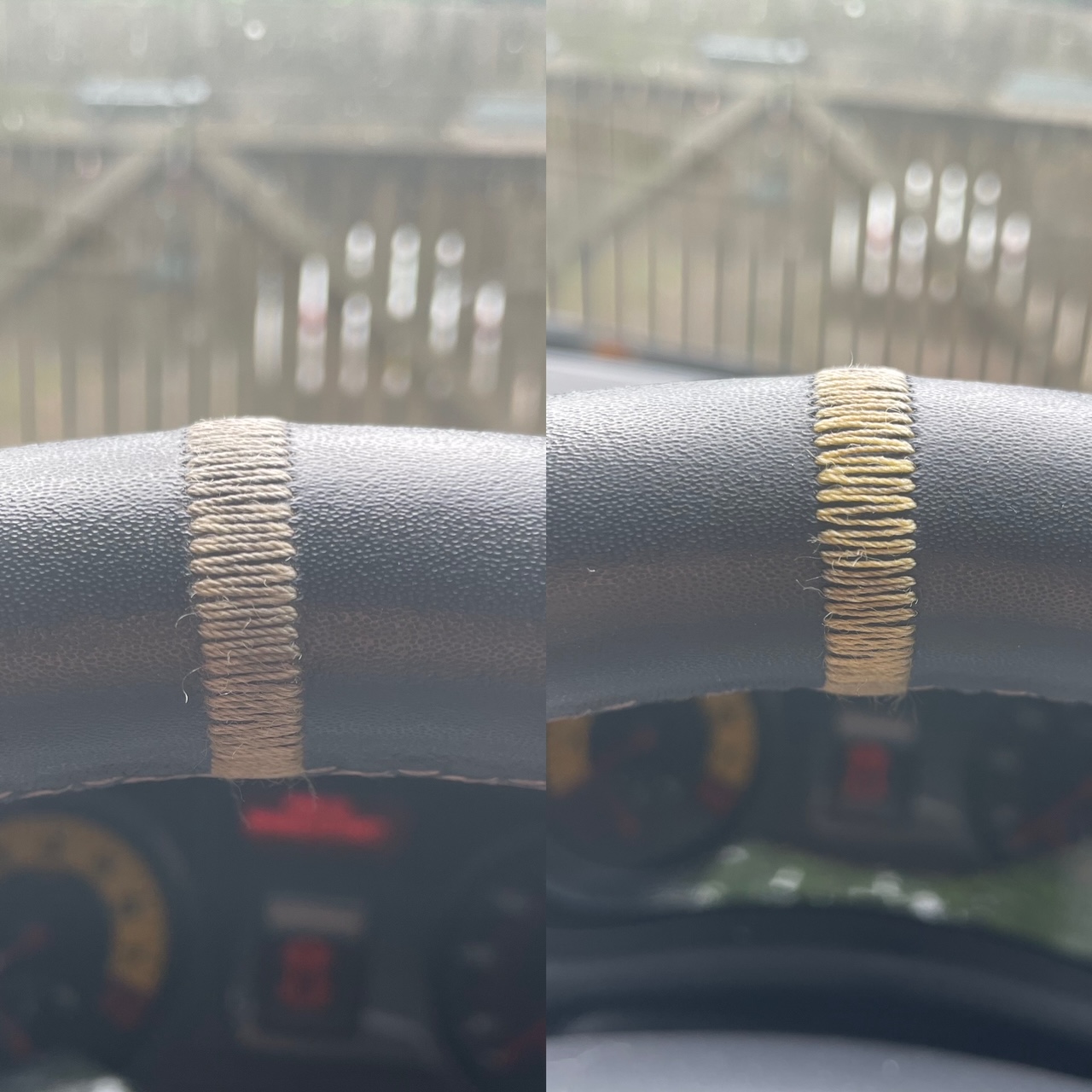

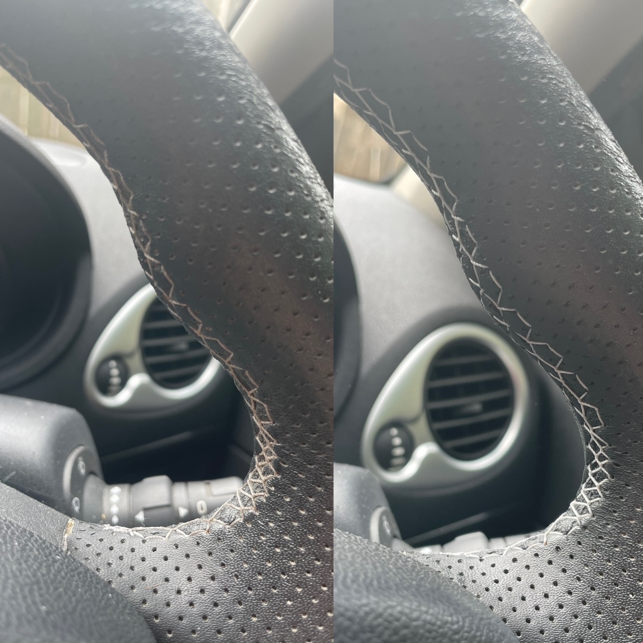

Inspired by @Marceliamous I decided to clean the wheel stitching today, such a satisfying thing to do. I know they are the same photos as they posted but I don't care 😂

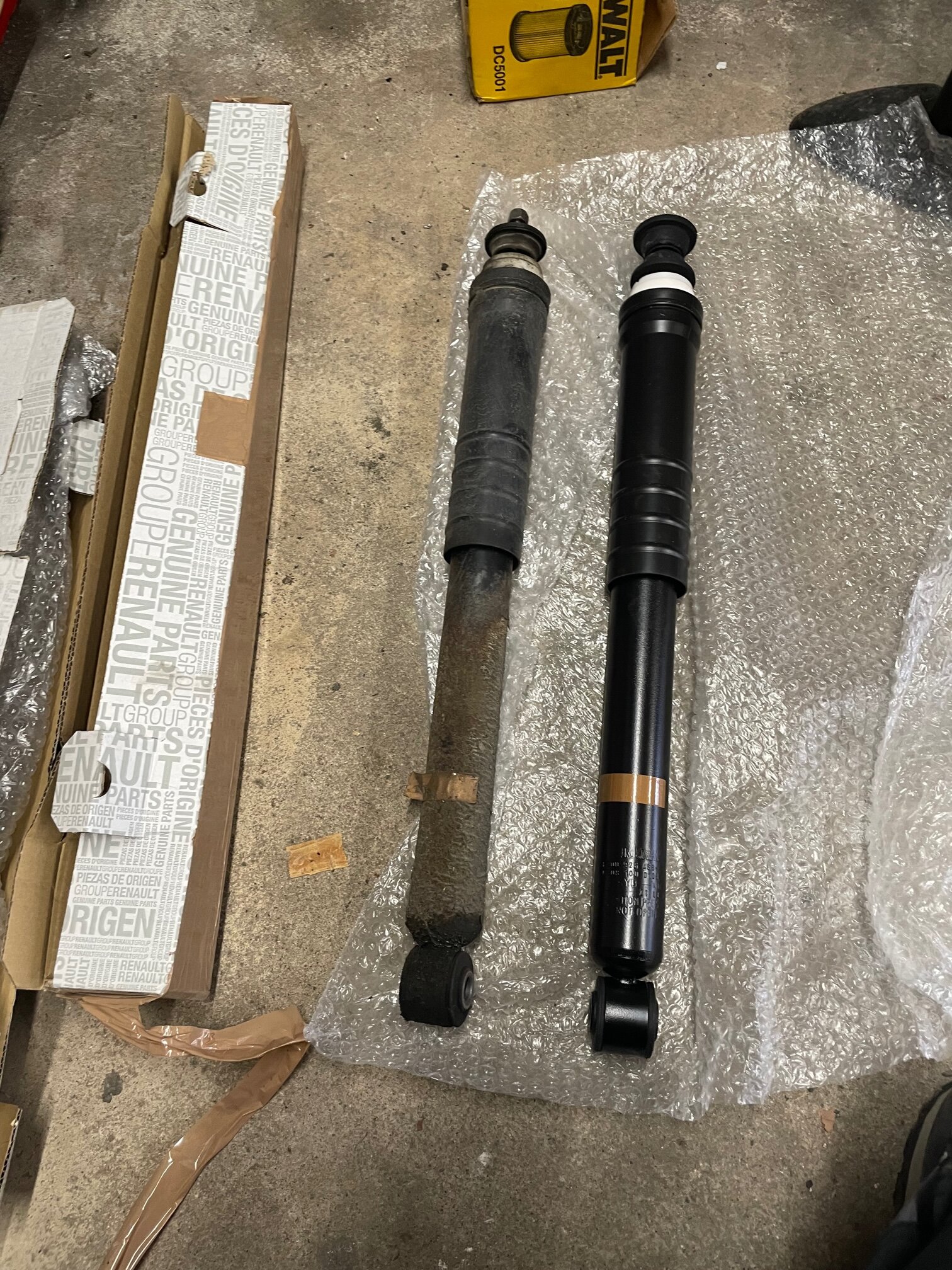

Wanted to change the rear shocks as they were looking a bit crusty, KTEC had some good deals on rear shocks and rear discs and pads, the whole lot were about £80 less than anywhere else for genuine so that was the first job:
Old and new shocks, the old ones didn't feel that bad, but nice to have all new after doing the fronts the other month:

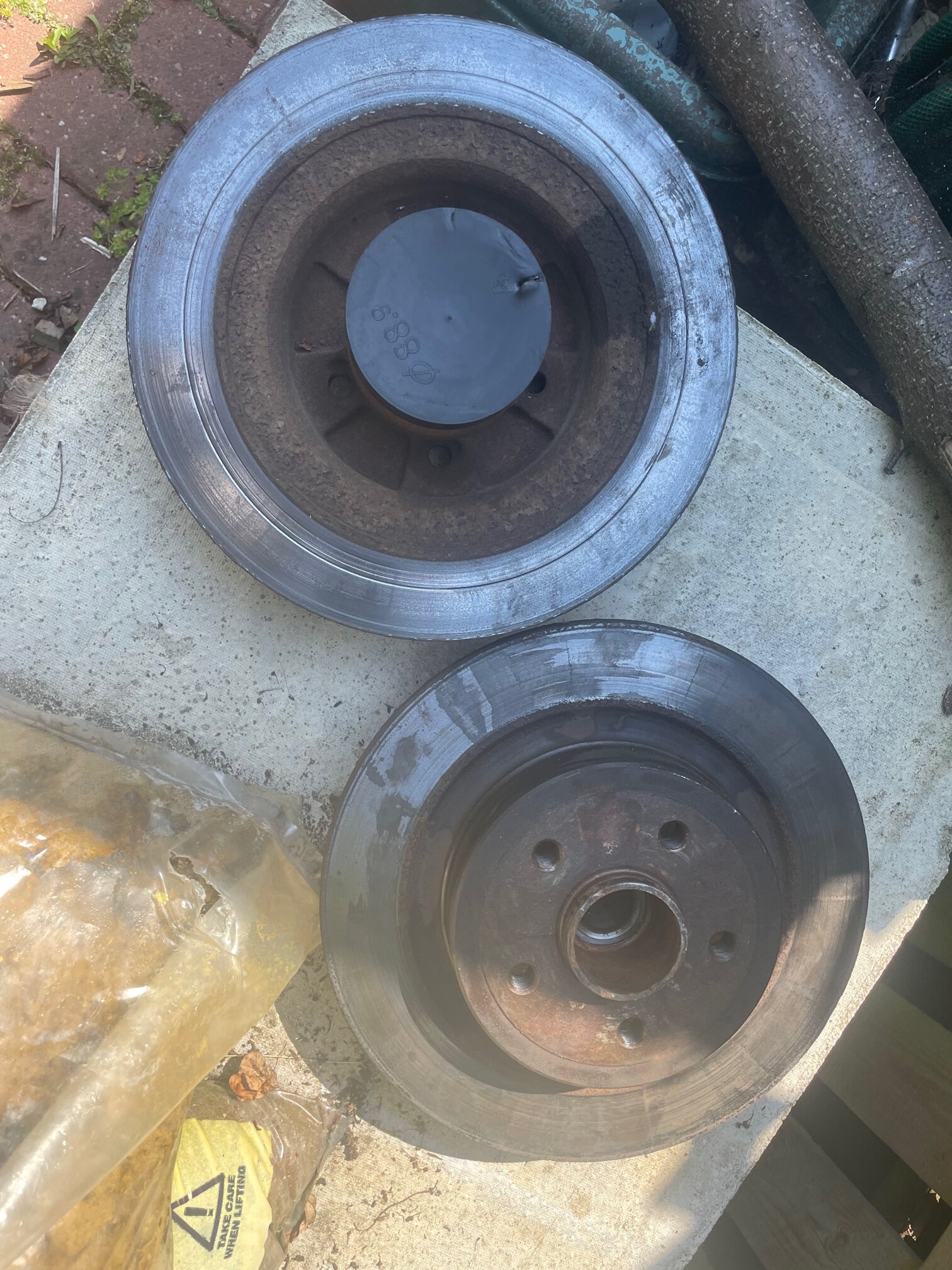

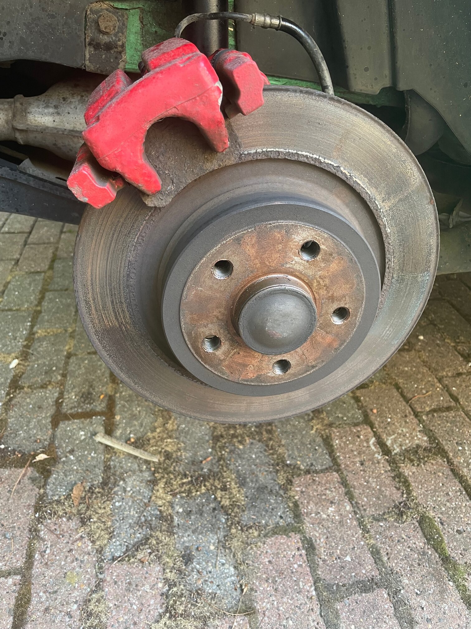

Old brakes again weren't end of life, but a little crusty, the back of the discs had worn a little more. I need to respray the calipers too I know:

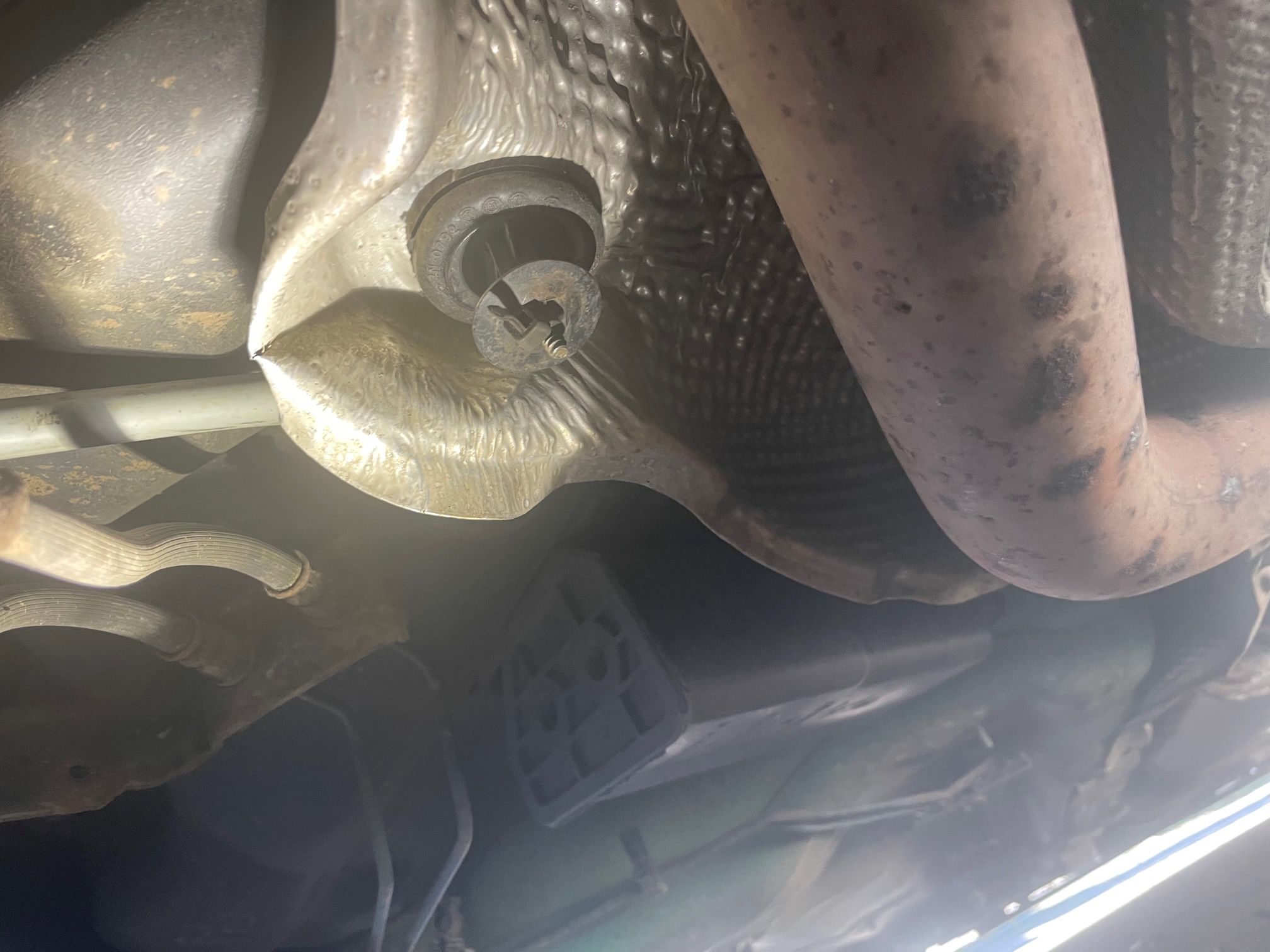

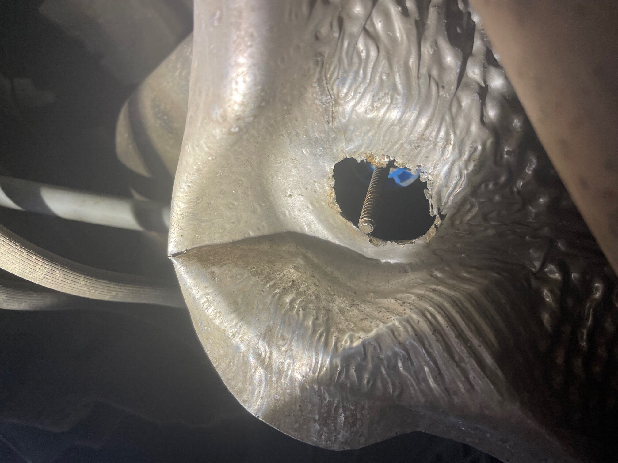

Finally there has recently been a nasty heat shield rattle, found that pretty quickly:
The clip was non existent and crumbled when I removed it, and I couldn't find anything else I could use today so I have improvised with a tight af cable tie that I then spun up the threads for a tight fit. Found a massive rubber washer from the Herald build which should do the job of holding it up.

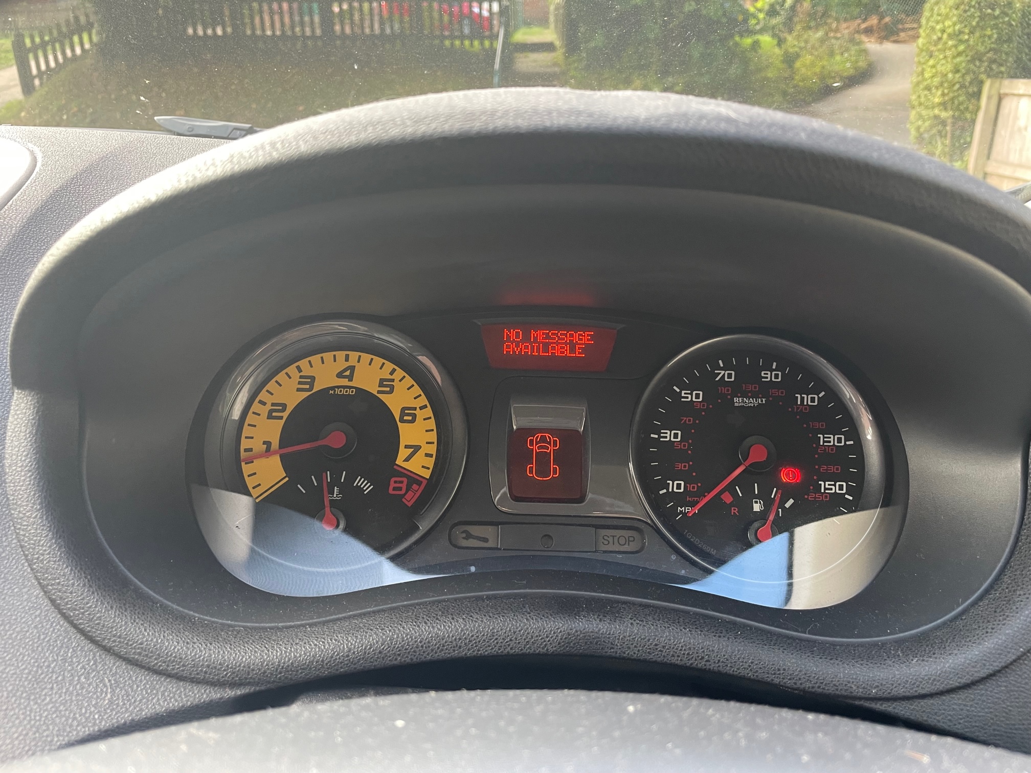

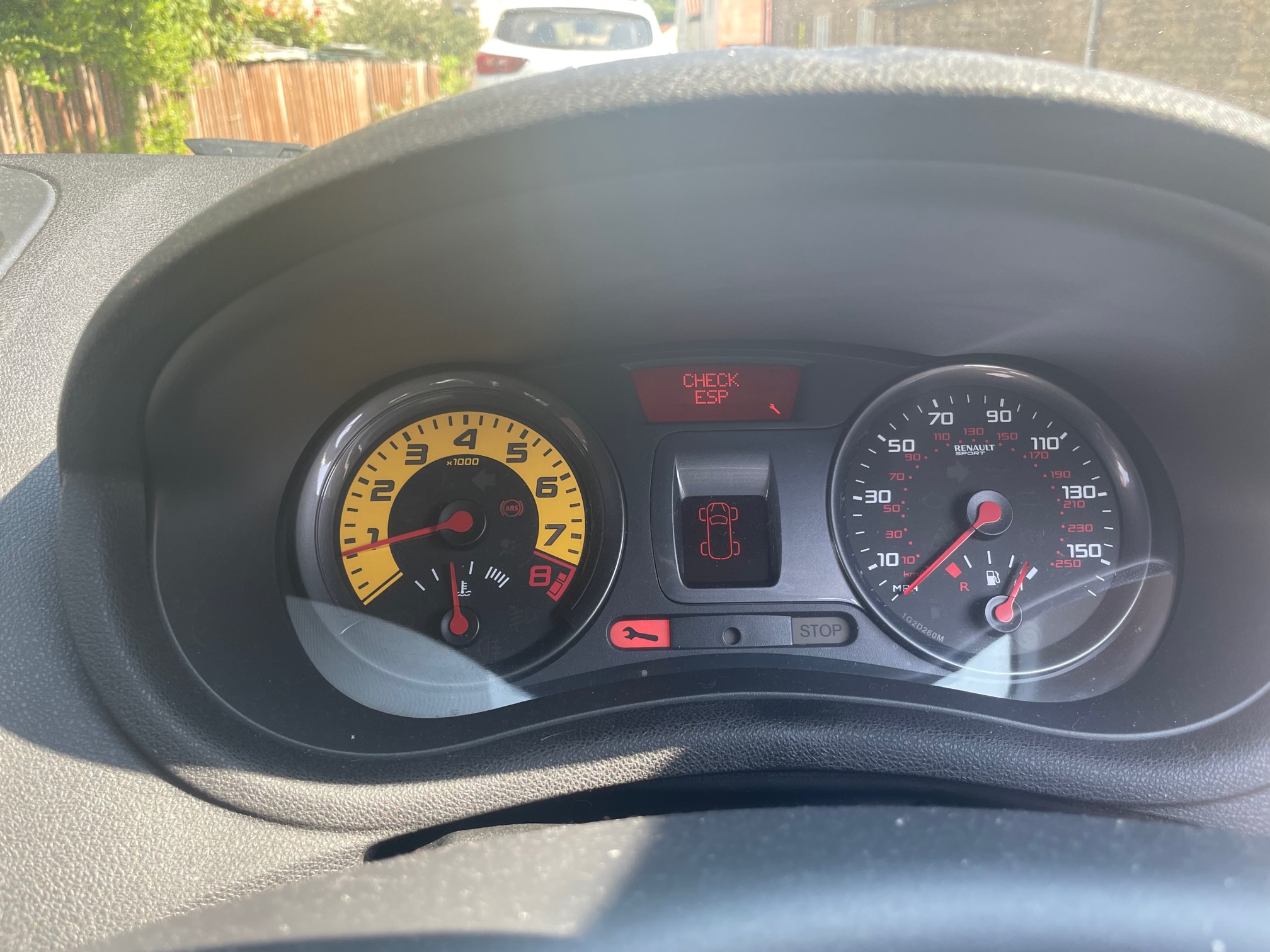

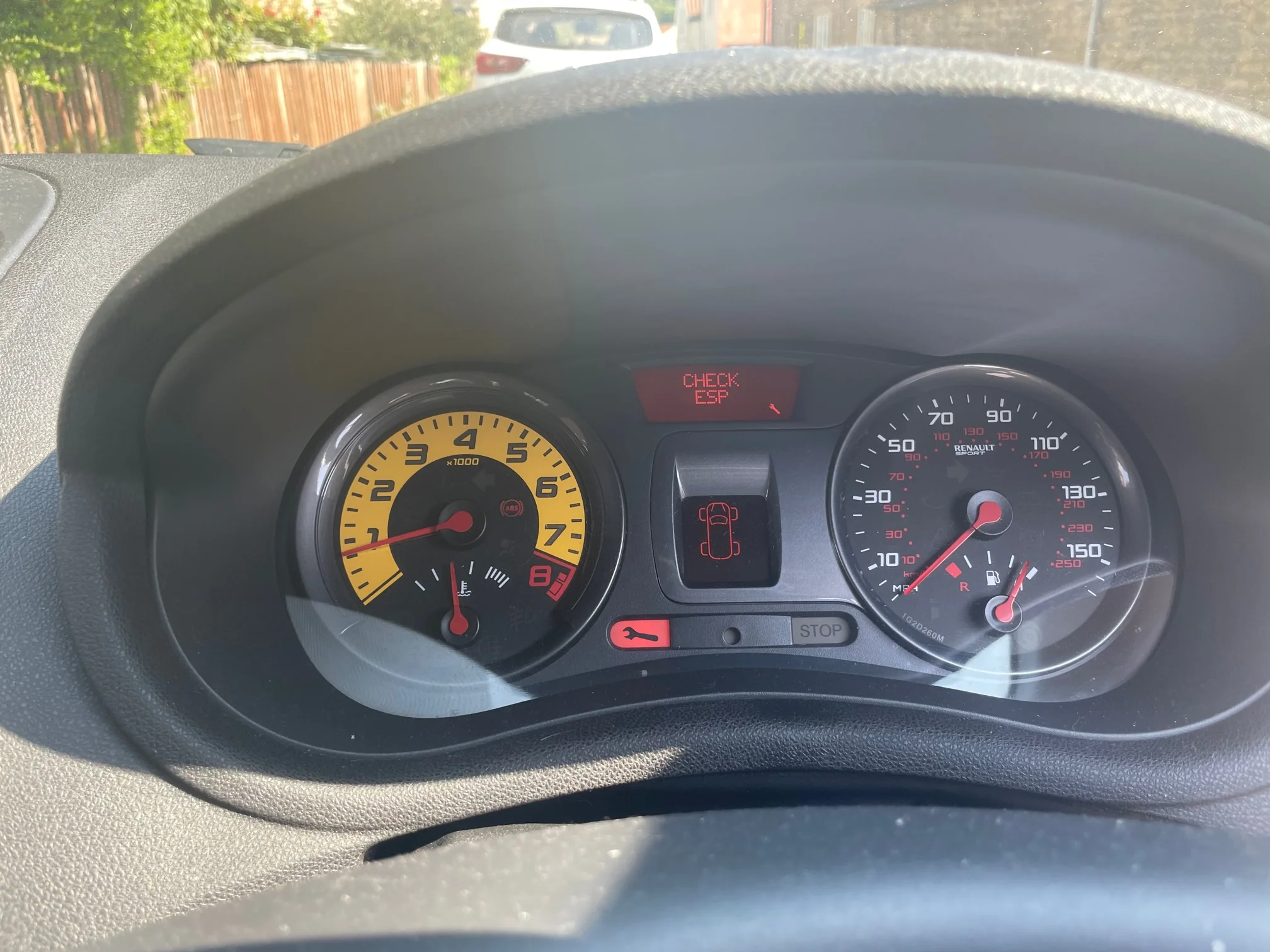

Then I went for a spin and the dash lit up 😞
I read the codes and it is showing rear left sensor.

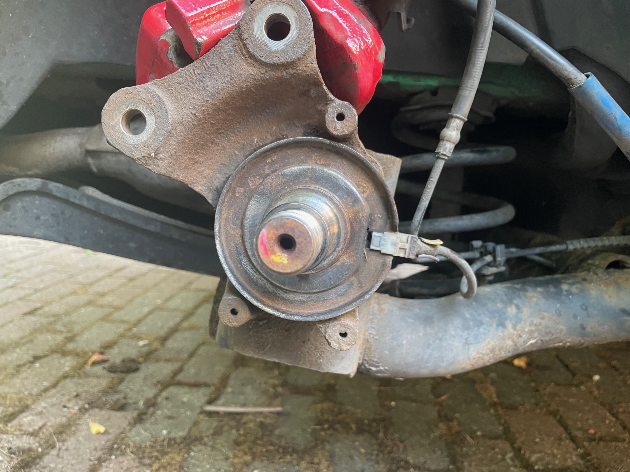

The bracket everyone replaces due to corrosion isn't that bad, I took it all apart and cleaned it up really well but it still hasn't helped, the code comes back every time I clear it after 200 yards of driving. I even threw the old disc back on incase it was the new ring but that didn't help either.
Have ordered a new sensor anyway, can't really think what else it could be. Unless the code is a red herring and it's actually the other side with an issue.
Then I stopped for the day, the last two things are cosmetic and it doesn't deserve them.
As per my thread here, the ABS ring on one of the new discs was ruined somehow: https://cliosport.net/threads/abs-fault-after-fitting-new-discs.843571/

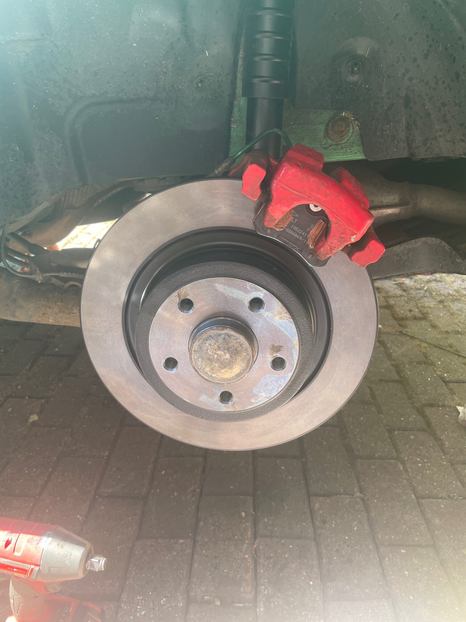

New ring came today, not taking any risks this time I wire brushed the bracket up ready for fitting:
Took it for a quick spin, lights and codes be gone, for now at least:

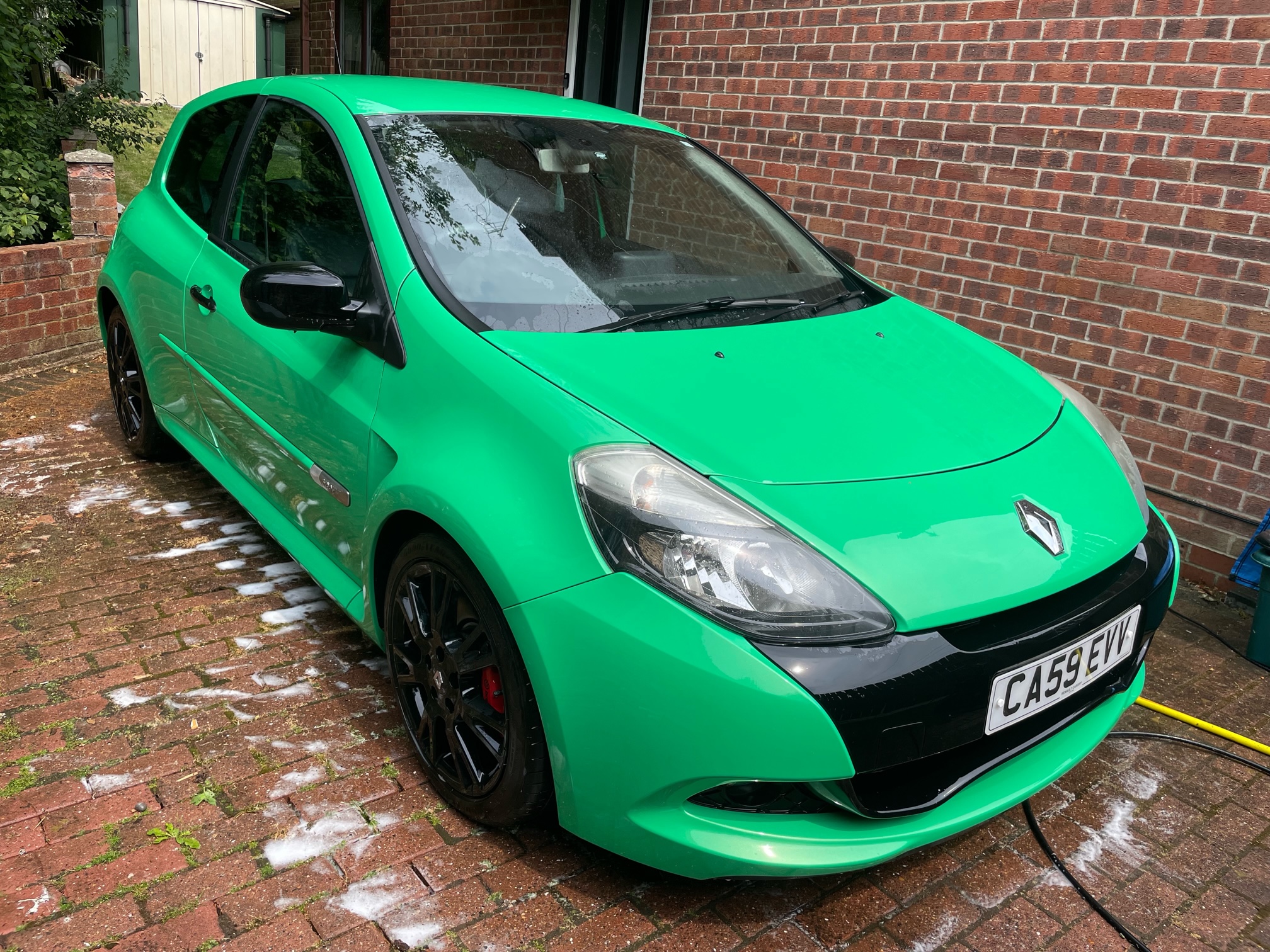

Really fancied tinkering with the car today but it kept raining, managed to find a gap in the rain to give it a wash. We still have a hosepipe ban here so got myself a bucket feed for the pressure washer, which I now realise is just a piece of hose with a filter and valve on the end, still it was only £20.
Comes up lovely even if I do say so myself!

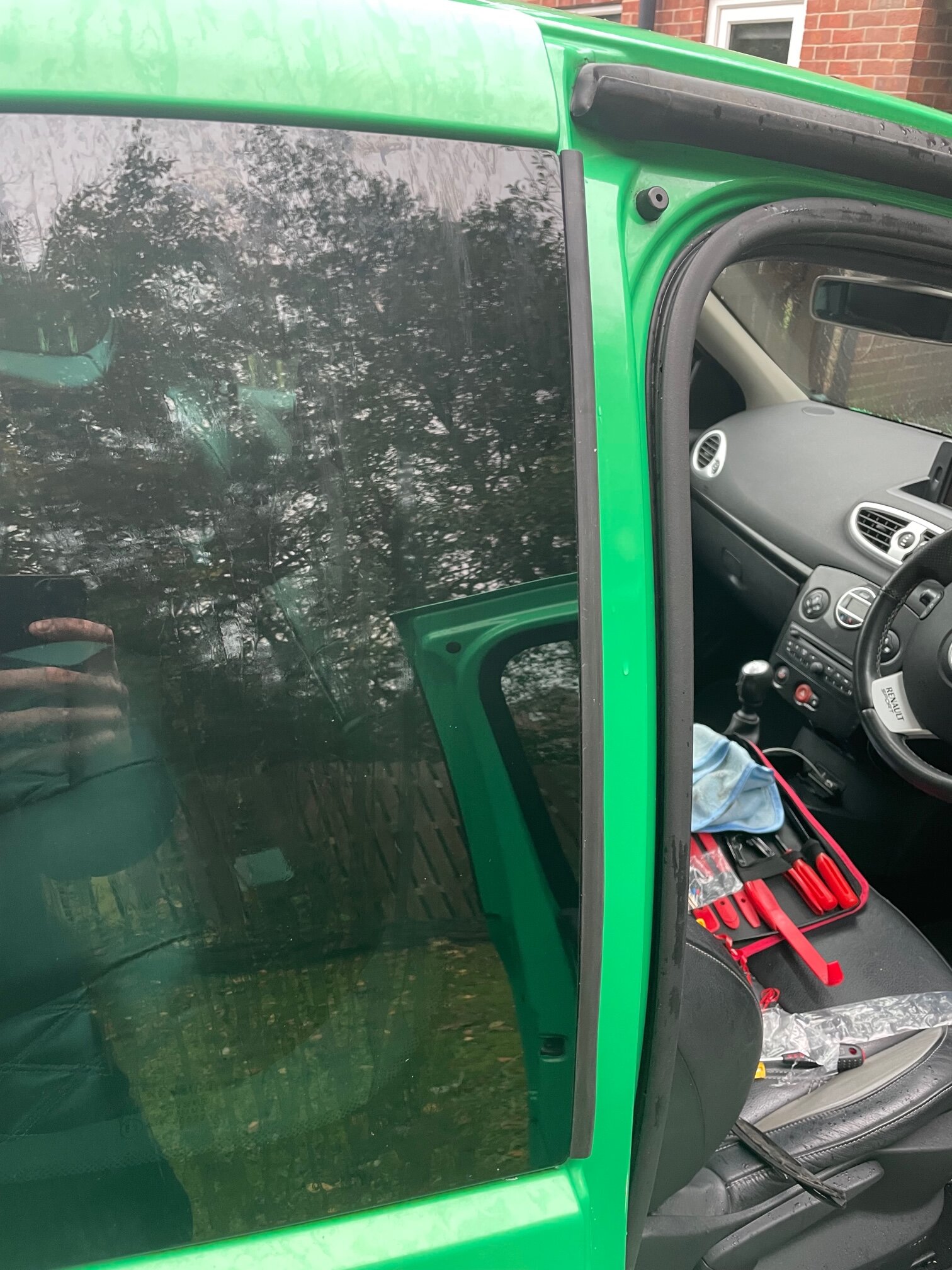

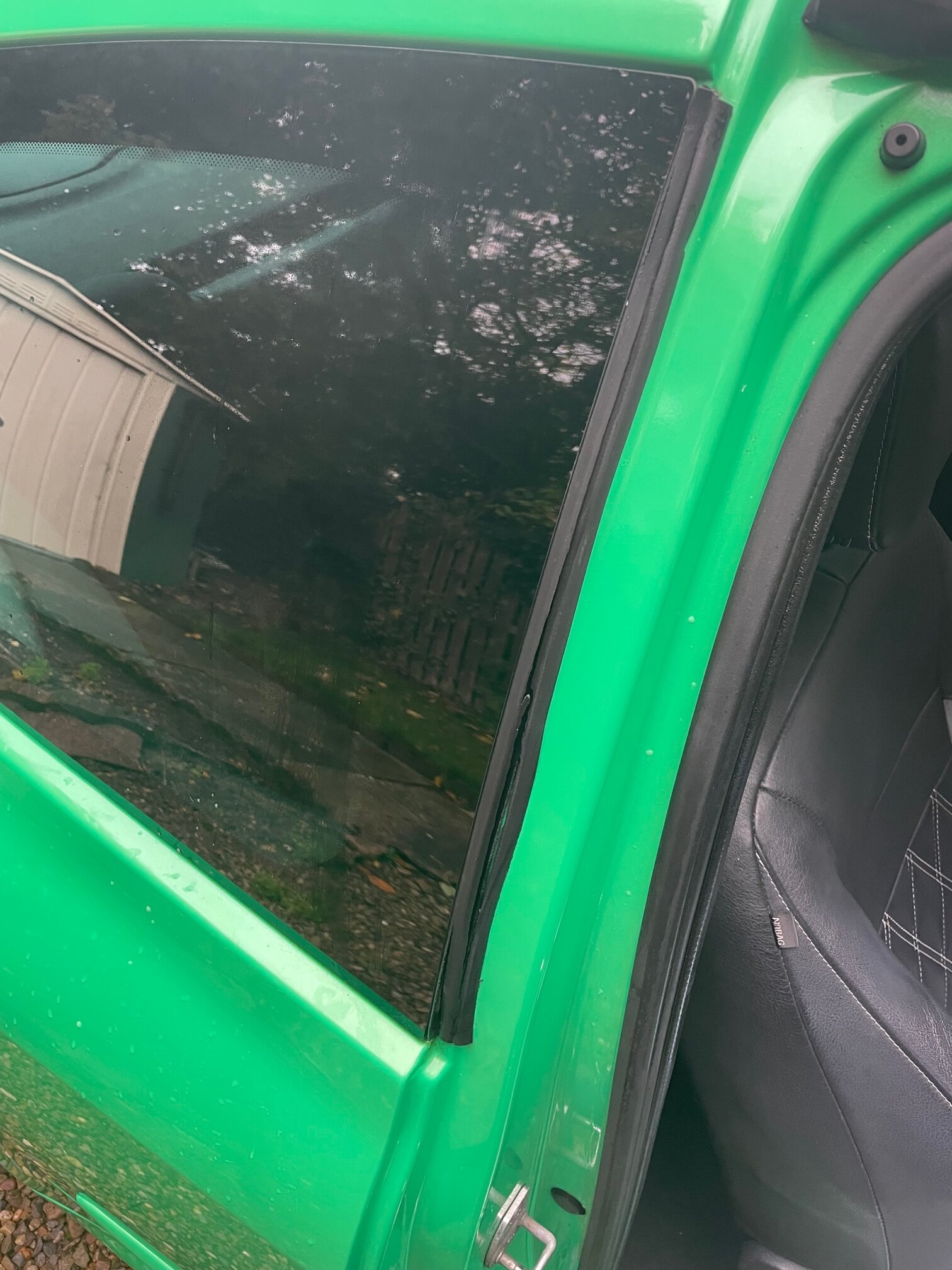

The b pillar weather strips are pretty much gone, so I got replacements and the video on youtube makes it look a piece of cake to swap them. Well the amount of residue is nothing like the video, presumably because on the video he removes a recently fitted aftermarket one and replaces it. But a 13 year old renault one is crusty and leaves an unreal amount of glue. A lot of swearing later, especially when it kept raining, and I've got one side done. Might do the other tomorrow if it's dry (unlikely).
This is before:
And after:

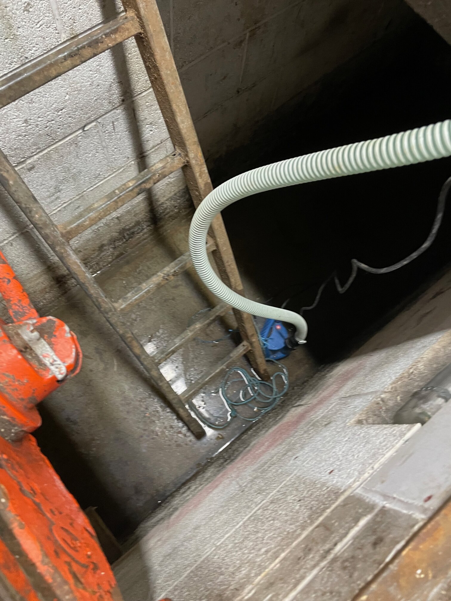

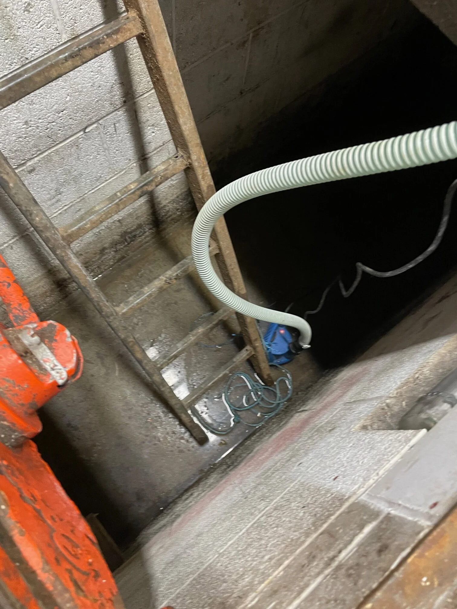

Job 1 as always, pump out the pit. I swear if we put the outlet into the reservoirs the hose pipe ban would be over:

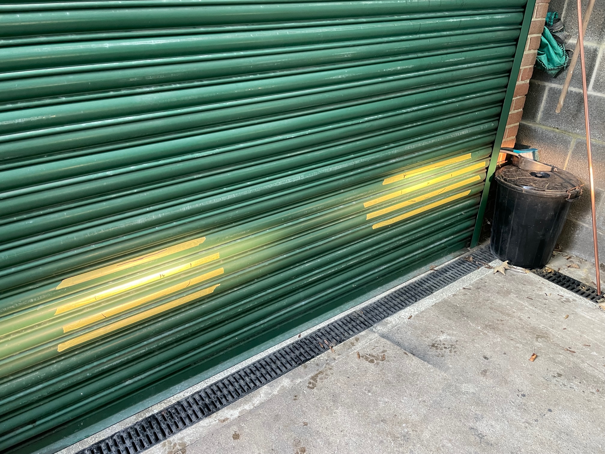

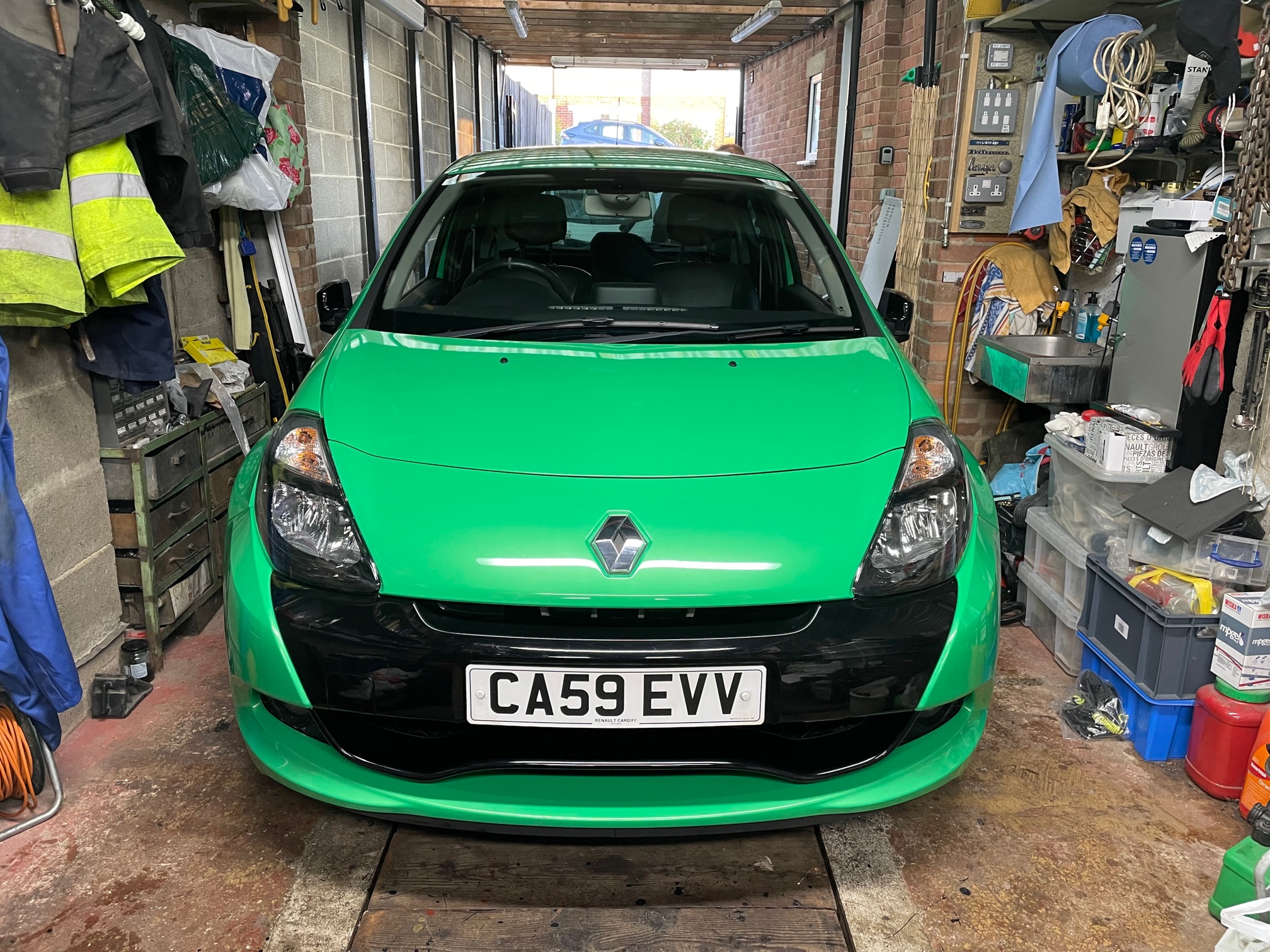

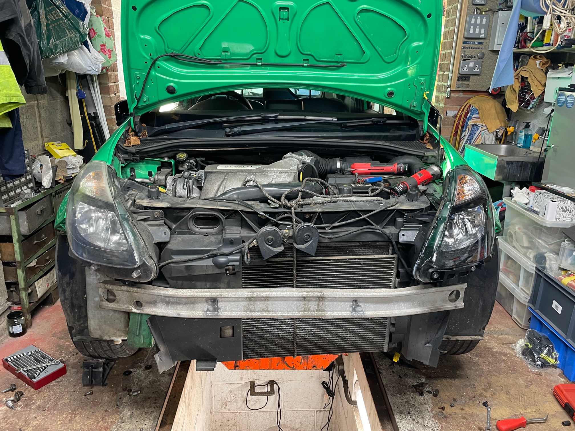

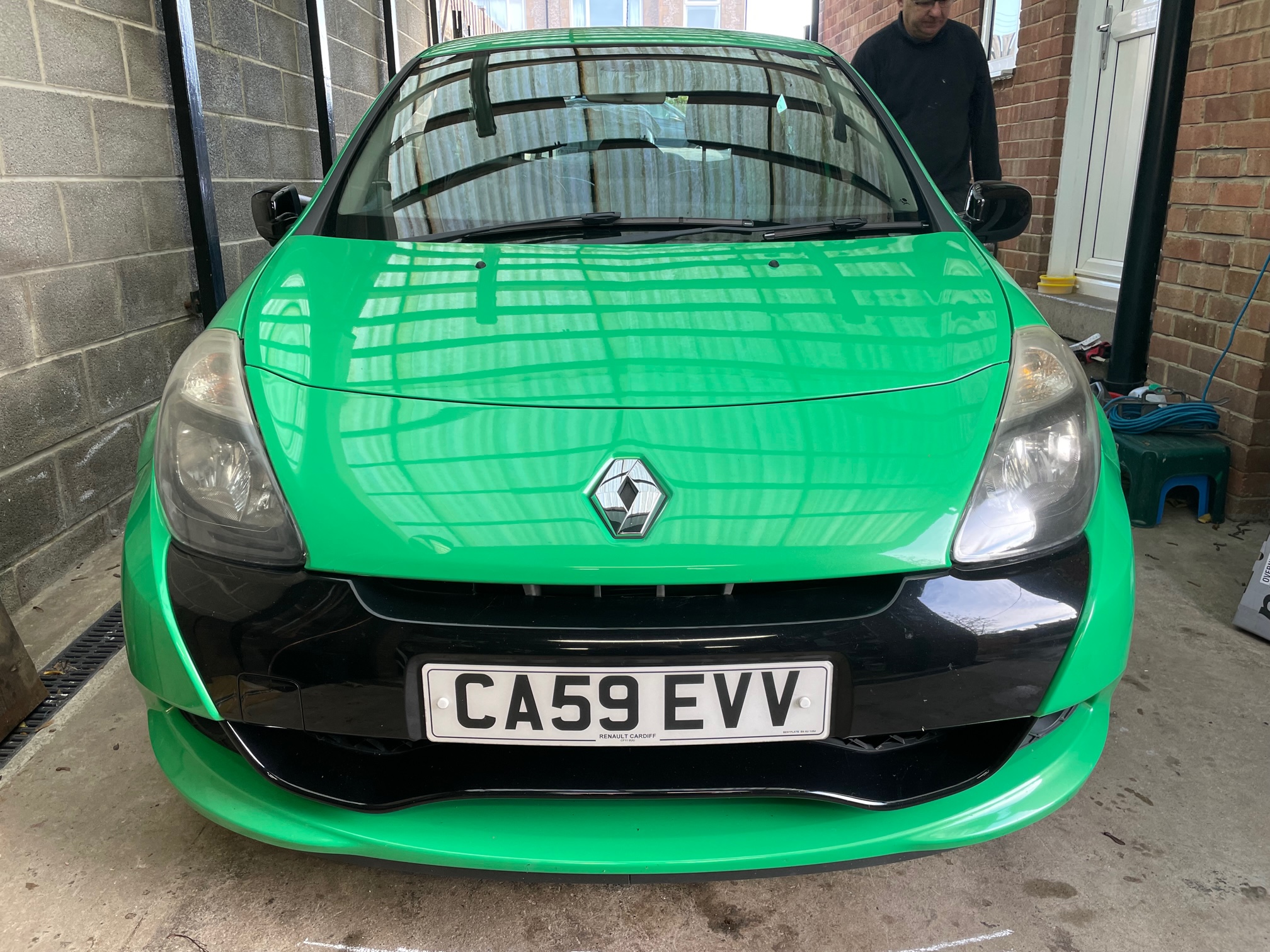

Car job one today was to replace the headlights, never been happy with them so got a couple of new Valeo units. Wasn't fussed about projectors, just nice stock units.
Used the garage door to mark up the beam pattern first:
Before:
During:
After:
To say I'm happy is an understatement, absolutely transformed the front end of the car!

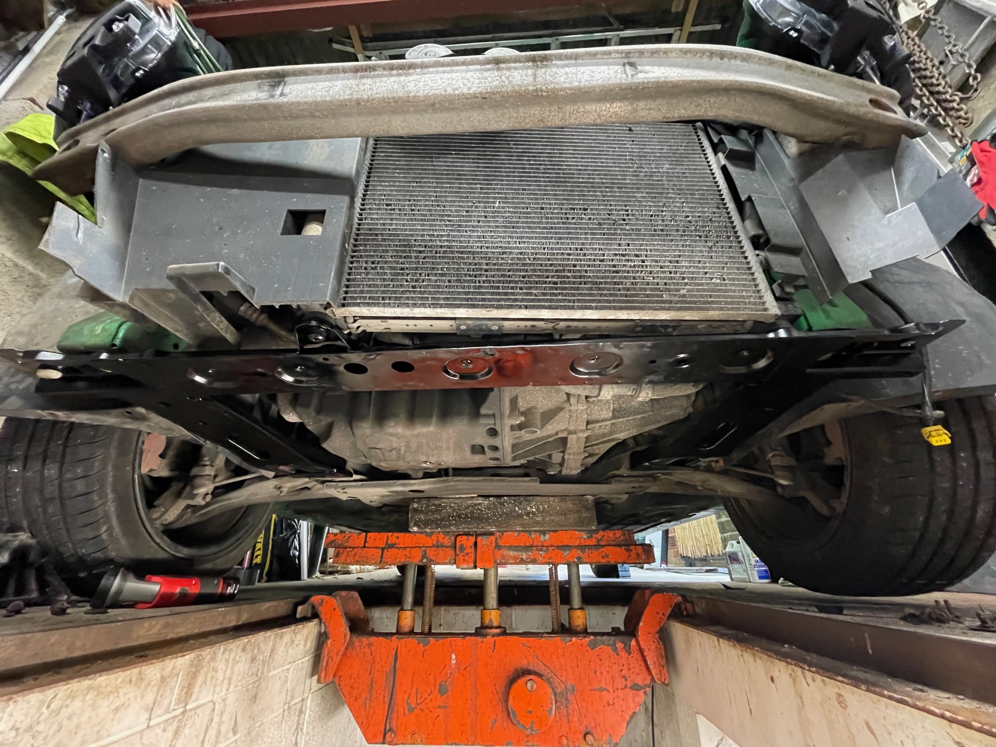

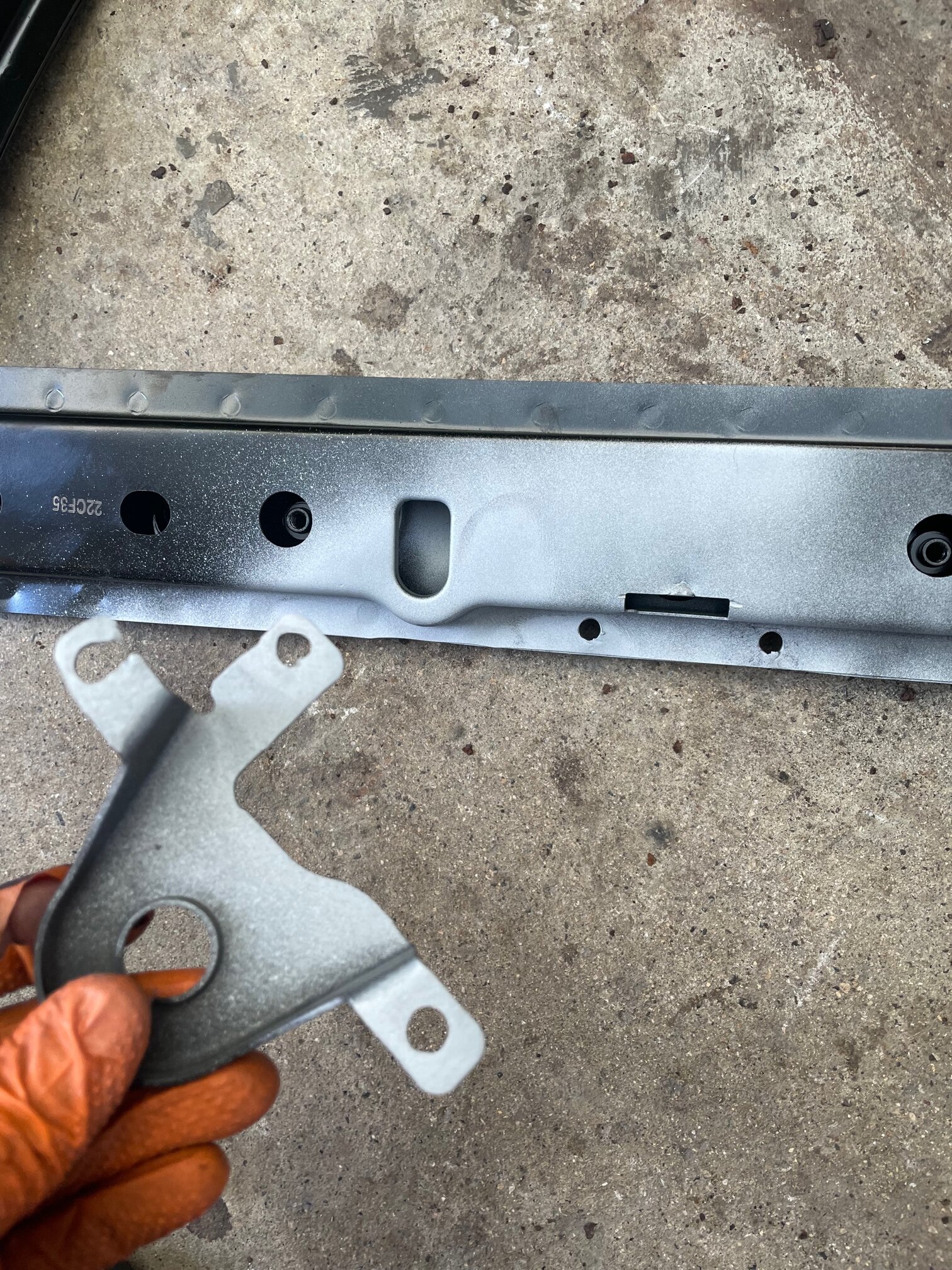

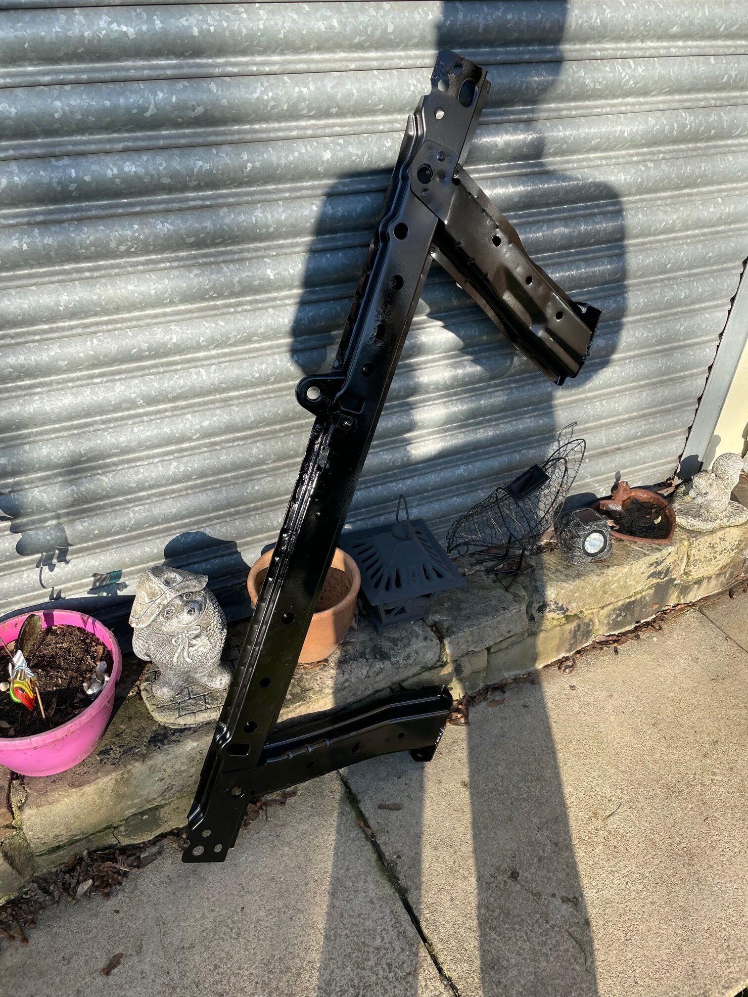

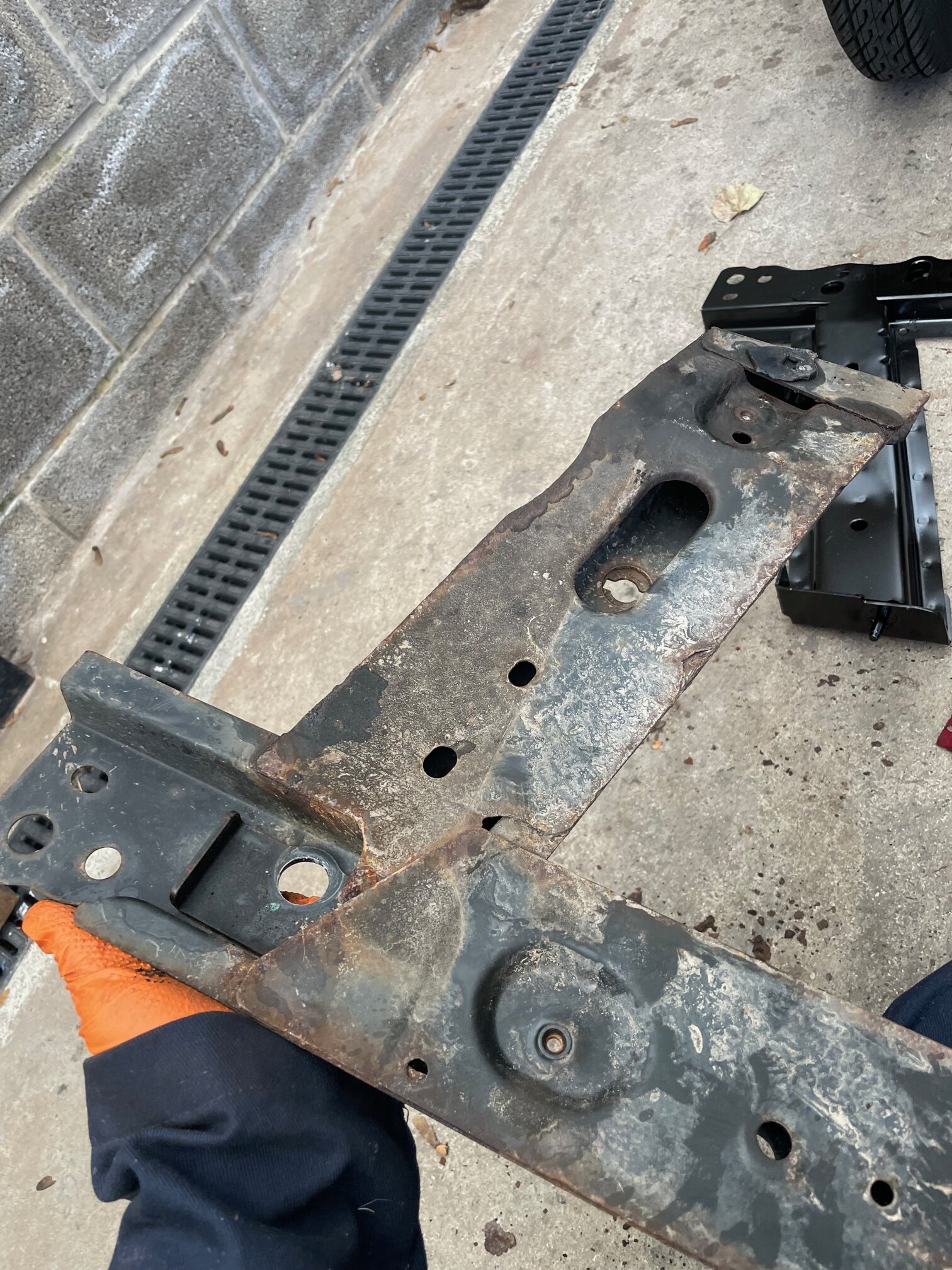

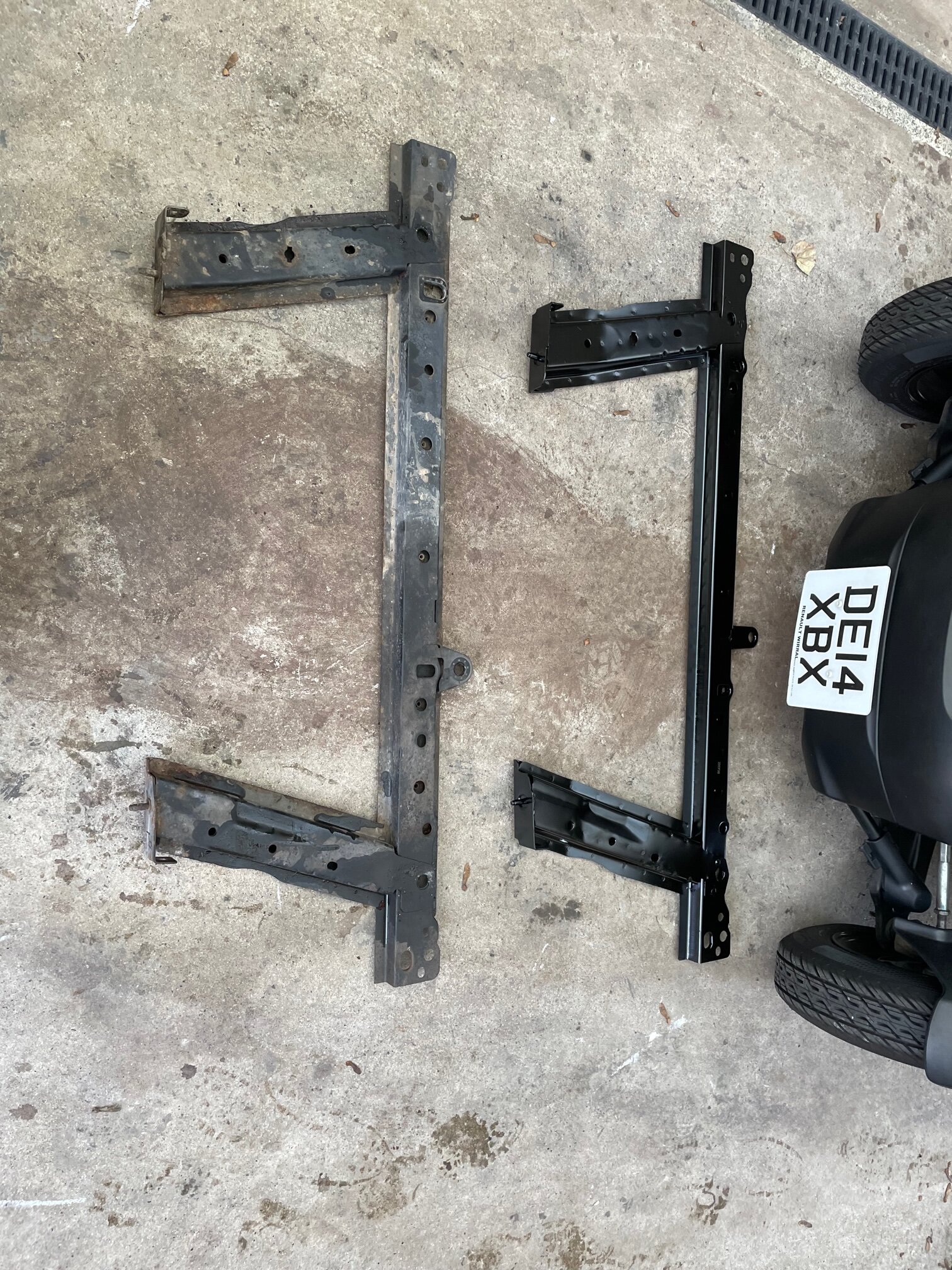

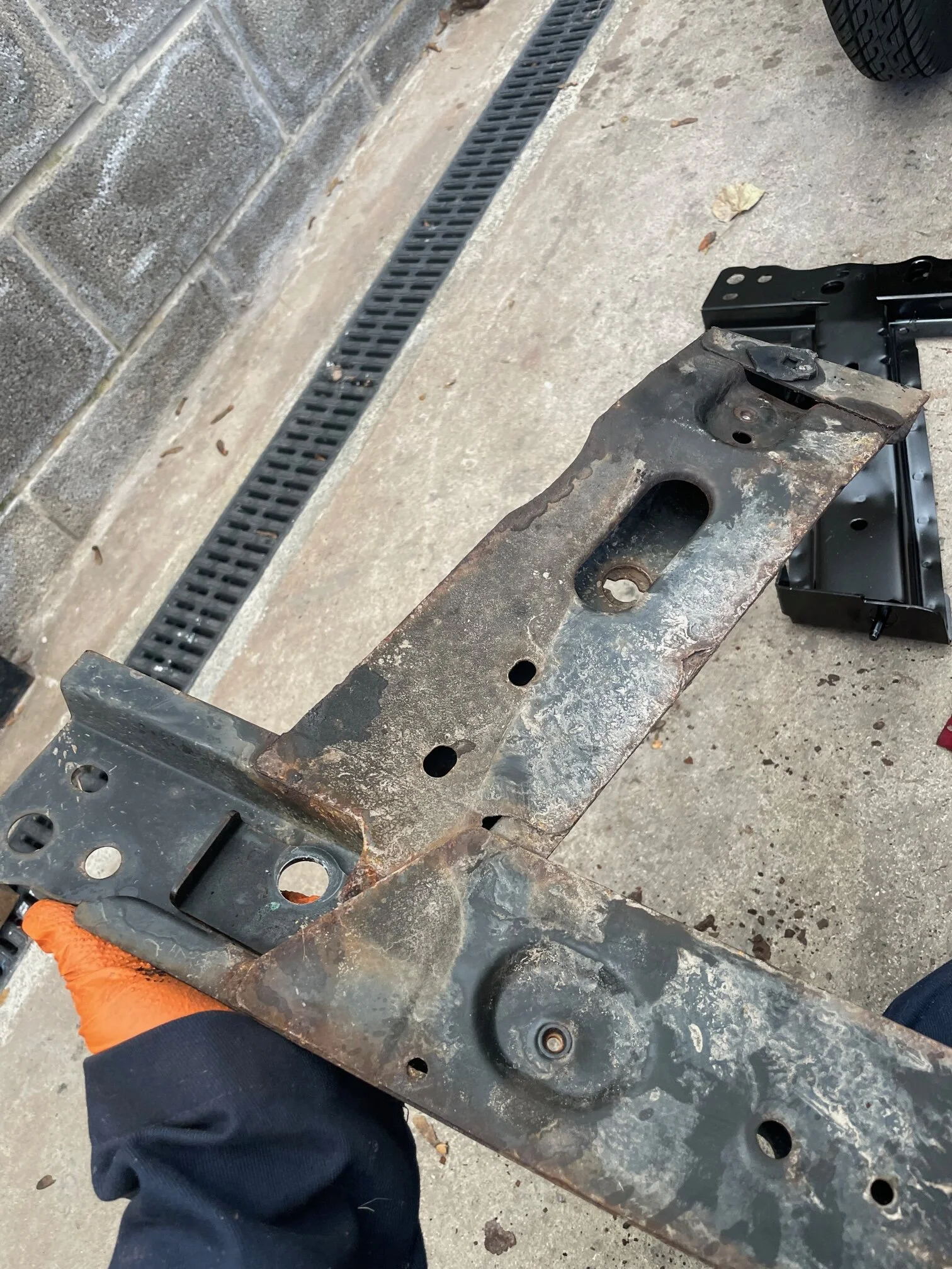

Next job was the rad mount, mine wasn't so bad but had rusted straight through in a couple of places on the bottom, but as the bumper was off and the part isn't a huge cost for the non sport version, although it does require some modification to fit.
Old one and new:
Drilled the spot welds out of the mount from the old one, prepped with some weld through primer:
All welded up and sprayed:
And fitted:
Arguable didn't need doing, but for £50 worth doing I think. Yes this one will rust away too, but I'll have probably sold the car way before that happens 😂
