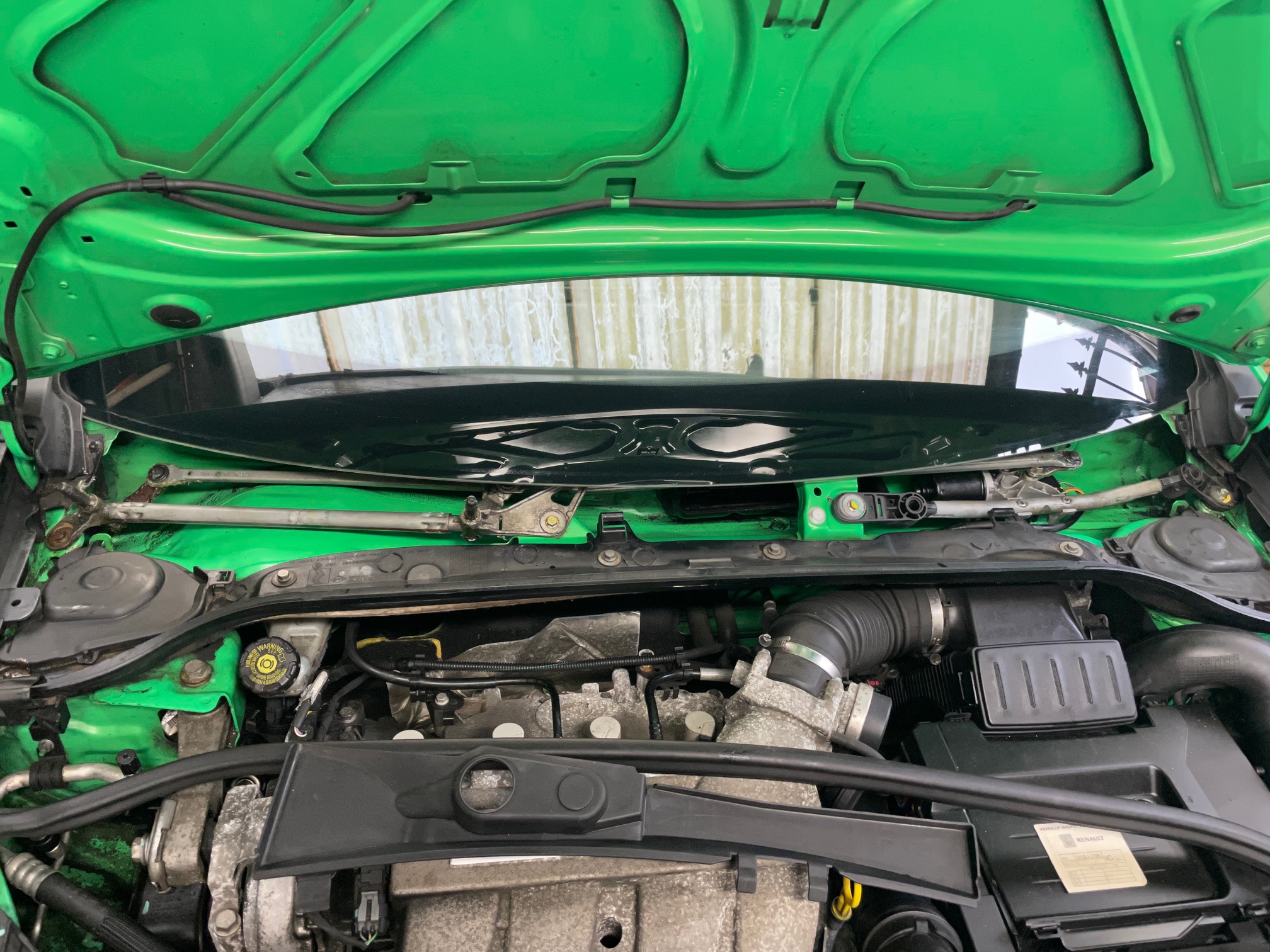

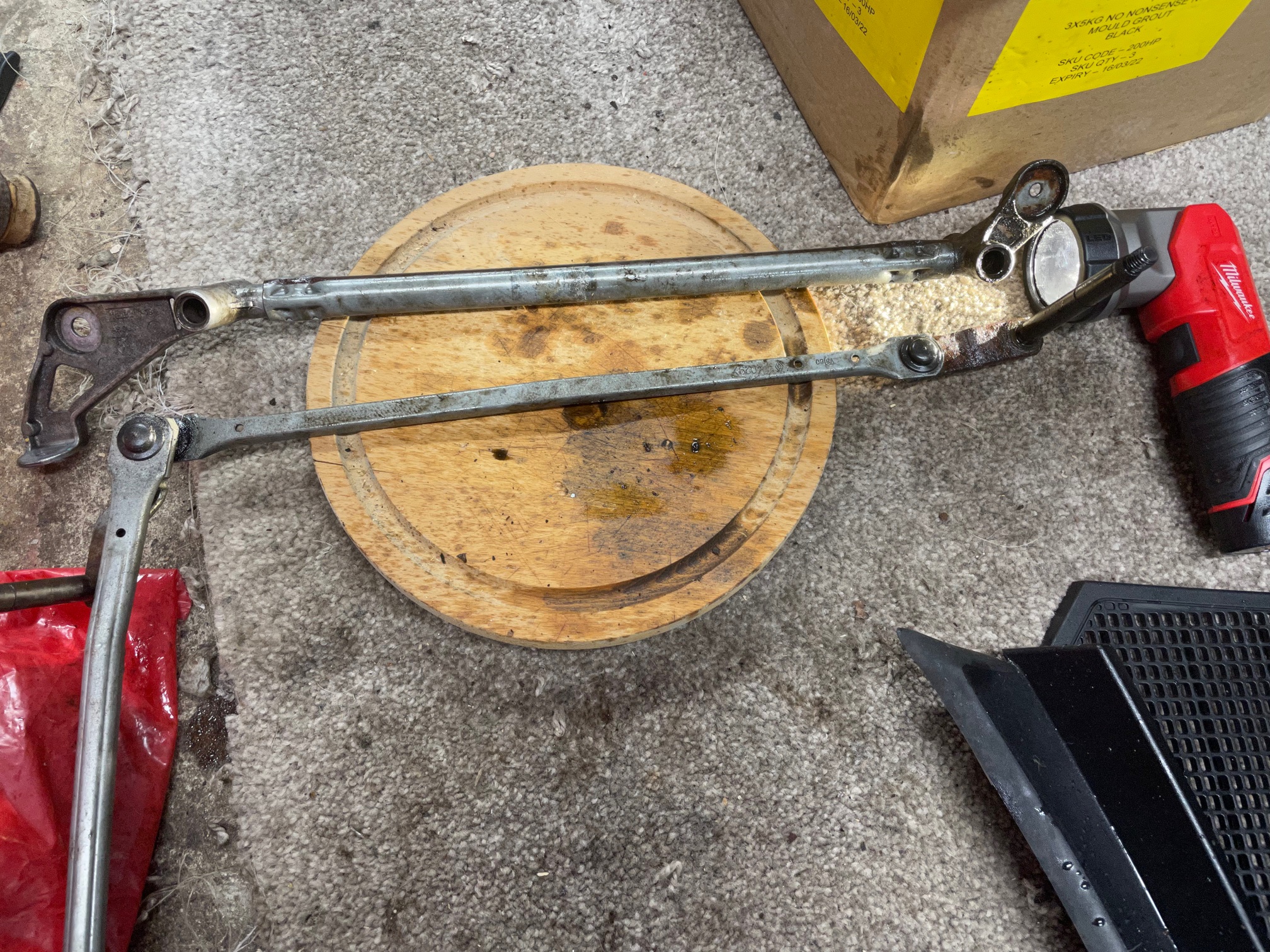

So on the test drive everything worked perfect, even the wipers...
About half way home this changed, they got slower, and slower, and stopped. This was less than ideal as the rain was getting heavier.
We pulled in to services and bought some fancy window cleaner, they actually had a really nice selection of detailing products, and polished the windscreen to try and create a rainX effect. And amazingly it worked, just the one crappy picture of it beginning to streak up but as long as we maintained 60 the screen self cleared and we made it home.

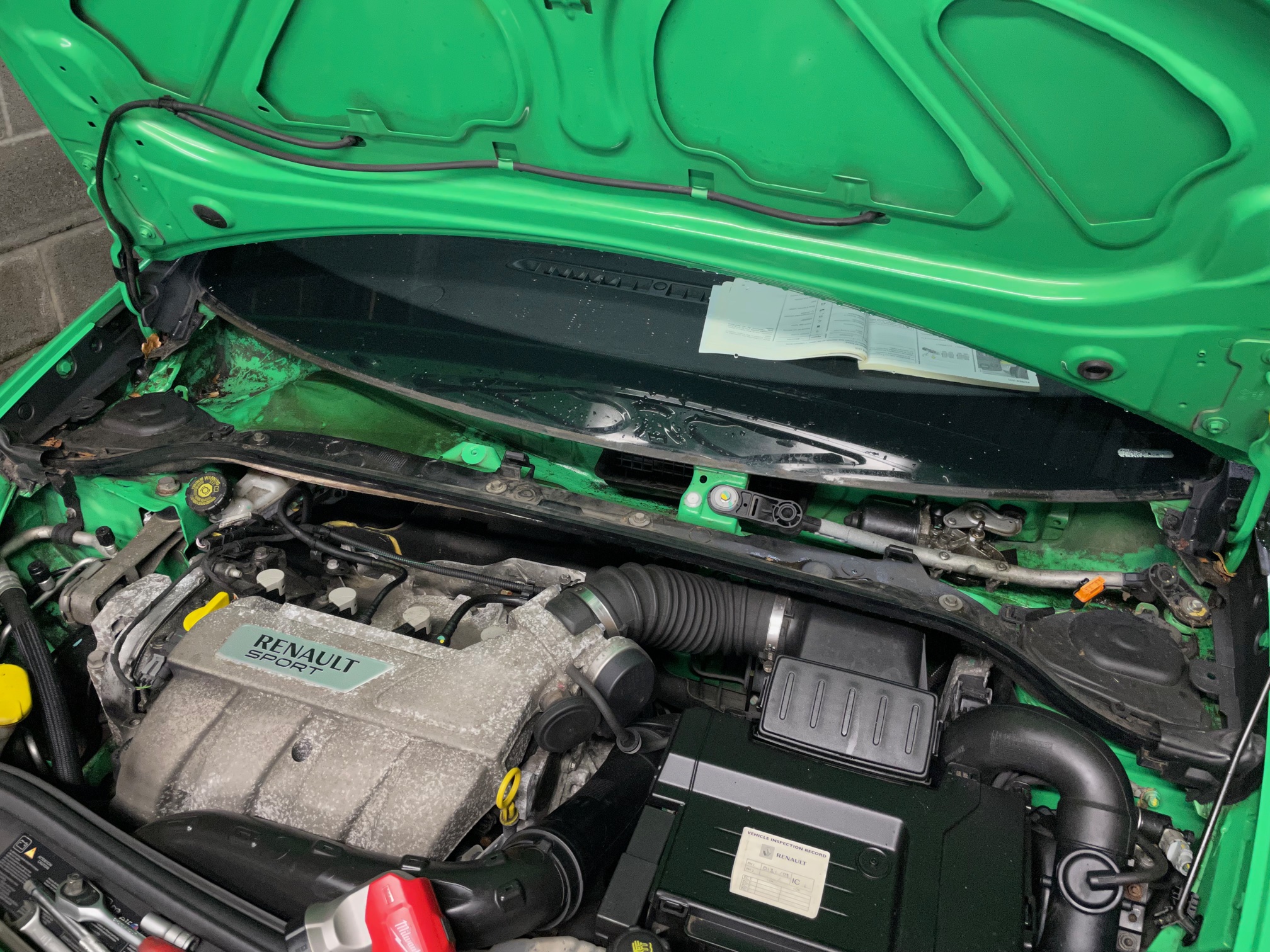

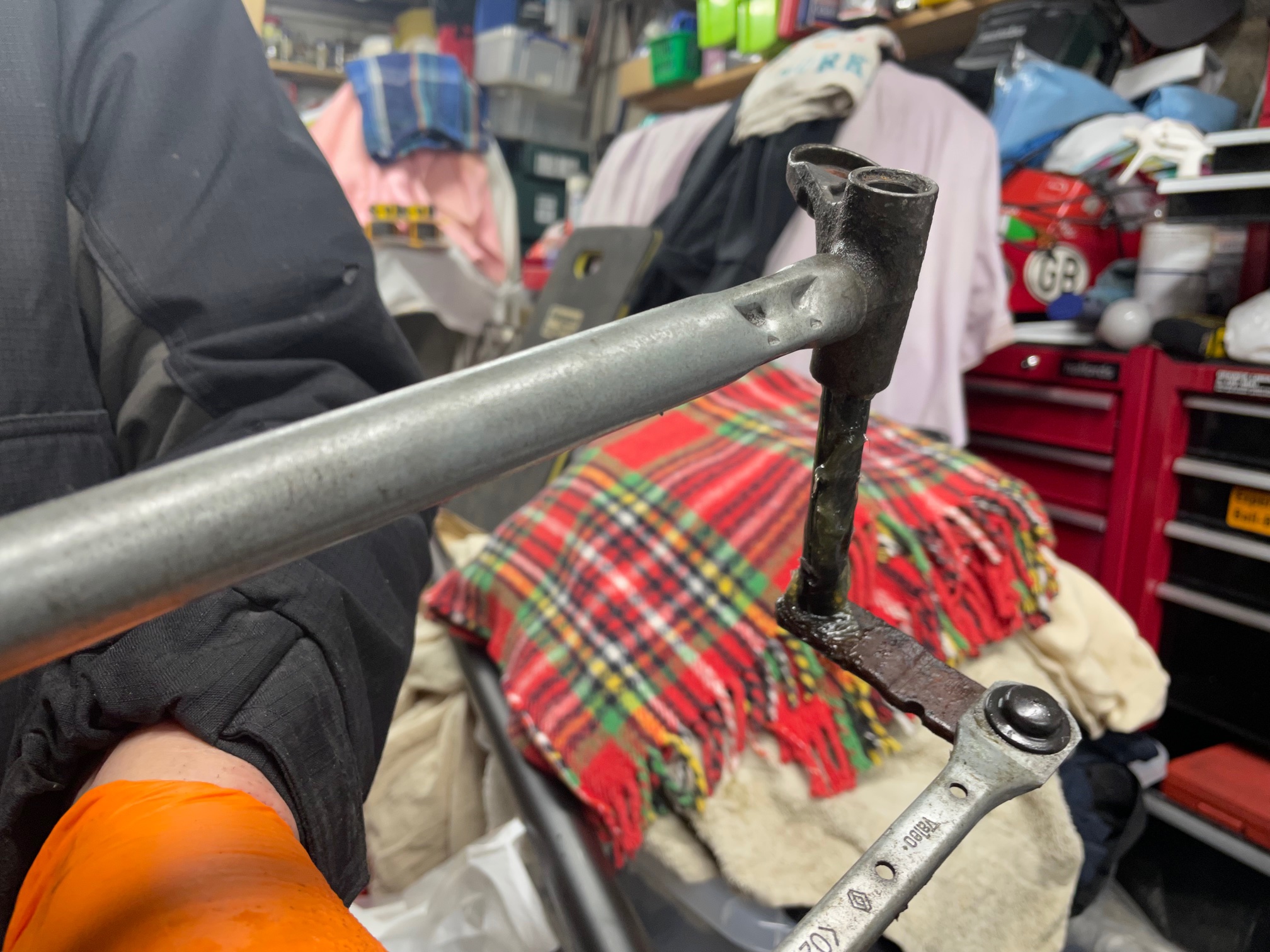

Got back home around 4pm, and took the linkage off.
It was a bit mucky under there but not too bad:
We managed to dismantle the linkage, clean up and relube, before re assembling:
The sense of relief when it finally came apart was much welcomed, the right side was so so bad, but went back together lovely.

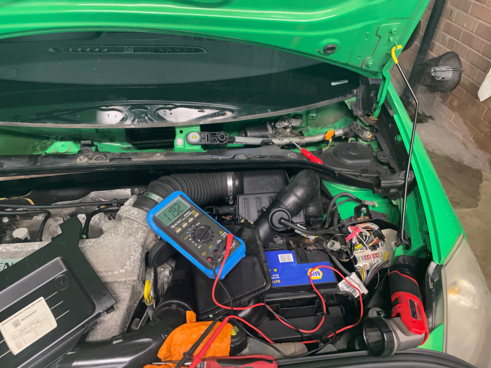

Unfortunately, on the way home we seem to have blown the motor, a bit of diagnostics work by myself is showing us getting the high signals as you would expect so I was pretty sure it's just a motor issue:
@Yorkshire Pudding also recommended whacking the motor and that did spring it into life, for a few minutes, then it died.
So tomorrow I'll go get a motor and fit it all back, hopefully it's going to be fine then. But what an unexpected polava, could have done without this tbh, not the first part of my ownership project that I was expecting.

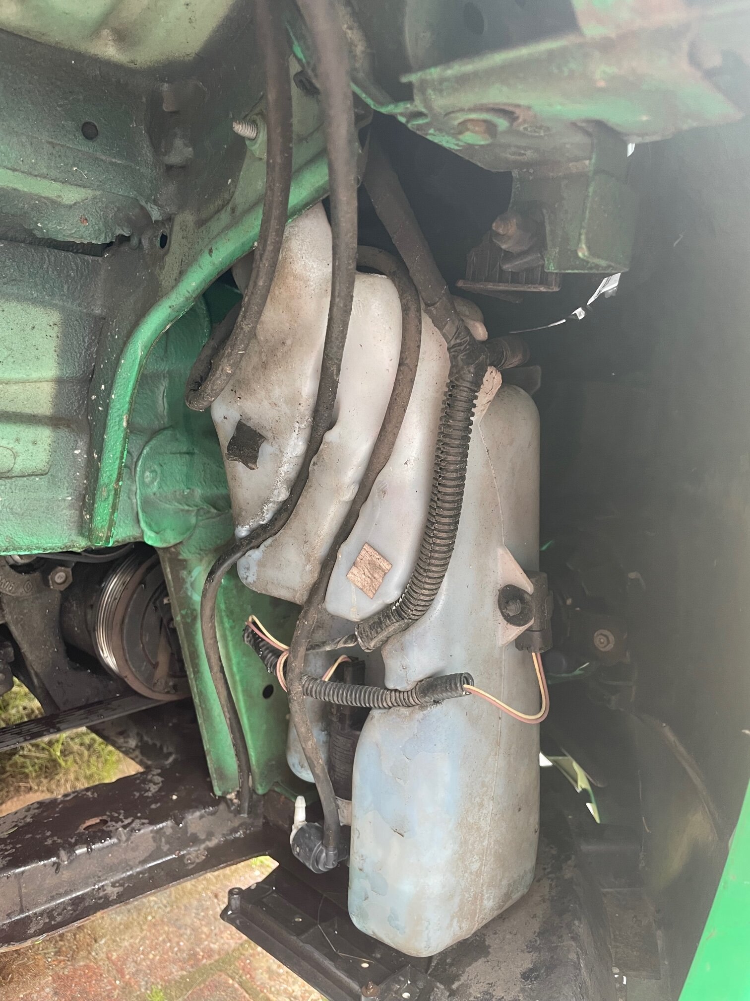

@jenic looking at the scuttle drain it looks like there has been water ingress from previous.
Check the rubber bungs either side and get a hose down there and get the drain holes cleaned.

Cheers, will check that out tomorrow too!

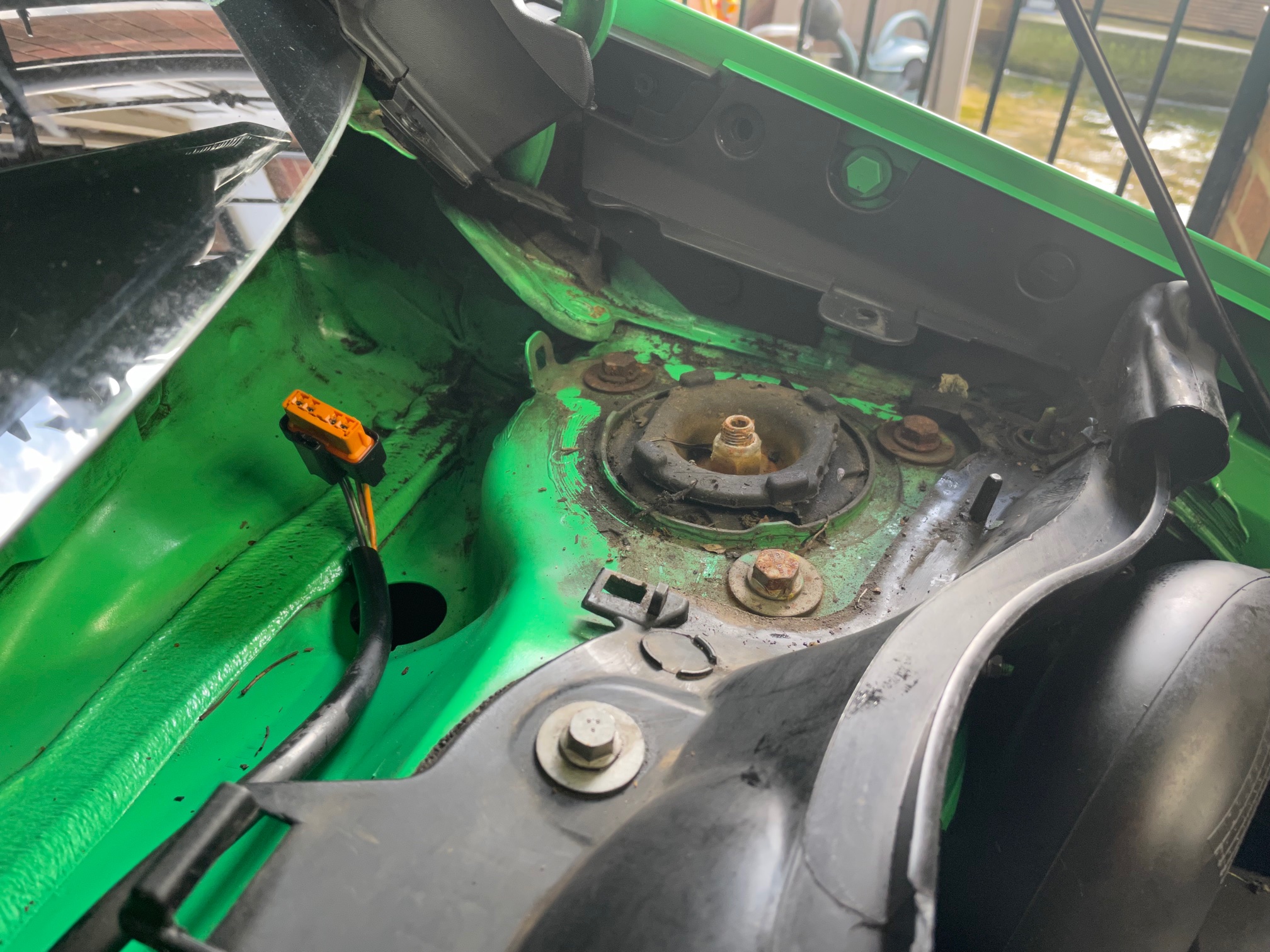

Had a pretty busy day today, after a trip to the gym because I'm some sort of mentalist that doesn't like rest, I nipped to euros and bought the massively overpriced motor.
Gave the whole area a good clean and tried to grease up bits we could (strut tops bolts etc) and then installed the new motor and refurbished linkage.
Manky strut top:
All cleaned and fitted:
Someone has been in here before, the rubbers on the drain holes were missing, but it's been suggested these are best removed anyway!
Then we put the trim back and tested the wipers, a bit slow to start tbh but using a hose pipe to keep the screen wet the linkages seemed to work the grease around and it now is behaving as good as you would expect a clio to behave.

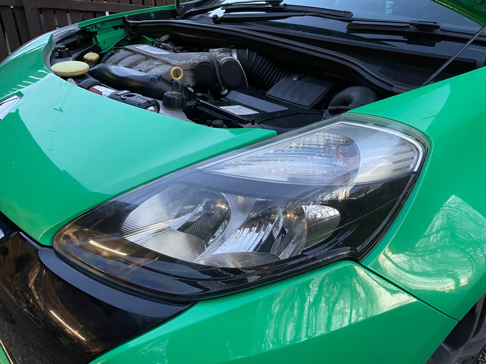

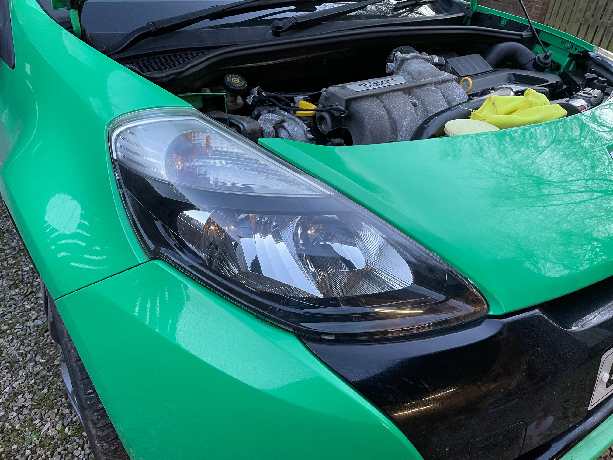

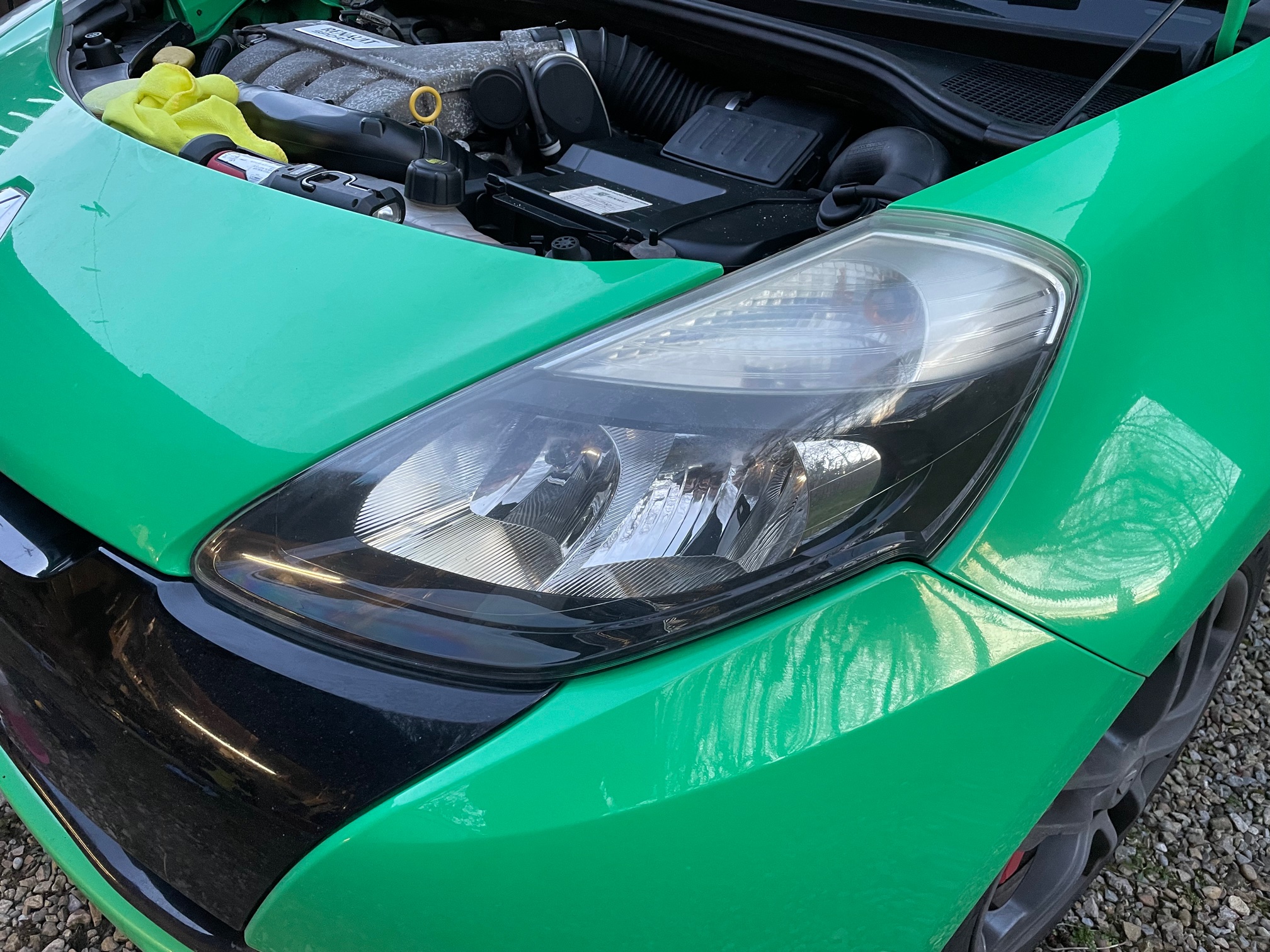

Then this afternoon I decided to tackle a couple of small jobs, first of all the headlights, they were faded particularly at the top so I had a go on them with this stuff I got given by a friend a few years ago:
It works surprisingly well, saves going for a full sand down refurb which I'm a bit scared I'll mess up.
Here is the half way point, drivers side almost done, passenger side not touched.
Drivers side done for now:
Passenger side before, it's mostly the top that's bad:
Passenger side after:
I'm really happy with the result for less than an hours effort, they could be better but for now it's a massive improvement.

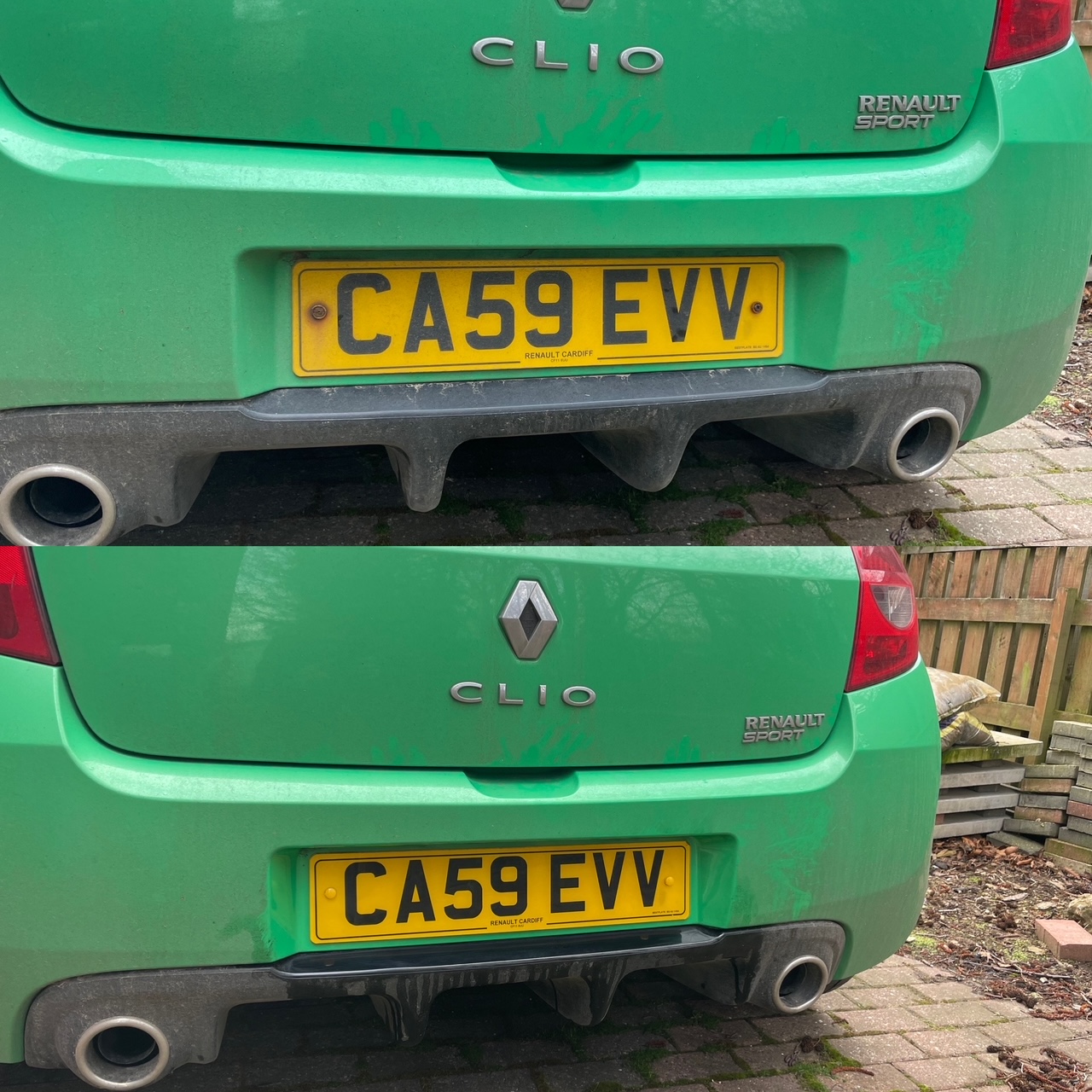

I also took the plate off, if you look at an earlier picture it's a mess, gave it a good clean and replaced the screws. I'm keen to keep the plates as they are the original supplying dealer ones. It came up well:

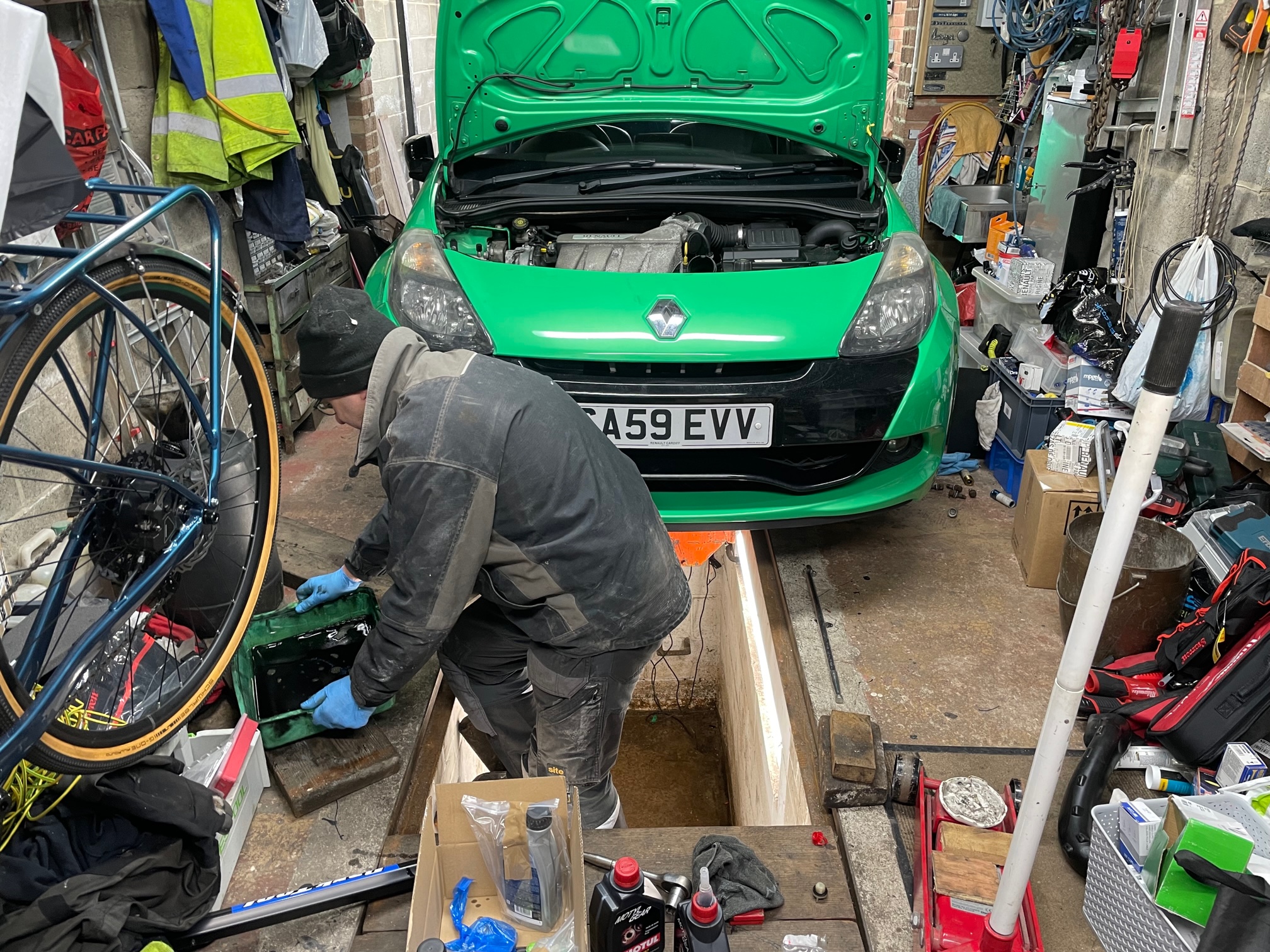

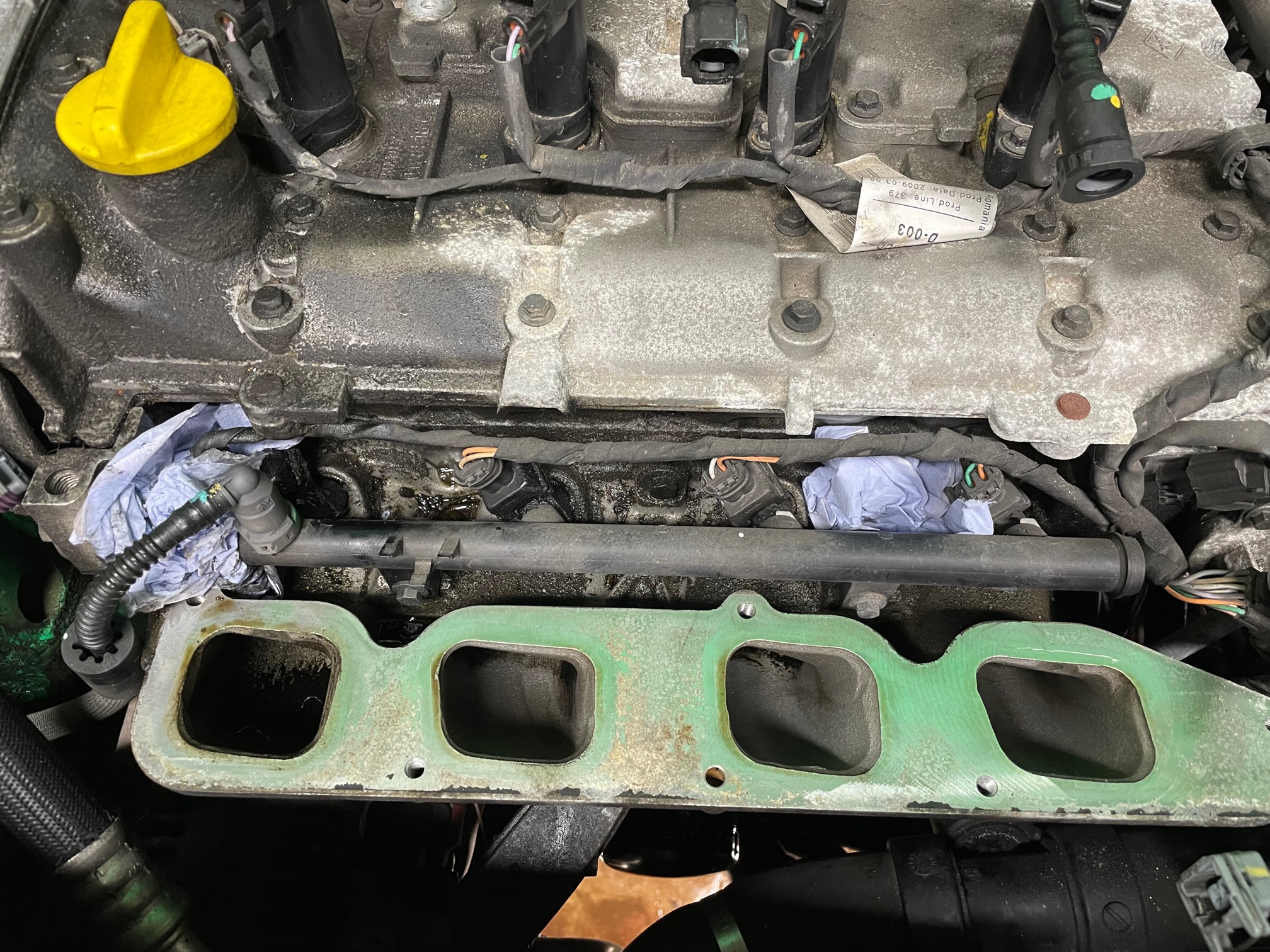

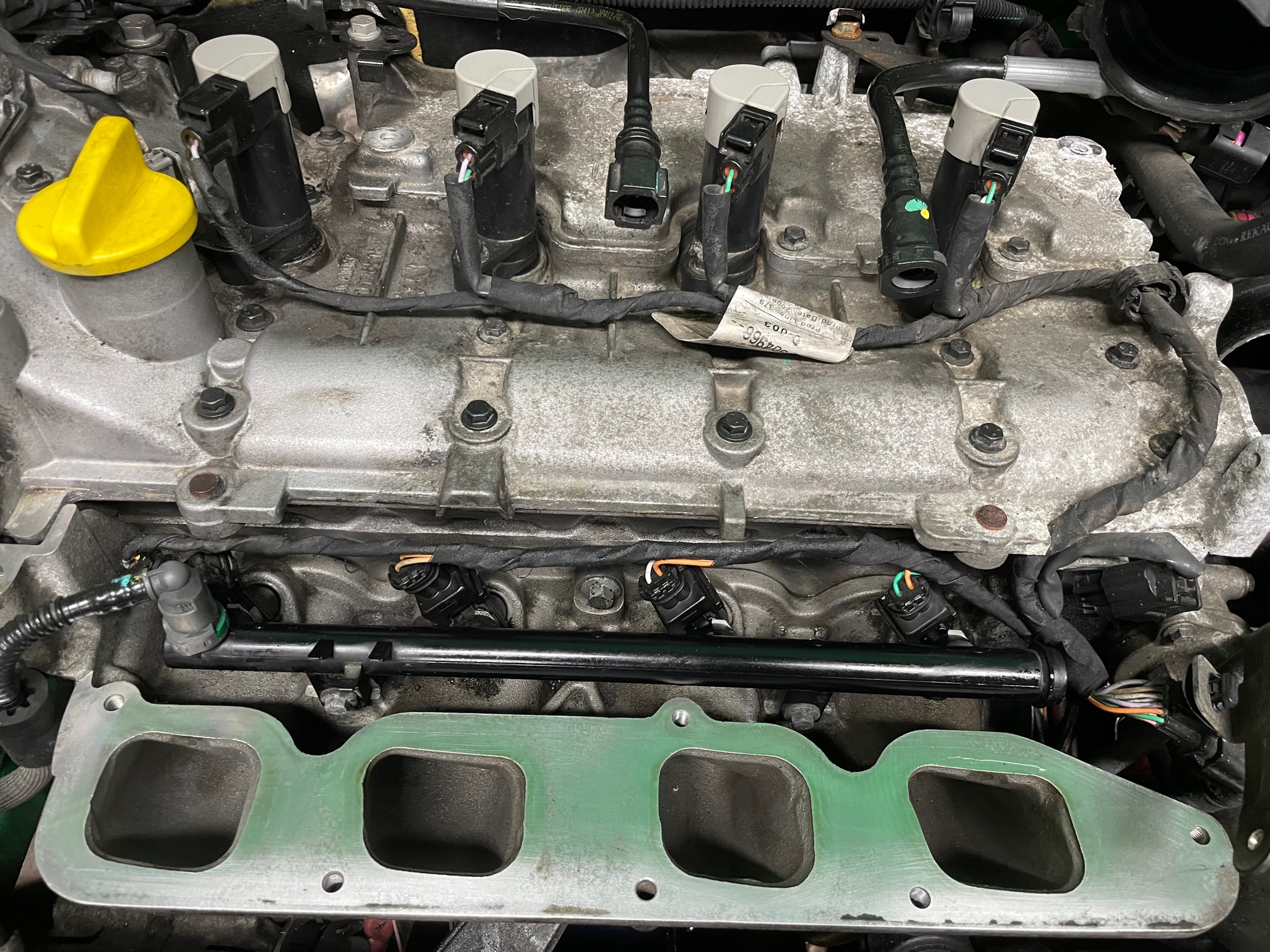

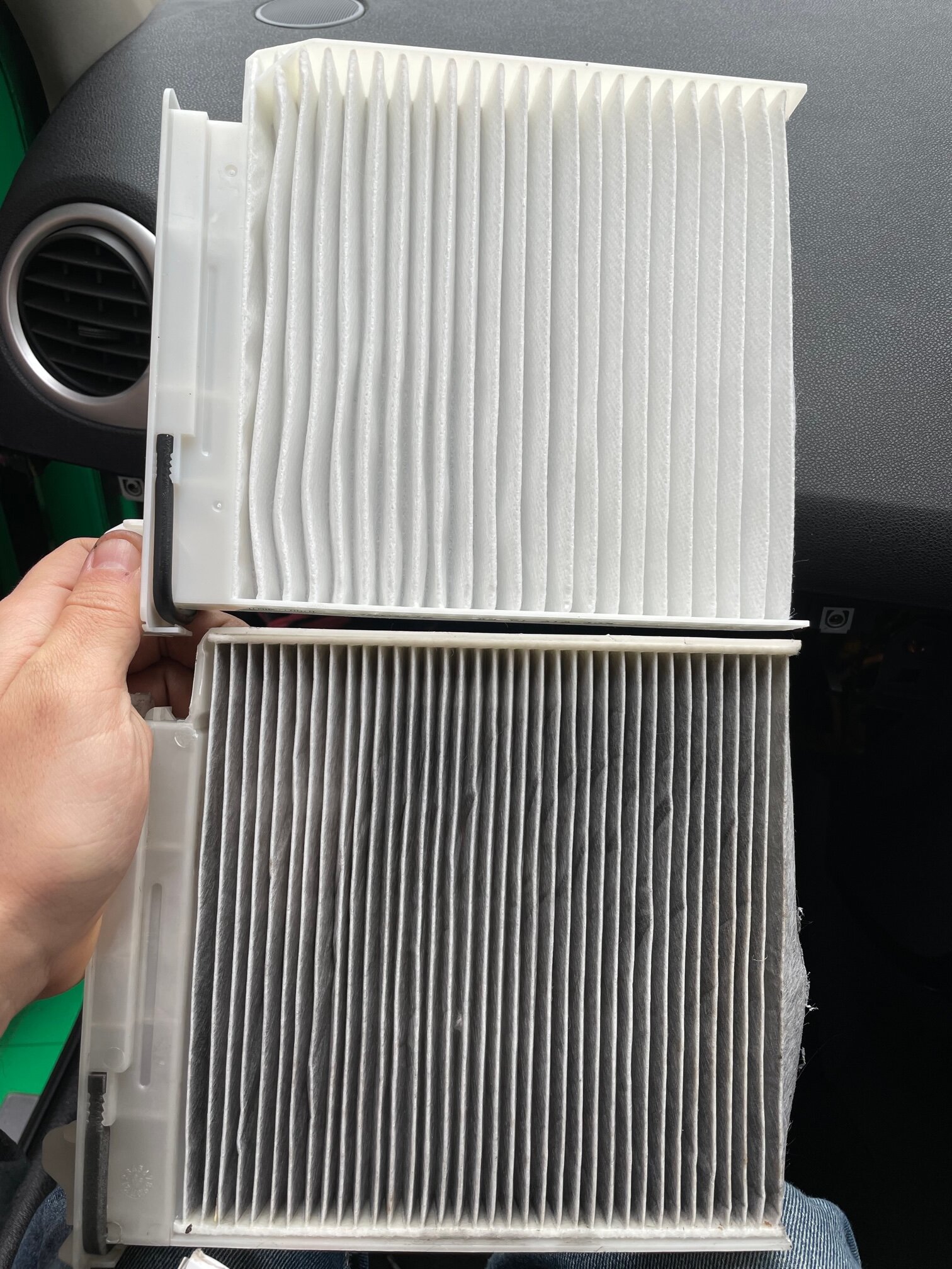

Went to my uncles to use the pit, did a full service (air/cabin/oil/GB oil/plugs), check out the state of the GB oil in the pic below 🤮

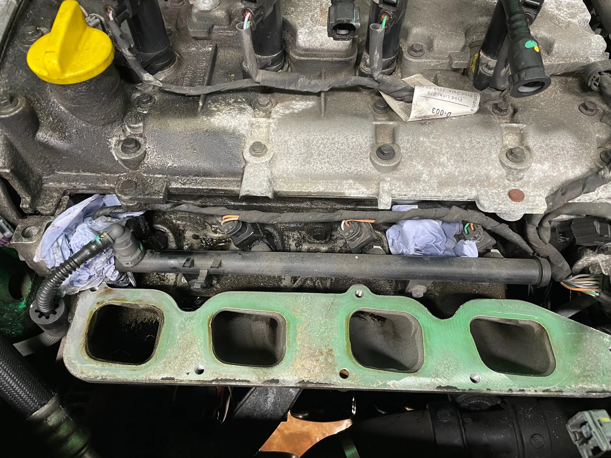

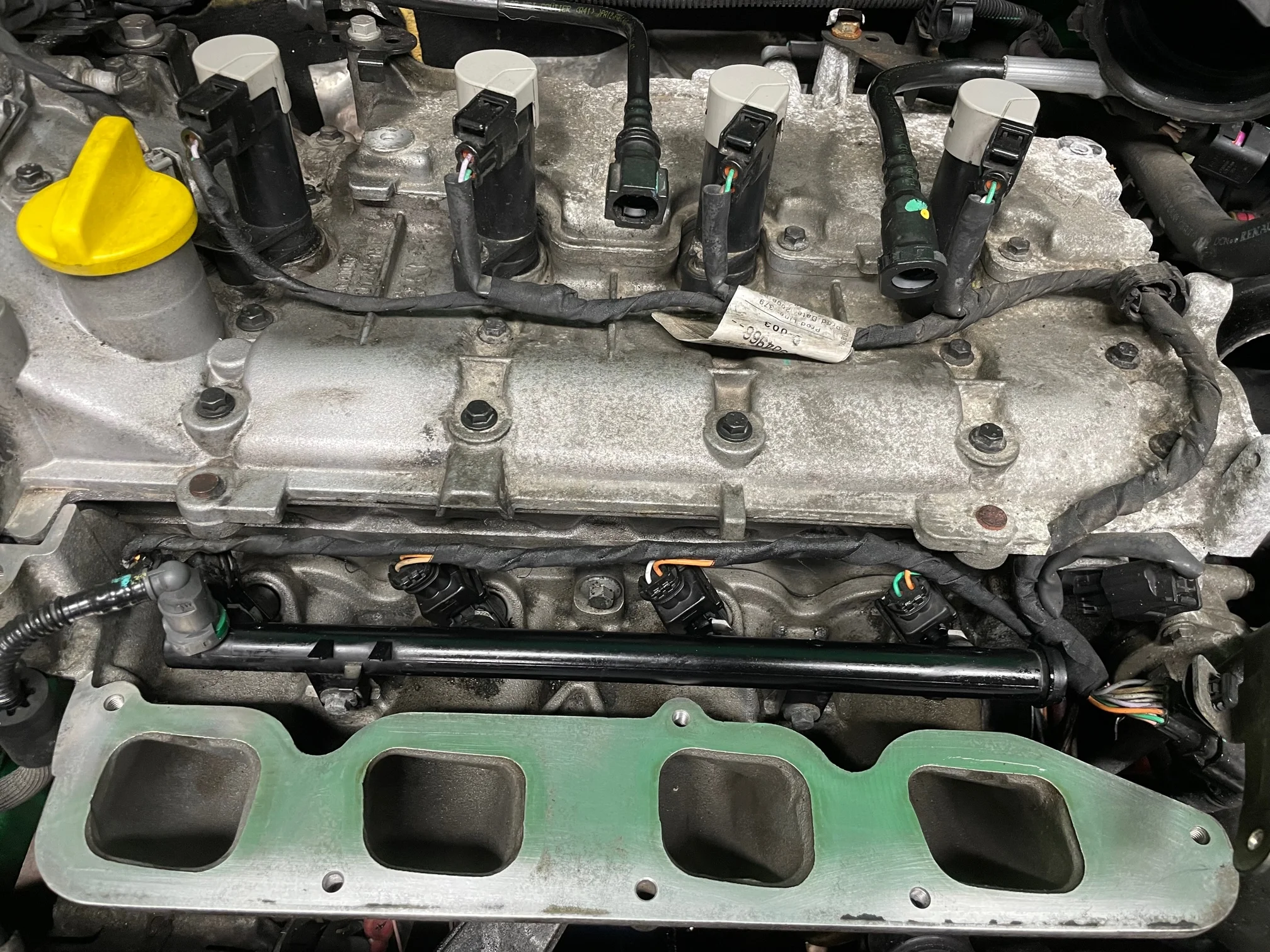

Took the inlet mani off and gave it a little clean up too, could do with doing a better job at a later date and take the lower half off too.
Mid clean:
After (for now):

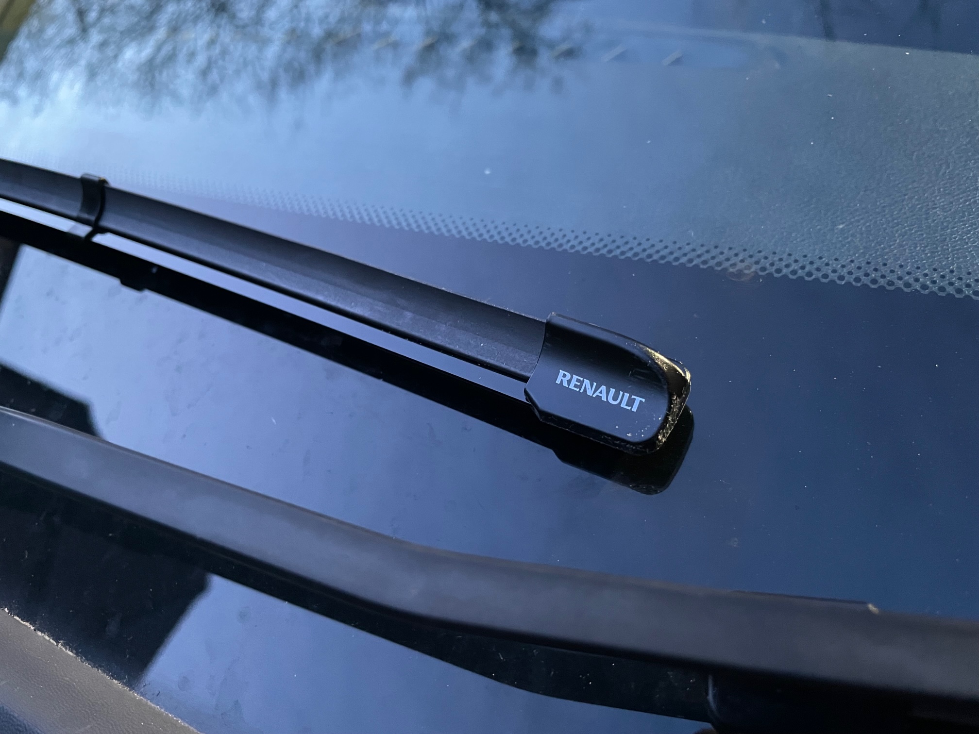

New wipers too, this has made a massive difference, they wipe so much better than the Bosch ones they replace, and they look nicer too:

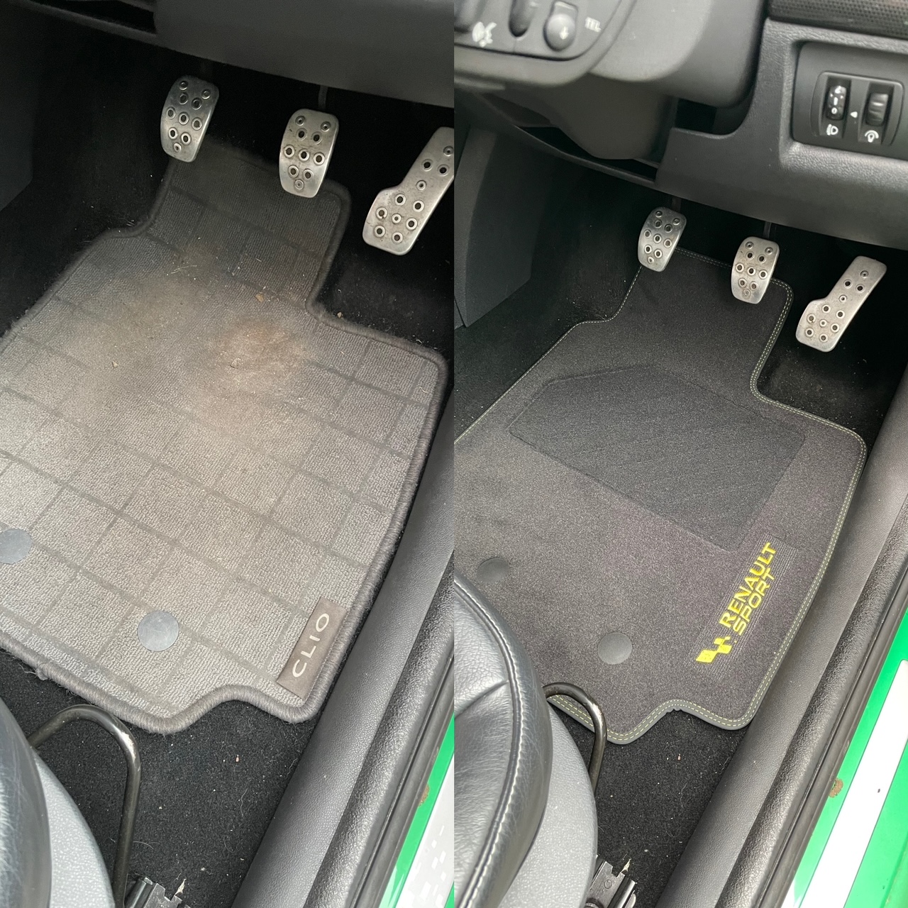

New mats too, the old ones were original, but horrible:

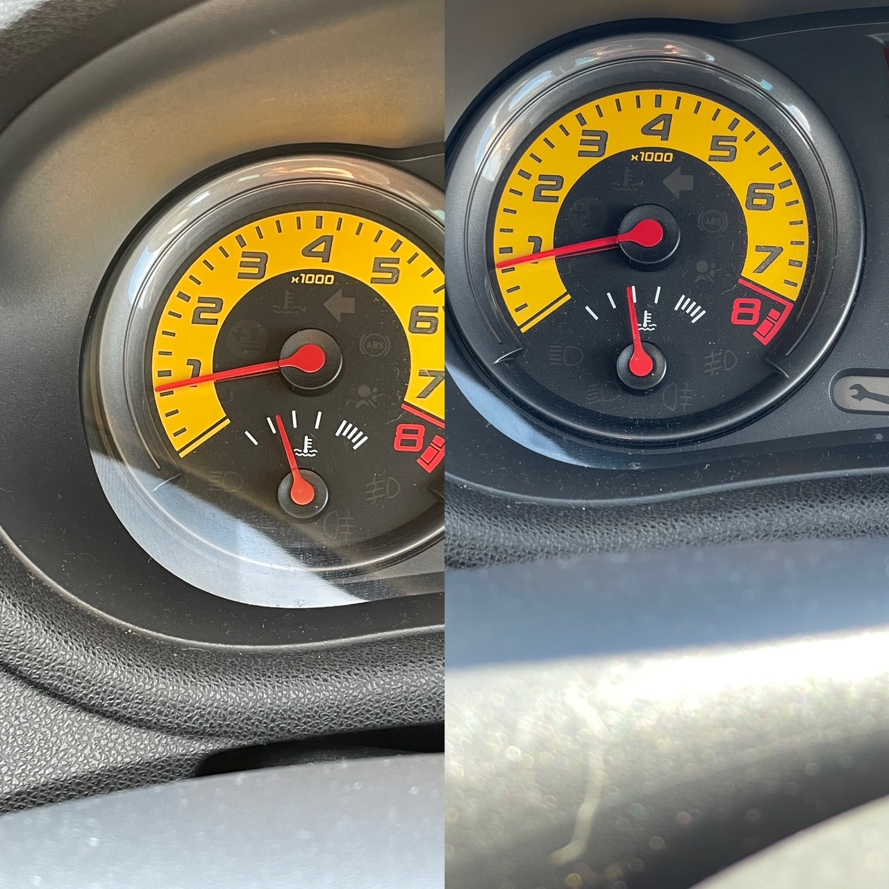

Changed the stat, it now warms up to where it should be, before and after:

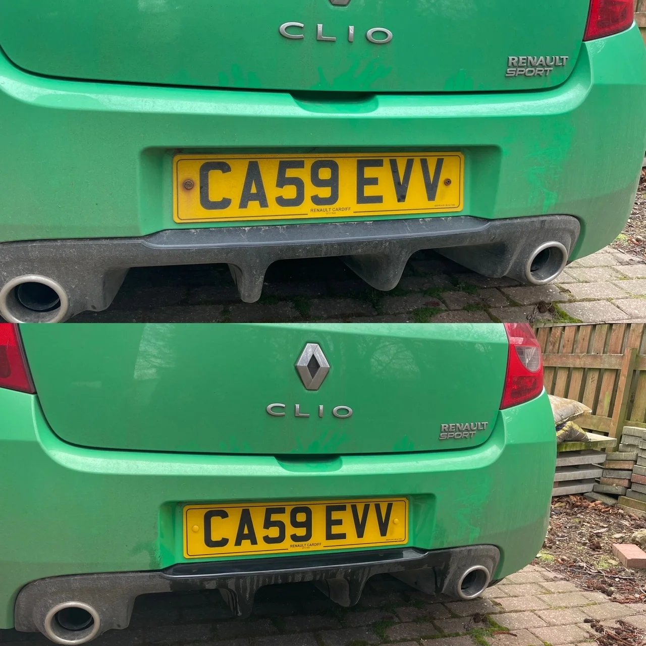

Also cleaned up the rear plates and fitted new bolts:

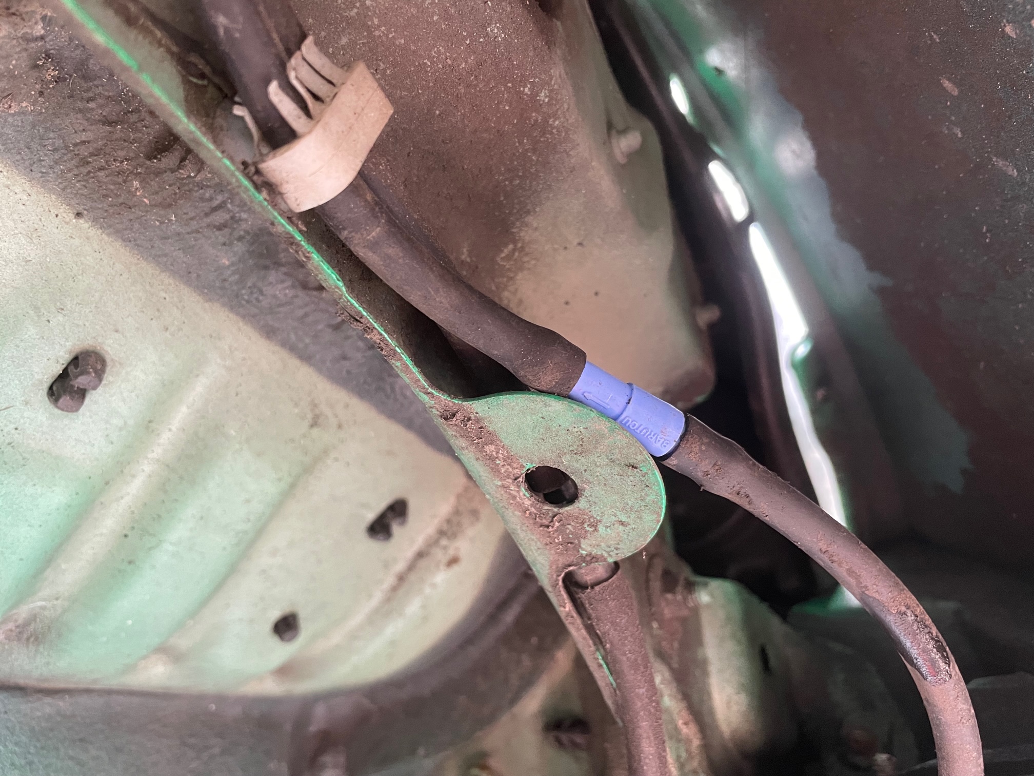

I also repaired the rear washer, the pipe had split under the arch liner so I had to pop to the motor factors for some bits to repair it, this meant I got a trip out in my uncle's Twizy which is fun!

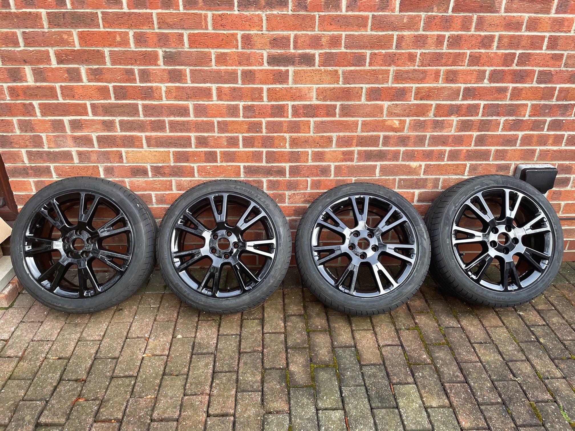

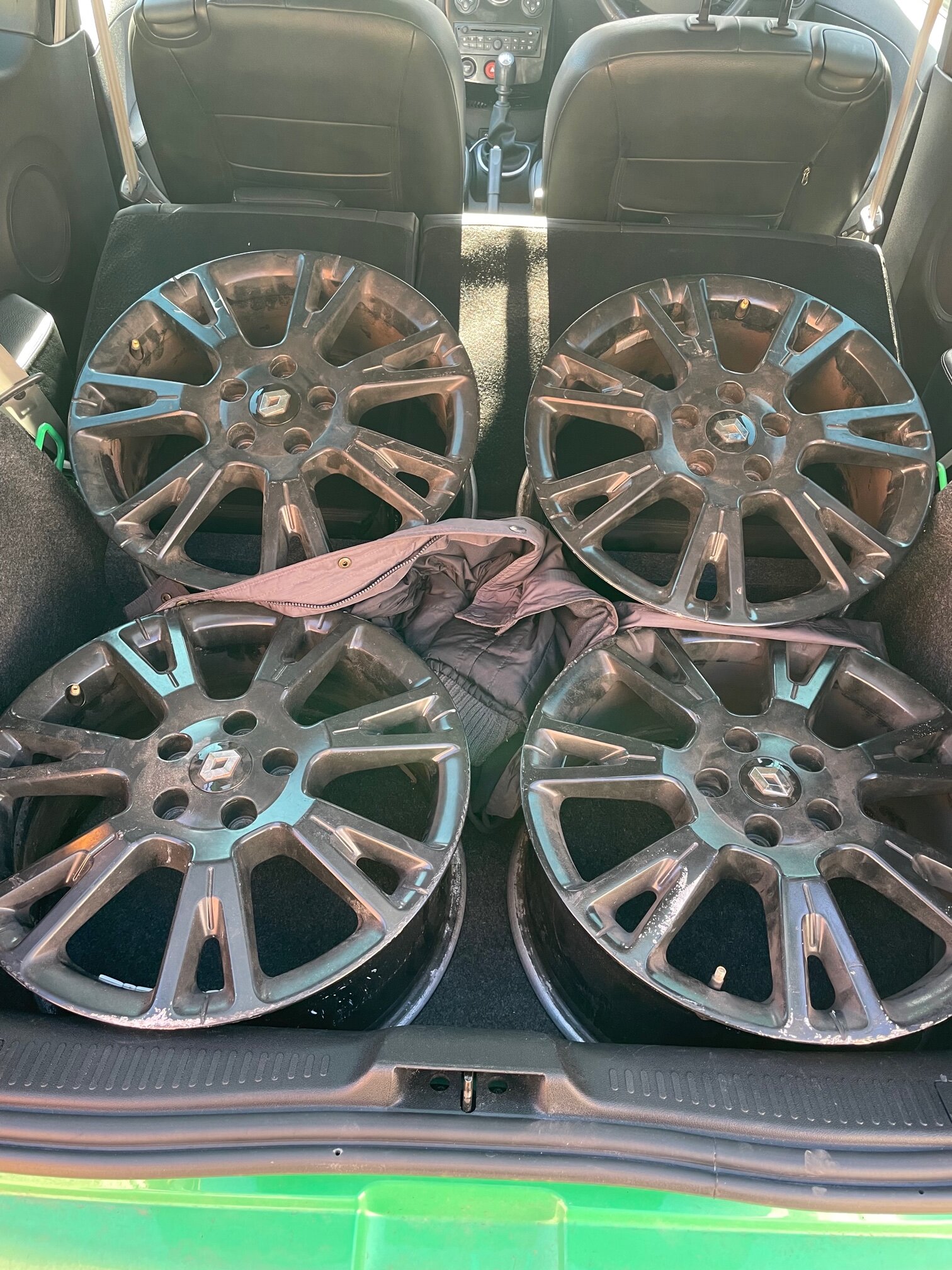

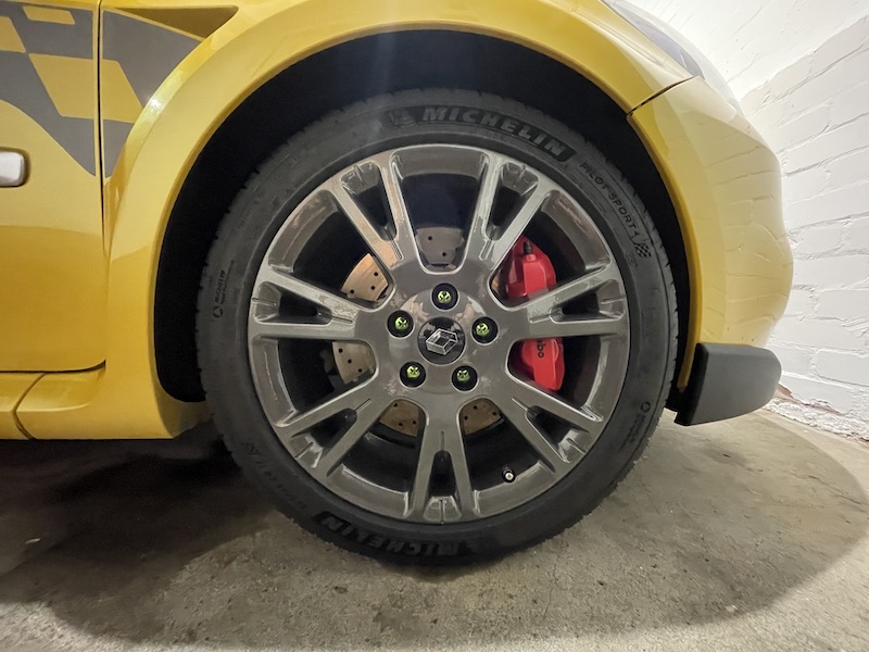

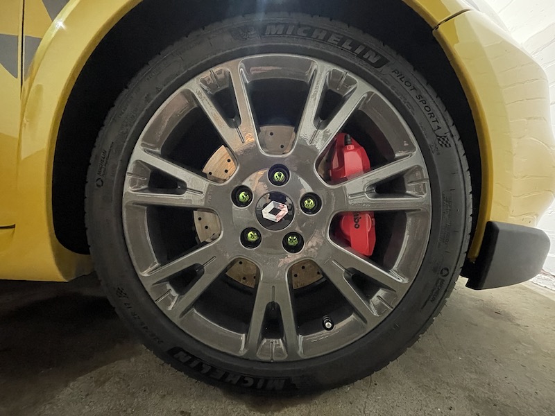

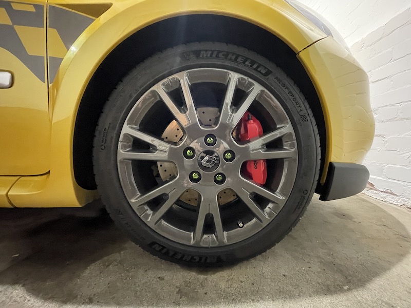

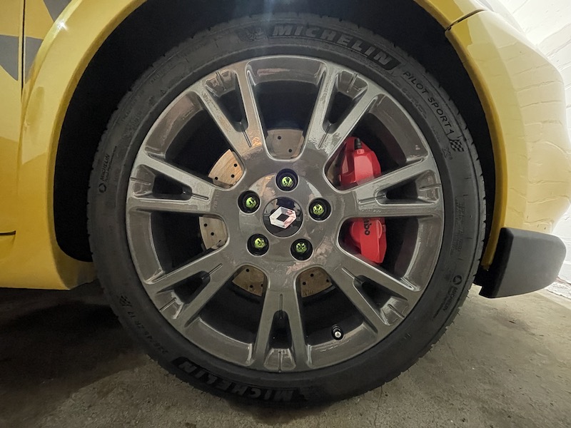

Got my wheels back on Tuesday, a lad in my village owns a tyre place to he took them to work for me to get the tyres put on. Also did a quick sealant on the alloys too, think my poorboys stuff is still at my parent's house so had to use some AG stuff I found in a gift pack.

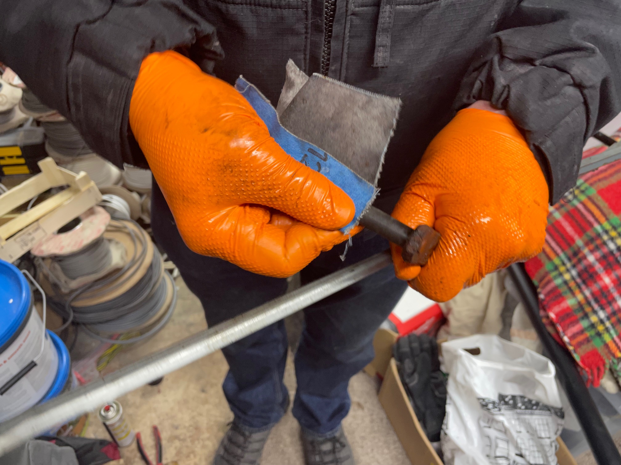

The bolts were pretty rusty looking so I gave them a quick wire brush and spray with some galvanising paint, probably won't last but it's better than rusty looking for now
Gave the arches a quick wipe over, the paint started flaking off the caliper so gave up cleaning that for now :ROFLMAO:
Dirty:
Slightly less dirty:
Fitted:
I much prefer the look to the stock cup wheels, might even wash the car this weekend. Wheel alignment is booked in for Tuesday too.

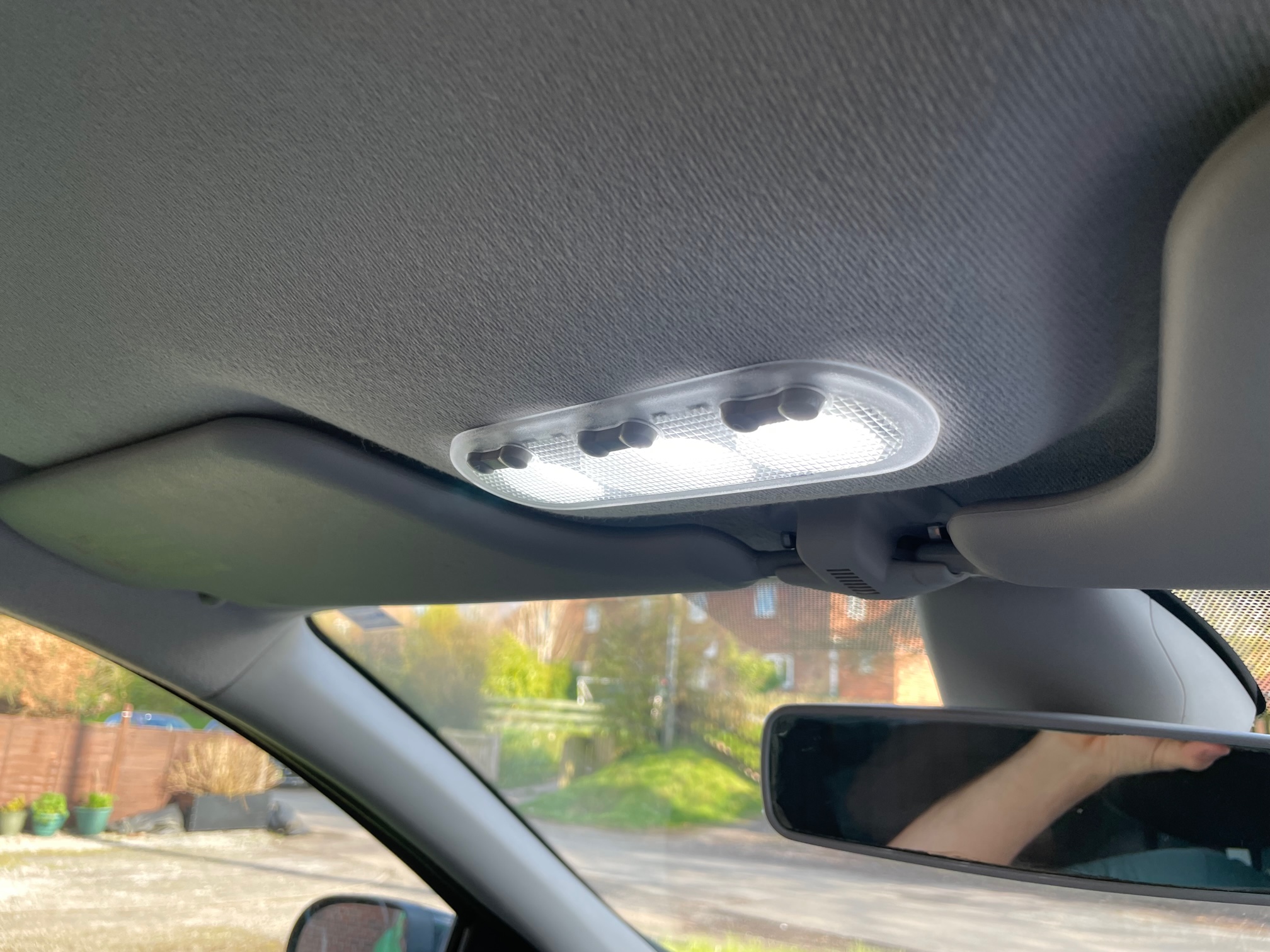

A couple of small updates, swapped out the interior bulbs for LED, bought the ones recommended on clio197:
Before:
After:
I did plan to do the number plate lights, but someone has broken one of the lens' in the past and glued it up. So I got some eBay special LED array ones, the fitment was terrible, had to Dremel it to get the original connector to fit.
This pic shows the LED array on the left and an LED bulb in the original fitting on the right, massive difference!

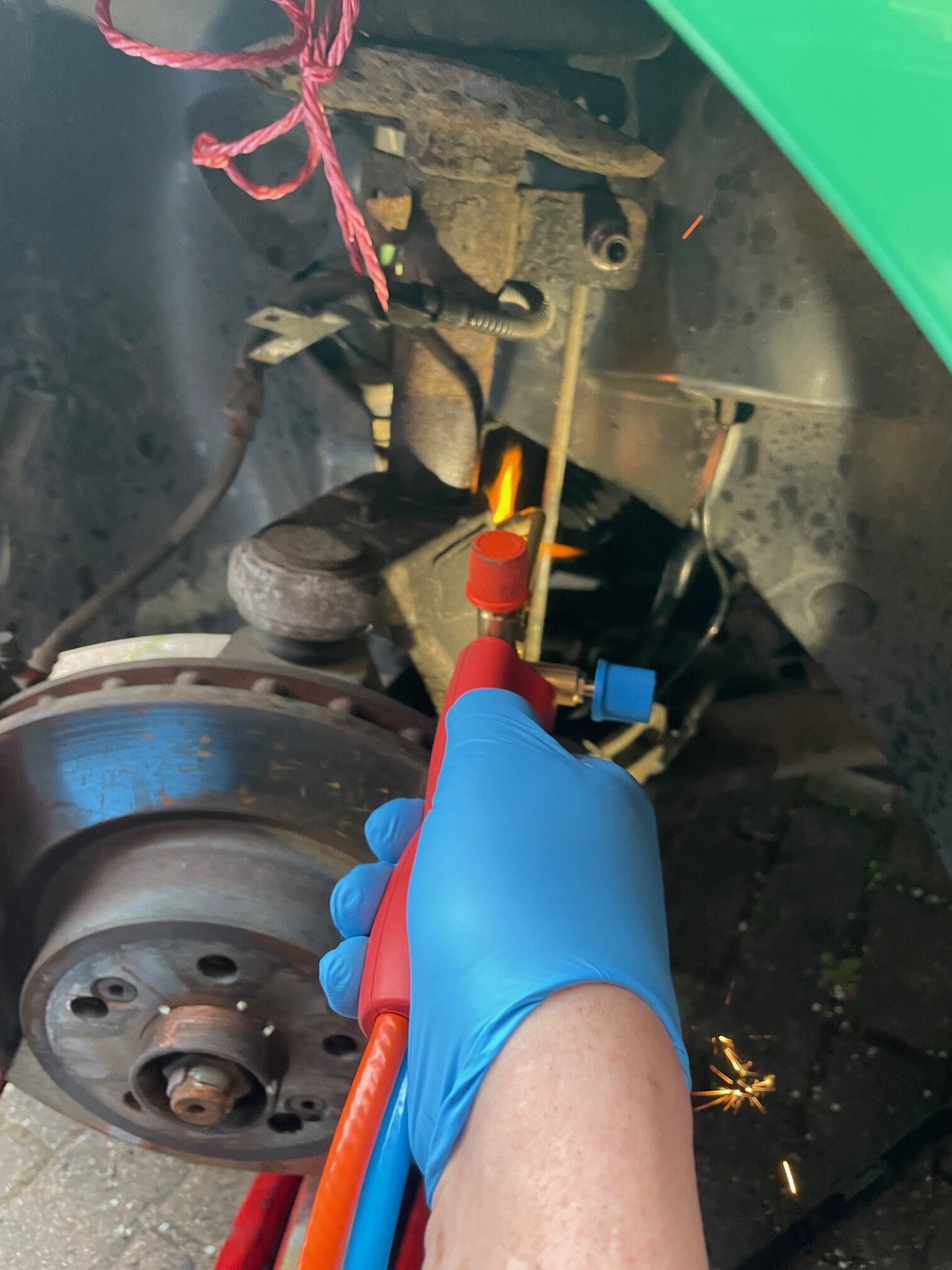

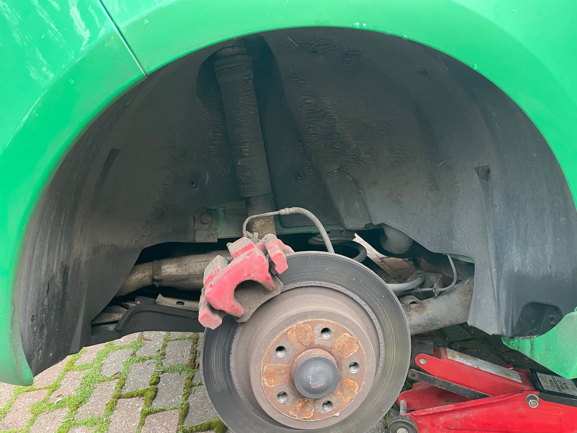

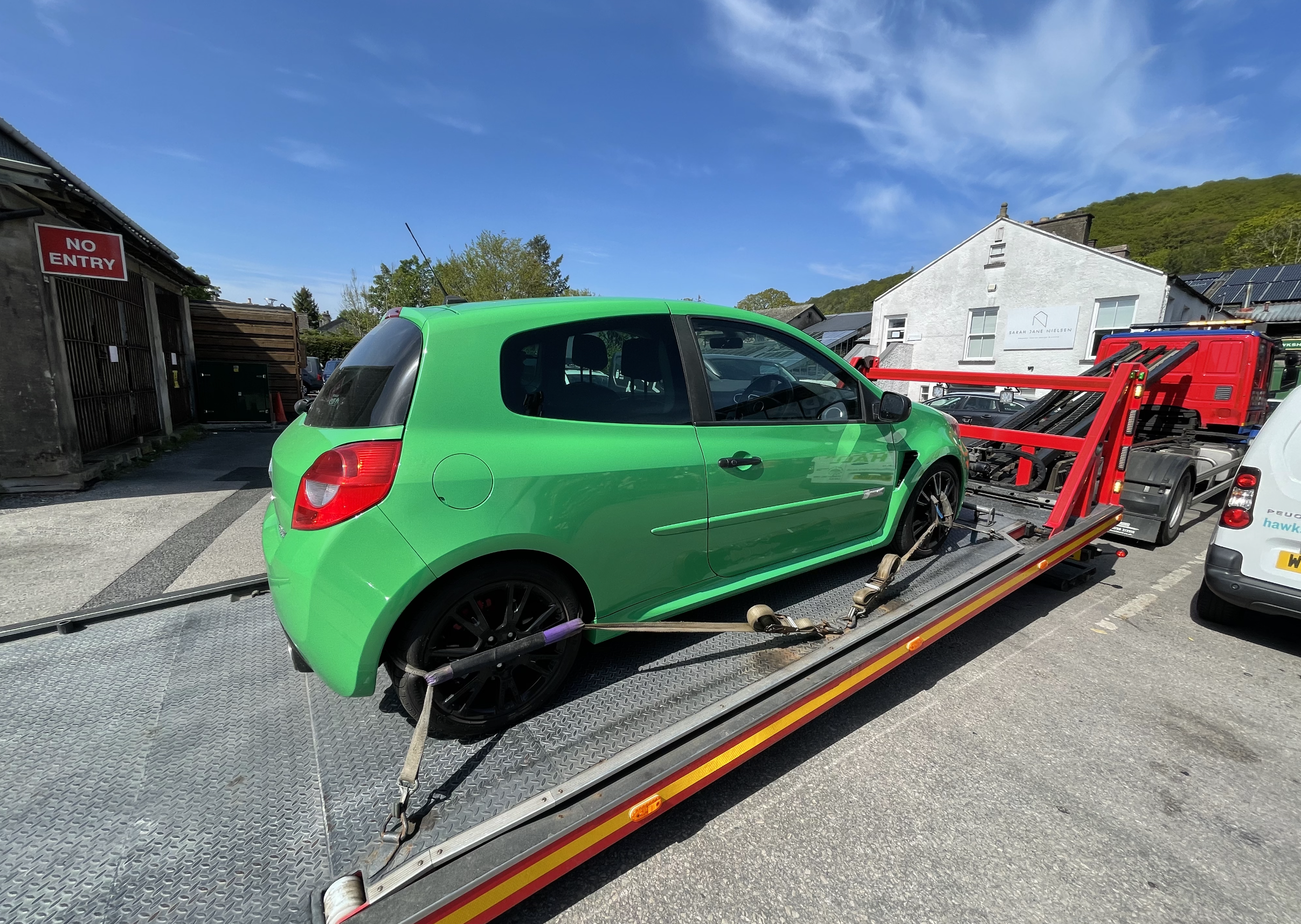

First proper breakdown.

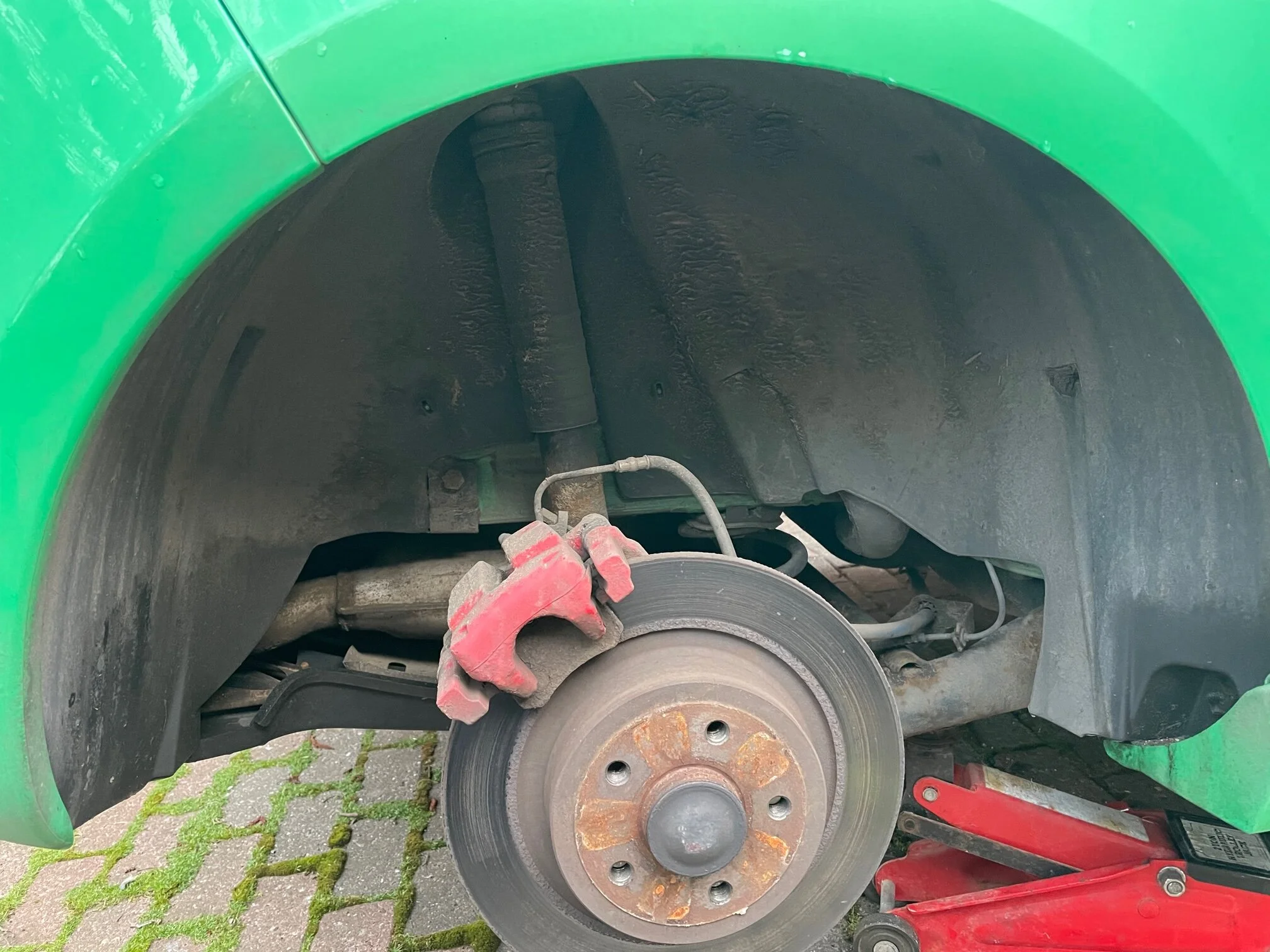

Having a couple of days up in the lakes, driving along and hit a pothole, heard a weird noise. Pulled over and the front spring carrier/base of shock is touching the tyre.
No idea whats failed, but now waiting for recovery to come and take me home.
It wouldn't be a clio thread without one of these pics, looking like a snapped spring, I'm now waiting at a services to be relayed home which is a bit s**t.
Don't think I'll have enough light today to start taking it apart so that's a job for tomorrow afternoon.
Seen that happen on a few Scenics and Kangoo's
Only ones stored on the middle shelf of the Pacific though🤣🤣
That's the thing, the rest of the car is really clean, no rust underneath or on any suspension/chassis components except the front shocks. A lot could have been replaced though, the front rad support has at some point.
The MK2 was so much better. Two shock bolt and bosh, shock came out.

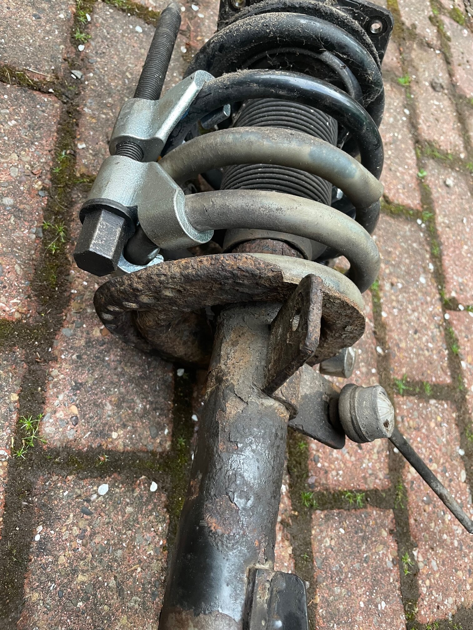

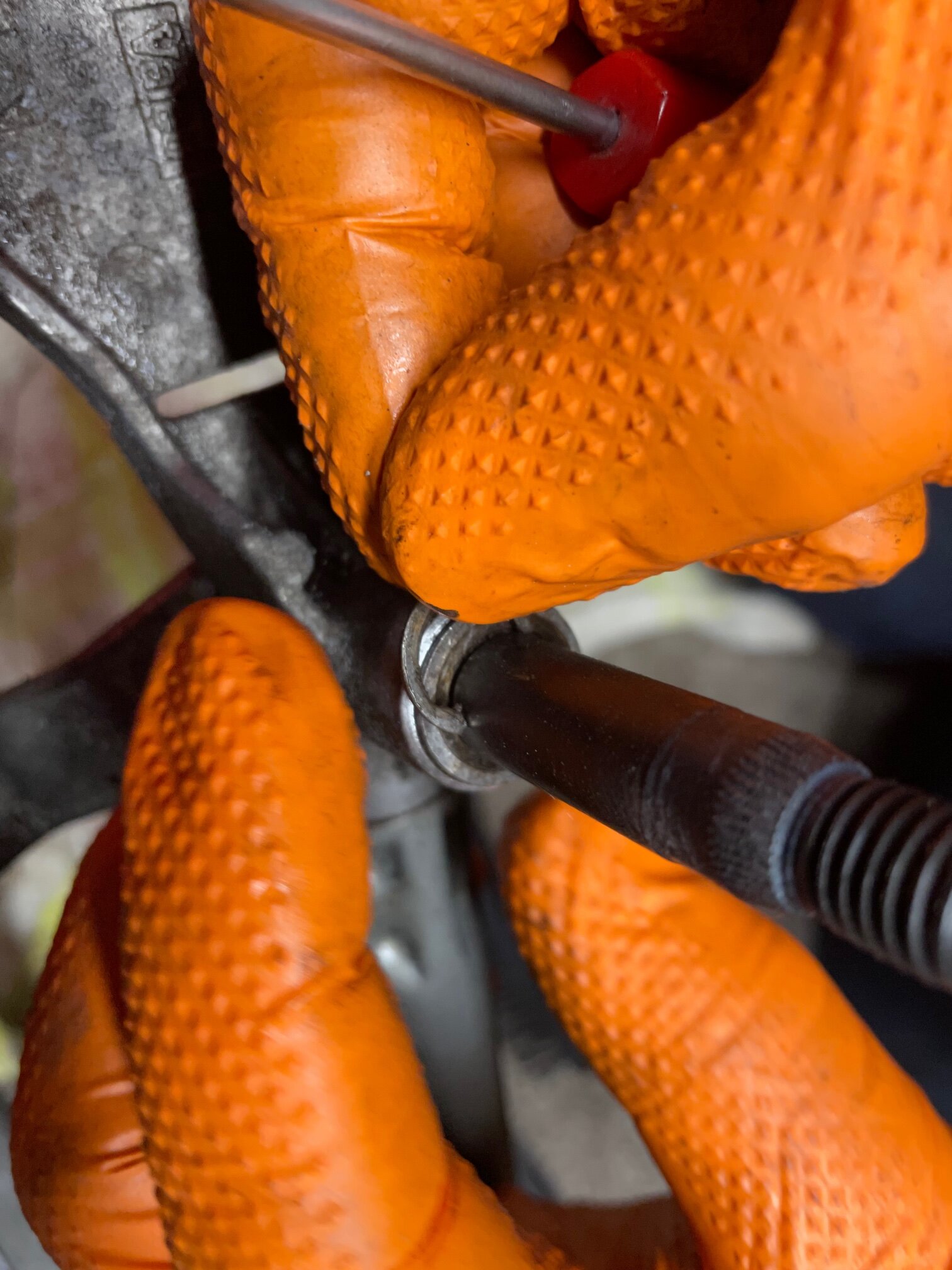

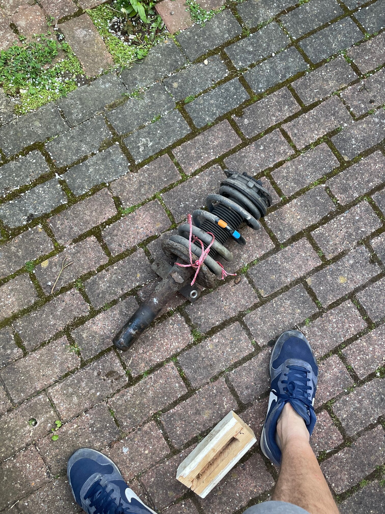

Onto the passenger side, pinch bolt nut came off easy, but the bolt was seized good, time for fire
The bolt is out, the shock is moving but it's way more seized than the other side. Stopped for the evening now, might do some more tomorrow evening if I have time after work.

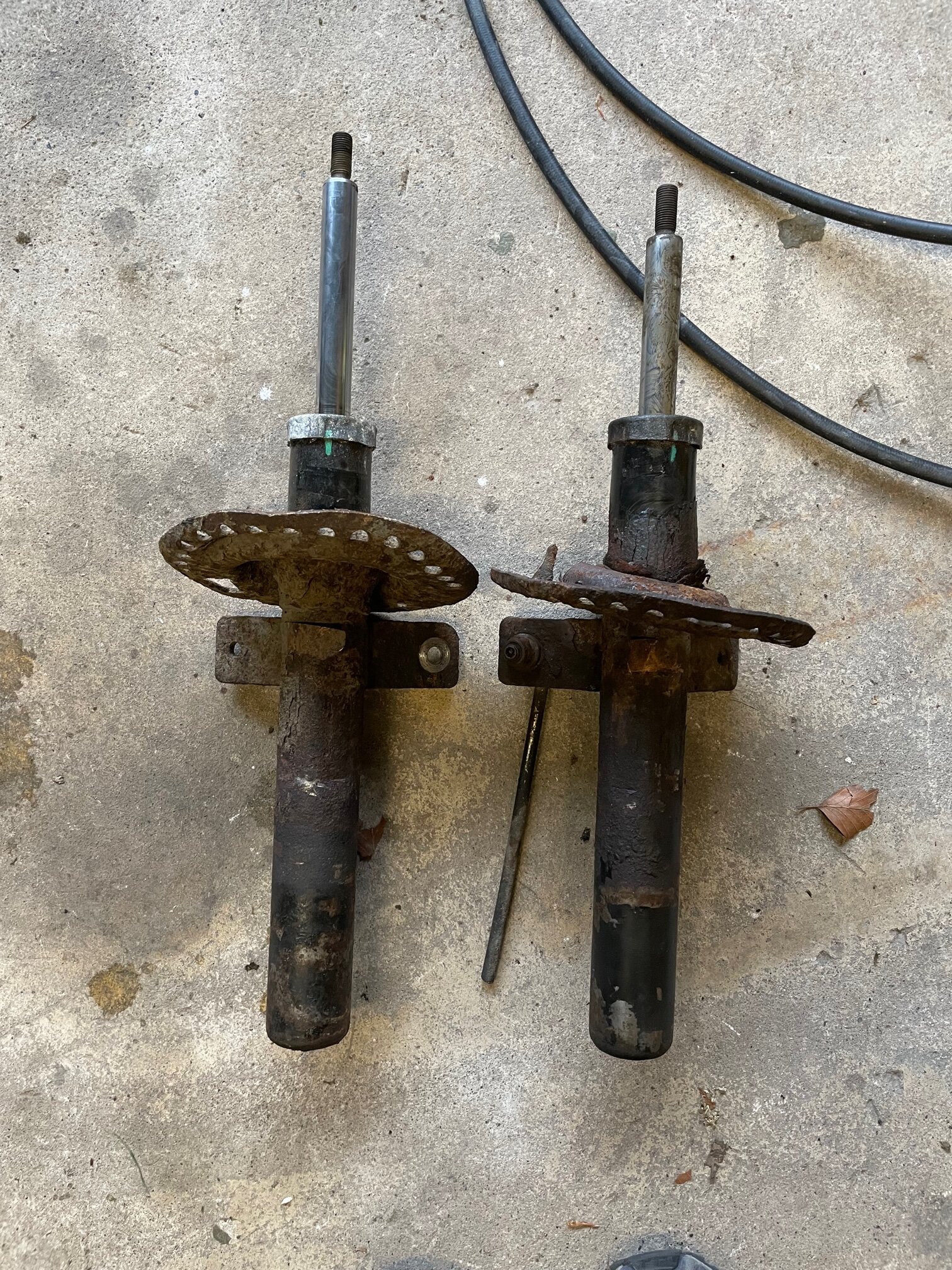

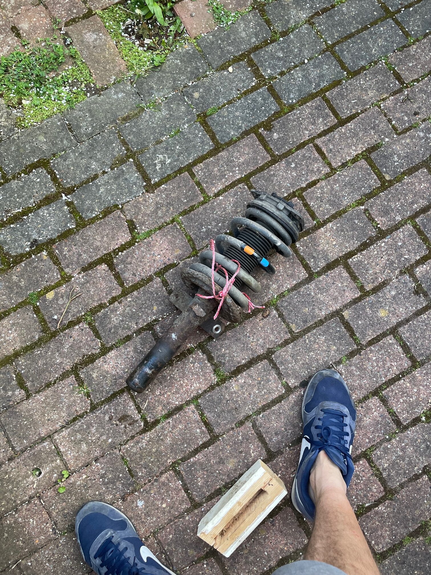

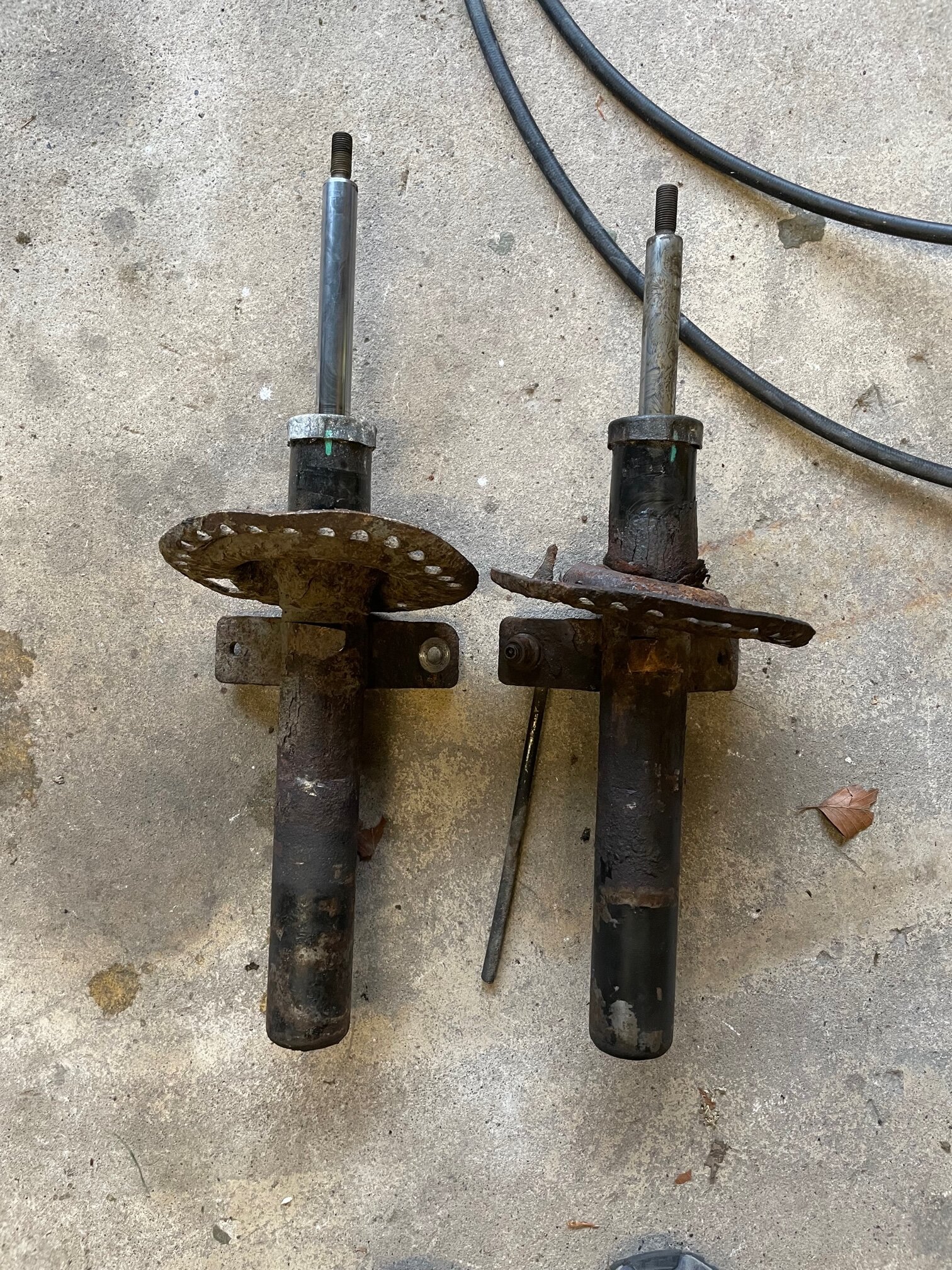

I bought a bigger hammer and broke loads of wood but got the b*****d out last night:
The 'good' one is only bent because it was also pretty corroded so I stuck it in a vice to see if It snapped when I whacked it with a hammer 😂
Springs and top mounts actually look decent, but I'm just replacing with all new, I don't want to have to do this job again.

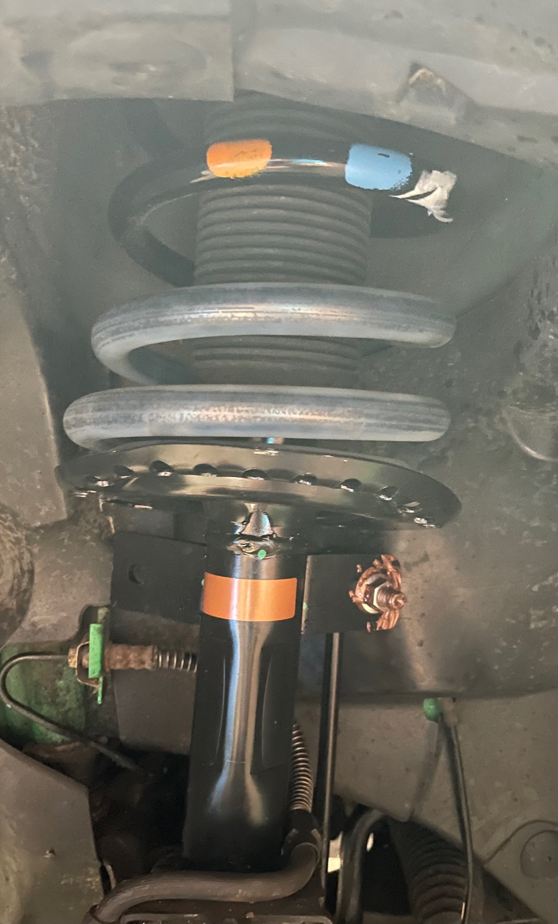

Got it all back together tonight, excuse the copper slip, I was being impatient with the brush. The only thing I need is new pinch bolts now, got some on order to collect in the morning and then it's done.
As always, hours to dismantle and minutes to put back together. Absolutely loving the new Milwaukee tools as well, spring compressors with an impact gun is life changing.
