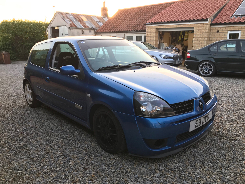

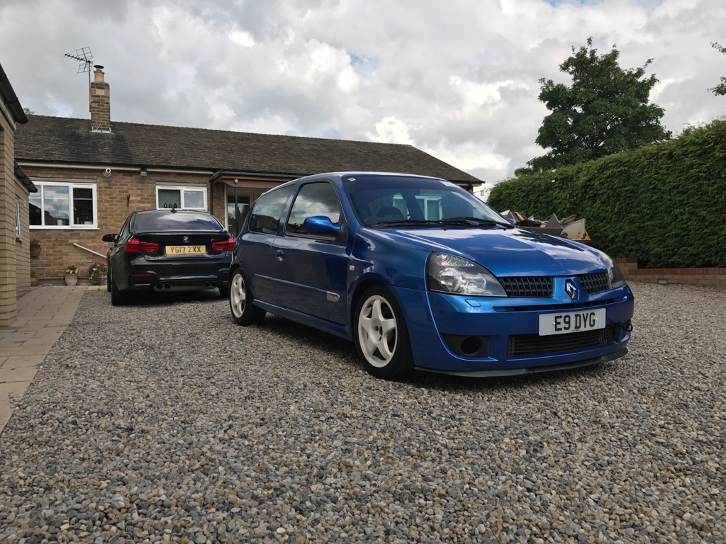

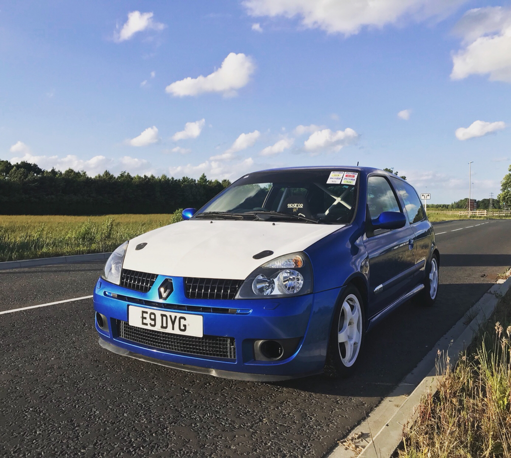

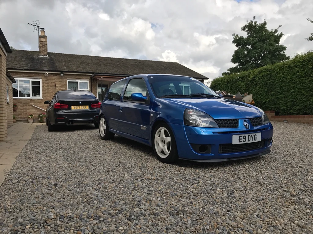

Pic of the Clio when I bought it from K.

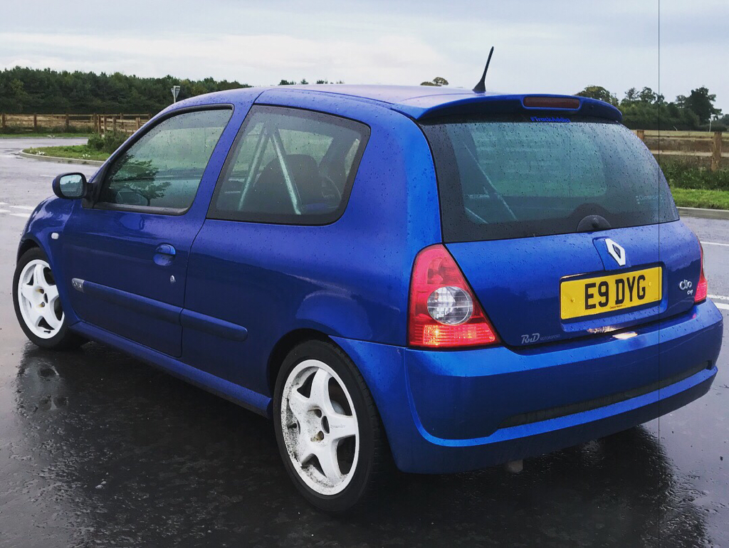

First track day in it at Blyton Park, was spot on & faultless all day.

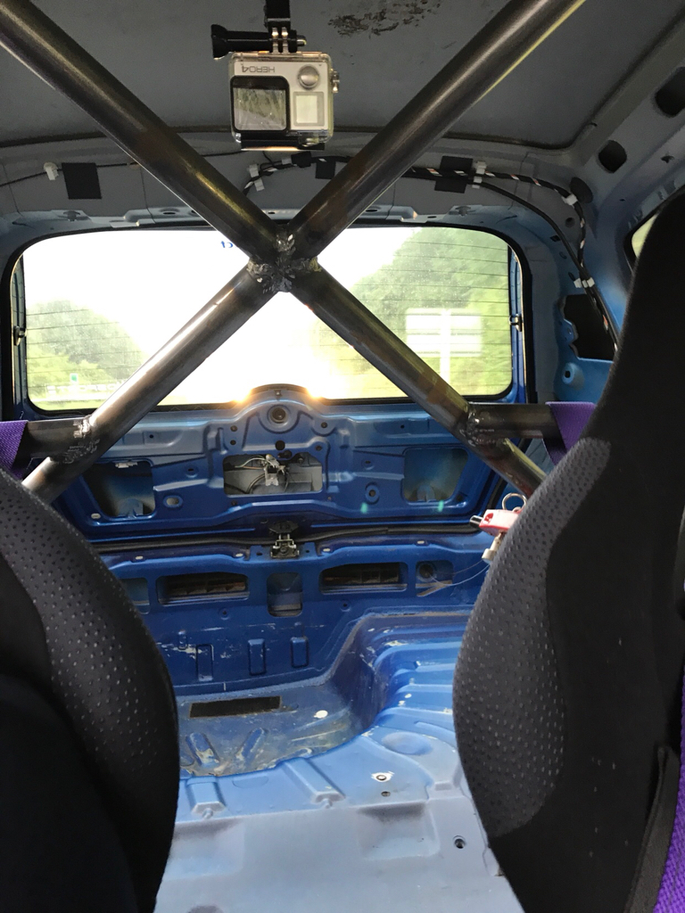

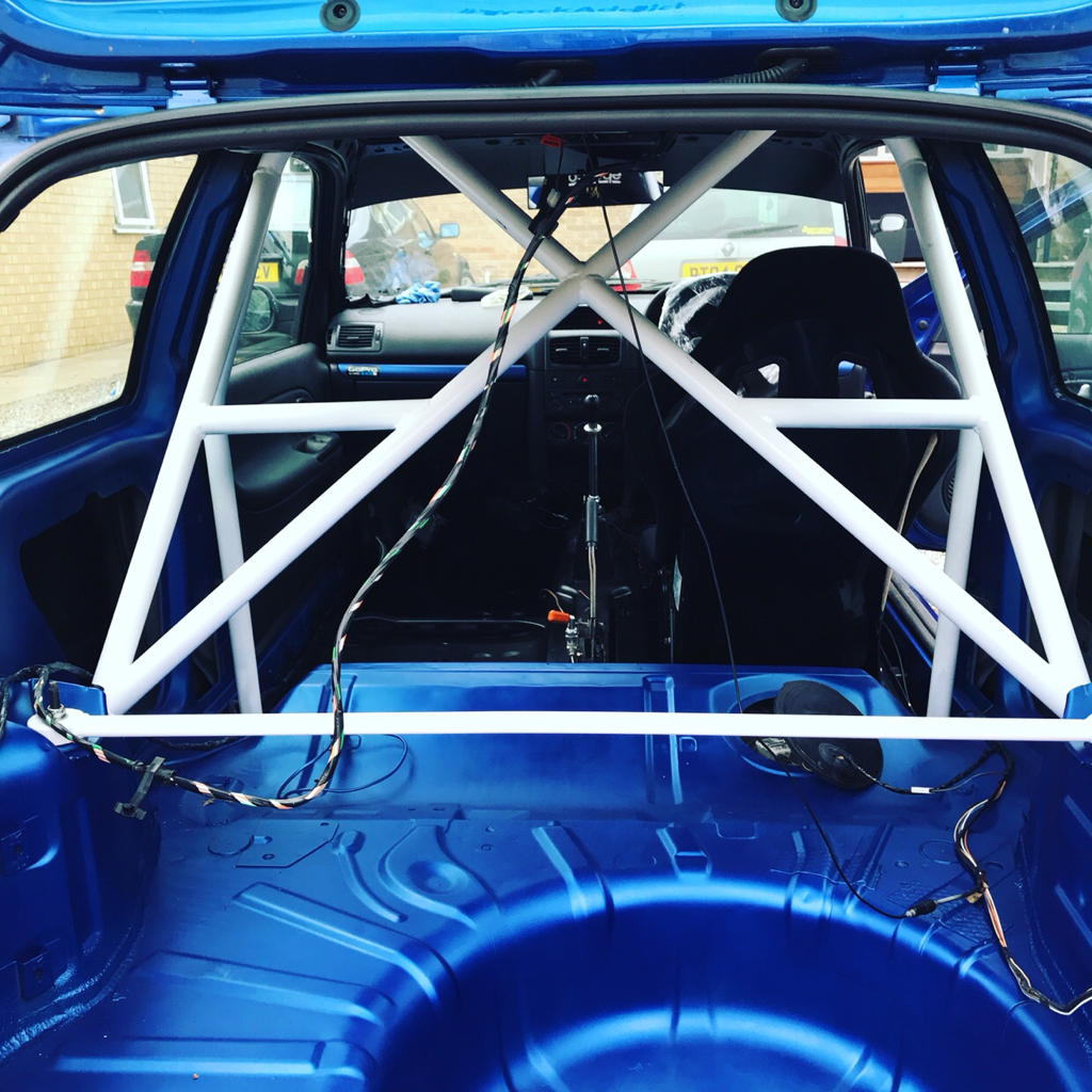

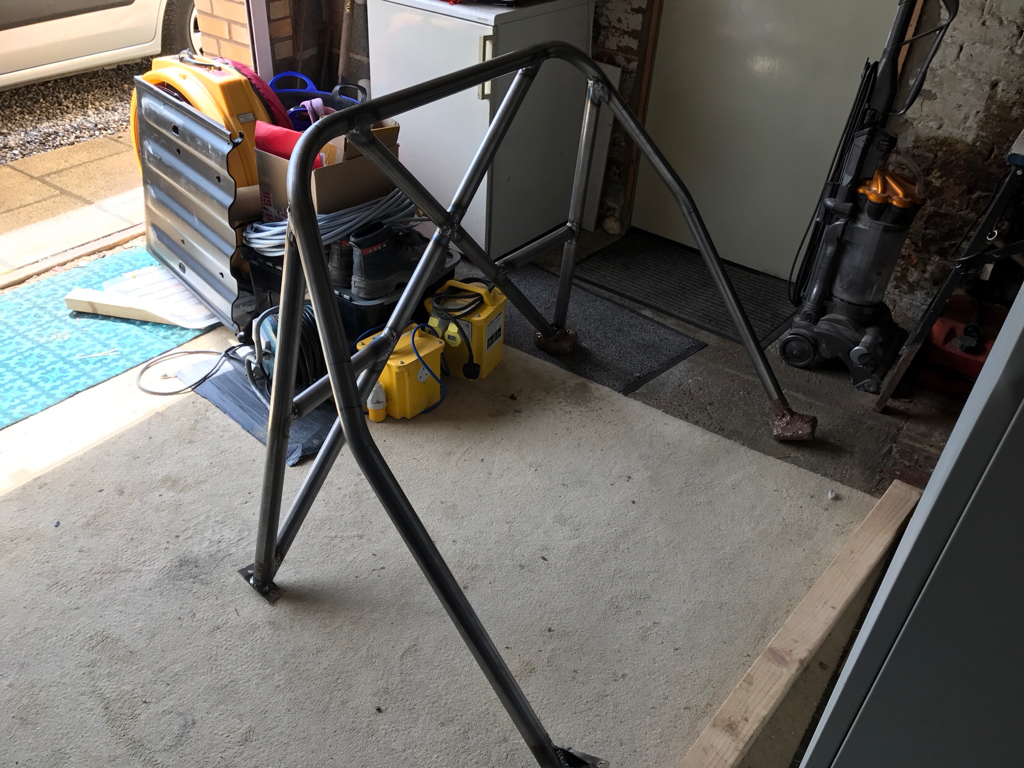

Bought an eBay special cage, as I wanted a harness bar and a little more protection.... [emoji849][emoji85]
Made some brake cooling ducts using some plastic funnels and some intake pipe. I’m a tight Yorkshireman that didn’t want to pay £80 for some plaggy jobbys.
Got cage fitted prior to Cadwell Park track day (no pics ☹️) but a pic after...

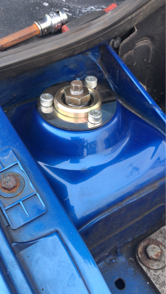

So after my trip to Cadwell I continued with the mods and fitted the pure Motorsport top mounts.

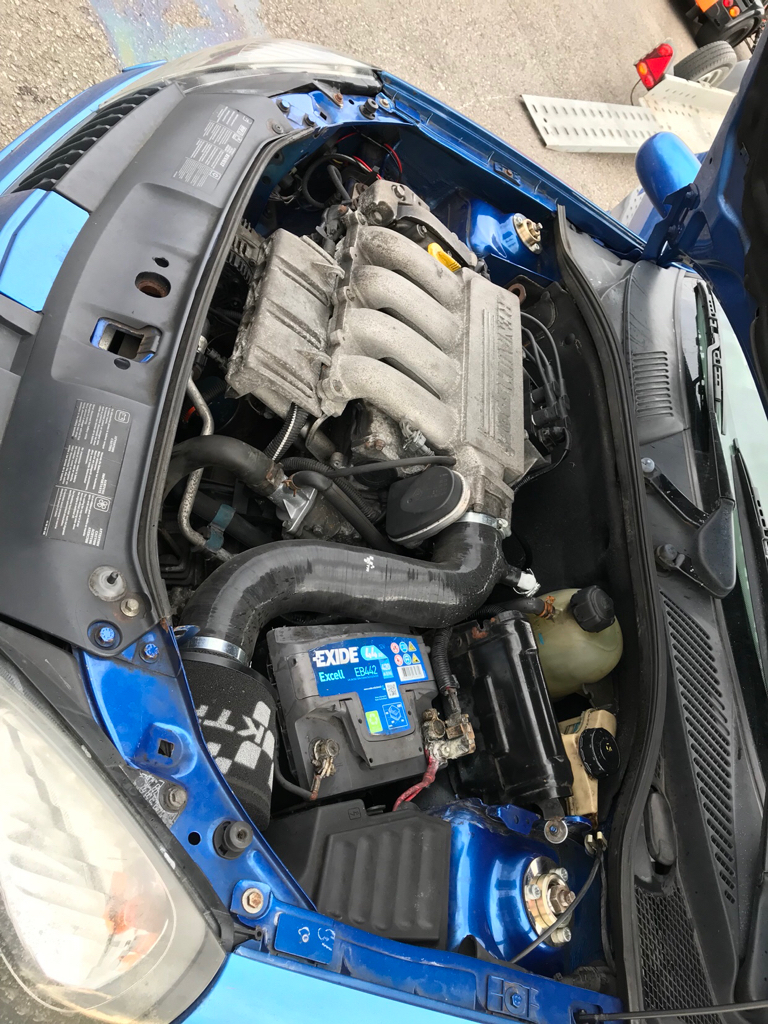

And also a fitted a ktec induction kit courtesy of @1985michael172

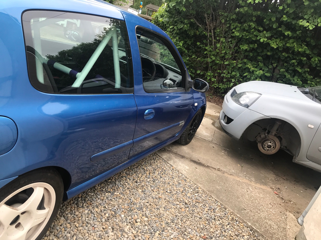

And had a bit of a wheel swap with the DCi rep sat behind. [emoji16]

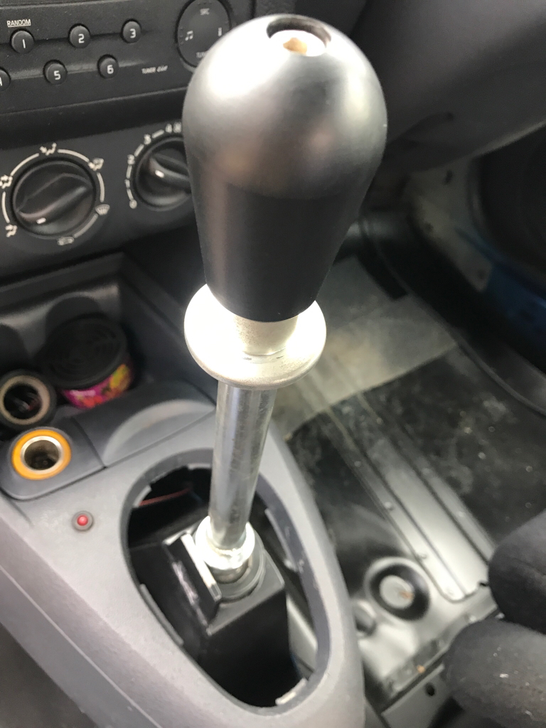

Then got this from Mike, who sold his 172 and bought a bodied 182 [emoji4]
So got the PMS shifter fitted, had a bit of trouble along the way but with Mikes help we managed to get all gears and reverse (if your gentle!)

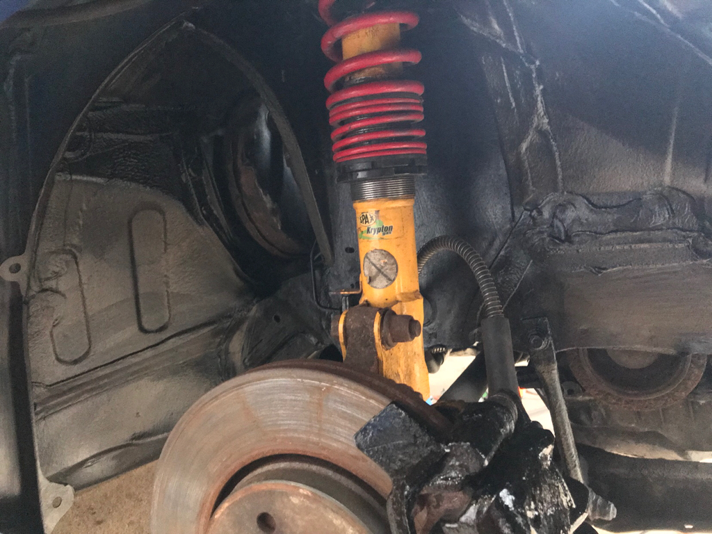

Whilst the car was in the air doing the PMS shifter I cleaned up the underside and arches and did some undersealing.

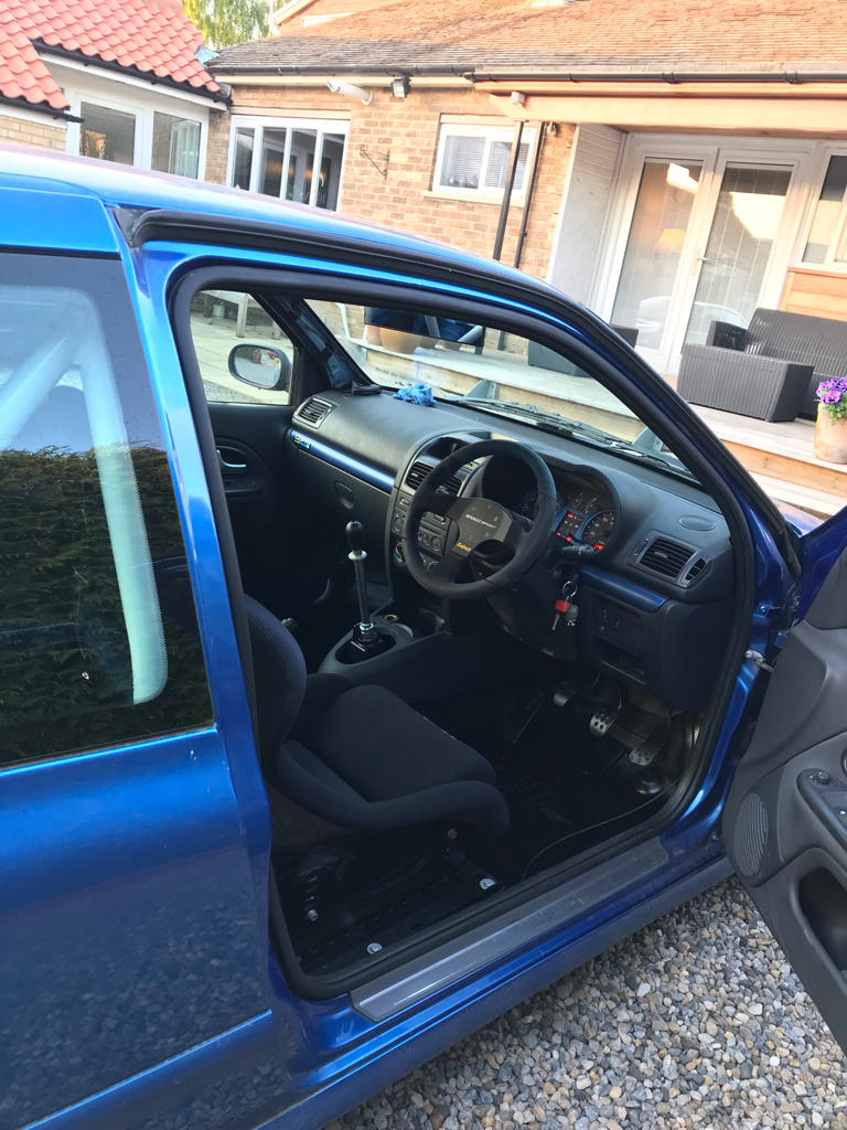

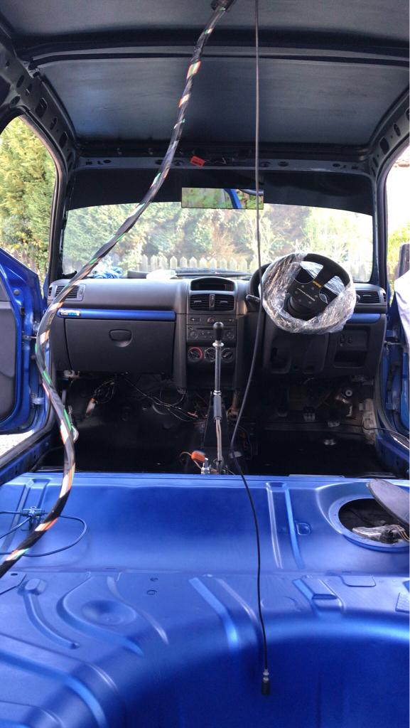

I painted the inside of the car, roof and floor black. And then the rear of the car mondial blue. Replaced a load of brake lines (not the best lol but will do until I get braided lines) and also added a adjustable pressure valve as all the proportioning valve was knackered.
Next I painted the cage, all rattle can jobbys so not the best but it be rite [emoji1303]

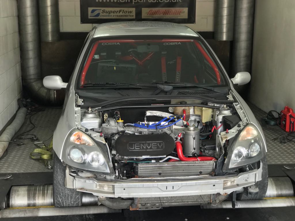

Excited for the results of the jenveys. I’ve just bought some and it will be going there for mapping as soon as they’re fitted. What cams are in it?

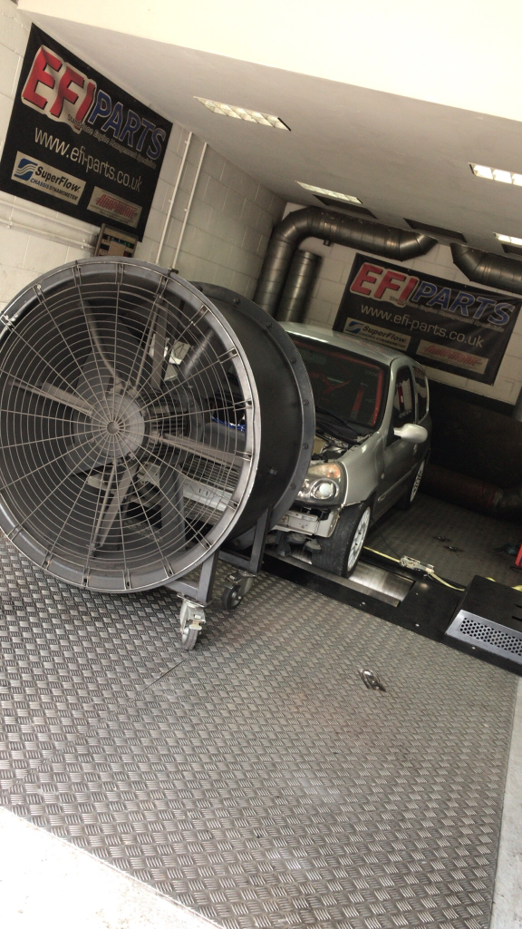

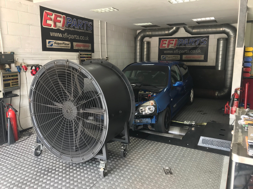

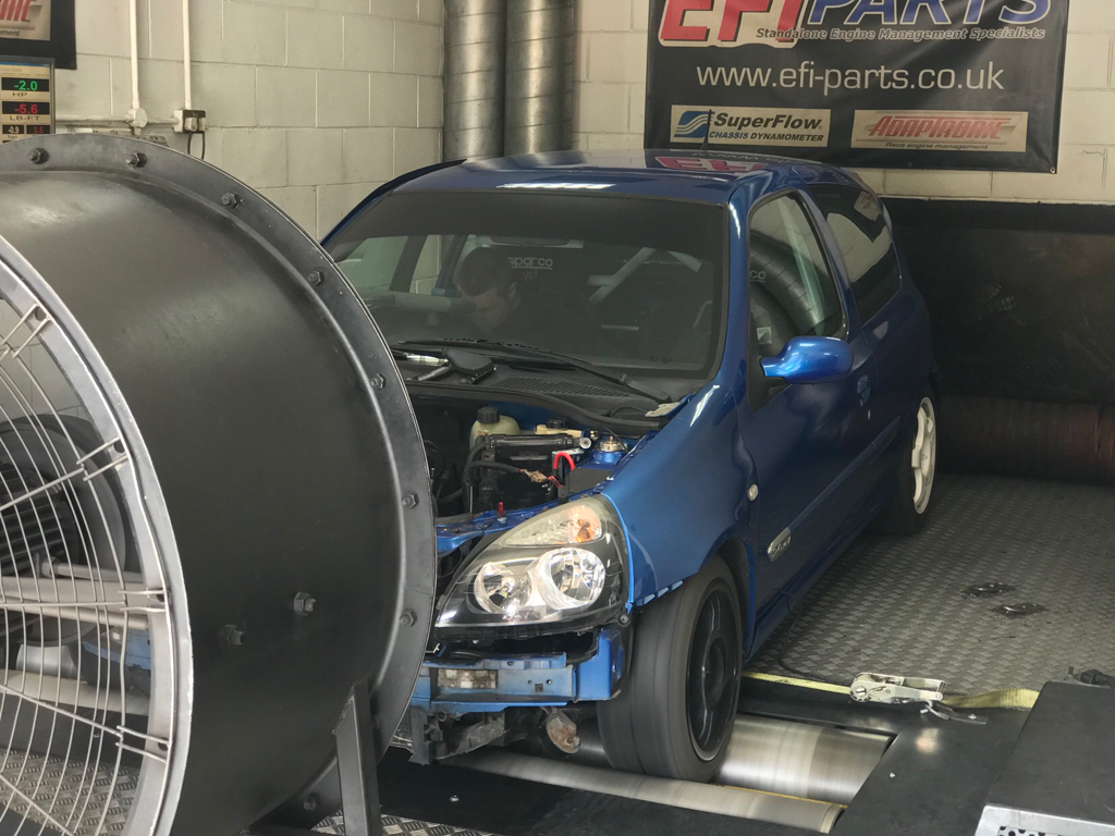

Great day today over at EFI. Chris is an absolute gent and worked his magic indeed!

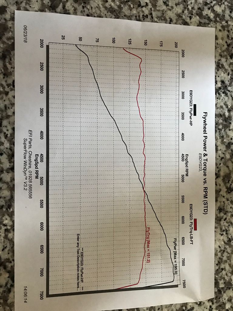

As above are Mikes Jenvey figures. Below his 182 on the dyno.
Was really happy how mine performed, must be a healthy engine!
It ran 195 hp and 151.2 ft lbs, very impressed. But most of all it drives really well!! See below a nice graph [emoji3]

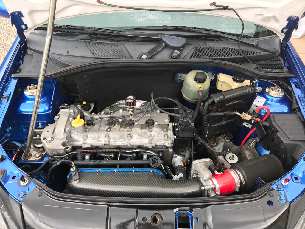

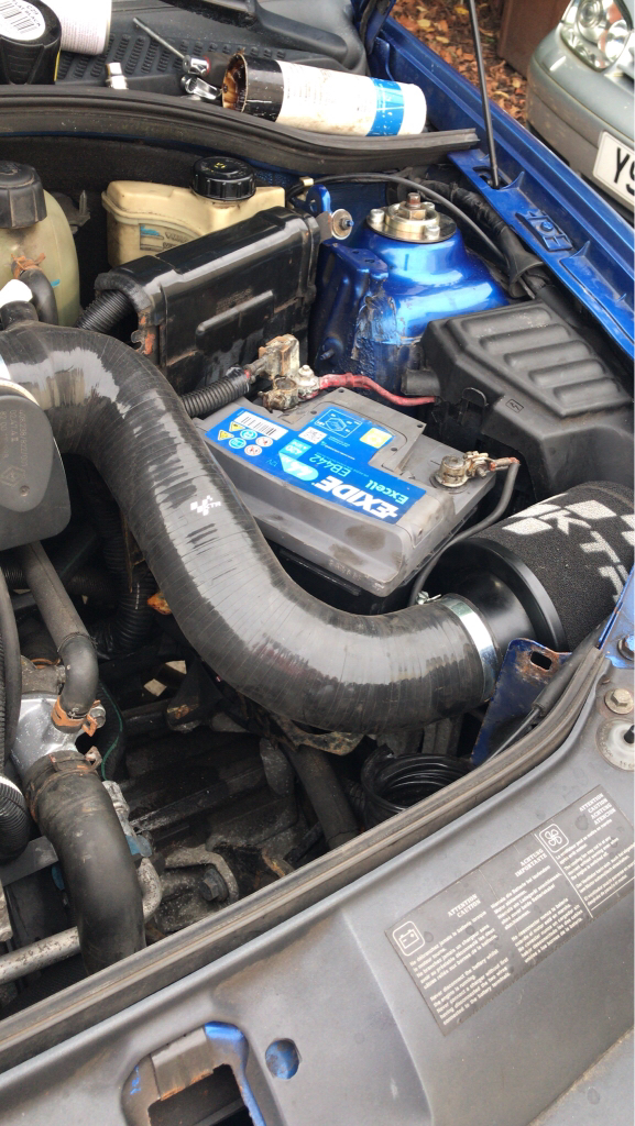

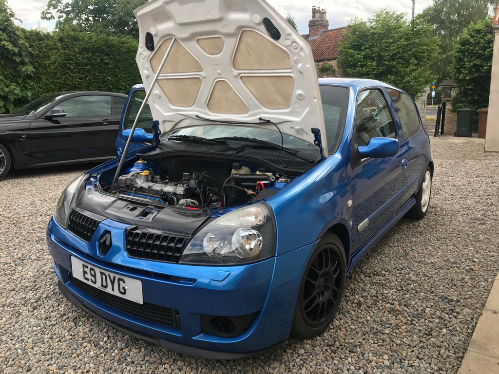

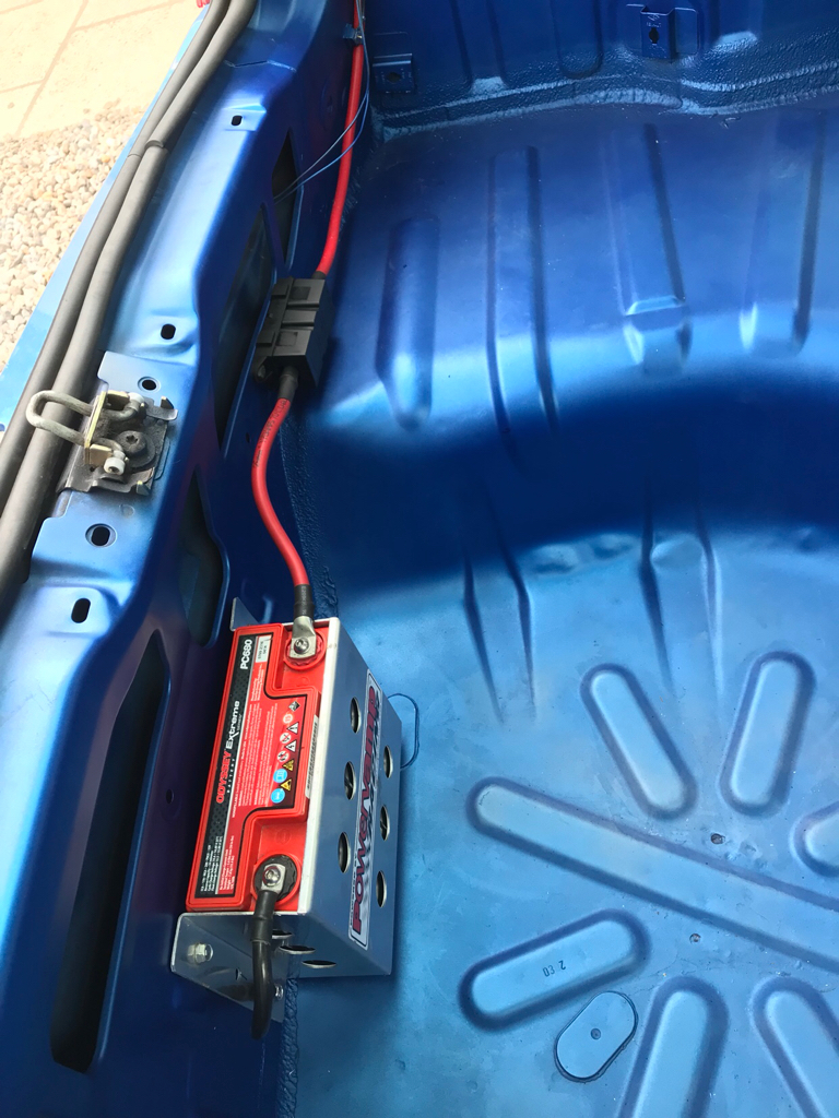

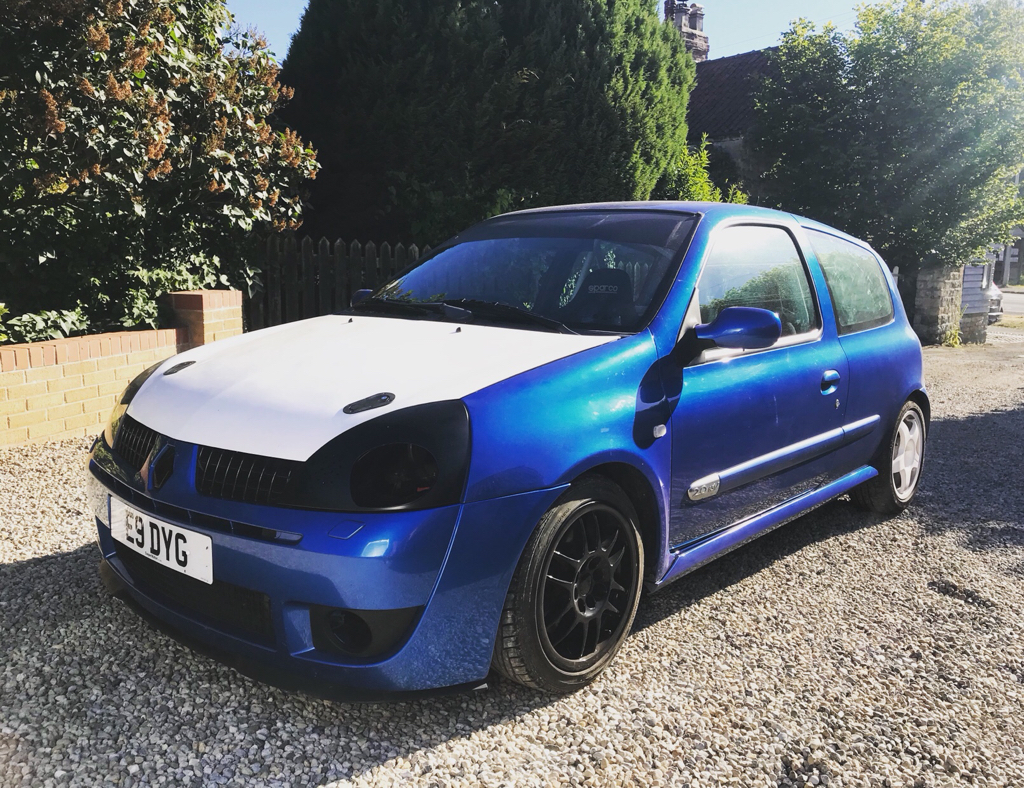

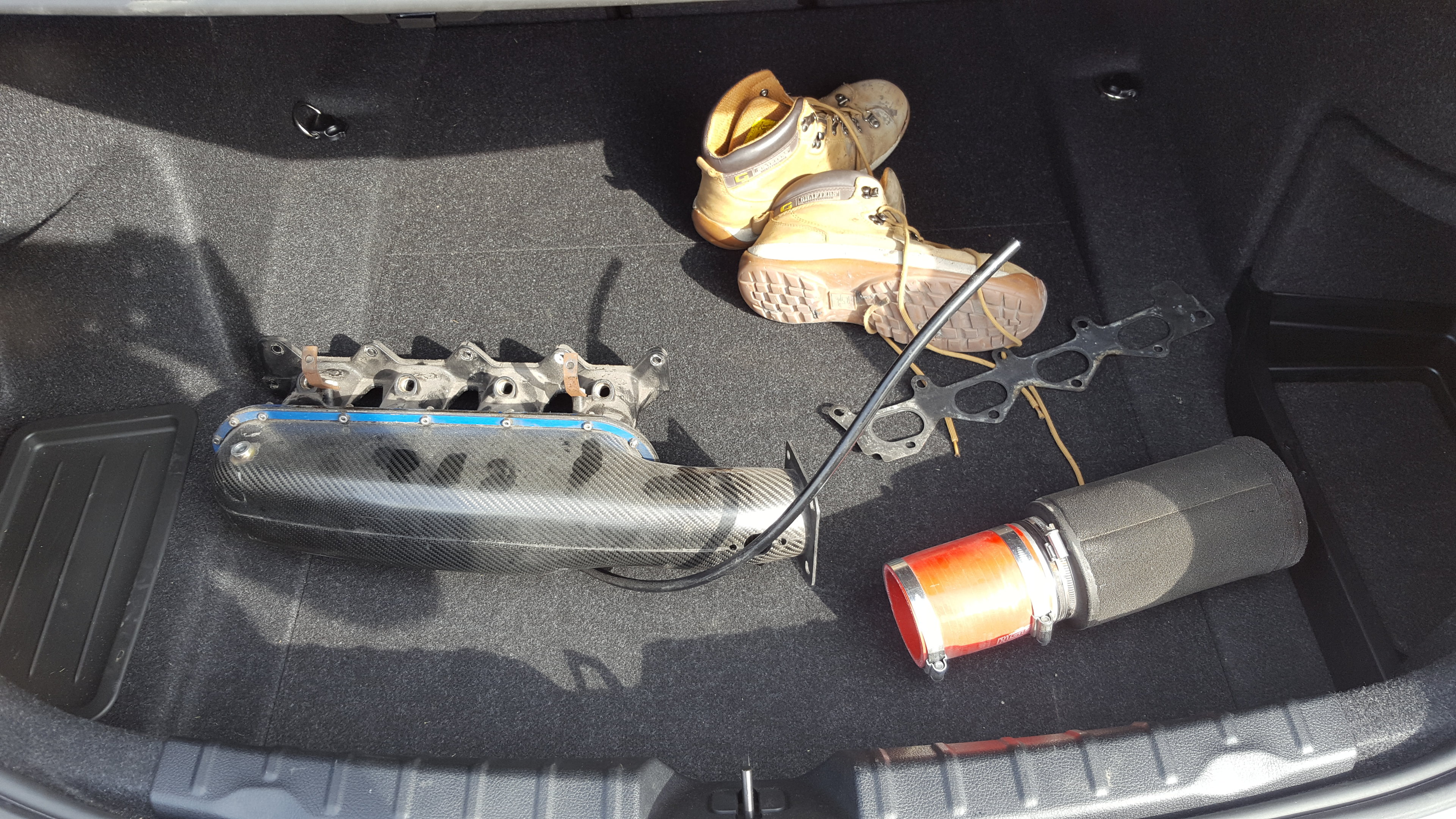

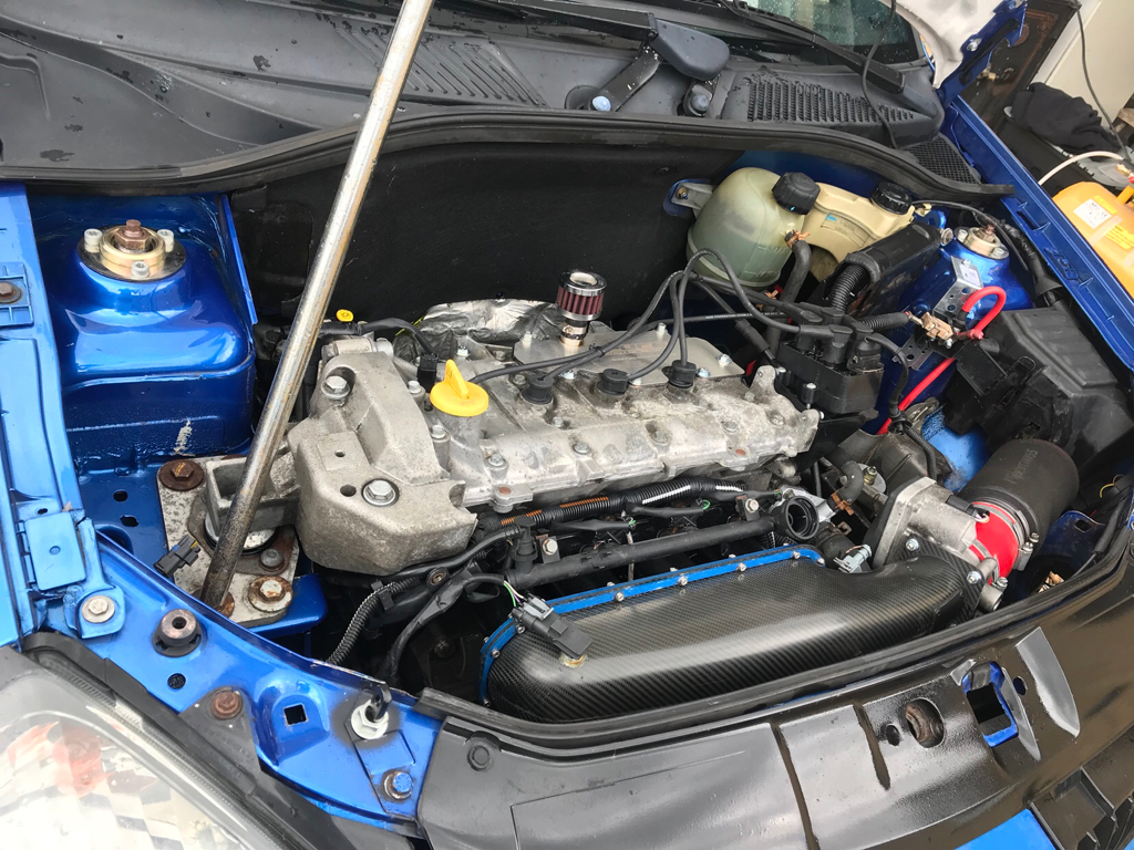

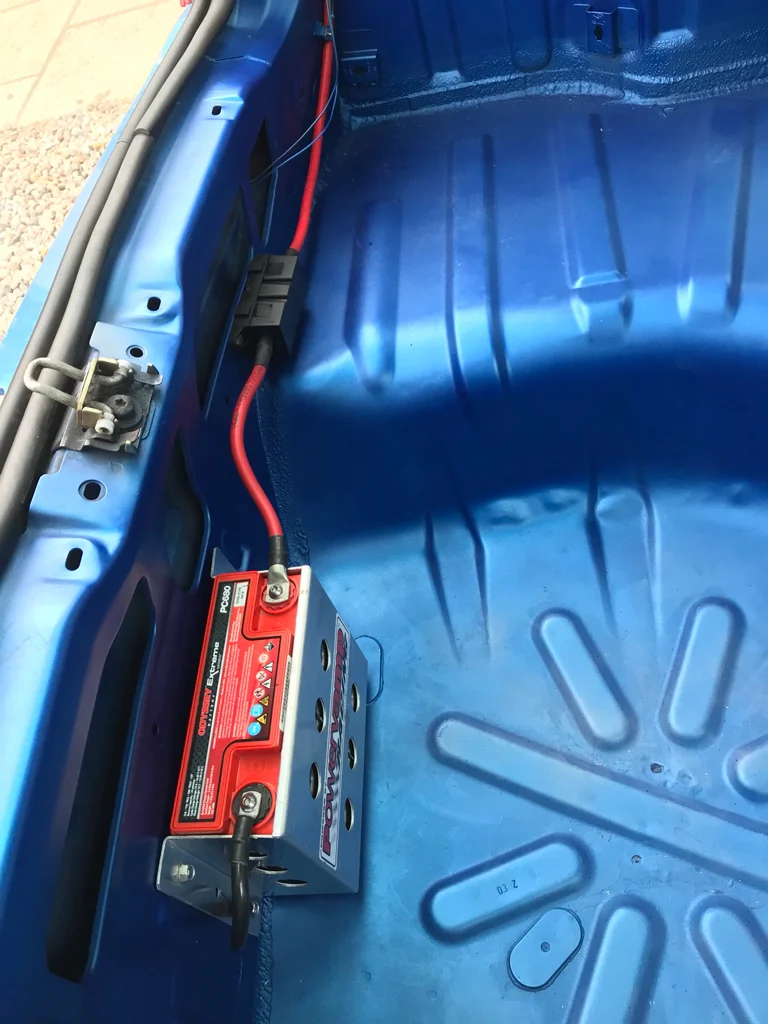

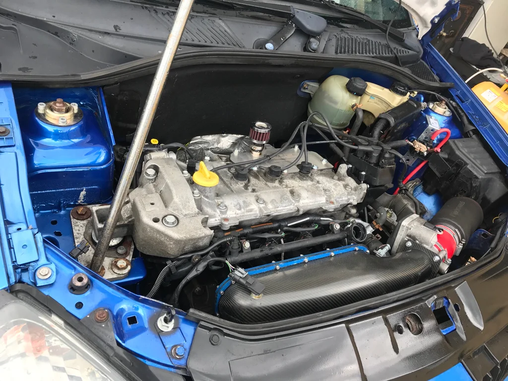

So after that I did a few more bits including moving the battery to the boot using a kit I made up. This was to provide enough space for the RS2 inlet. Also I got Mikes fibreglass bonnet from him [emoji1303][emoji16] and fitted that too [emoji3]
Few pics of the RS2 inlet fitted prior to getting mapped at EFI.
Also of battery in the rear.

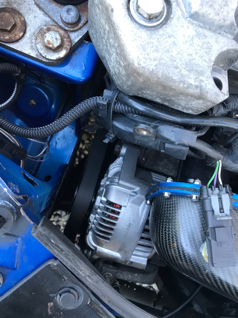

Got round to fitting a new alternator whilst trying to move house! [emoji28]
Was a bit of a chew as with the RS2 inlet on it made it difficult to pull it out from the top so I had to remove the alternator bracket from the block. Took a little longer than wanted but she’s now charging [emoji1303]

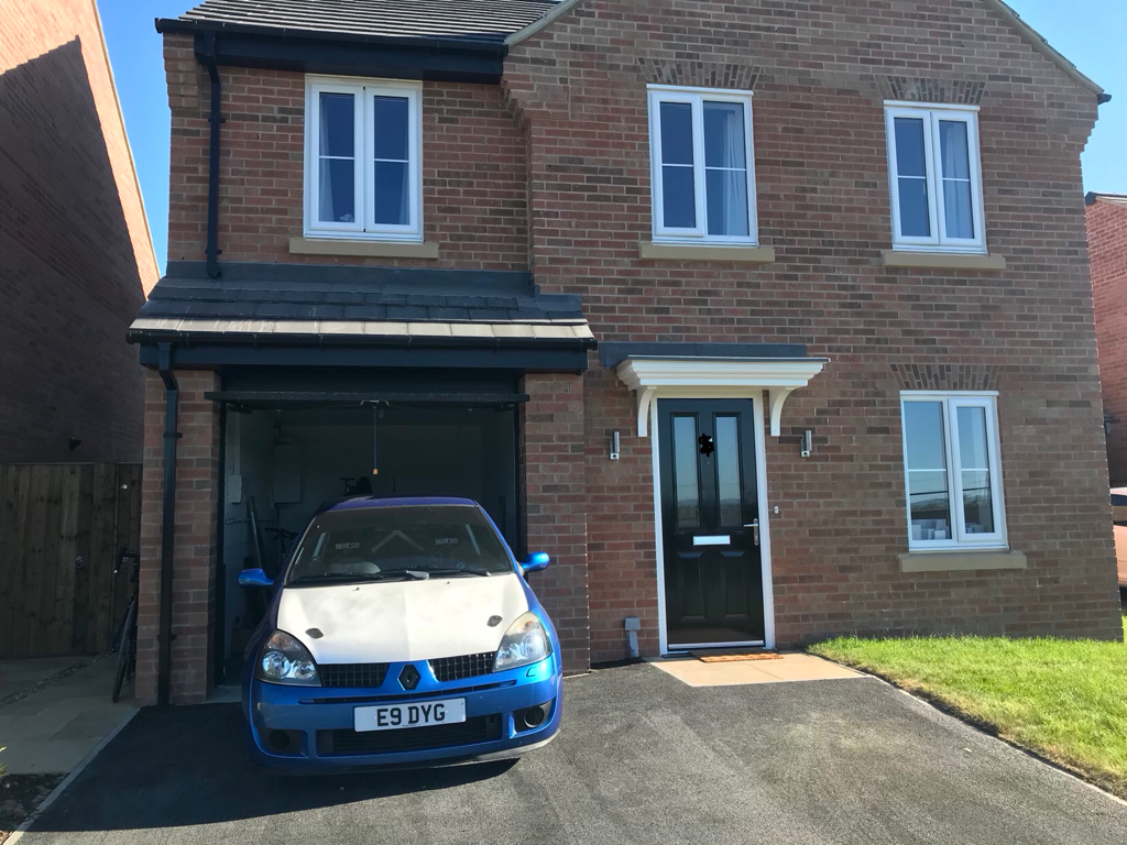

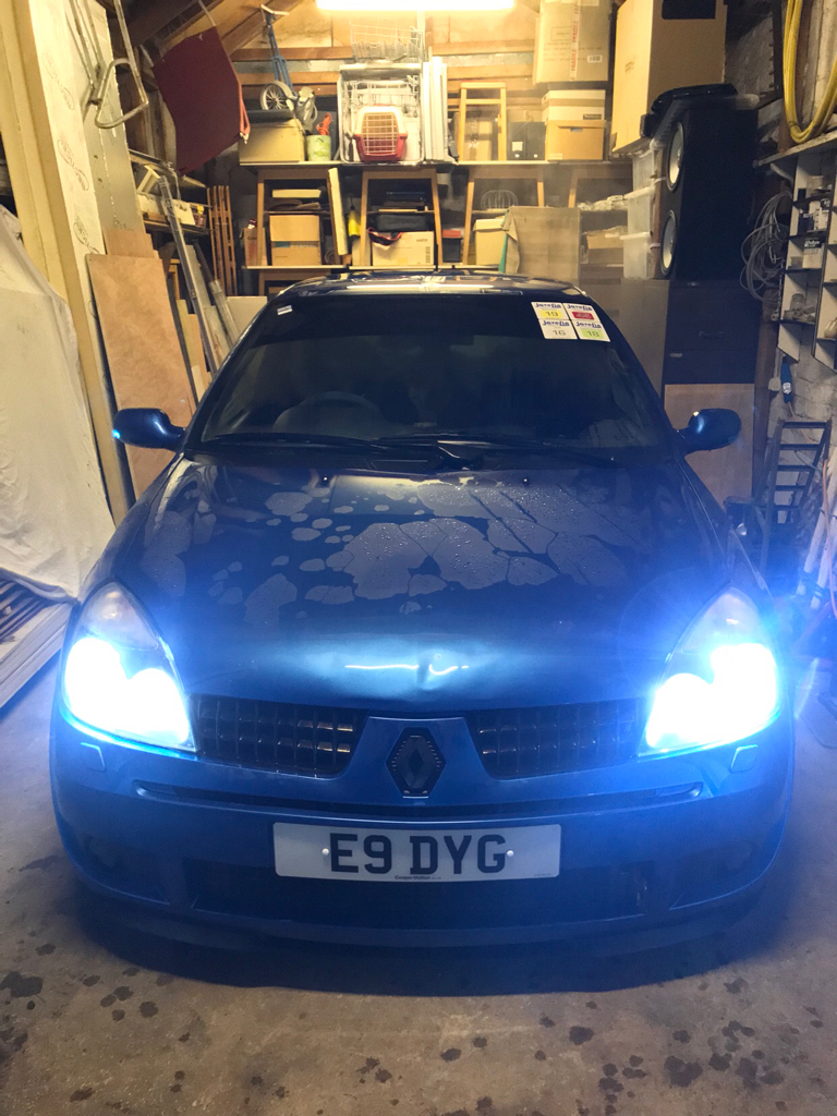

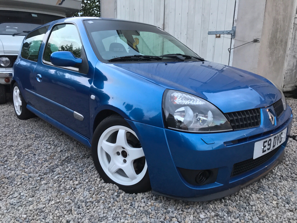

Tried the car in the new garage, going to fit fine but will be a squeeze to do anything on it ☹️

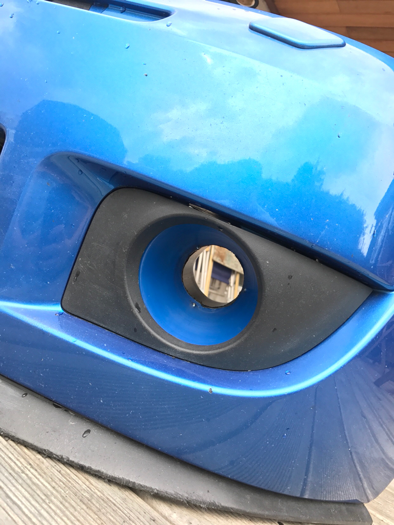

Also tried on the headlight intake that I made [emoji51]
Should work well with the RS2 ??
