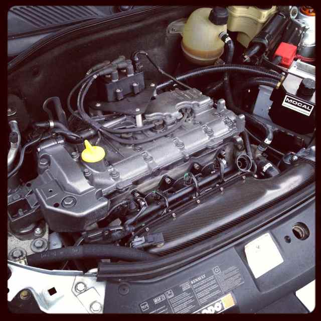

As far as engine goes, it's just the RS2, Ktec Supersport Stealth, 182 Manifold and Decat.
looks smart isit true that having the 182 manifold is a expensive job? can you just have the 182 manifold and use the 172 exhuast ect or do u need other modifications for fitment
Fitting the manifold is not a 5 min job, if you are paying someone to fit it I'm sure there is a couple of hours labour involved.
You still keep a 172 exhaust system but need a Decat link pipe or Sport Cat to join it all up (Ktec sell them).

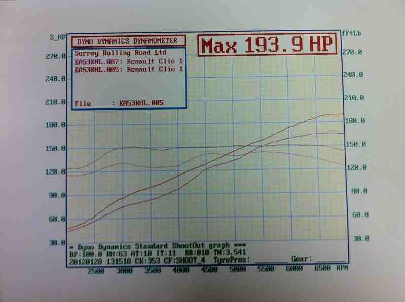

Dan's and Mike's both made 200bhp on RS2 and 197 cams, on two different rolling roads, both of which were totally independant of all the work done.
Mike's was fitted and mapped by him, and independantly tested at surrey rolling road : 200.4bhp
Dan's was fitted by him, mapped by me, and independantly tested at TSR rolling road : 200bhp
Spec of both:
197 cams dialled in to MWM specs, RS2 intake manifold, free flowing exhaust and a decat.
I think 200bhp is probably a little optimistic to expect to always get, would only take the tiniest of differences to make it come in a bit less, but certainly over 190 seems a very realistic expectation.

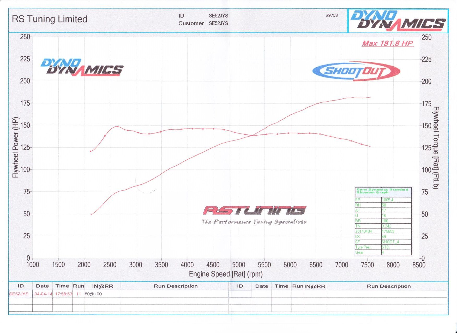

Just had mine done @ rstuning:
Can definitely feel the lower torque but the rs2 definitely improved the way the car feels and drives!
I reckon your cam timing is out. Shouldn't die off like that at the top end.
Big improvement at the bottom end of course and still some gains at top but I don't think quite as much as it could be.
Lovely to drive now though I'm sure :)
Yes, timing is a bit out unfort and just had my belts done about 3k miles ago as well. might consider re-doing them at some point but will need another remap as well i assume. Defo changed the way it drives! :D
Yes will need tweaks to the map when it has the timing sorted.
Mwm latest timing figures would see around 8-10bhp typically but you'd be looking at a big bill with the remap too. Prob around 500 quid I guess.
Paul might be able to do something similar but not sure if it would be dearer as may require a bit more trial and error for him if he isn't experienced as timing cams for the rs2 as the figures aren't public domain.
group n inlet setting is a good start though. But I know mike actually doesn't quite use those values, but they are better than standard at least.

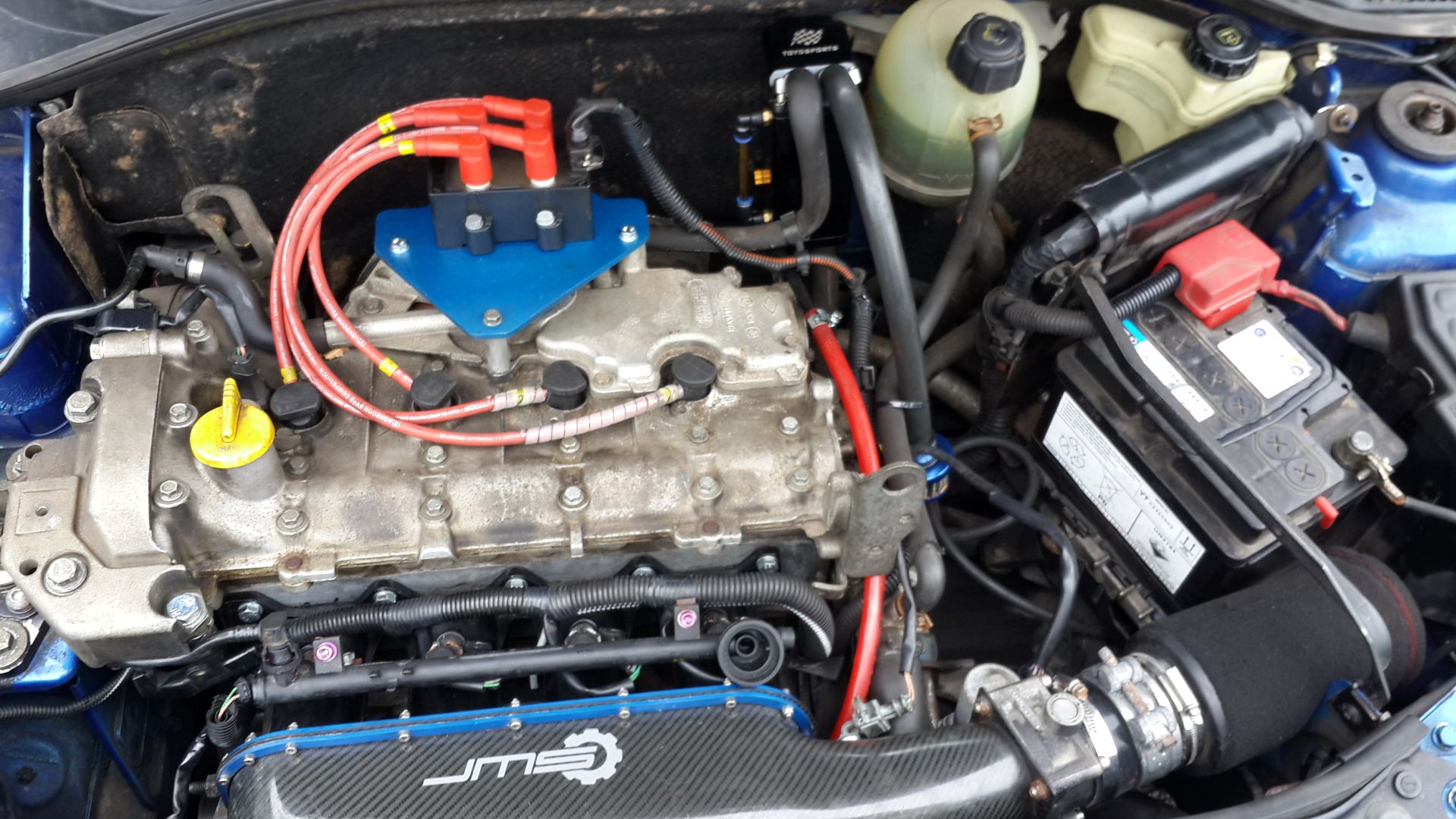

Why did you remove the extensions fella?
wouldn't fit in without removing the bonnet catch and fitting in bonnet pins unfort. Atm still want to be able to return to stock without major work :) Would the extension made any diff besides an increase in torque maybe ?
chip, Paul tried to get the most of it, had quite a few runs on the dyno to get it over 180bhp. Have the car booked in to do a major serv to get the car ready for an euro trip this summer so might get it back to Paul to correct the timing and get it re-mapped.
What else would be worth doing when i get to re-doing the belts and re-map to get maybe a bit more gains ?
It's how it drives that counts to be honest, torque looks a little dissapointing.
The only problem I see is you need to arrange fitting in line with belts and a remap for maximum results which is a shame as there is only one person who can tweak the timing for maximum power torque gains atm.

Just do the cam timing mate , not really any other mods particuarly worthwhile without spending a lot.
