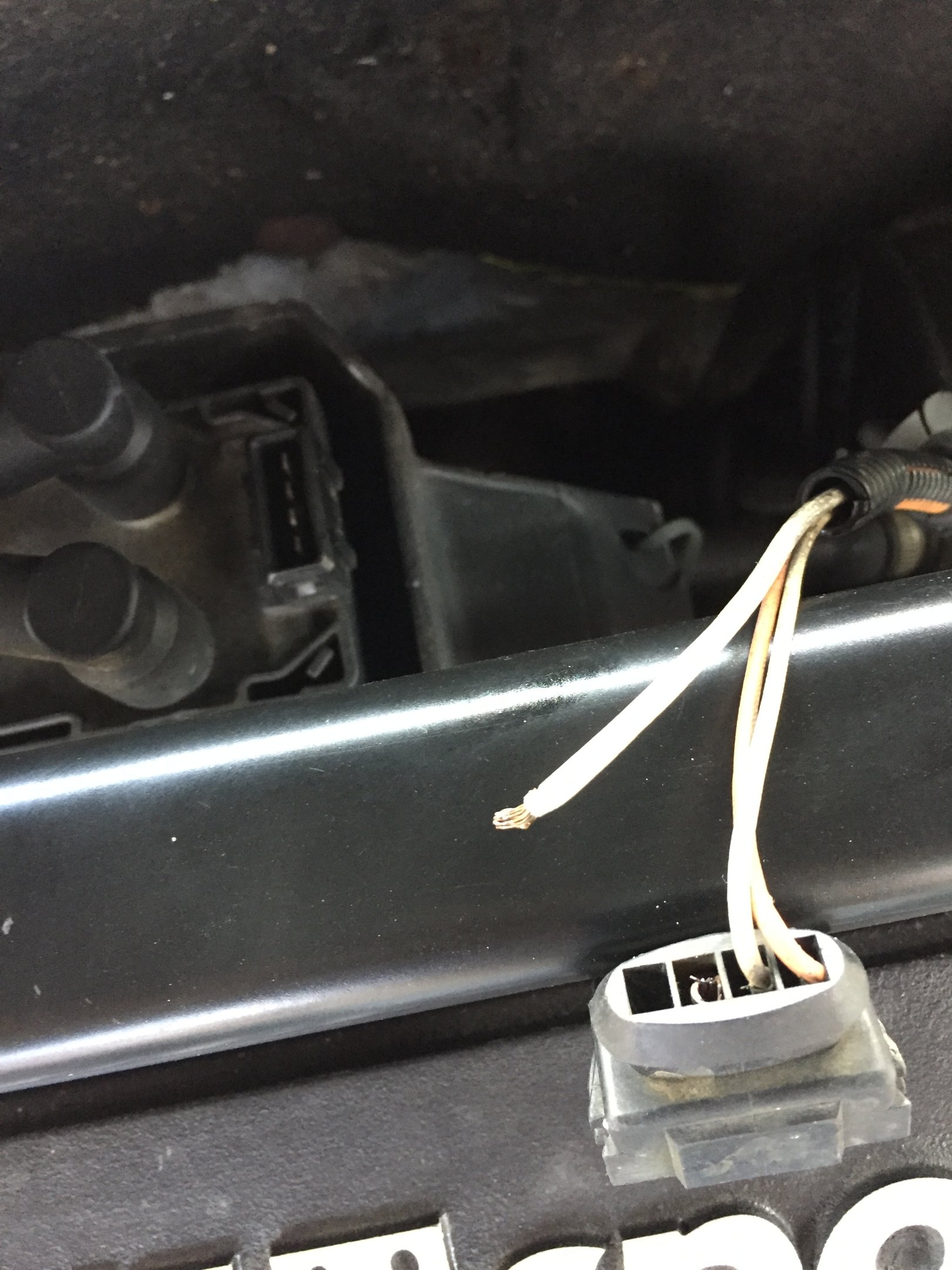

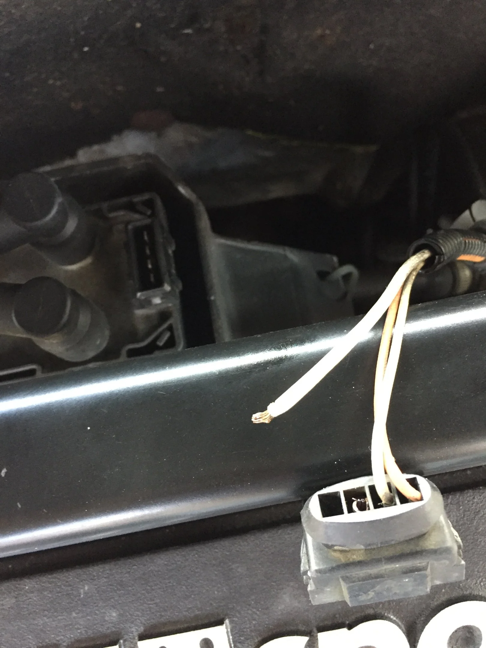

Unfortunately, the clio lived up to the french hatchback rumours and as soon as i got on the motorway home, had a misfire and it went into limp mode which is where the story starts
Pulled the car into the hard shoulder, done the only thing i could think of, turned it off and turn it back on again. Of course it started up and drove fine, for a few miles, same thing again. only thing i noticed was that it happened when i was accelerating so got off at the next services checked all the connectors which were fine and carried on back to Birmingham. Trying to be smooth on the accelerator, i eventually got it back locked it up and left it a few days until i had the time to look at it.
I got my code reader out and showed injector fault, i cleared the code and pulled off the tails one by one, no difference. took it for a drive, same issue check for codes and showed up a different injector. after a lot of phone calls and advice from rob seemed to be getting no where. After getting a 50% off code at ECP i decided to eliminate the injectors plus so far they are one of the things that haven't been replaced by rob. A couple of weeks later made the trip back to London to get the spares Rob had sorted out for me including a spare loom, coil pack, leads and a host of other parts.
First thing i wanted to check was leads and coil pack so unplugged the coil pack and low and behold there was the issue, all this hassle and getting more and more pissed off with the car for something as simple as..
a broken cable in the plug
So easy fix, chopped the loom and replaced with the plug off the spare loom, happy days, soon changed my feeling for the car, and what a car i had.

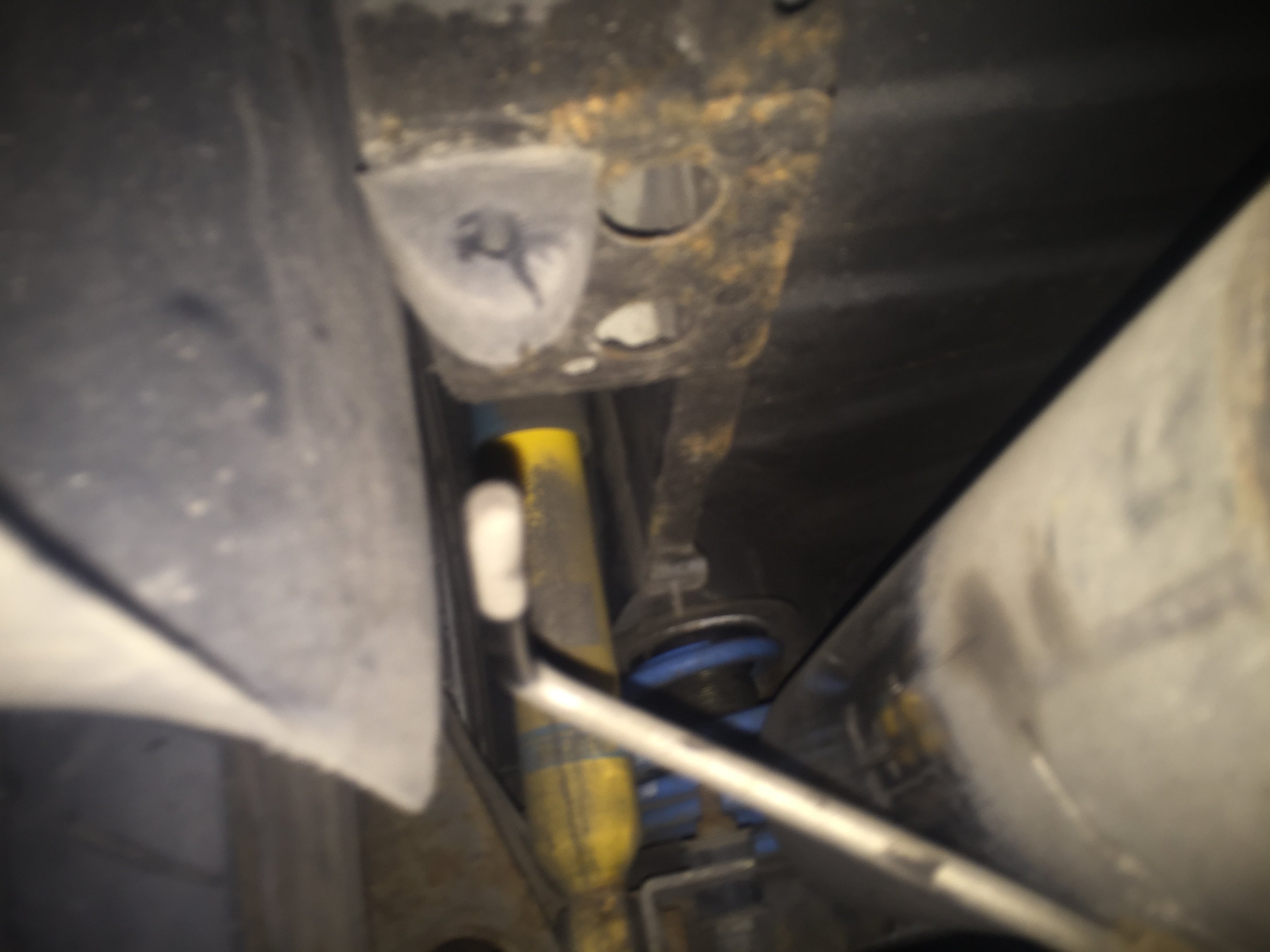

Next on the list was to replace the bearings in the pms top mounts as they were creaking and Rob being Rob had already brought some and put them in with the spares. i put this task of purely as i didn't want to mess up the suspension settings. After having a good look at it i decided to jack the car up and release the strut from the top and once the solid mounts were undone could get them off from the arch no messing with the lower suspension at all. After a game getting the old bearings out the new ones went in all fitted back together and ready for another drive. No creaking and so much more direct steering.

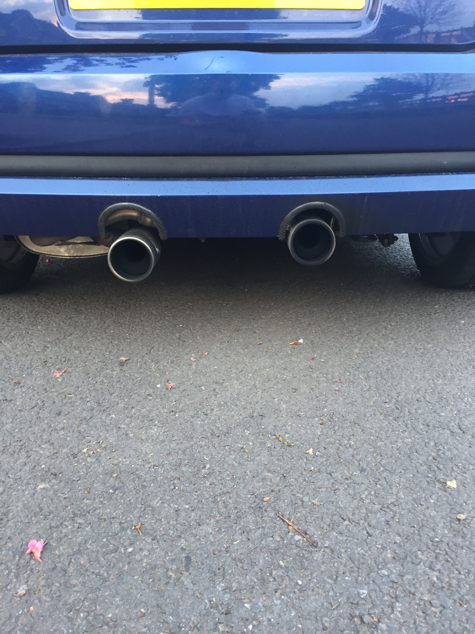

As this is only a weekend, fair weather car it spend a lot of the time sat parked up. One day i noticed the exhaust wasn't sitting straight,
clearly the old powerflow exhaust was fitted using non standard hangers.
so i ordered a new mount and a power flex insert which was fitted and intact sorted the exhaust and where it sat perfectly. Had to get a photo with my Personal Trainer's CL55 AMG, what a beast.

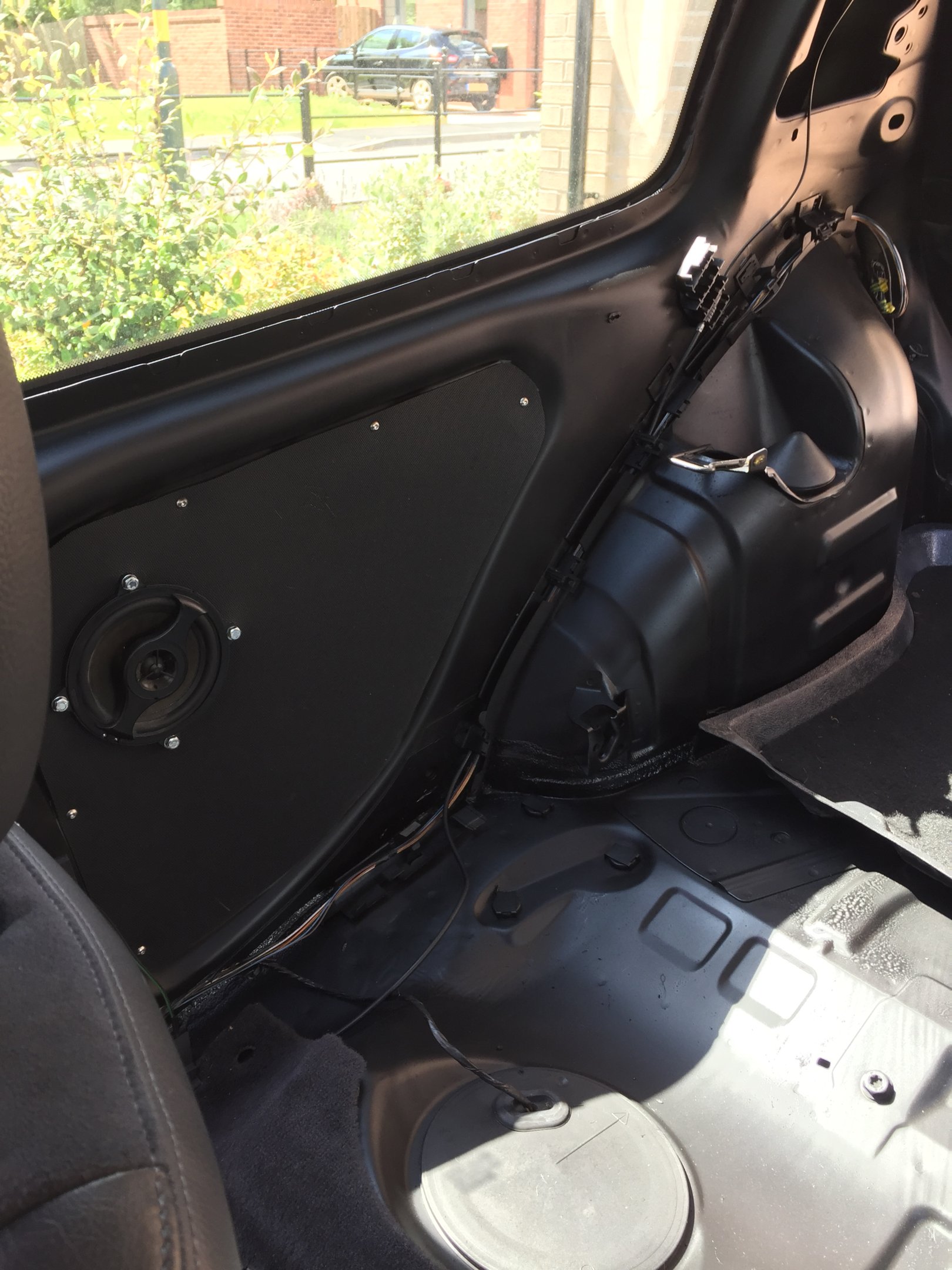

I came across a group buy thread by Simon for door cards https://www.cliosport.net/threads/g...s-from-£40-delivered-6-sets-available.805861/ which made up my mind so out came the rear interior. With everything masked up i sprayed it all with black stove paint as i've found in the past this is very easy to touch up with just a quick spray. Not bad for an afternoons work. ( 3 months later i still have the front door cards waiting to be fitted) I will get round to it.
In fact this is the best thing i could have done, no more rattles

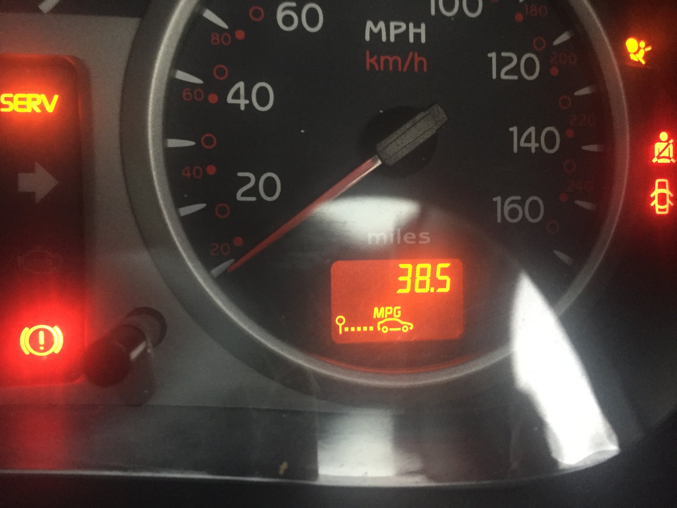

Here's a few photo's from the trip, over the 1,119 miles as well as passing the 130000 miles on the clock, even with a pull on the Autobahn that had the needle on the 160mph before i had to lift was still pulling and doing over 100 all through France just so we reached the tunnel in time the car still done 38.5 mpg, thats better than the vectra.

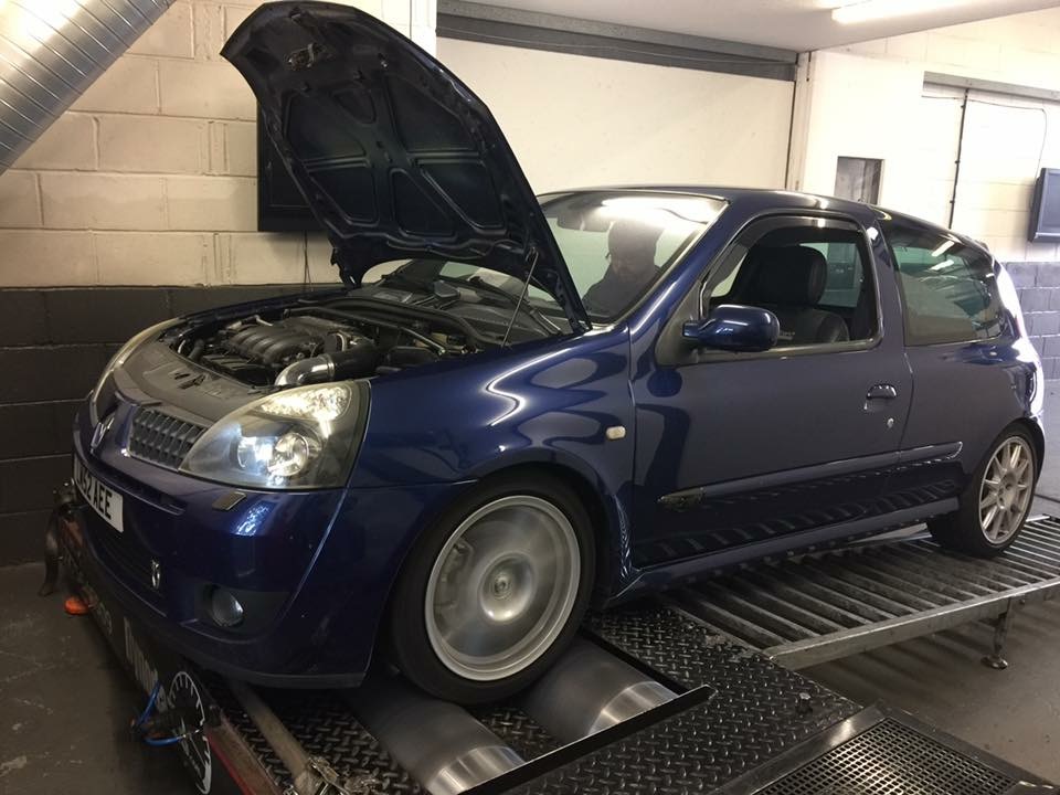

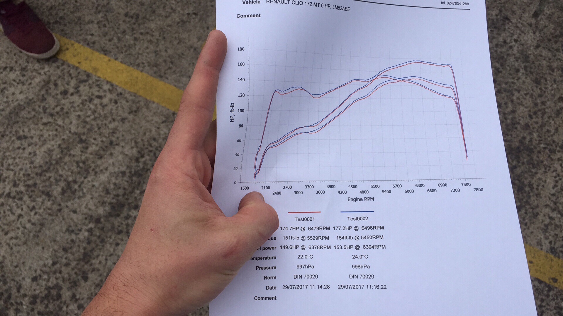

on the 29th August there was a midlands group rolling road day booked a dynodaze and i really wanted to see what power the car was running as it was about even with rob's St. We knew it was a good one but it pulled 177bhp and 154 torques, no wonder it felt quick

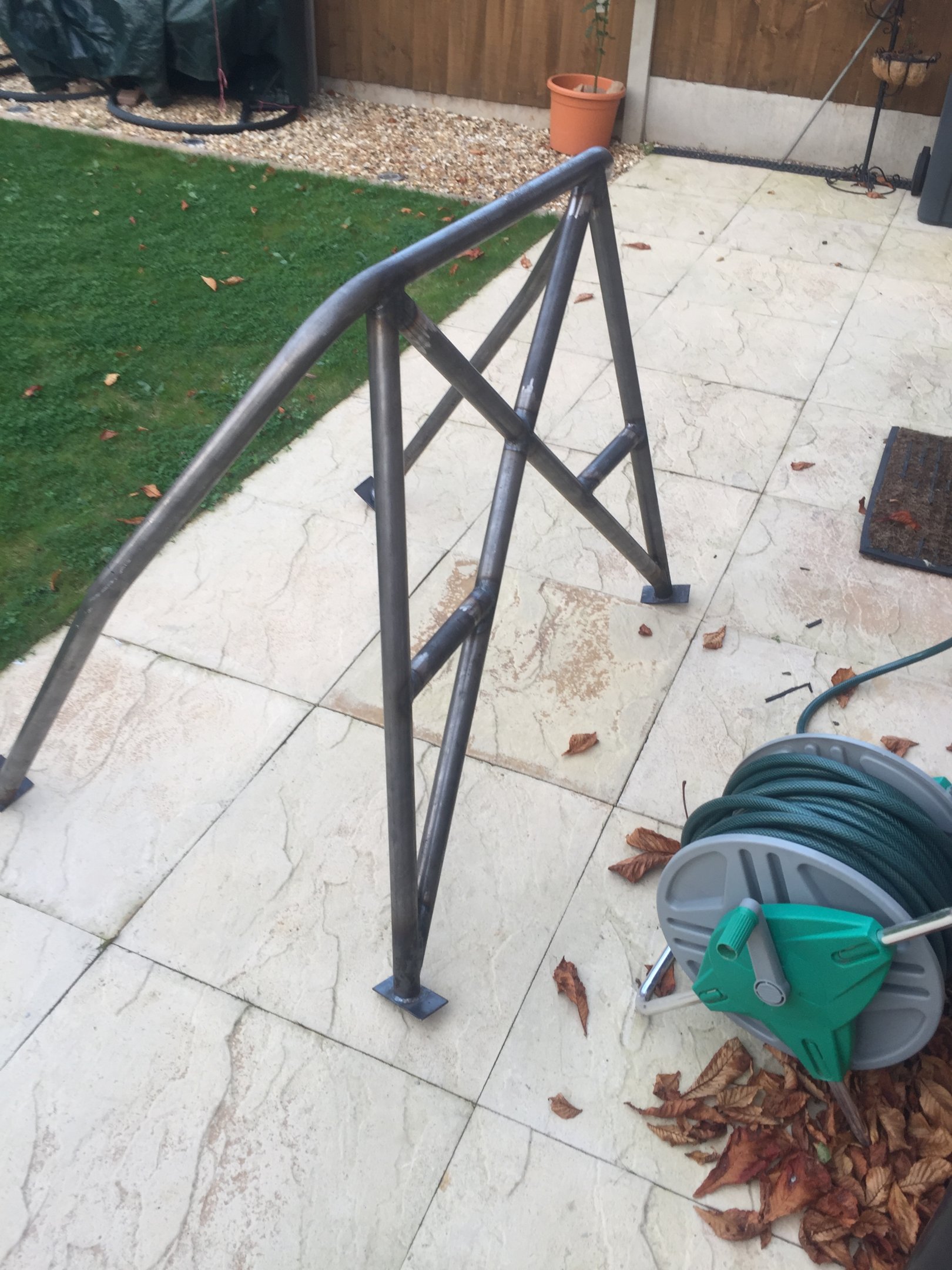

After a visit to see @Raceface_13 seeing his roll cage moved that swiftly to the top of the list, i'm picking it up from the powder coater tomorrow in the the same silver as the wheels.

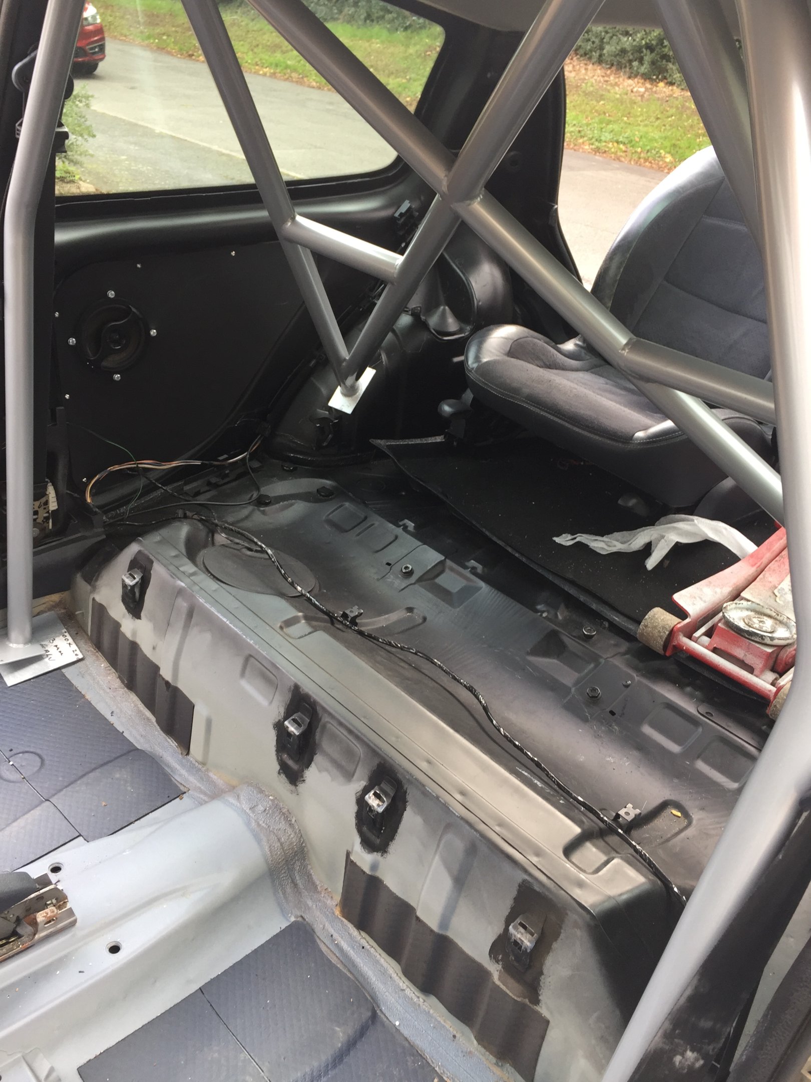

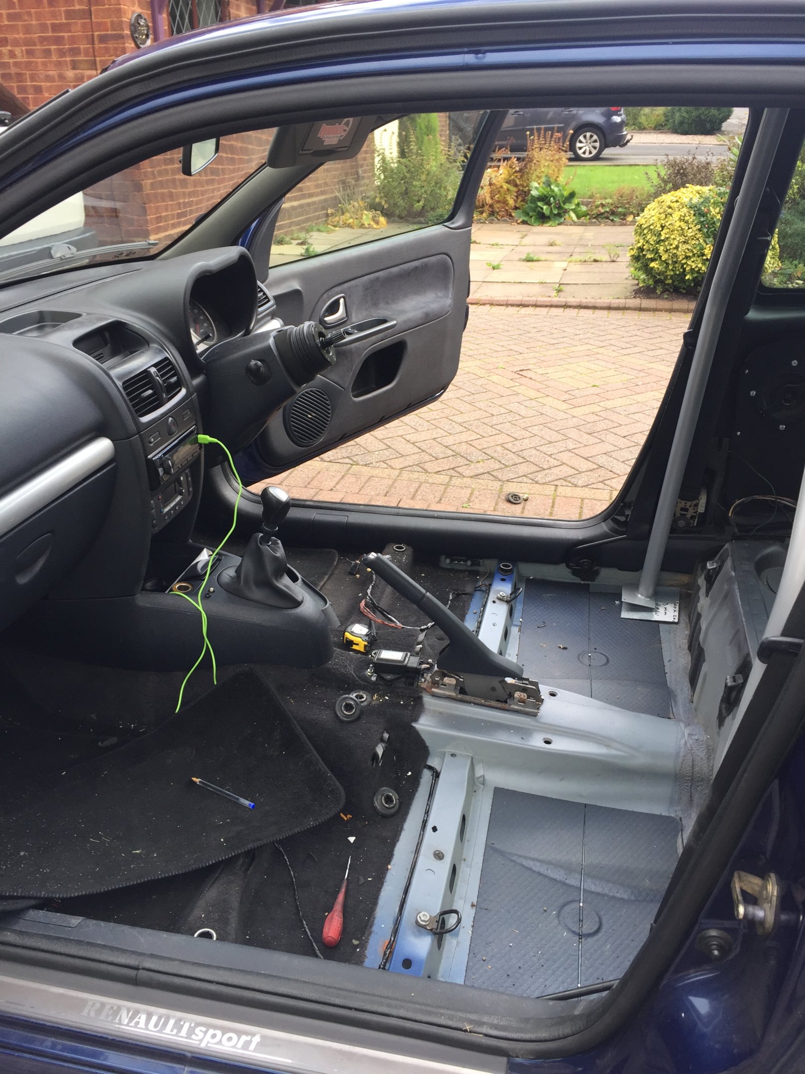

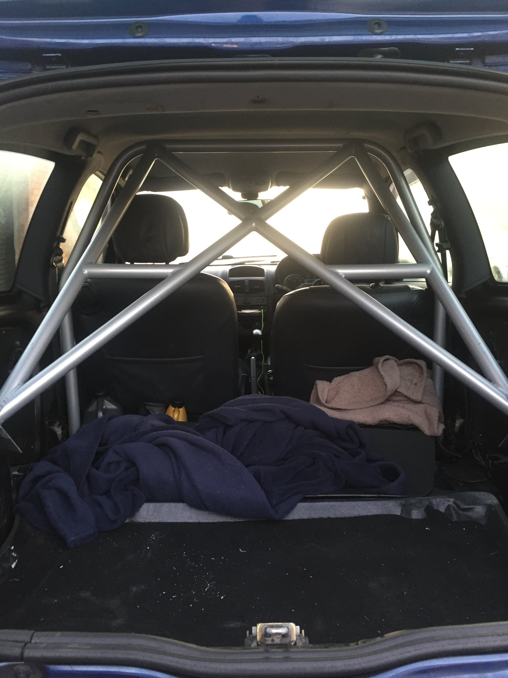

About a month ago along with @Raceface_13 a lot of swearing, cut hands and Oreo’s I got the cage fitted. Again, i can't fault Sweeney and Sherlock in Birmingham for the Powdercoating.

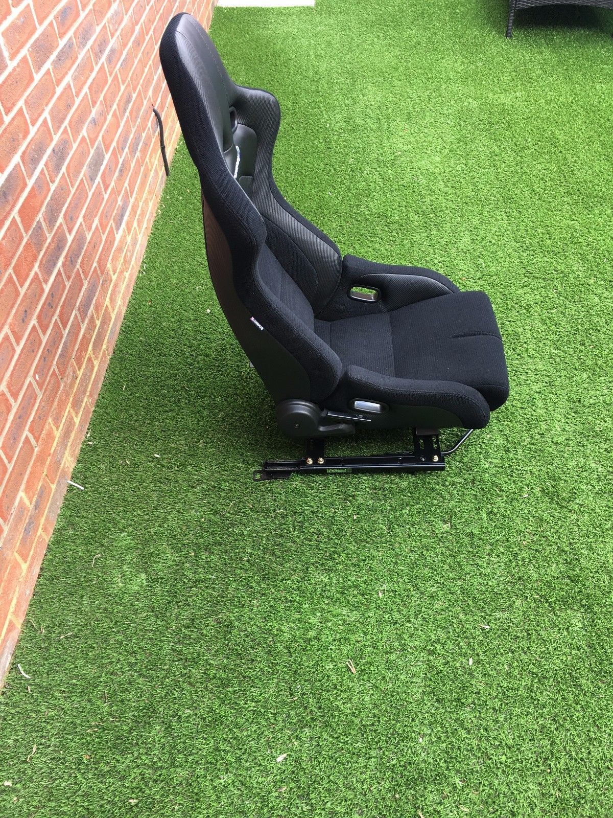

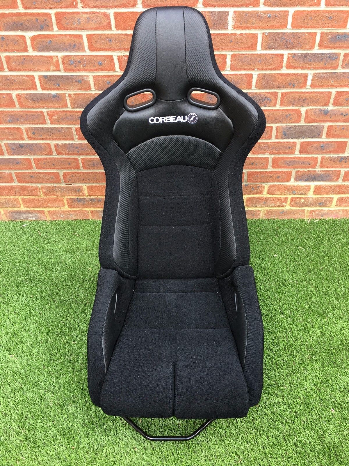

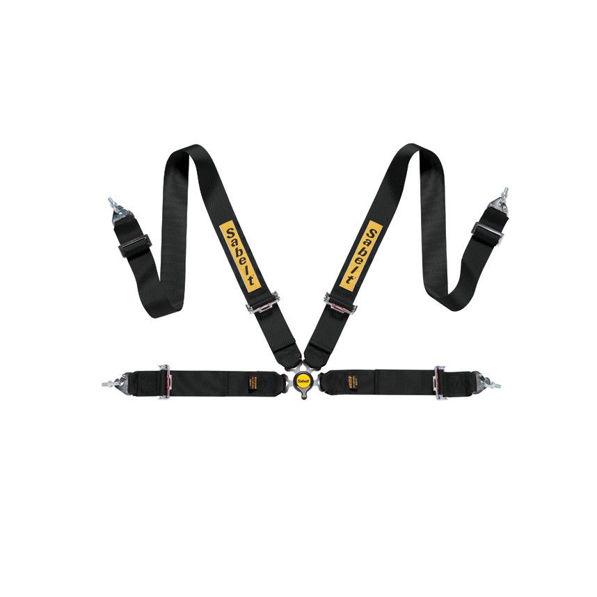

As i already said i wanted a set of Corbeau RRB's after sitting in a friends's but reluctant to pay £400 a seat plus mounts harnesses etc for a clio. Been on the look out for a bargain and this one came up second hand but in great condition and have also brought a Sabelt Harness to match the steering wheel and door pulls i have for the lightweight door cards. Also tidied up the Scenic shifter and fitted the stiff shift kit and carbon gearknob. Again the list keeps building but as its parked up and not being driven it will be like a different car when it all gets sorted and driven next year. i must admit i do miss driving it a lot.
