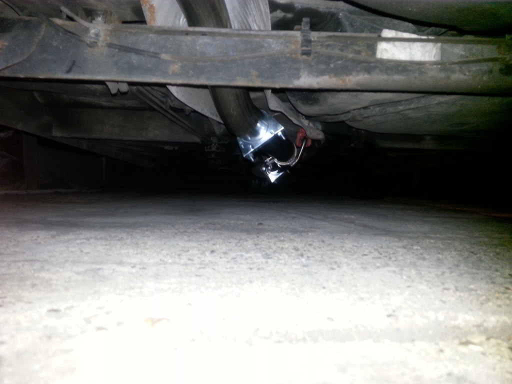

Tomorrow will be the real test. May hook the gopro up to the rear of the car! It seems like it hangs pretty low to the ground though?
  172
Well im assuming thats what ktec sent as I had my local garage fit it for me purely because I didnt want to be fecking around under a car with not much room. Annoyingly it seems that the clamps could have been twisted so they would give more clearance because as you can see at the moment they are positioned so they are going to be as close to the ground whereas if they were turned a quarter there would be a lot more clearance!
  172
I've taken it slow over speedbumps and they have been fine so far. Bit annoyed at the garage to be honest as it looks a bit schoolboy error. Saying that they probably didnt notice as they would have had the car on a ramp.

You should be fine mate had a leon turbo that the sump sat 1 inch from the ground not had any problems just make sure the speed humps that are in the middle just go to one side you will be fine bud
Can't you go back and get them to rotate them or fit different ones? At least then you can go over speed bumps properly ;)

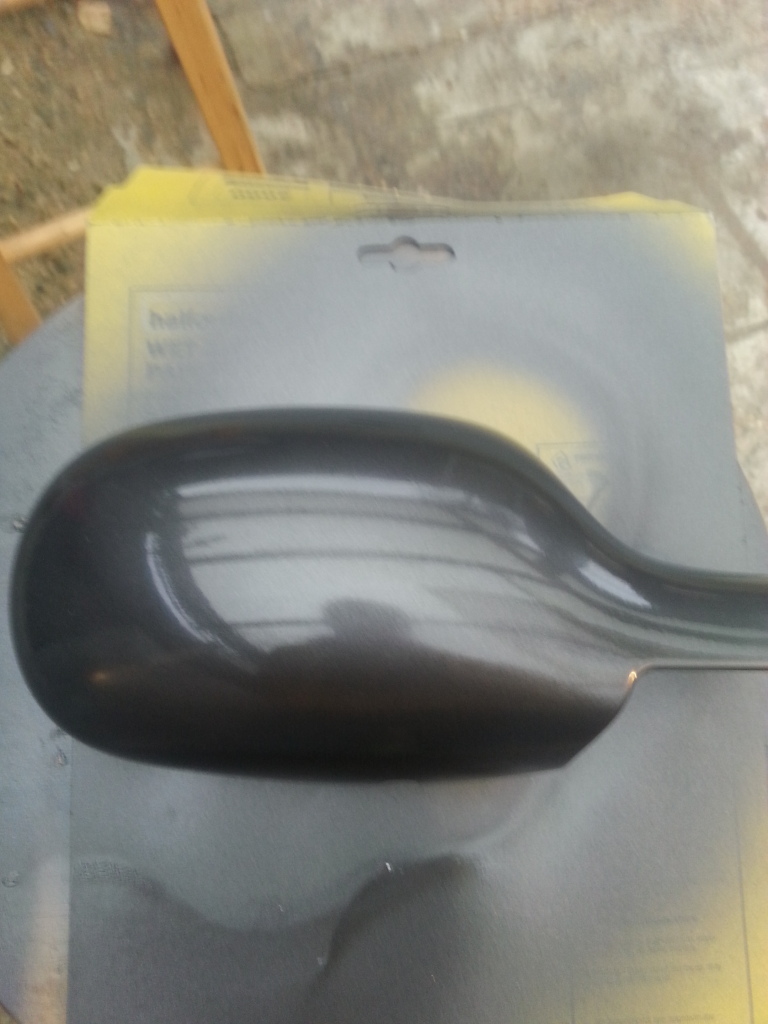

Ignored my own advice while spraying my mirror caps and decided to use the whole can of lacquer as there was a tiny bit left....BIG mistake it now looks orange peely from where it spurted on the last few strokes and ive got a nice big run! b****cks!!!

Wetsand and buff up?

Just checked on the mirrors and they look properly s**t. Just hope that some serious t cut on them will work tomorrow or im going to have to start again. Grrr.

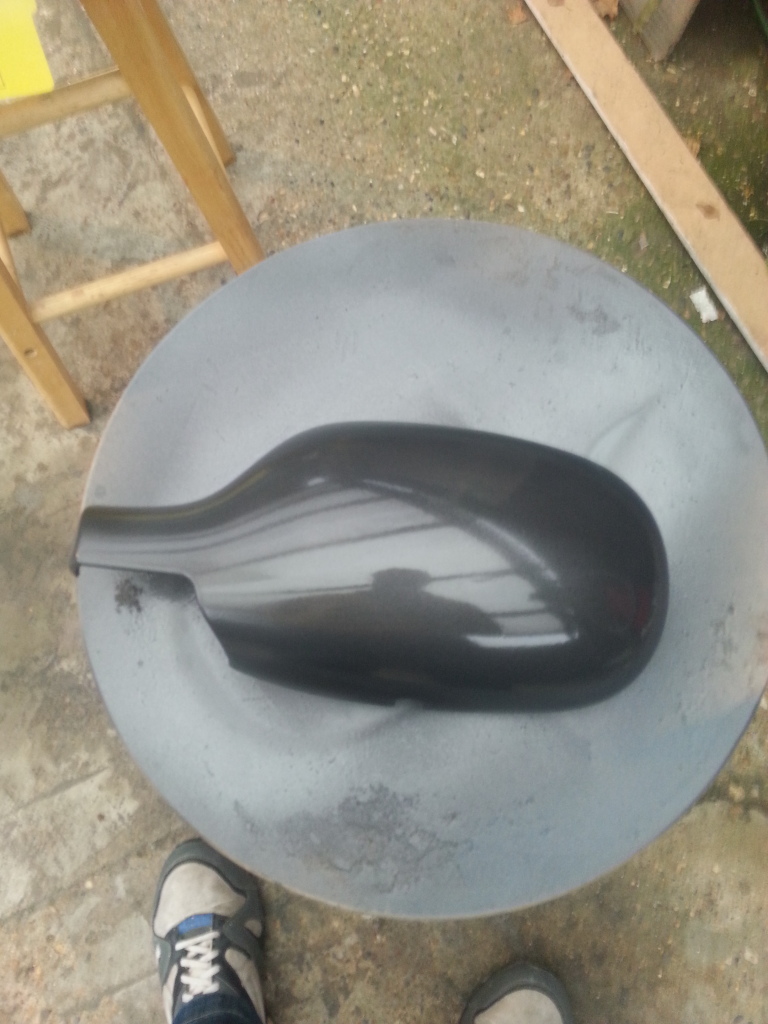

If I wetsand them thats just going to take the lacquer off though? Judgng by the state of them I think thats what im going to have to do though. Quite how I managed to get these so wrong compared to all the other things ive done im not sure!
No you'll sand off the orange peel and runs if you do it correctly. Lots of info about this online though, make a search on Youtube about wetsanding ;). Else you are just going to have to repaint it. No way to just get the clear coat off

Clear coat is off and now im left with the graphite grey which now looks a matte colour with what looks like orange holes all over it! I also sanded right down to the original colour in a small part of it so majorly fucked off. Don't know how this has happened when all my over stuff came out 100%

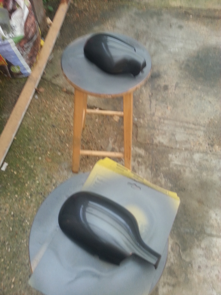

Well redid the mirrors!
Sanded them down as best I could with what I had (2000 grit) and then redid them primer and all!
To be honest I got 90% of the finish I was after which isnt bad for a diy jobbie. If I hadnt have ballsed it up the first time they probably would have been 99% but oh well. You would never tell they aren't perfect from a distance anyway!
They are still drying so will look better. Then I will buff them up with some turtle wax when they are fully dry in a few days. Should look great on the car! Now just the small door handle section to do and my clio badge to redo.

Now its getting dark they are reflecting the light and colours from my shed light so im more than happy. Just got to try not to be stupid and put them on the car for a while!
Wet sand and polish with every paint job, I'm awful at painting but can still do a half decent job once it's wet sanded and polished!
