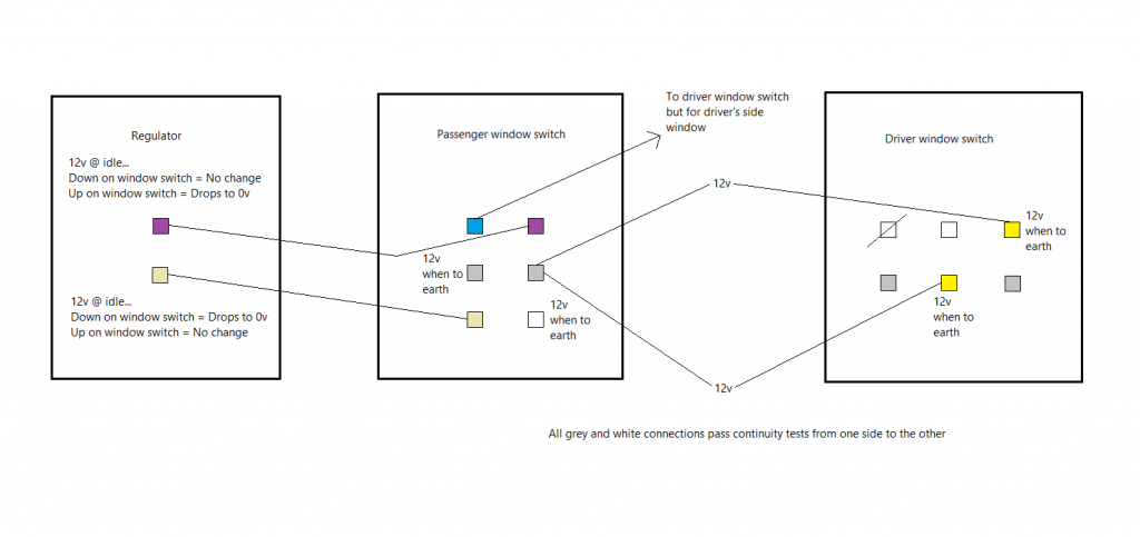

When my window went it was the microswitch within the switch unit. Took it apart and you could clearly see it was burnt. You can check voltages etc. before that stage, I have a diagram I created I can post in here if you're interested. Other thing it could be is the actual mechanism... can you hear it 'trying' to engage?

Could I have a look at the diagram you've made please might just help me because the more I think about it the more I'm thinking it may not be the UCH as everything else works fine it just clicks loudly from the passenger side of the dash when I'm using windscreen wipers and windows.

Easiest things to do is get your voltage meter out mate and chuck it on the switches and and regulator (mechanism) I've found the diagram but out of context I can't imagine how helpful it's going to be!
Just remembered mine was on the passenger side, I don't have the information for the drivers regulator, but I suspect it's the same.

Ok guys thanks, got the car booked in a garage in the morning for a service and to find the misfire. I cant really make anything of the diagram lol. Want to get the car running right first then ill worry about the window and speedo.
