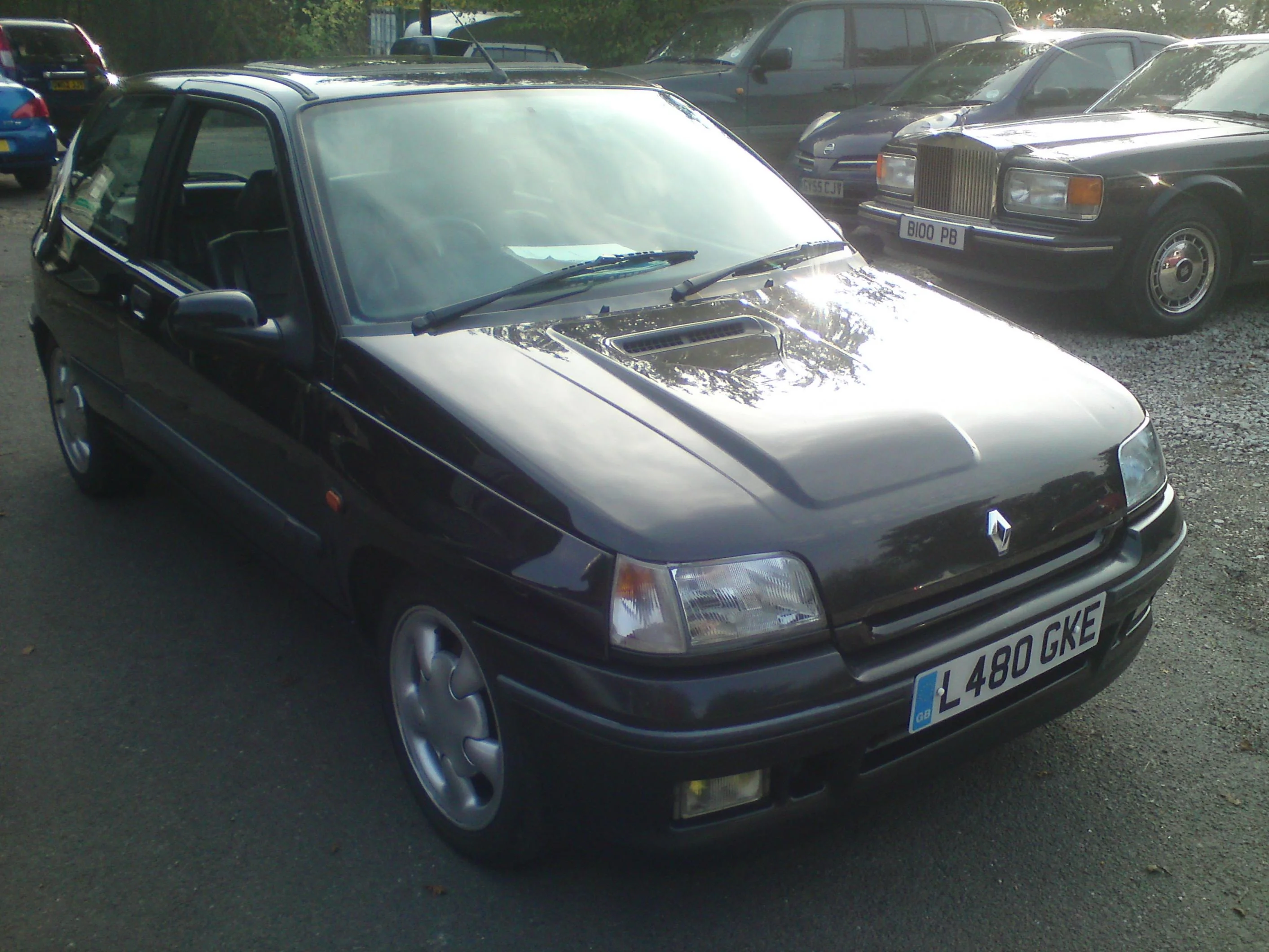

Just bought a Valver!! 1994 :D :D
  94' Valver F4R'd
Ok,
So my car got written off last month and i've been deciding what to do. Was going to get it repaired but it's well past that and can't afford it :(
Really wanted to do a conversion on mine but can't now, so though i'd look for a 16v that needs a little work that I can use :)
Loved the black ones with leather but are hard to come by in good nic, anyways, after a long time searching I found one. I think its perfect! does need a few bits doing but is perfectly usable! Picking her up Saturday!!! I'm like a child! So excited!! :D
(click for larger Image)

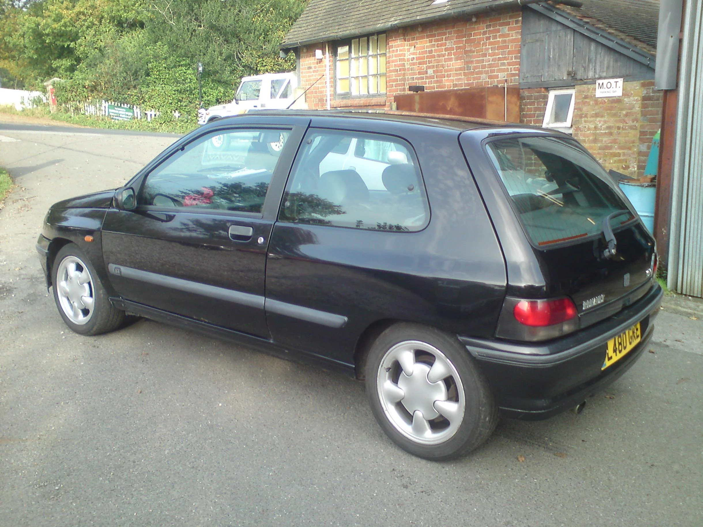

It's very clean for 18 years and 114k miles!
Few small problems that can be solved by swapping bits from my PH3 1.4
here's a list of thing that need doing/will eventually get done...
  • Small leak coming from the gearbox somewhere, not leaving a puddle but there it's covered the gearbox, Any common places it could be? Thinking driveshaft seal?
  • Headrests don't click back into place? Thinking of taking the leather off and putting it on my 1.4's headrests? Anyone know if theirs a quick fix or something?
  • Door pockets have faded - Swap from the 1.4
  • Door cards are peeling - Glue?
  • bootlid from a 1.2 needs the spoiler, take the one off the 1.4 and spray black...
  • bottom of both doors have rust, keep the drivers door from the 1.4 and get sprayed (no rust on it) Find a passenger door
  • Arches were done 3 years ago, drivers side has a small bubble nothing that worries me for now
  • Discs and pads on the rear, maby front aswell
  • underseal the sills and paint subframe/wishbones with hammerite
  • Swap my tinted back windows from the 1.4
  • Swap the windscreen form the 1.4 (this one has a chip)
  • Swap the exhaust from the 1.4 - Slight blow in this, and its just a standard system
  • FIND A NEW AIRBOX. THIS ONE HAS BEEN DRILLED :mad:
  • Give the interior a good clean
  • Find a new insert for the gearknob - faded
Think that's it for now...
Cambelt and water pump were done 3 years ago, Head skimmed new gasket and starter motor. It's got a K-Tec manifold, don't think it's stainless, are these any good? Supersprint one be better?
Will have 1 years MOT and 1 months Tax when I get it.
Picking up saturday, and starting the work!! :D
I Will be putting my coilovers on from the 1.4, Does anyone know if the will fit? I'm assuming as the track is the same width and the fitment is, they will be ok?
over time will get other bits done but just planning on keeping it tidy for now :)
Looking for an Airbox from a 16v or Williams if anyones got one? Need it ASAP.
Let me know what you think guys!!
Any help much appreciated! :D
Daniel
