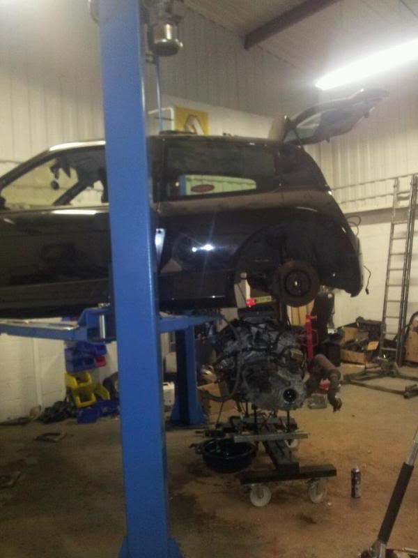

Last one we had in the engine come out for the belts, but I do know some people like to do them with the engine in, so it can be done both ways, your just have to have a look and see if your girl hands are up to it ;)

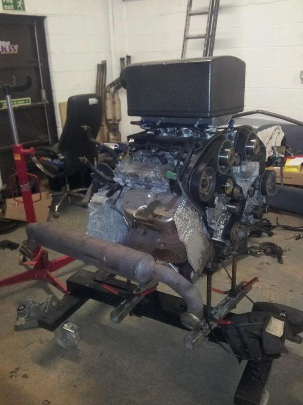

to do the belt PROPERLY its engine out, no way you can time it up perfectly with the engine in, NO WAY! if you're near Birmingham you can borrow the special cradle from me if you want, and the 8 locking pins AND the setting tools (its £1100 for all the tools by the way! LOL)

timing up a 172/182 in situ is easy enough, bit of a tw*t, but on the V6 you have 2 dephasers and all 4 pulleys are adjustable (and have to be undone when fitting a new cambelt) you can get the timing right but the belt tension wrong and vice versa etc, its 2-3 hours to drop the engine out, so why struggle!
