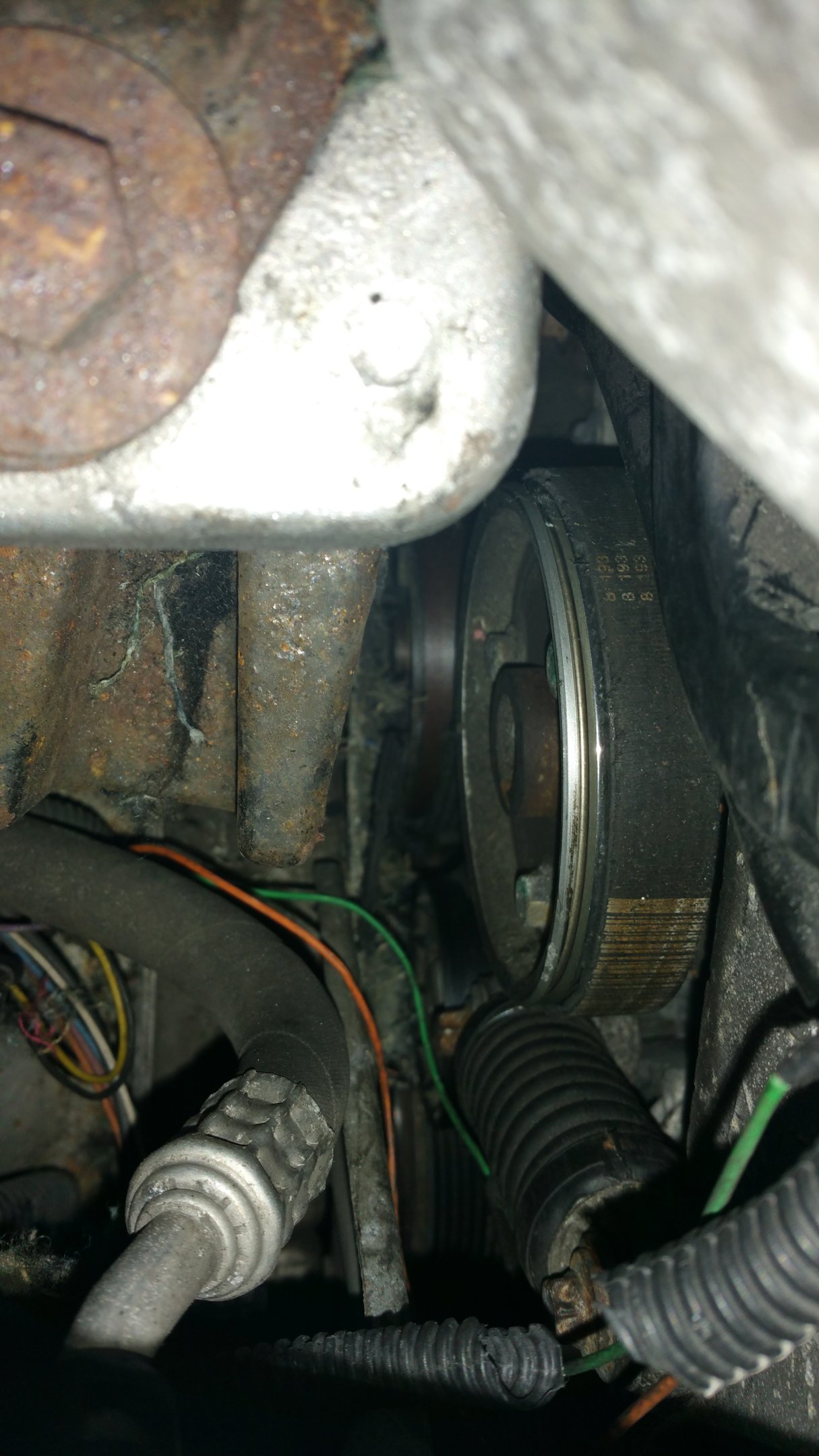

Car is on its way to have its belts done and it' gone, what are the odds! Unsure of damage. It just died spluttering and found part of my aux belt gone.

Has the outer edge of the belt parted company , or has the inner part of the belt ? , it looks like the belt has drifted over into the engine .

Outer edge towards the wing, but looks worn outer and inner on the lower pulley but it is still in one piece as far as I can see.

I bet the bit of the belt has found it's way into the crank pulley and taken the cambelt out or slipped the timing.
No metallic sound of the engine chewing itself up but you can't tell without opening it up I know. I'm hoping for the best but preparing for the worst.

belt has jumped and no compression :disrelieved:
it was coming in for cams so at least a head swap won't add much more to the bill and only about 45 minutes to the job but just seeing what heads i can find and take it from there.
As Carl said above its slipped its timing. Cams are moving when turned over but no compression so probably took all the valves with it. And to add insult to injury the AA guy sheared the tow eye, lol.
