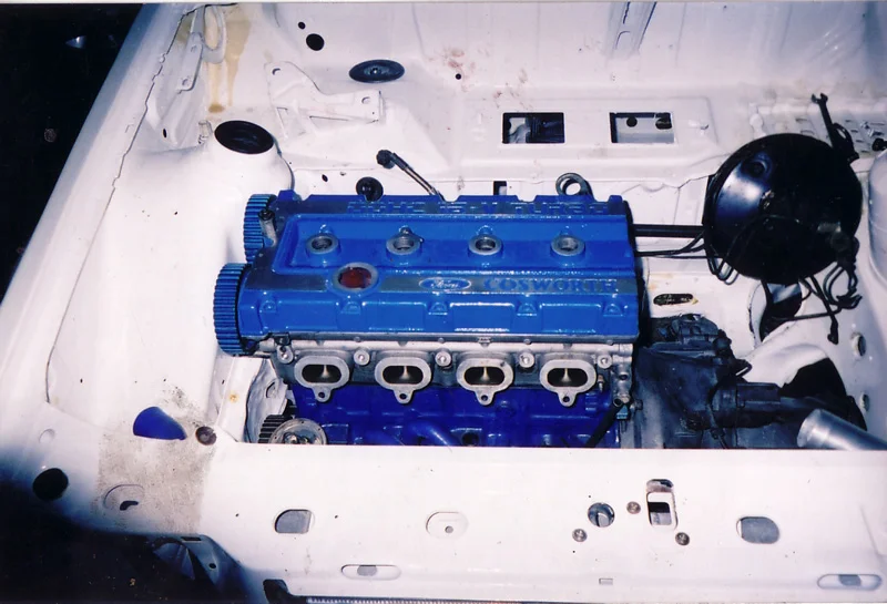

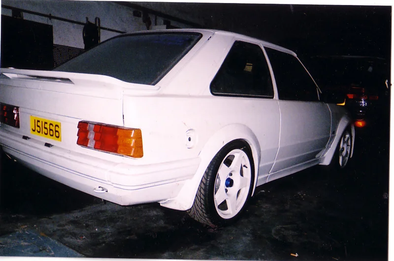

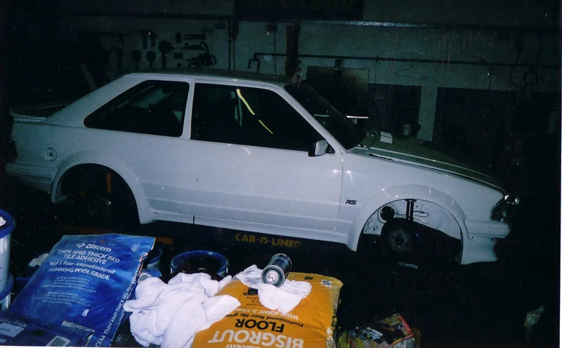

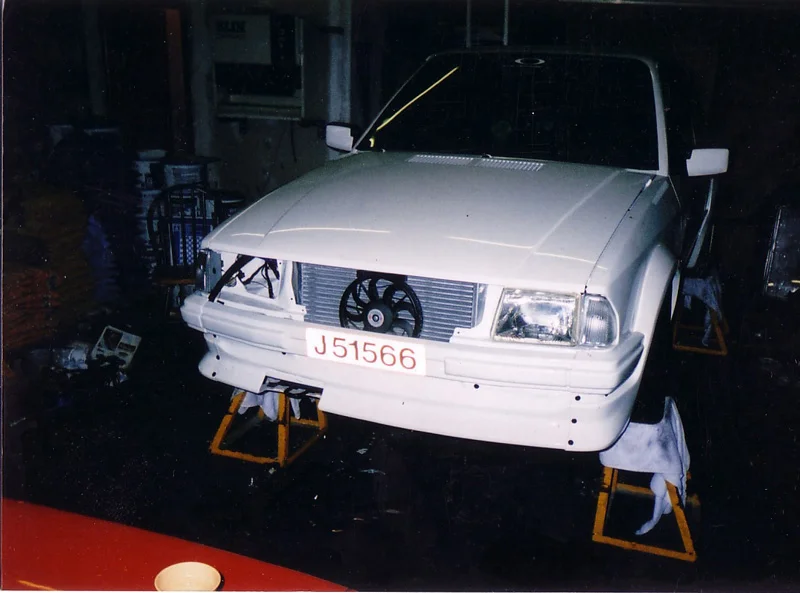

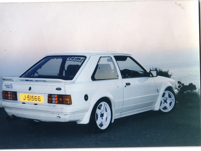

This is a little look into the car that kept me going for the last 2 1/2 years, and its finally finished (well near enough lol)

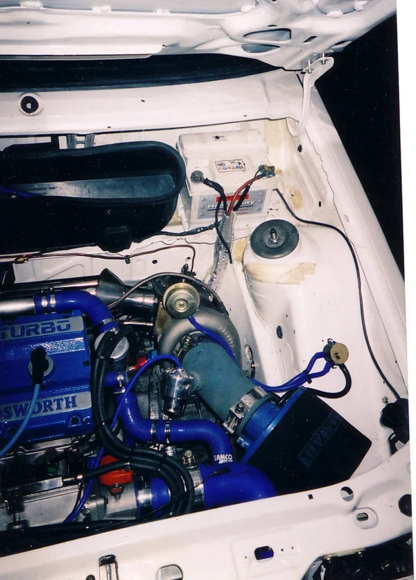

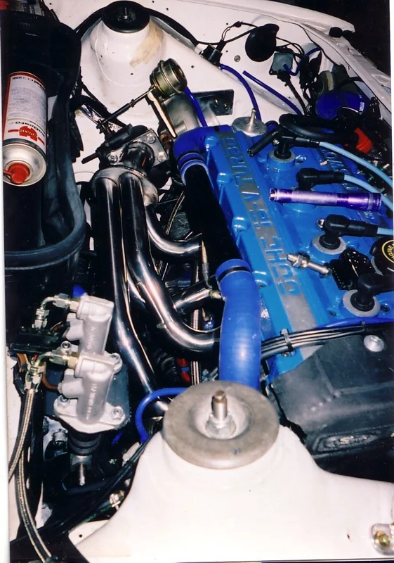

cossie s1's ModificationsEngine and Gearbox:2 Litre Cosworth
T4 Turbo
Green injectors
Electronic Boost Controller
Stage 3 chip
Full remap

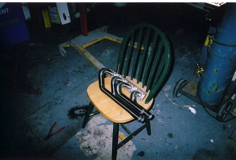

One off exhaust mainflod
GRS front mounted alloy rad
Pace intercooler
Much more!
Runing 378bhp at 1.3bar of boost
6 Pot Tarox front brakes
4 Pot Tarox rear brakes

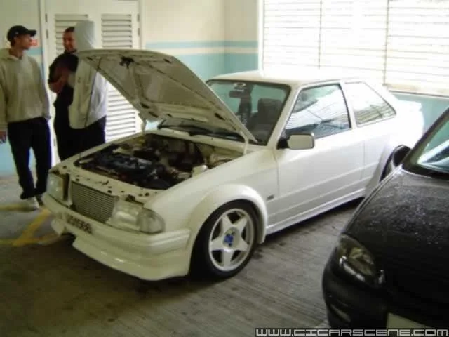

it's weird seeing a cossie lump mounted transversly...
you're a brave, brave man. lol

I have quaife LSD but the standard gearfox hates the power, i have lost first gear already but sill I managed to do 135mph in 4th not sure how accurate due to wheels etc... but it too much power for fwd im runing low boost most of the time 0.8 bar. love it. I will try and get some videos up the sound of the straight through 1 off exhaust system and the external wastegate sounds so mean.. Im glad I dont need an mot carried out on it lol.

I've noticed that engine in mounted transverse!
370bhp through the front LOL
It was the only way it was going to work!
And even so I had to get loads of 1 off things for like electric water pumps, both manifolds and the list goes on lol

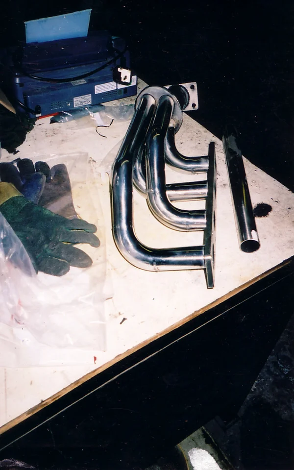

One of my best mate made the exhaust manifold and it took him 60 hours just to get it right (We had lots od clearence and heat issues lol) but hopefuly it will be worth it.

Looks like a hell of a lot of work has gone into it, love the way you've kept it looking standard too (best thnig to do with a series 1) as nothing needs chaging on them at all:)
I'd get a set of the side graphics on it too (although it does look clean without them)
