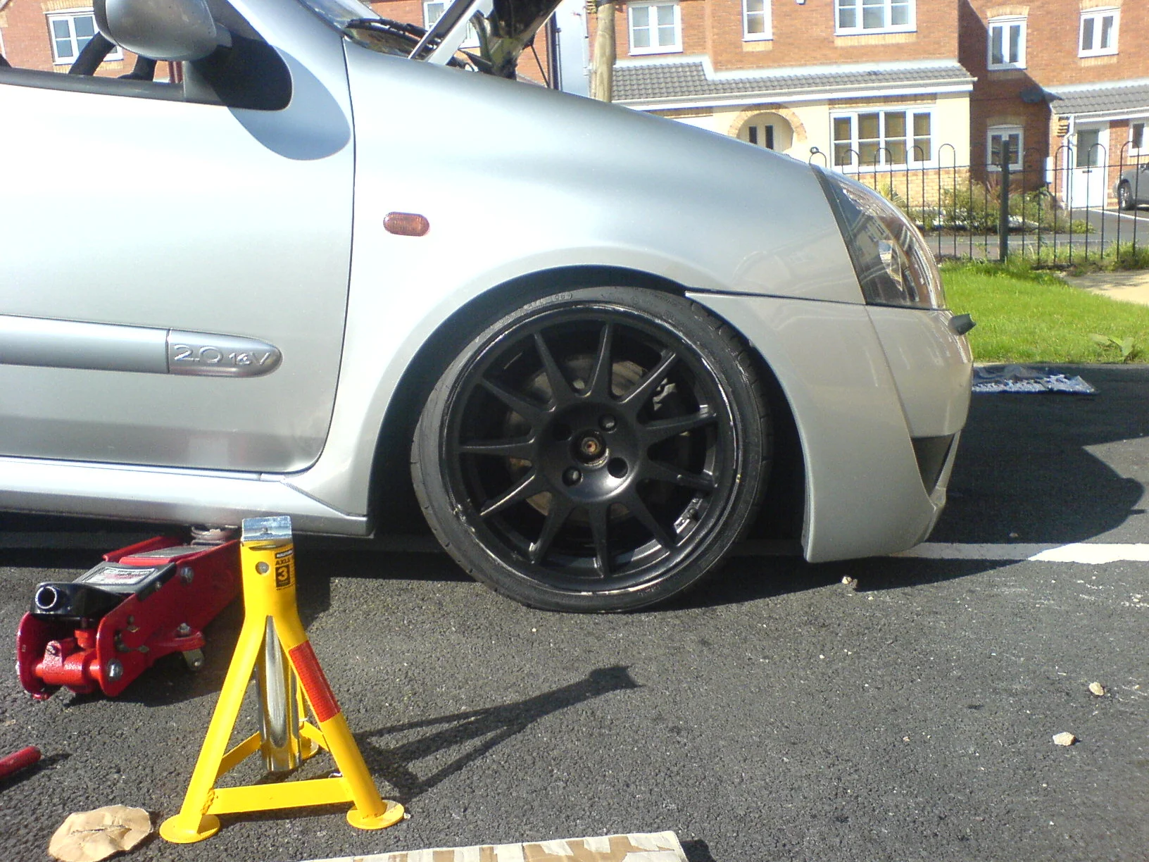

Just Fitted Front Coilovers - Is This Too Low!?
  CTR--VX220D
This is with the springs half way up the thread. I could litterally lower it to the floor if wanted :S

  K20 EG Hatch
that will handle shite and catch like a b*****d on the bumper brackets and bits towards the front of the arch.
  CTR--VX220D
Thought so .... its predominantly going to be used on the track though.
Im going to raise it about 15mm.

Your front bumper looks like its come loose there.... What type of coilovers are they and how much did they set u back?
  CTR--VX220D
They can go so low that the sump can touch the ground - FK's.

Oh and BTW - I can get away with lowering it more than people with std 16's because Im running 195/40/ R16's - it makes all the difference.
Aye maybe a wee bit low...
Same with H&Rs - mine have enough adjustability that I'm sure I could have the splitter touching the road if I really wanted.

  CTR--VX220D
All done - and tested. I raised it only 10mm and no scrubbing, and handles astonishingly good - cant wait to test the different damping settings.

measure 140mm from the small abs bracket to the bottom of the adjuster platform, thats about the correct height
