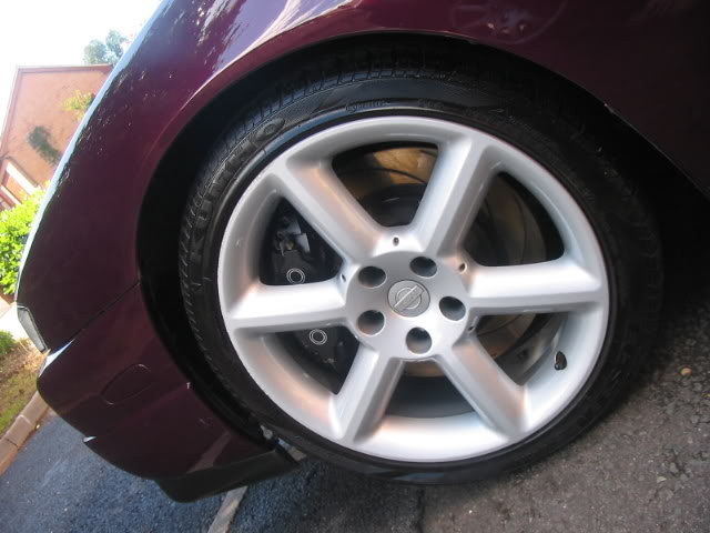

Just fitted my new brake discs

I think you put them on the wrong way round mate. Think the grooves are meant to face the other way. looks good tho.

how can you tell whether its a front or rear caliper and what side from that pic?
just curious
well on 182 the caliper is on the same side as the bumper for the fronts and the caliper is larger than the rear one which is closest to the bumper also.

The grooves should sweep backwards, so yes, the above discs are on the wrong side of the car. They need swapping over.
its debatable, i always install them with the grooves sweeping forwards, prodirve run the WRC with them sweeping forward on the front and backward on the rear
sweeping forward i find they give more "bite"
