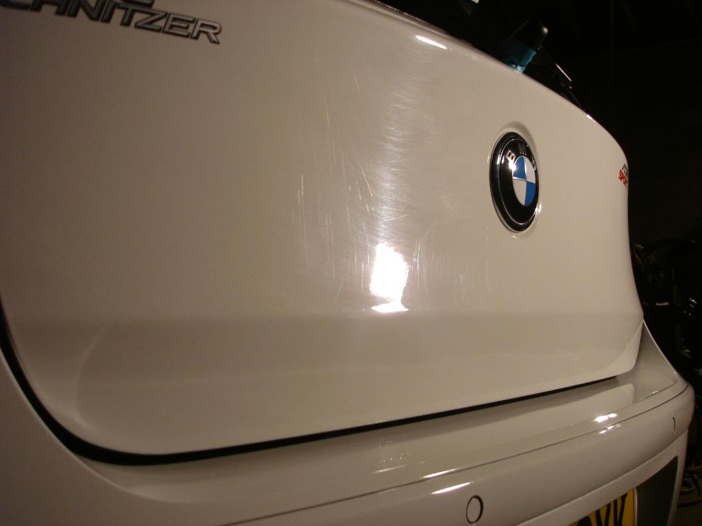

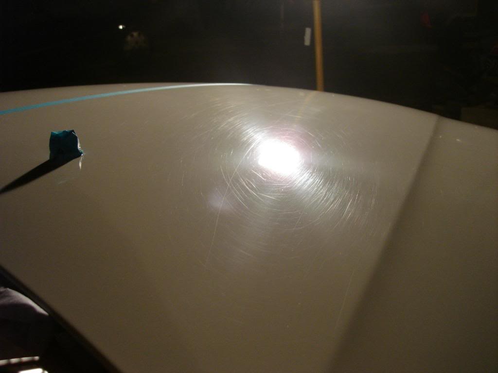

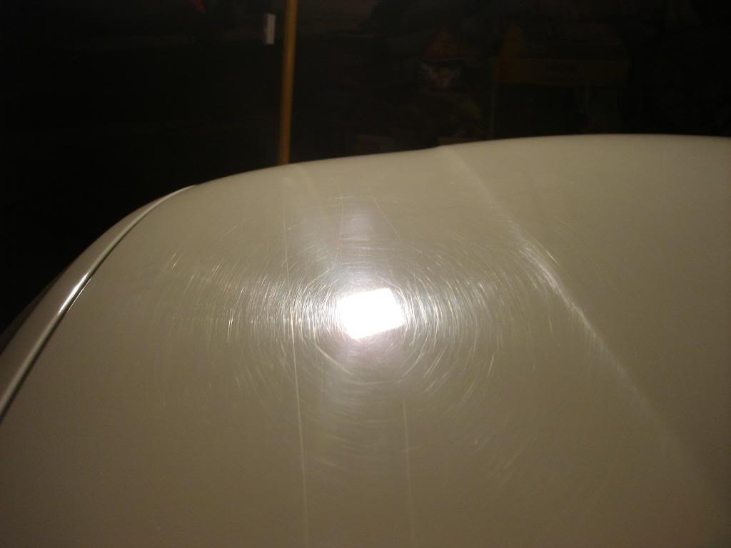

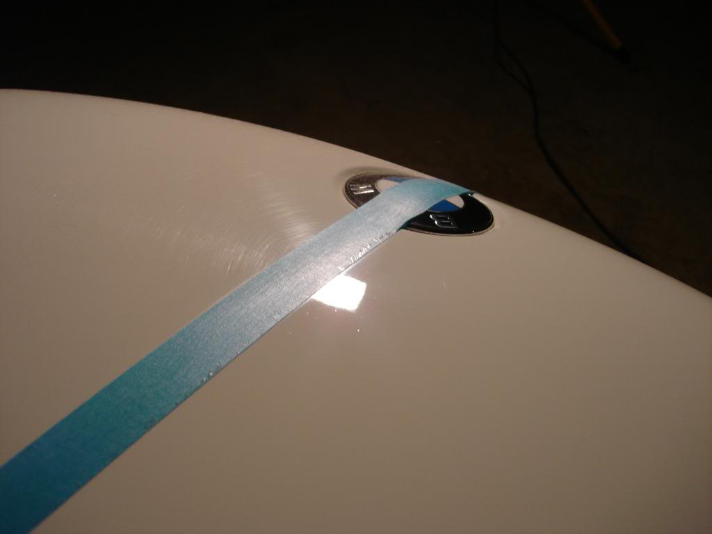

As i mentioned before i was detailing (or trying) my mates 118d. We as in 2 of us, spent 5 hours opn the bonnet alone. The guys at ACS have royally fucked the paintwork. I think wetasanding is in order but its not something ive done before and im a little wary of it.
Ive done a lot of merc's before and believe me they have been hard work but not impossible. i was royally stumped by how concrete like the paint was.
We did the full bonnet, but after starting the front quaters we gave up because of time. The pics dont express how bad the swirls were, they were ALL RDS ffs !!!
