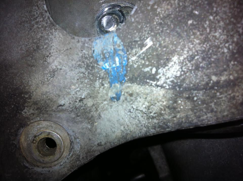

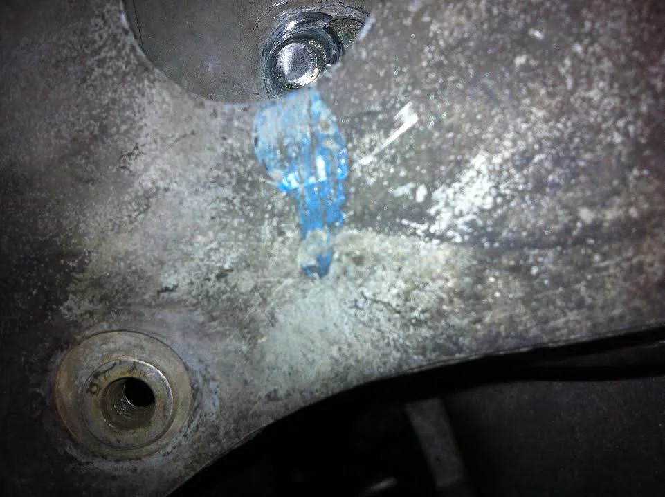

Lower gearbox mount ( http://i337.photobucket.com/albums/n393/Dannyd2134/P16-06-09_1510.jpg ) -
On the first one I got the stud broke as I tightened the buttom nut with a simple and short hand ratchet.
I had to pay to get another one. The new one was different in design, even the overall shape , and didn't fit correctly. I couldn't align the little circle at the top, otherwise the buttom stud wouldn't go in it's place. Not sure if it matters though.

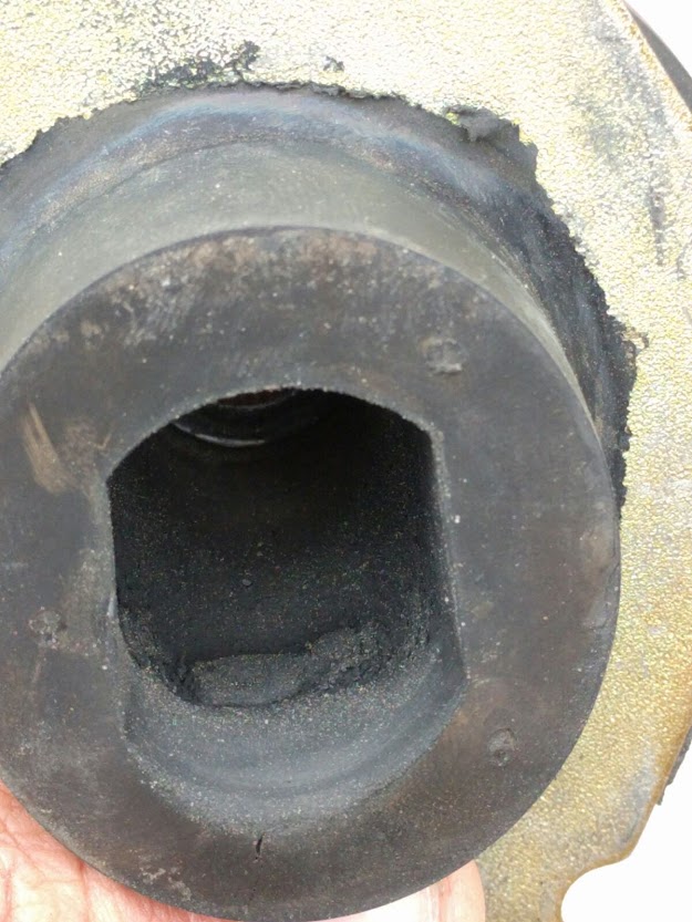

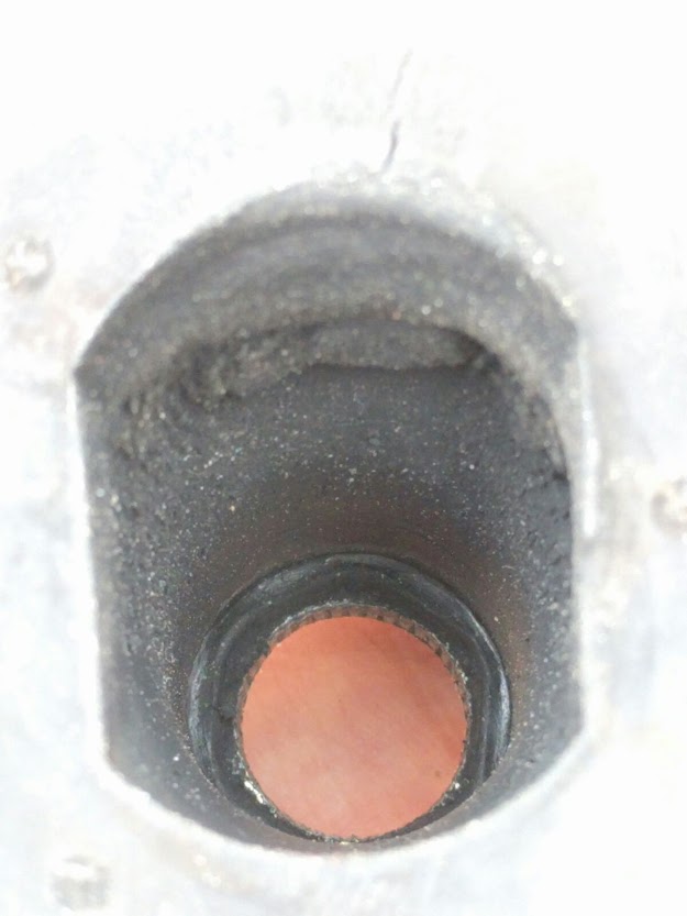

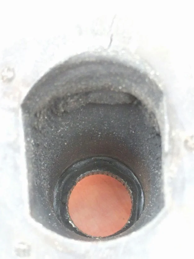

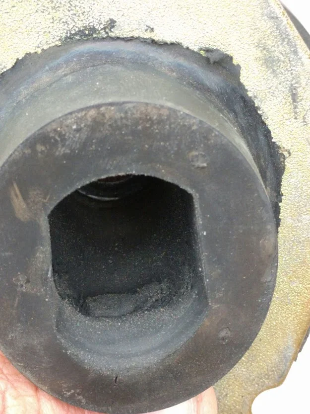

Upper gearbox mount (under the battery) -
I got mine in august 2015. 4 months later, Exhaust manifold started to bang on lower gears as if my dogbone mount was bad, so I loosened all the mounts, pulled the engine all the way forward with a jack and re tightened everything - still knocks on low gears. Took the battery out to inspect the mount - and it was done, photos included. A new mount fixed that.
