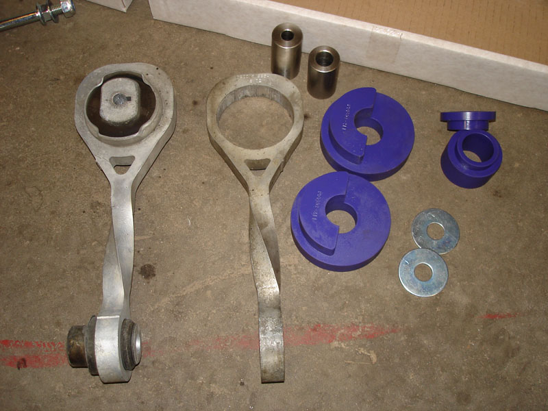

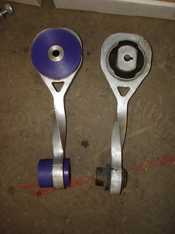

I came on here because I've got the new bushes and I made a bit of a mess of the old ones when taking them out :( The new one doesn't fit. It looks asthough I need to zip round the dogbone with an angle grinder to get the larger bush to fit. Is this the case?

replaced my dogbone for a power-flex one and solve the knocking. i also though it was the exhaust, i also changed the wishbone bushes. got mine from sorensen road sport. a lot cheaper!

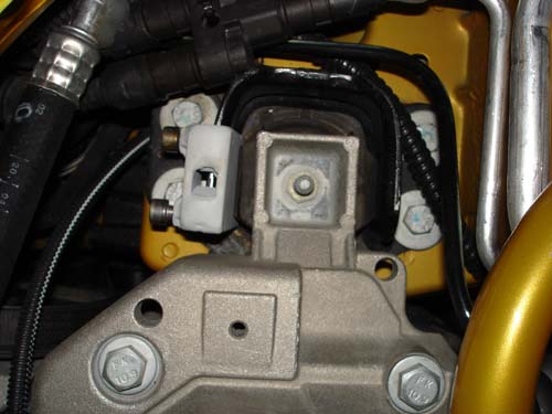

I think it works great, only negative I can think of is that the steeringwheel vibrates a some when the engine is in idle. No feeling of it as you start rolling. The large piece was a bit hard to fit but otherwise on problem at all.

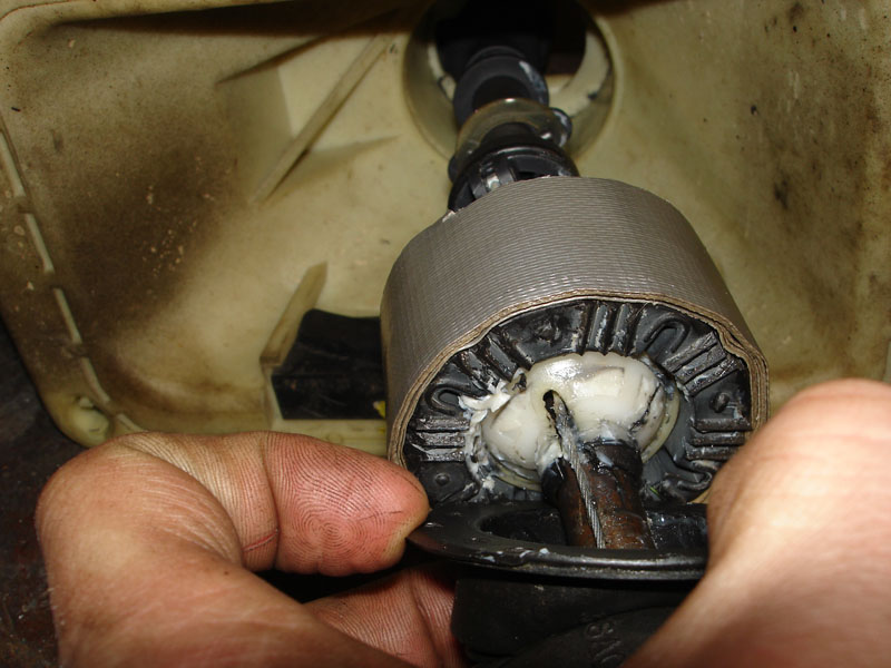

I also have modified the gear stick bush to make it a tight fit to the gearstick housing.
The play in the upper bush was cured in this way, no clonking what so ever. Had this solution b4 fitting the powerflex bushes and I must say that the powerflex bushes did not add anything for the feeling. But it is stiffer and better suited for track use imo. But i dont think that the lower mount is the source to the clonking problem, Im sure it is the upper right one.
