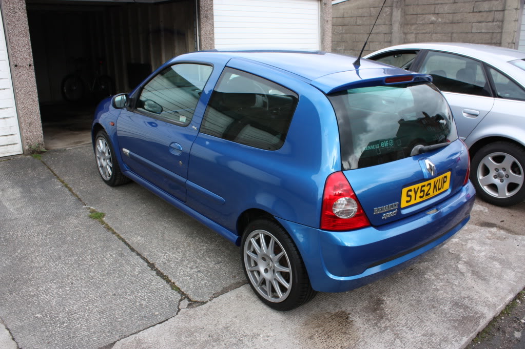

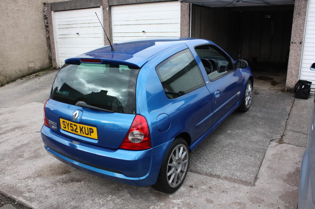

I've picked up a nice old A6 Tdi for sensible money which will serve as an everyday runner and tow car eventually.
One of my old mans mates is in the motor trade, to cut a long story short, he did a bit of enquiring locally to see if there was a suitable donor car to be had and within a few days he'd come up with something. It had been traded in to Hoggmotorco in Glasgow and sounded like an ideal candidate so I phoned Sean and arranged to go for a look.
The first thing that got my attention was the reg no' SY52 KUP
Turns out the car was first registered by Ness Motors in Inverness, and then one owner since they sold it in 2003. 80k full history, all mot's, reciepts, belt done etc. The car had a few cosmetic blemishes, a small scuff on the front bumper, wheels needing a refurb etc hence why Sean wasnt looking to retail the car but it was probably still a bit too good for what I was going to use it for lol Needless to say we did a deal and I drove the car home later that day.

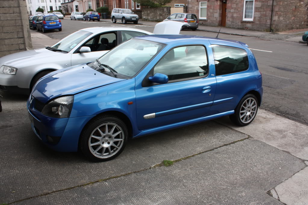

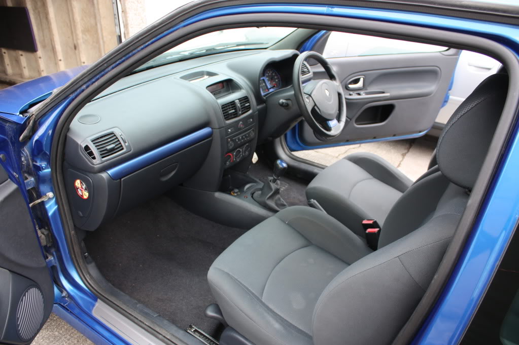

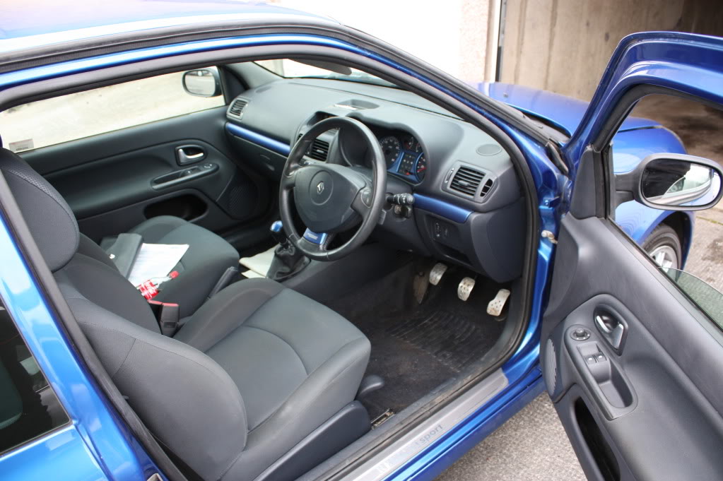

Some pictures from when I got the car, more to follow as soon as I get it up to the farm

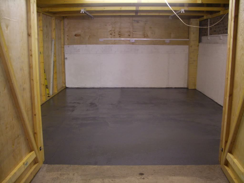

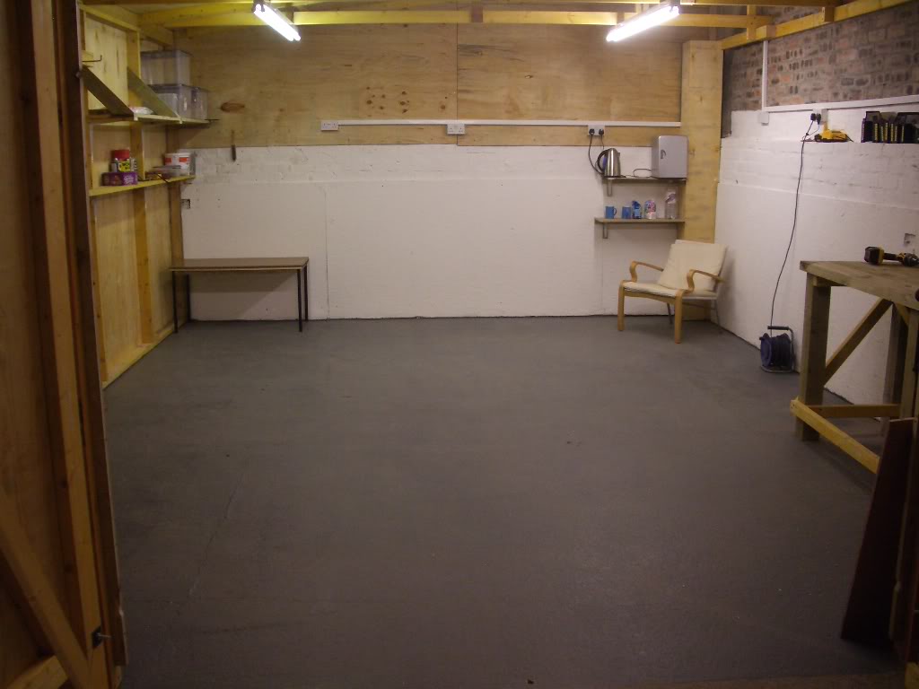

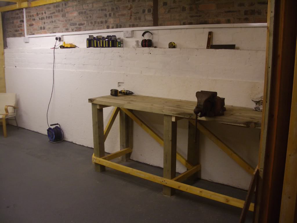

Still, i've managed to get the workshop built and it's pretty much ready for the car, put the second coat of paint on the floor this morning so it'll be properly dried by time I get home.
All thats left to do is to put up a few shelves, finish off the workbench and connect up the other two lights. I've got my compressor hooked up too so i'll have air tools on hand, and should be able to get my mate to paint the inside of the car once the cage is in.
It's going to be a long two weeks offshore! cant wait to get back and get stuck in.

Good size workshop mate. Plenty of space to work some magic with the car.
Good luck and keep us posted.

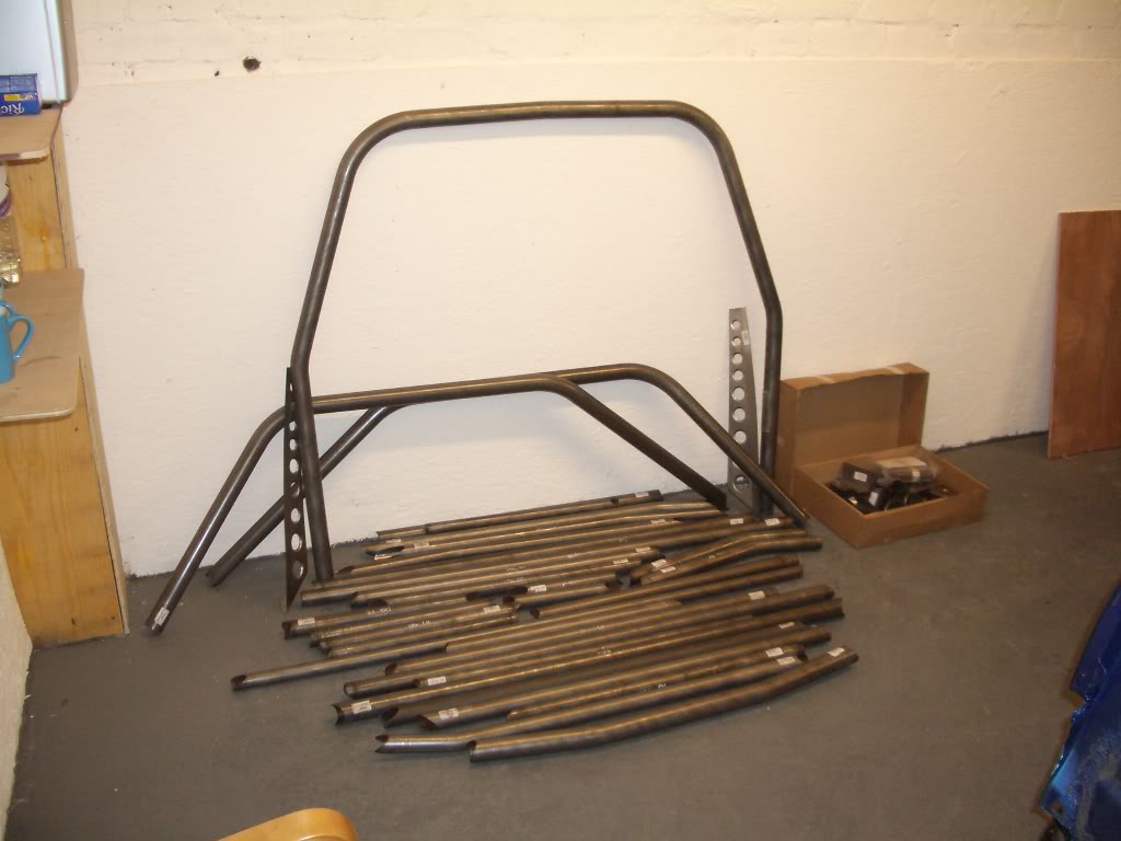

I phoned Custom Cages the other day and ordered the cage, went for the full multipoint in T45, hopefully it should be ready for when I get home :cool:

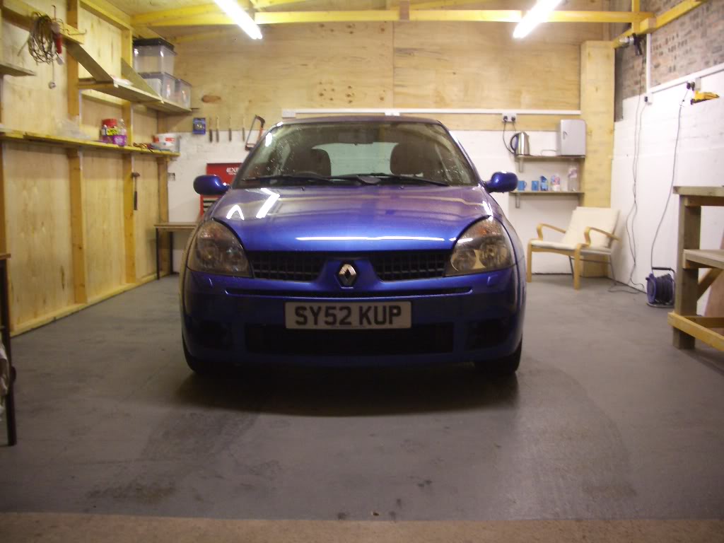

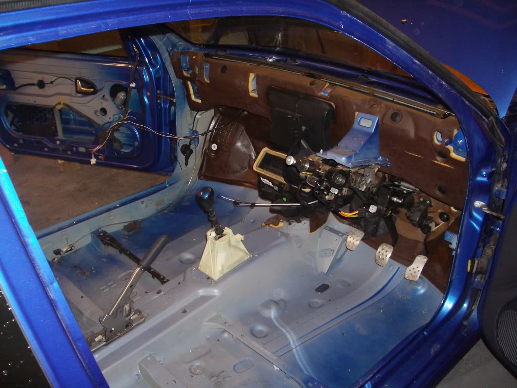

Finally got the workshop finished :cool: or at least to a stage where it's good enough that I can crack on with the car, i'll just add bits to it as I go

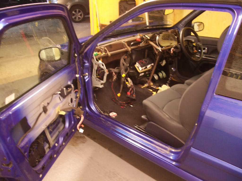

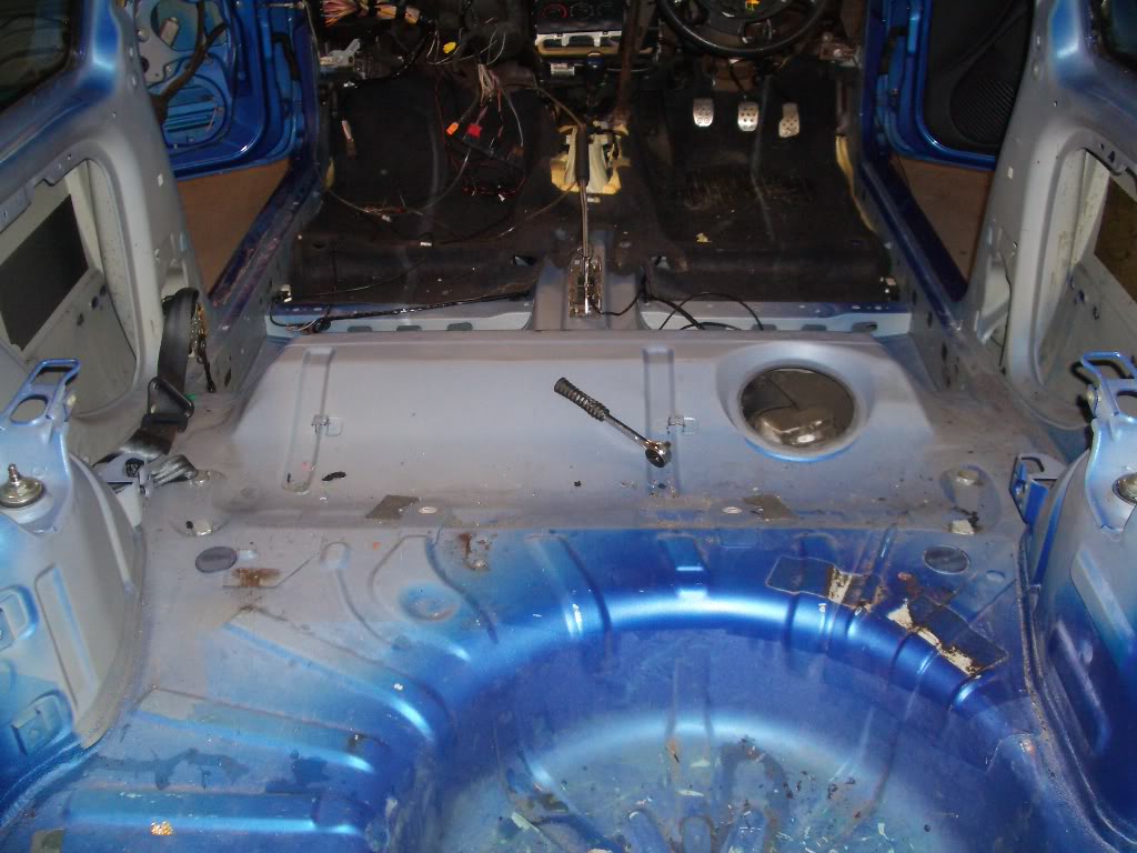

Got the car in about 3pm and continued removing the interior,
This was as far as I'd stripped it working from my lock up
A short while later
This is as far as I got with the interior

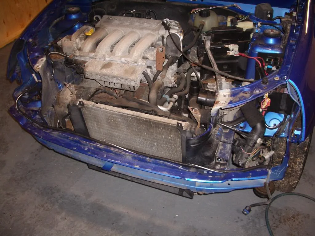

Then made a start at the front
Decided to called it a day at that, just happy to get the car in there and be able to get cracking with it.
Next time I'm there I'll finish stripping the rest of the interior, remove all the tar sound proofing etc and then work my way through the engine bay and get ready to pull the engine and box out.
Kenny.

The cage was supposed to be here today, i'll need to phone them and find out what the hold up is. Still a wee bit of work to do before it's ready to fit so not a big deal just now.

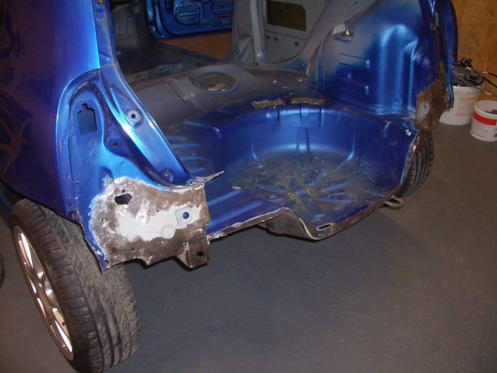

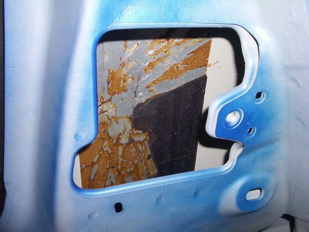

When I initially removed the rear bumper I was suspicious the car might have had the back panel changed at some point, certainly wasnt a major bump as the tyre well etc was ok, no signs of creases or kinks anywhere just something about it didnt look factory.
Decided to dig a little deaper today and sure enough the back panel has been replaced, guessing it was a while ago though, the date stamp on the bumper is Aug 03 so could well have been when the car was only a year or so old.
Unfortunately the seams couldn't have been sealed 100% and water has been getting in, hacked/buffed all the seam sealer off and it wasnt in particularly good shape.
I decided to bite the bullet and cut it off. Phoned and ordered a new panel which should be here in the morning.
Some of the returns on the boot floor look to have been ground very thin during the first repair, and combined with a bit of rust, bits of it literally just fell off so I'll need to fabricate some new sections to be welded in.
It looks like the bump was on the offside corner under the light, the Chassis rail is fine though, had a good look and it's all straight, no sign of any split seams or creases so not the end of the world, easy enough to repair, and I suppose it's practice for the next time i need to change it, if and when I smack it ! Also a good excuse to see if I can chop some excess metal out when the new panel goes on ;)

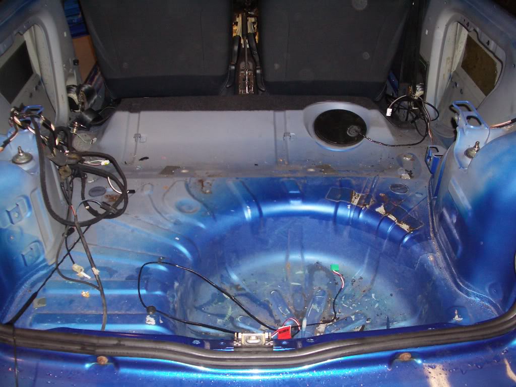

After a few hours with a grinder and an air saw
I also cut off any unnecessary brackets etc from around the back seat and the boot area.

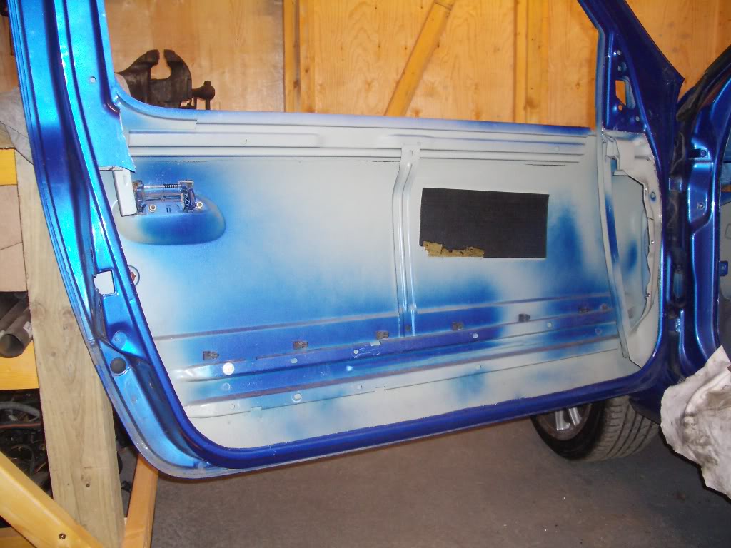

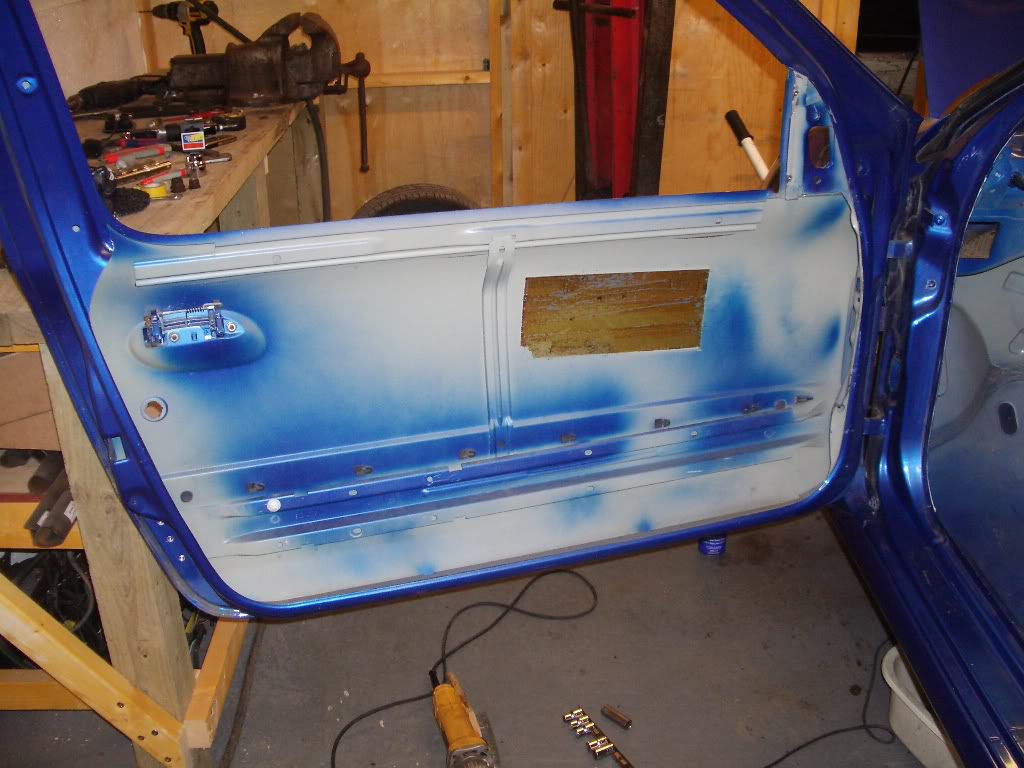

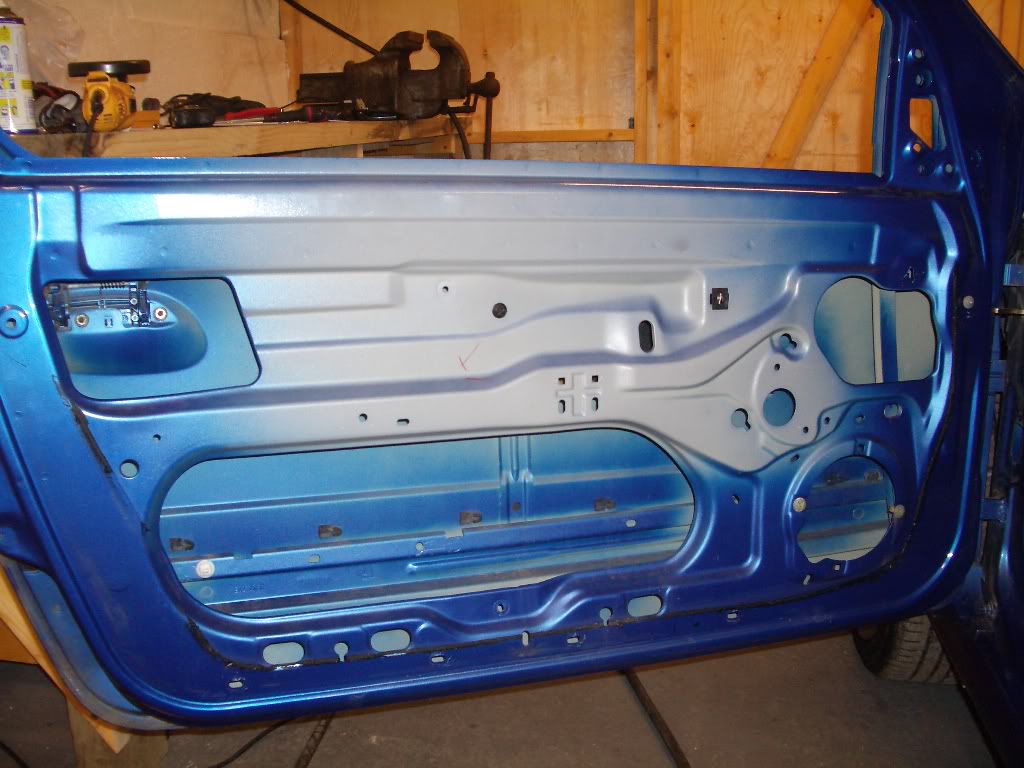

I then decided to have a look at cutting some weight out the doors,
Before:
After
Still got a lot to come out obviously, but the air saw makes a real racket so decided to call it a day at that. As I'm sure most of you know the top section of the door is very thick, not got a set of scales up there yet but definately a good saving getting that out. The door now flexes a little bit but certainly no worse than a fibreglass one. I may go to fibreglass doors at some point but for now I think i'll settle for gutting the steel ones.

Not a great deal more to report, tidied up the passenger door and trimmed about as much out as I dare, need to take it off so I can drill out the last 3 spot welds holding the door bar in, but once thats out I recon that should just about do it, it's pretty flimsy but it'll serve it's purpose, all it needs to do now is keep the worst of the wind and rain out.
I did my usual and completely forgot to stop and take any pictures of progress :eek: but once I'd done the door, I removed the rear brake lines, fuel tank, filler neck, lines etc. I'm not going to be using the standard tank, got a few ideas for the new one, but nothing confirmed as yet. I also stripped the front suspension, separated everything then put it back together loosely, so i can put the wheels back on as I may want to roll the car outside and give it a blast with a pressure washer.

Ooo kenny you have gone very hardcore with the door cuttage!! How are you going to attach your plastic windows? You appear to have cut the bits off which you usually would have put self tappers into. You will probably need to bond the window in all the way along the bottom of the window.

Cheers, progress has been a bit slower than I'd have liked but there's only so much I can do in a day working away on my own.
I'm going to use some M3 or M4 stainless button head allen bolts and go through the small lip on the outside edge of the door, probably going to need about 20-25 of them. Not going to be re-fitting any of the door seals etc

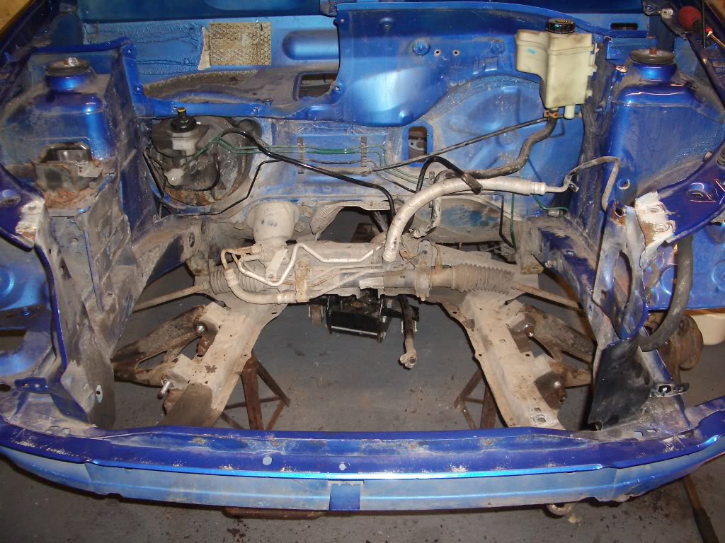

Fairly major change of plan:
Last week I continued to strip the car down and got it to nothing more than the bare shell and two bits of glass still bonded in. The car was very cheap and I knew when I bought it that it was a bit grubby underneath and some of the suspension parts etc I could see where a bit rusty but I wasnt too phased by this as everything was going to come off and get shot blasted then either painted or powder coated.
However, during the final stage of the strip down it was becoming clear that the rest of the car had weather quite a bit more than I had initially thought. Just about every bolt I touched was seized solid and was either a total pita to remove, sheared off as soon I looked at it or had to be cut off. Then, once the rear beam and fuel tank were off the true state of the corrosion on the shell was evident. The "wee" bump it had at the back several years ago no doubt contributing to that or more so the poor repair that was done. There was also the begining of some rot on the sills under the side skirts, the area round the filler neck and the inner wheel arch behind it were also in a poor state, everywhere I looked I found more and more bad bits.
I sat in my thinking chair with a cuppa and pondered over what to do :dapprove:
I knew everything was repairable or redeemable but it was going to take a lot of hours and require quite a lot of metal to be chopped out and replaced to make it right.
So i was faced with a bit of a dilema, carry on and fix the shell then fit the cage to an already tired/repaired shell or look for a new shell.
I looked in the local adds for 172's and found a few potentials, I went for a look at 2 of them but for the money they wanted they werent really good enough to warrant the expense, I would also have to sell off the left over parts to try and make it worth while.
Final option was to enquire about a new shell, so on the phone to dealer and asked the question, with some discount it was a very tempting proposition. I had a think about it for a few days then finally decided to bite the bullet yesterday and ordered a new shell :p
I'm back offshore now but it should arrive when I'm about due home. It's put a bit of a dent in the budget but at least now I know I'm starting from a straight shell and I can paint the whole thing inside & out and underneath in what ever colour I like without having to spend for ever cleaning off 8 years of road grime.
