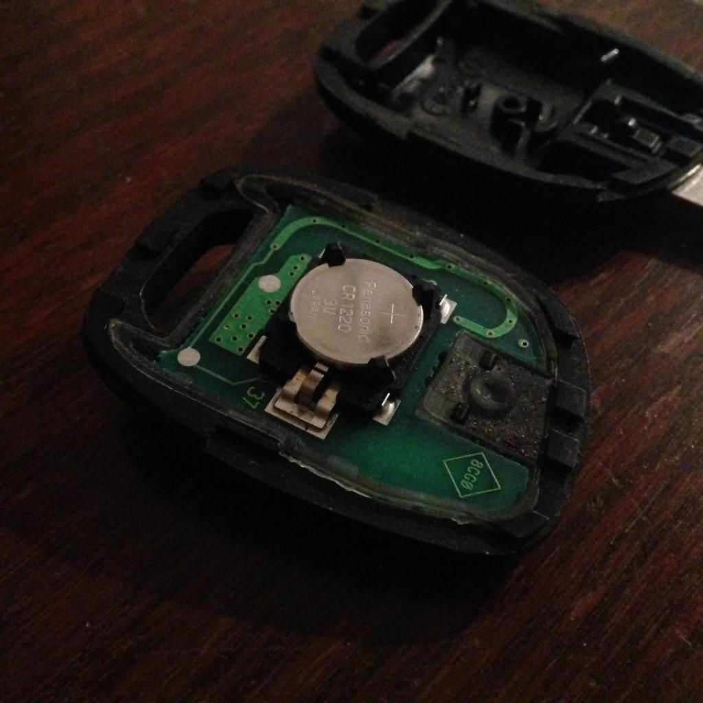

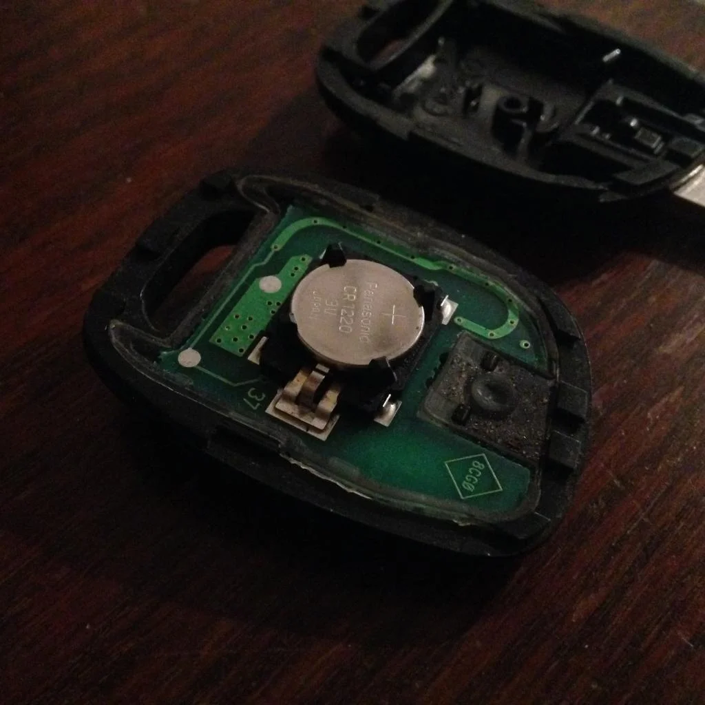

Hi guys i picked up my new 172 cup yesterday on a 03 reg quite clean too. After getting home i realised the central locking was not working and when i texted the guy he said i lock it by the lock on the door which doesn't lock the boot or pass side door unless i press the lock button on the dash Great!. I was going to try a new battery but i don't think its that it looks like there is a piece missing from the inside of the key' . Can anybody post me a pic up of the inside of the chip board in the key to see if mine looks the same or if somethings fallen out of it? . Thanks again .

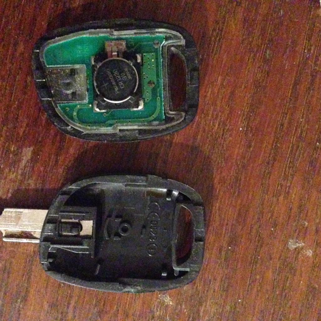

do you have a pic of the other side of the chip in it too please i know for certain the black rubbery bit is missing,

My spare broke recently, on the other side of the chip, there's a small black button. That had broken off. Got engineer at work to solder it back on.

hi yep the switch has broken off it and looks knackered so it looks like il have to get it in for repairs somewhere hopefully.

The two bits on either side of the switch, if you touch both bits at same time with a key or something metal, it should unlock and lock your car.
