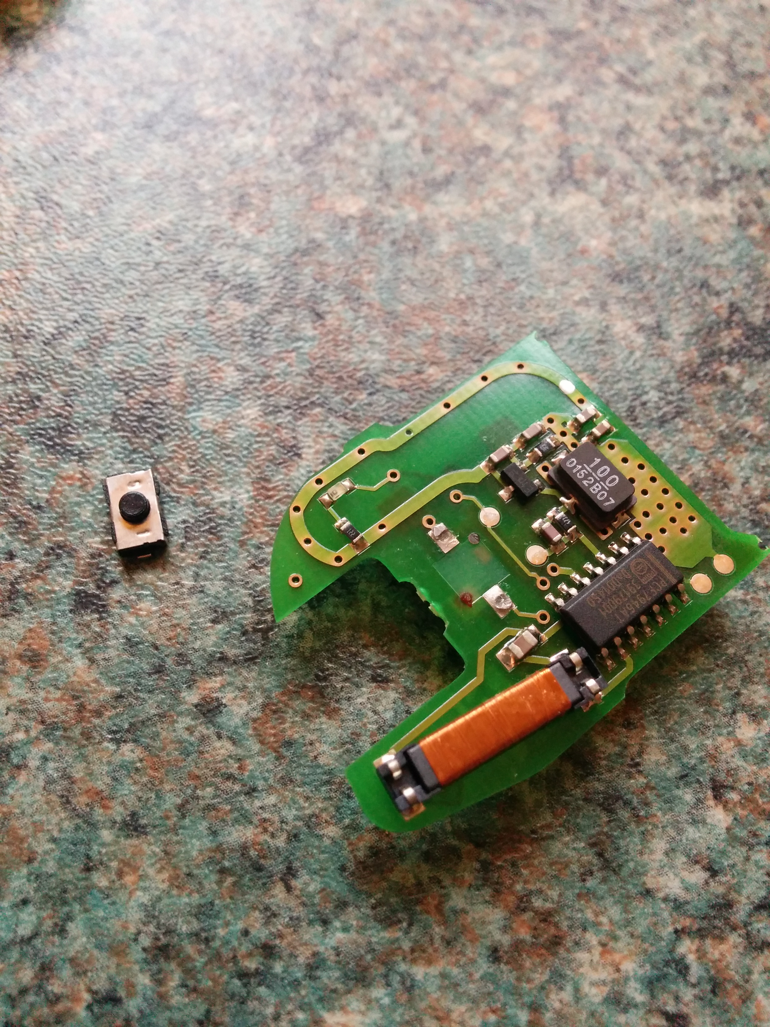

I have a small problem with my key, the button stopped working. I opened it up and the tactile swtich has snapped off the board.

couldn't a new button be soldered to the board?
failing that remove the chip and put it on a working key and you wont have to pay for reprogramming

You 100% cannot use the method above to sync a virgin key as that's not how PIN security works. You will need a new key i'm afraid OR as above, solder a button to the PCB. Its very easy and if you take your time will win.

Stick a new switch on. I had to do mine. Robbed the swith from a spare remote for one of the vans at work :) easy peasy

when mine did this, before i solder'd it, i put a tiny dot of super glue on the bottom to secure it more. mainly because one of the metal contacts had stripped from the board. so i also had to paint one of the contacts on the board with some repair stuff from maplins lol
