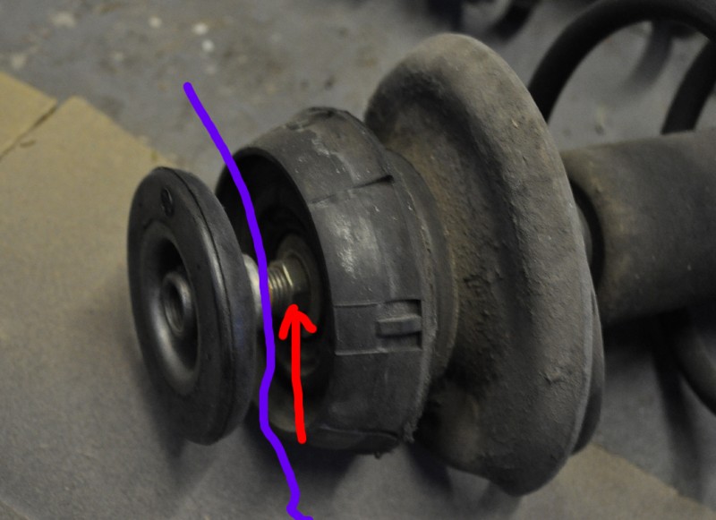

Just found this picture from another thread. The rubber part to the right of the red arrow is what i imagine has worn away and is knocking against the metal work?
Is that a part that would stay on if i was to replace the shocks/springs with coilovers as that is my next plan.
