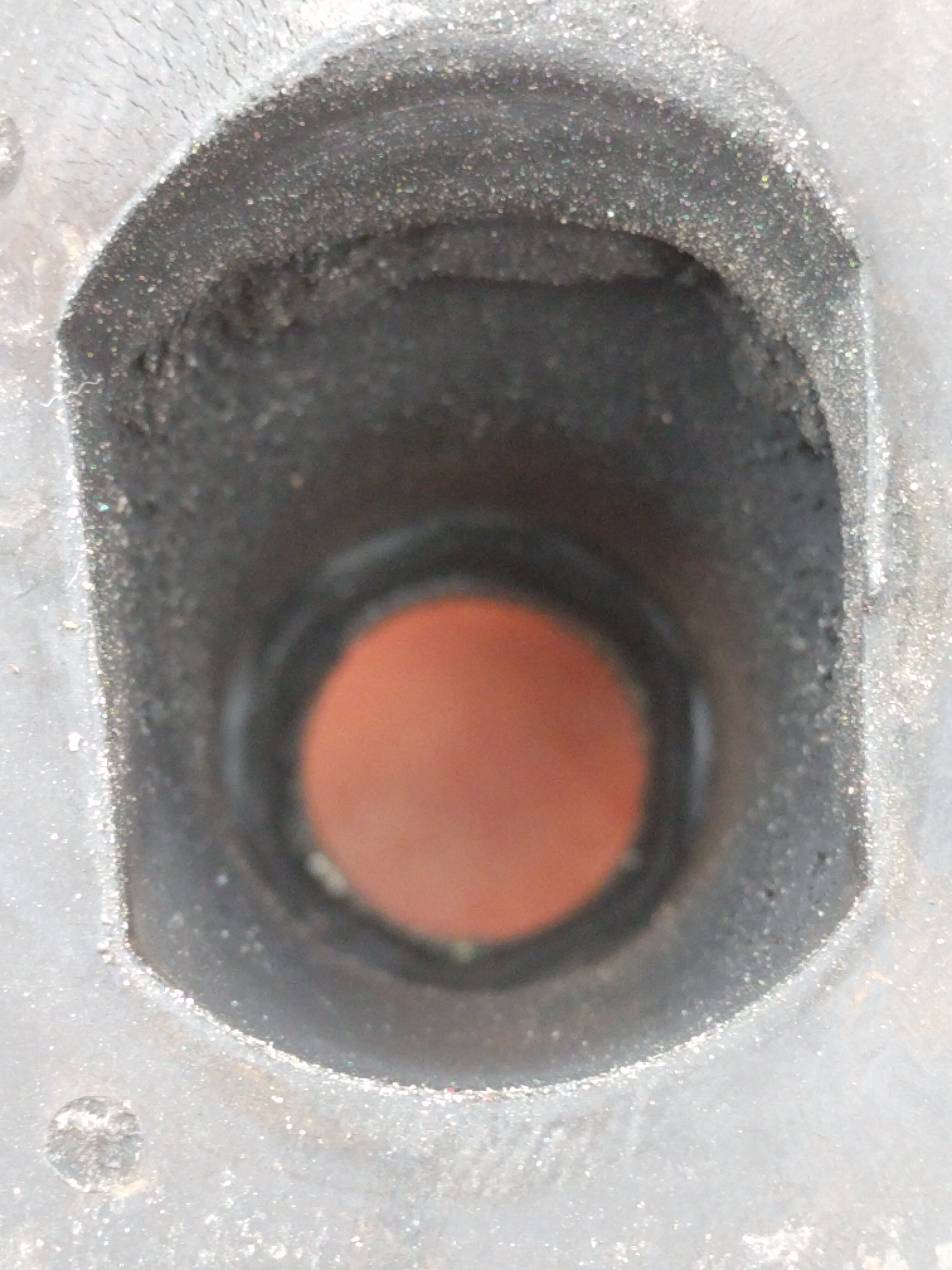

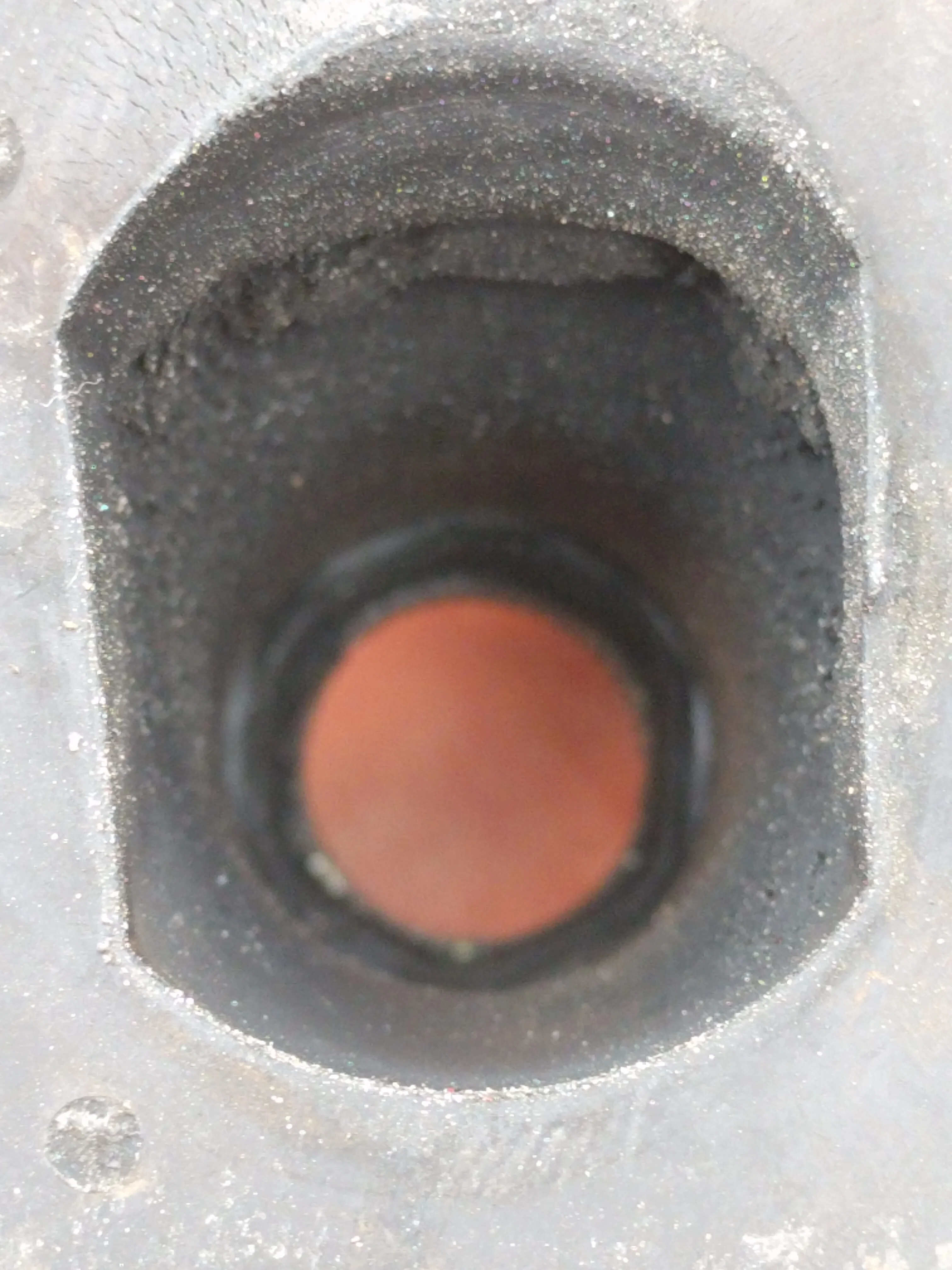

Turned out to be a faulty top gearbox mount.
It's only 2-3 months old, from k-tec. I read their oem replacement mounts are low quality so I guess it's true.
Fitted the Renparts upper gearbox mount yesterday. Had some fun and games with the large bolt being seized into the bush, but got it done. Pulled the engine forward a bit on reassembly and it seems to have cured it. Hopefully the supplied Ocap bush will last a fair while. Still not happy with the gearshift, but I suspect that's me being picky!
