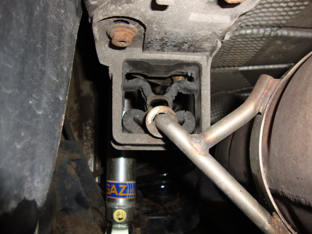

When coming off the accelerator? It's only just started on the way home, also the suspension seems amiss and 'floaty'. Could this be an engine mount?

A weird vibrating coming from underneath the car/ when you let off could be an exhaust mount as the rubbers usually perish.

Cheers, seems the dog bone bush is shot. The exhaust hangers don't look in great shape either and will need doing soon.
