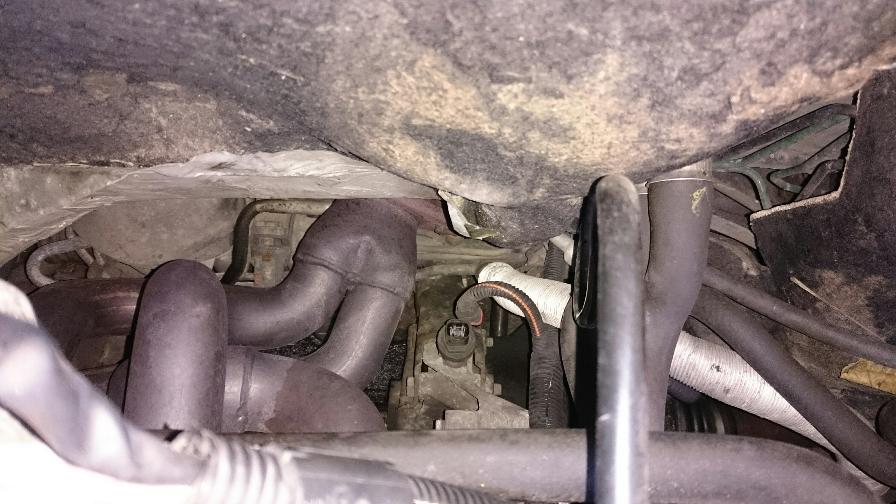

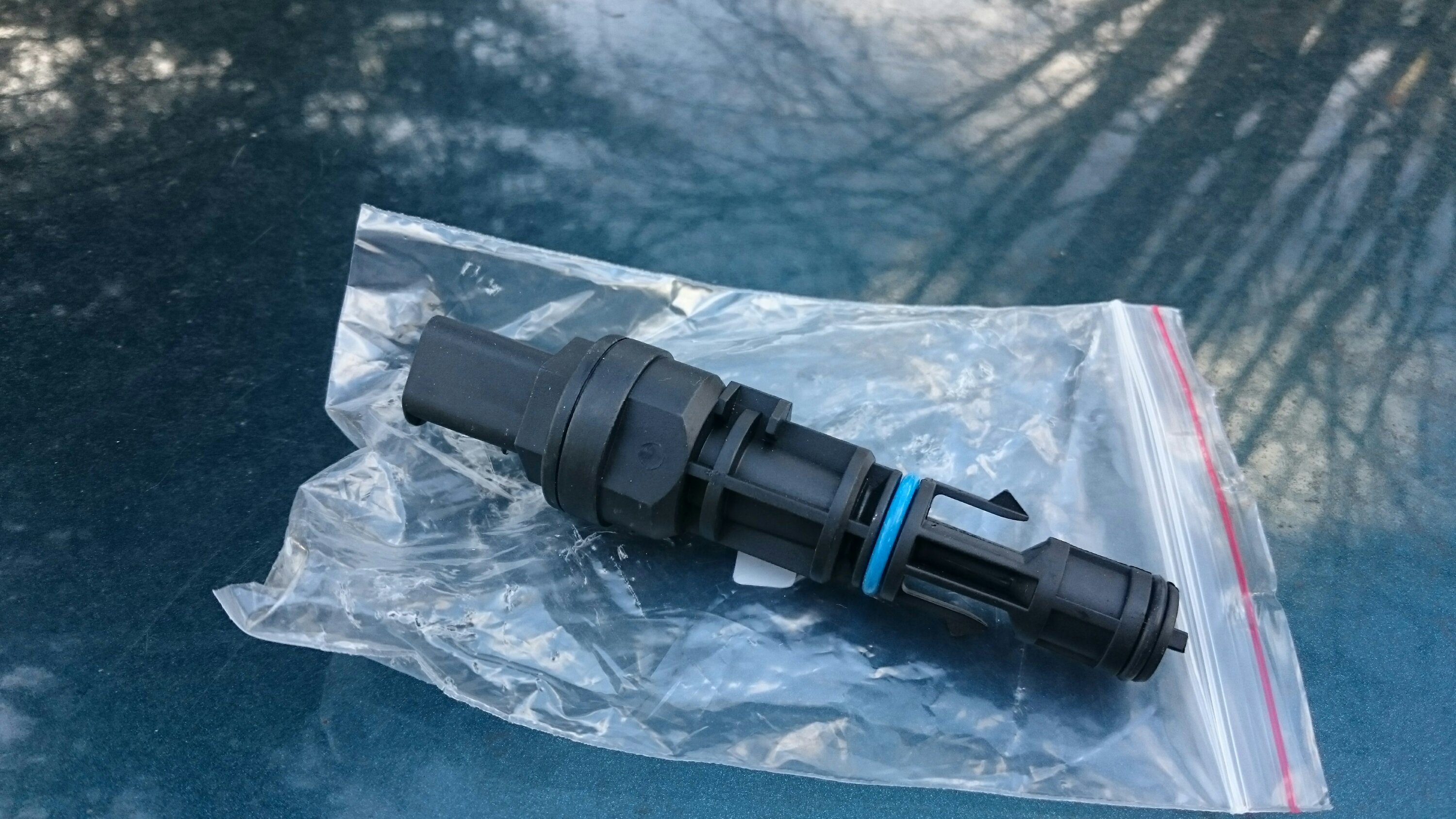

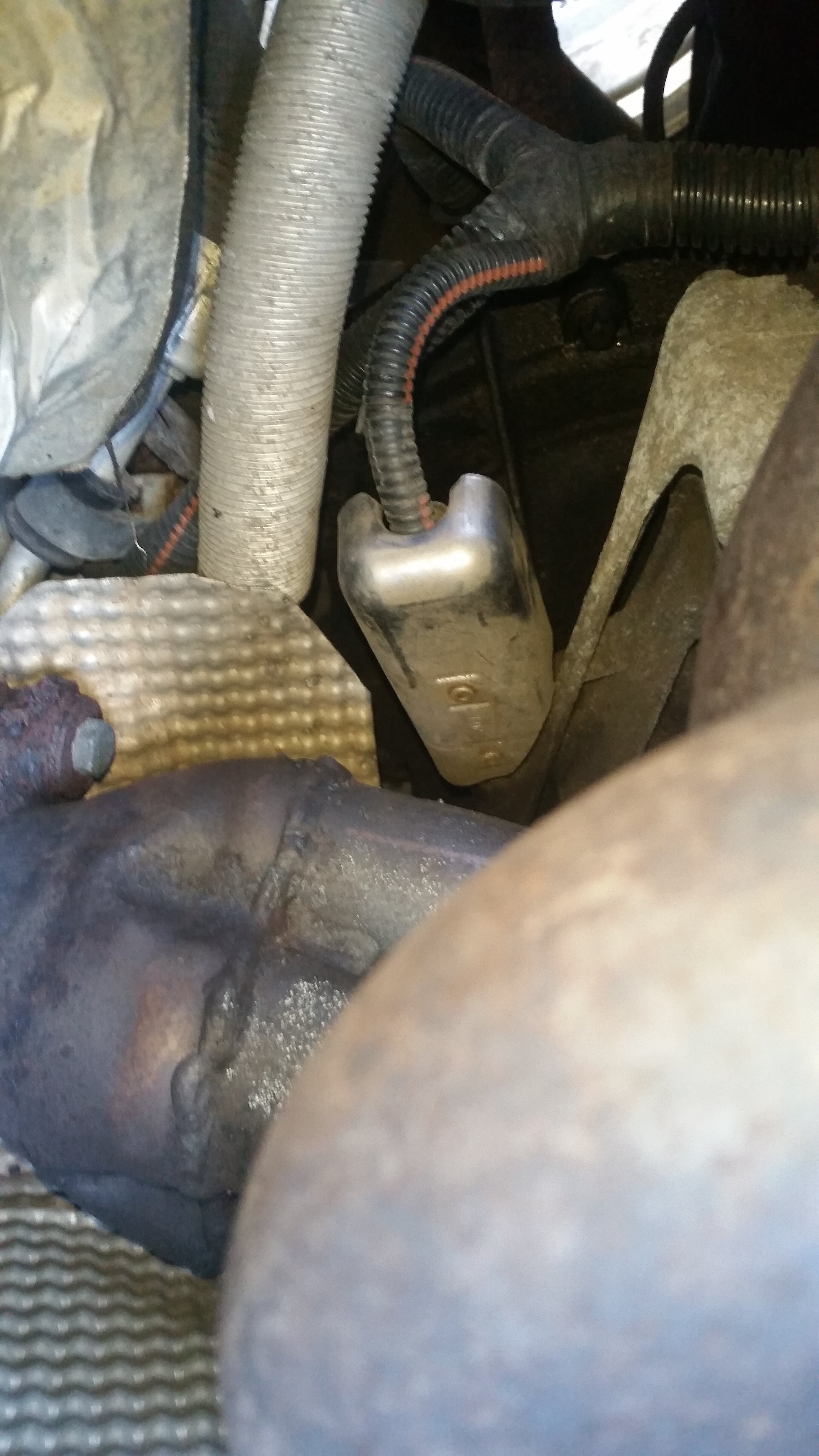

I've had this issue of the speedo drop to zero. At first it was only doing it a few times then it would stay at 0 for 5 to10 seconds before going back to normal speed. Replaced the Speedo sensor and that fixed it.
Renault Part Number: 7700418919

I too had to change the speedo sensor on the gearbox on my 172. Same symptoms as your having and it was such an easy fix to change. Definitely worth changing it for the cost
It does change (I think) the throttle sensitivity in 4th and 5th gear, for which the ECU will use the vehicle speed to calculate which gear it‘s in. When speedo drops out, if you’re in 4th or 5th you’ll notice a change in response.
