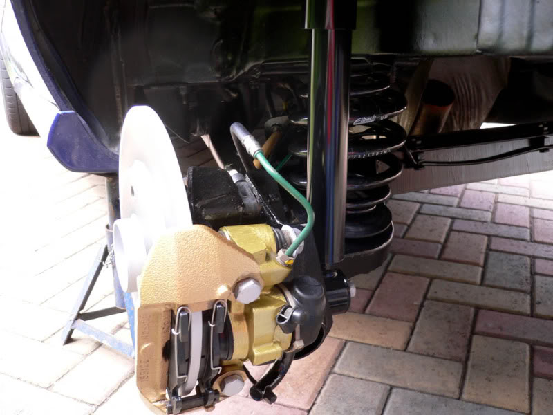

When slowing down I've got a knocking sound from the near side rear (where it sounds like it's coming from anyway)
I can only hear it when pressing the brakes, but it does slow down when the speed lowers.
Have you guys any idea what this might be?
Cheers
Corby
  182
Check the rear pads still have springs attached and shim is still in place.
Also check the pad material has not divorced the backing plate.
