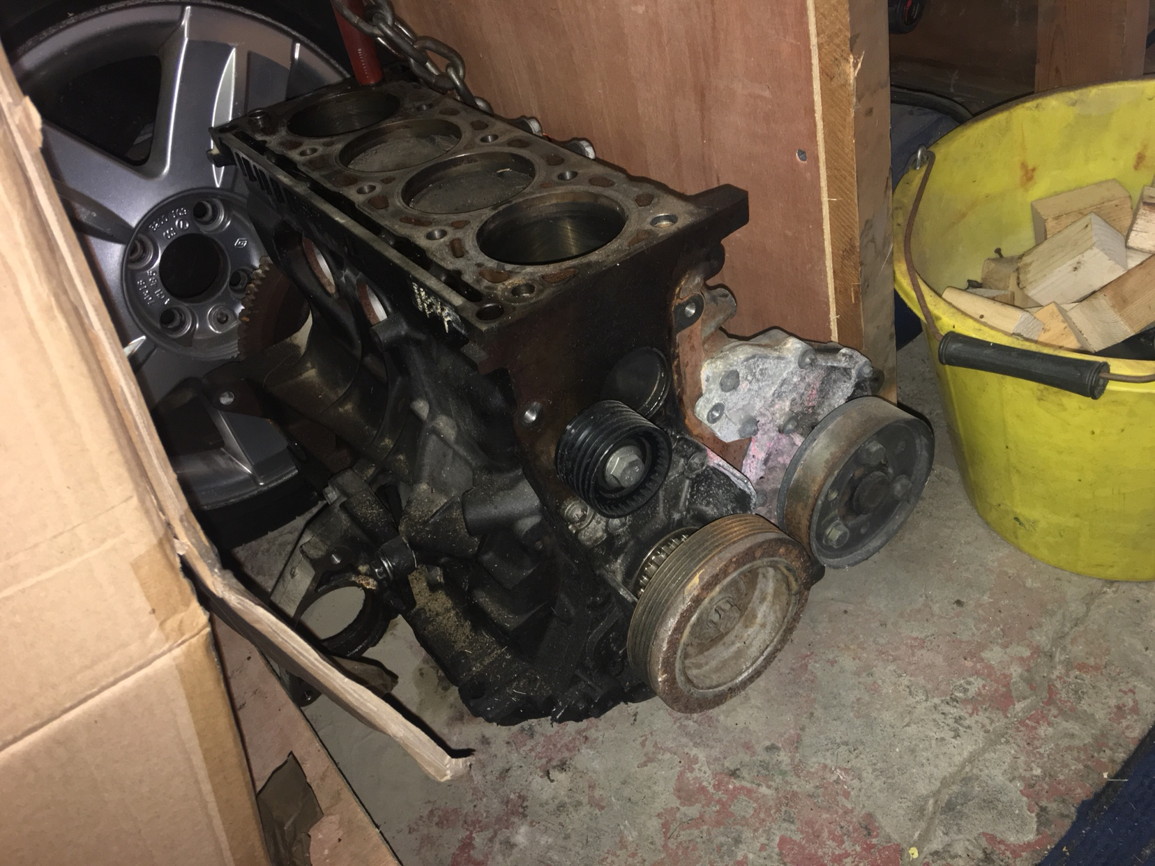

The original engine blew up on 78k with no history of belts done. Span a big end but given the lack of history I’m assuming the belt had never been changed. At that point in time a new engine was £250-300 so was more than worth the risk of snapping the belt given a replacement was cheaper than a belt change

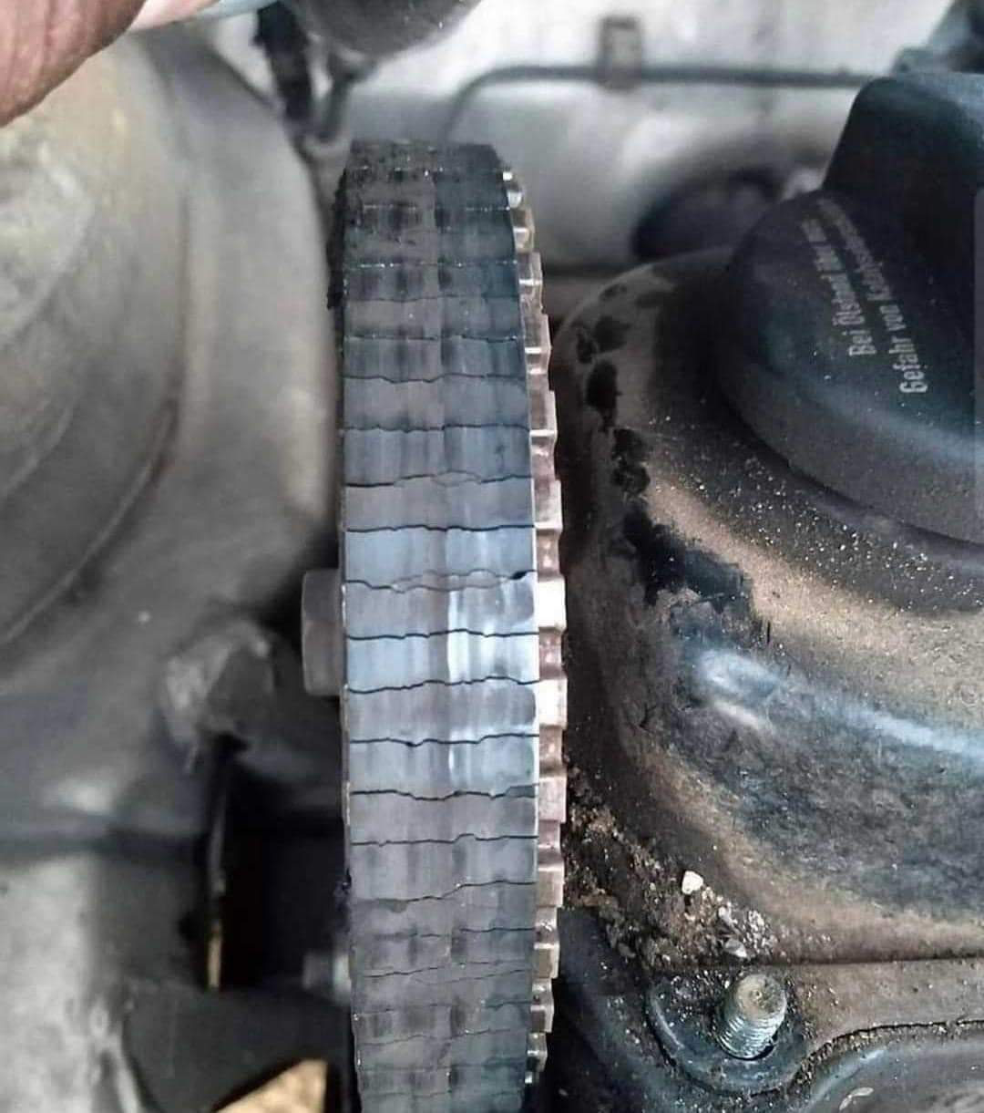

Ive seen some that are still in good nick when changed due to age, and ive also seen some that are on the verge of failure with cracks all over. Russian roulette sadly, also got to factor in tensioner/idler condition.

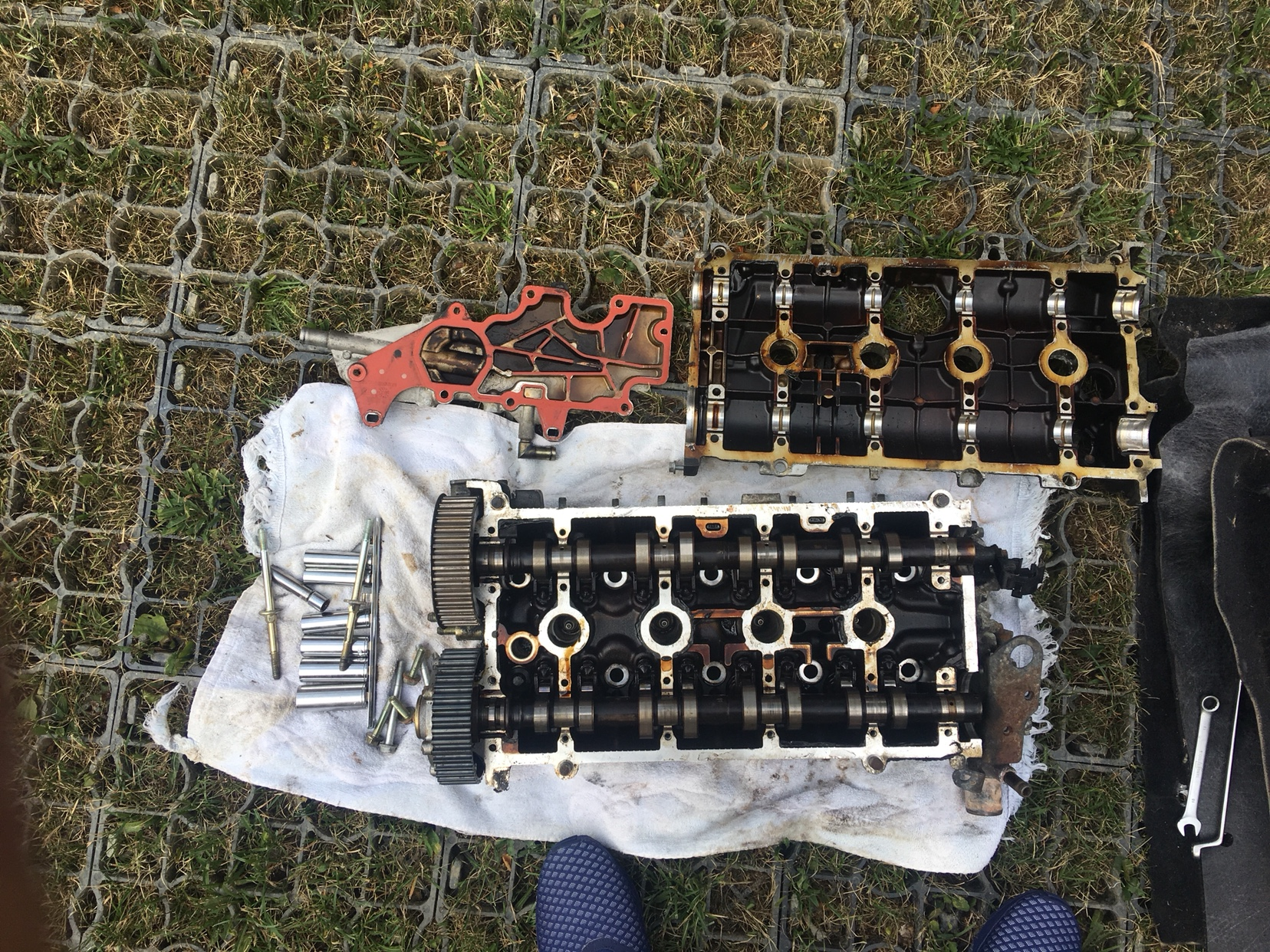

I bought my 172 just over 3 years ago, it was on 117k and the original cambelt and dephaser. Still could just about make out the Renault logo very faintly on the belt
The belt had snapped and smashed every valve square to the pistons. I think it was actually the tensioner roller that failed as I was picking bits of it out of the crank pulley. It takes a LOT to snap a kevlar belt

The timing belt looks perfect, I almost wish I hadn't bothered, being such a b**ch of a job (there is just no space to get your hands and tools in there).

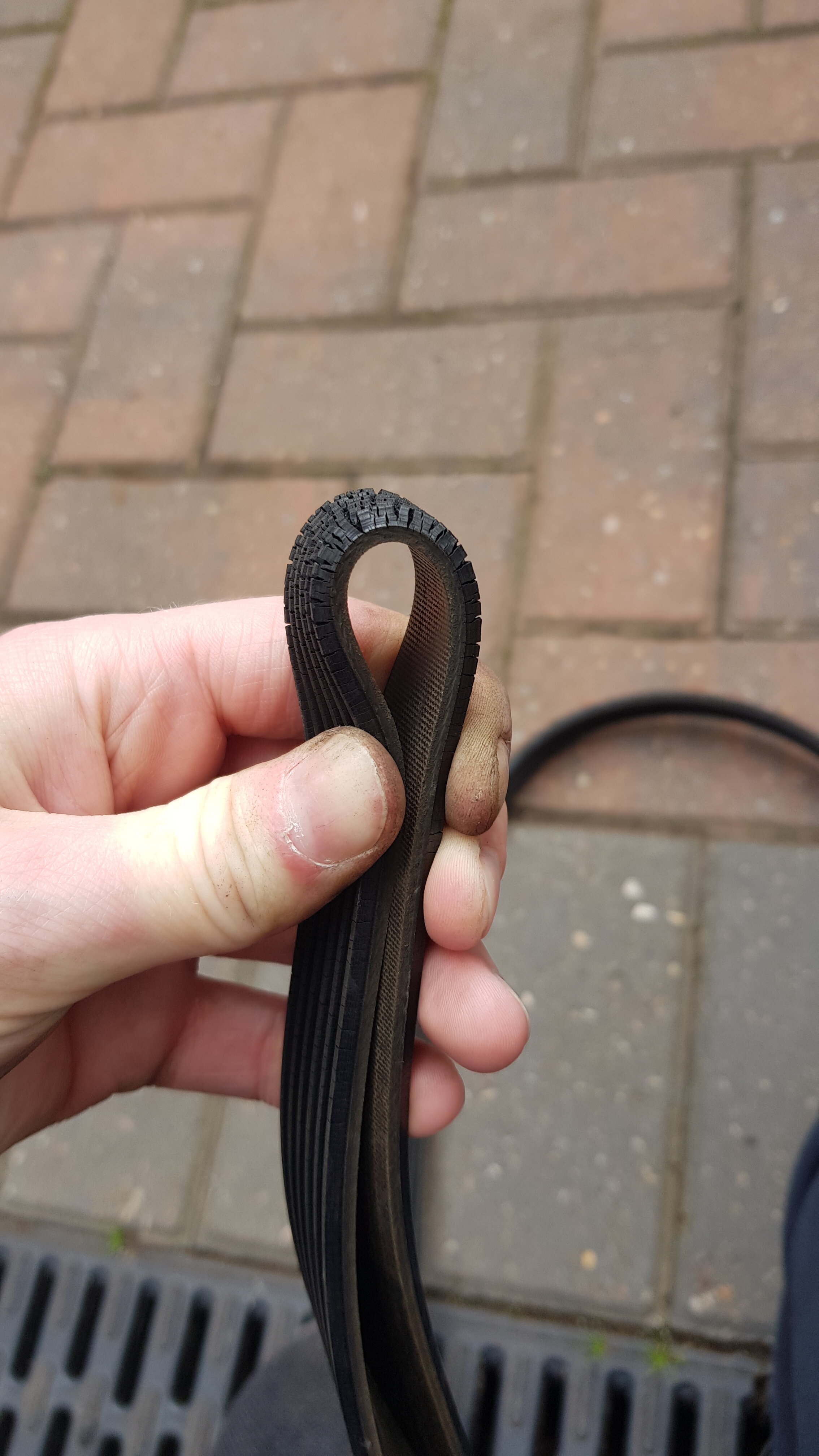

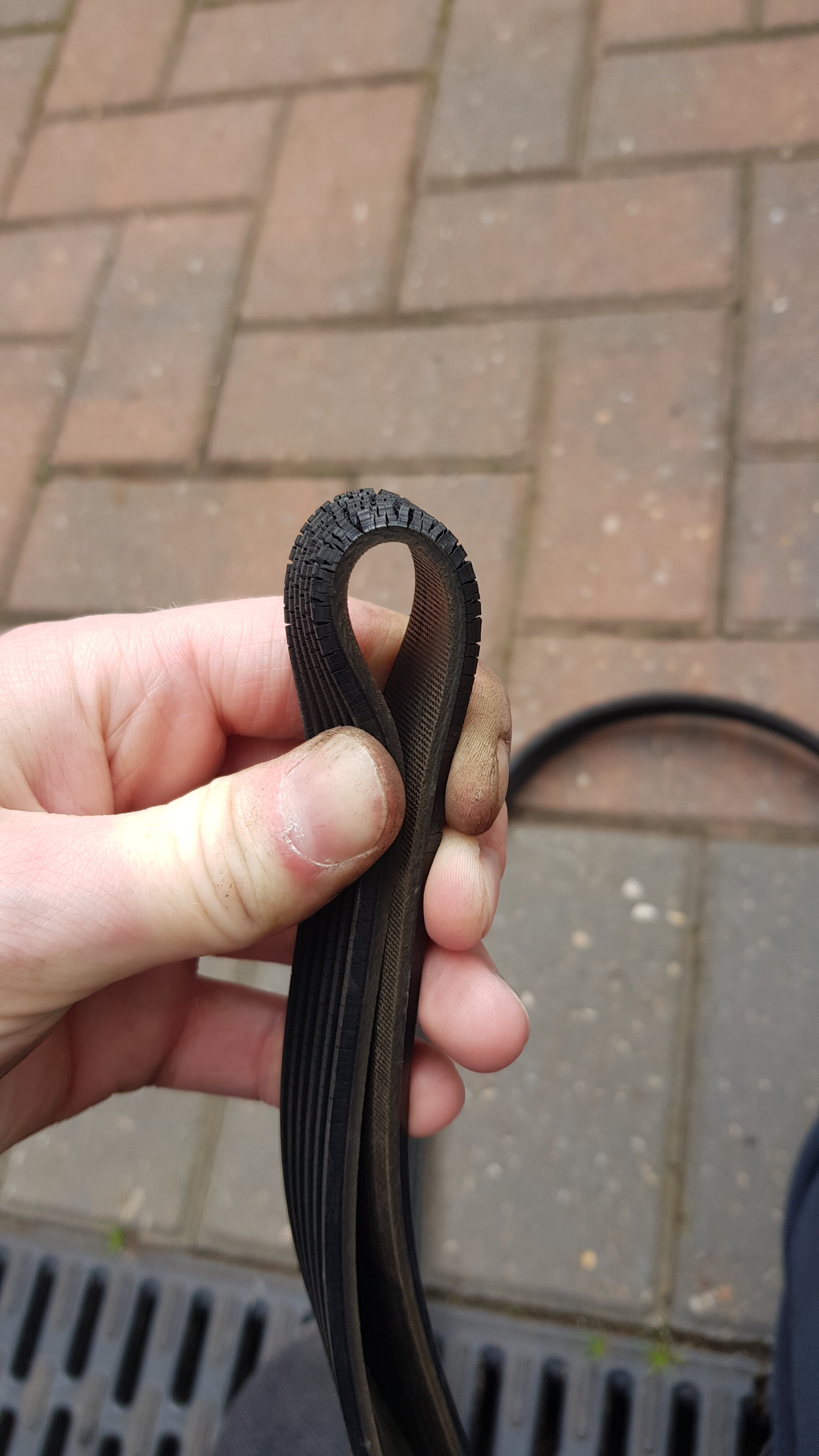

The aux belt is starting to show cracks at the top of the ribs, but still looks in good condition.

5 years, 35k since mine were done and the idler was noisy and the aux belt cracked. Cambelt is in good condition from first appearance so I wont be changing this.

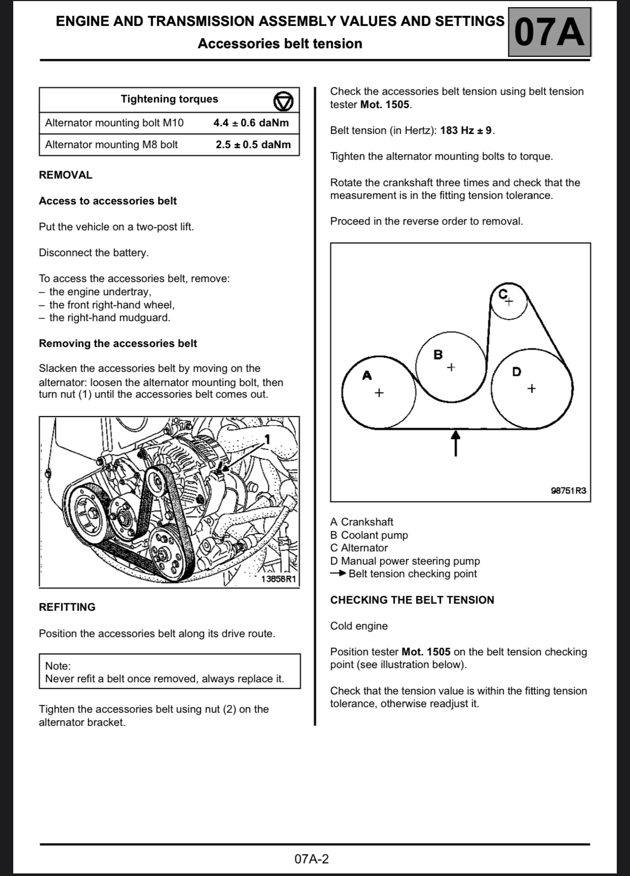

So next question, can someone point me in the direction of a guide to change the aux belt on 172 cup?
Describing it and telling me how easy it is won’t help, I’m a visual learner haha
need pictures or video
