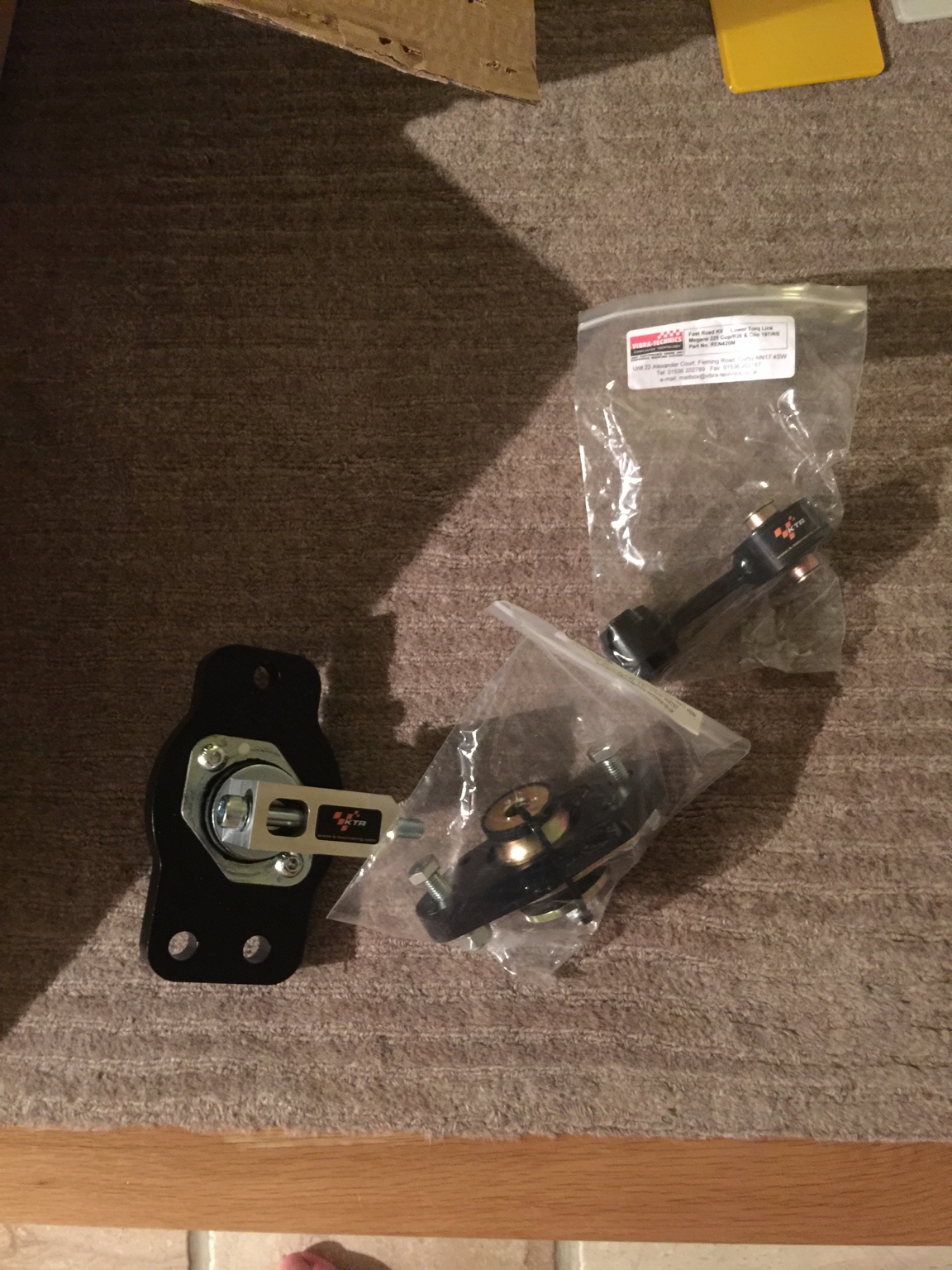

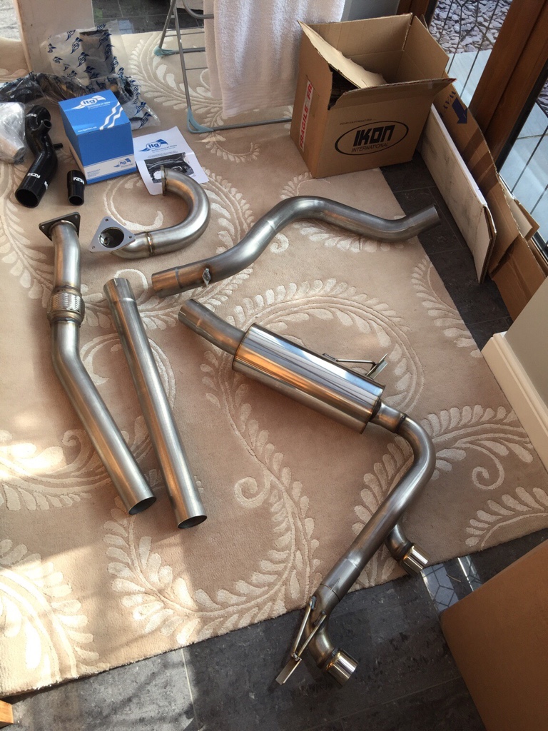

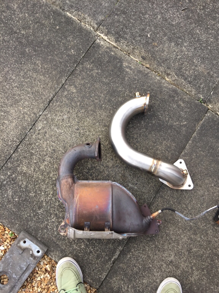

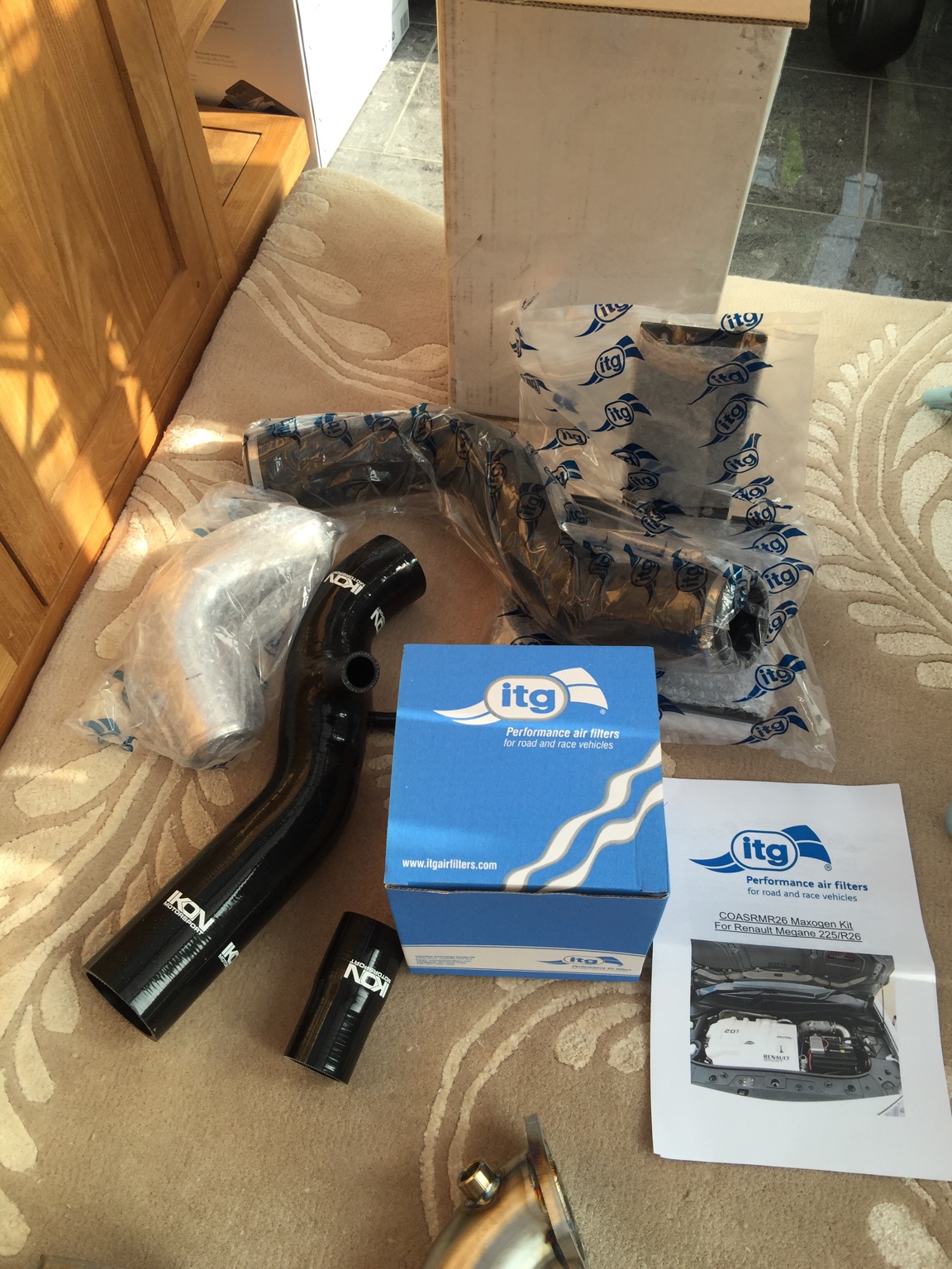

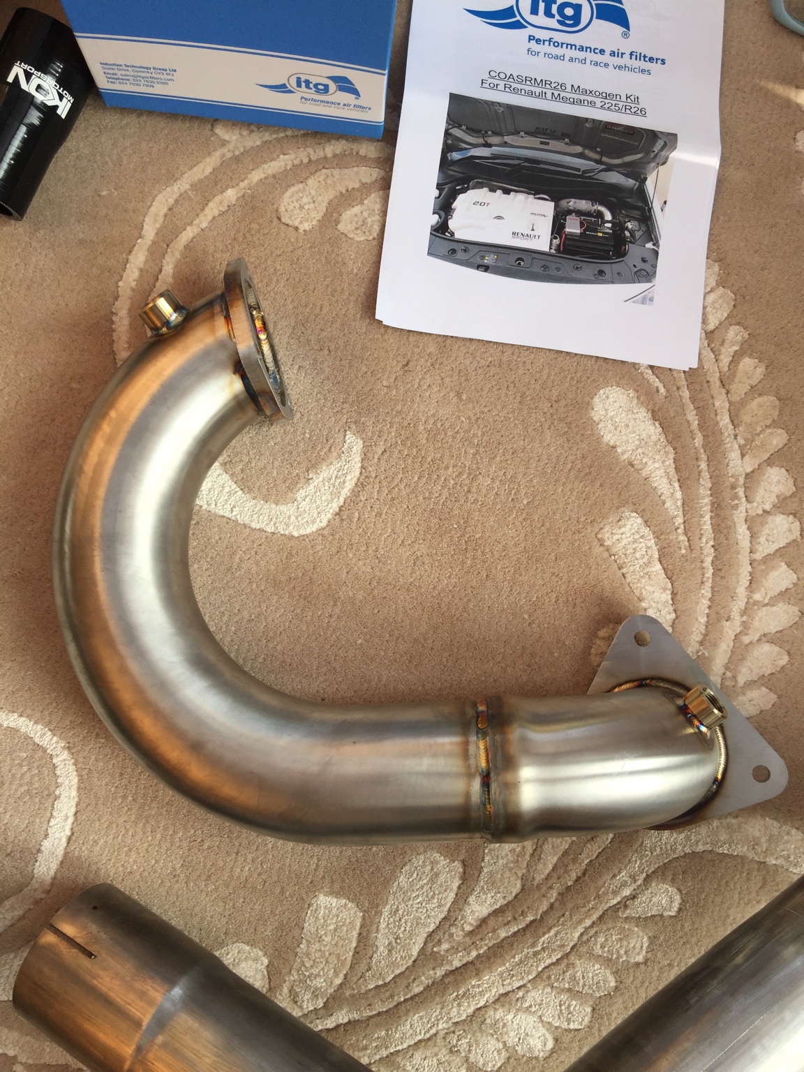

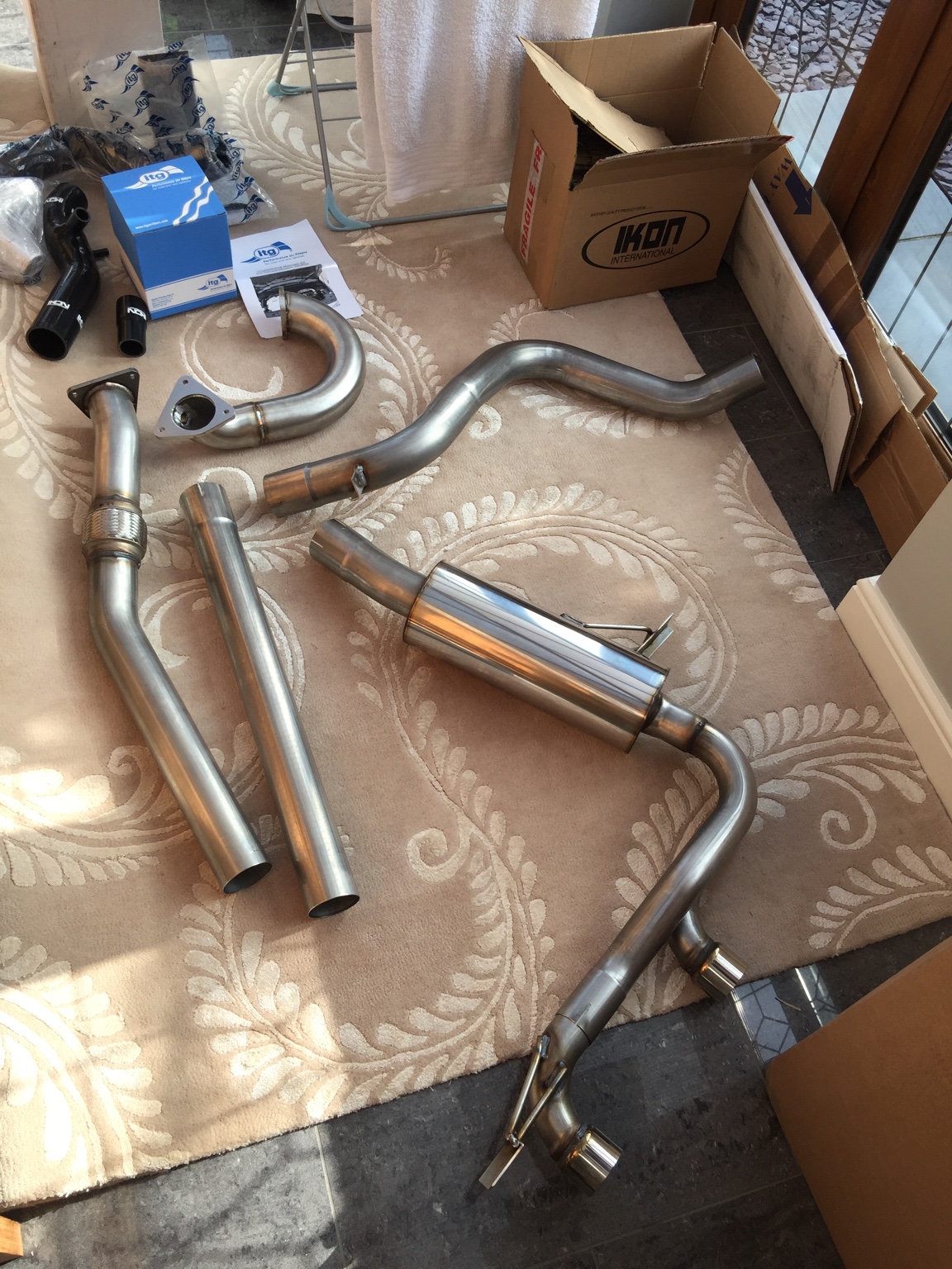

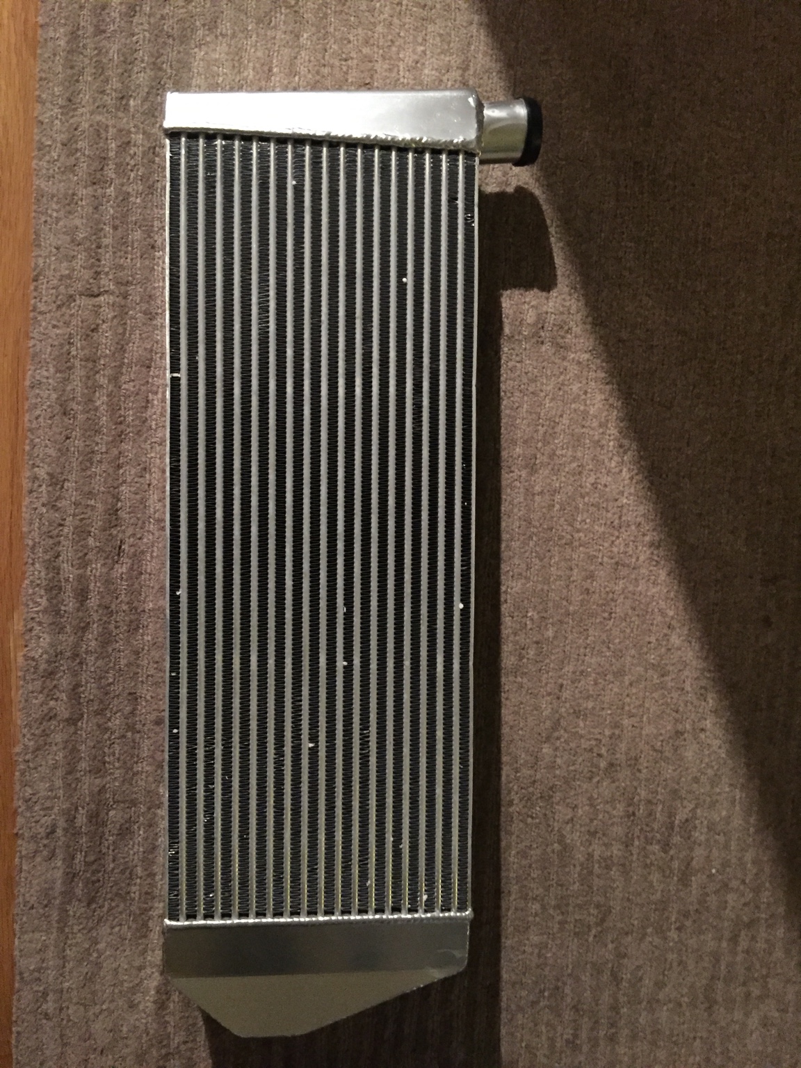

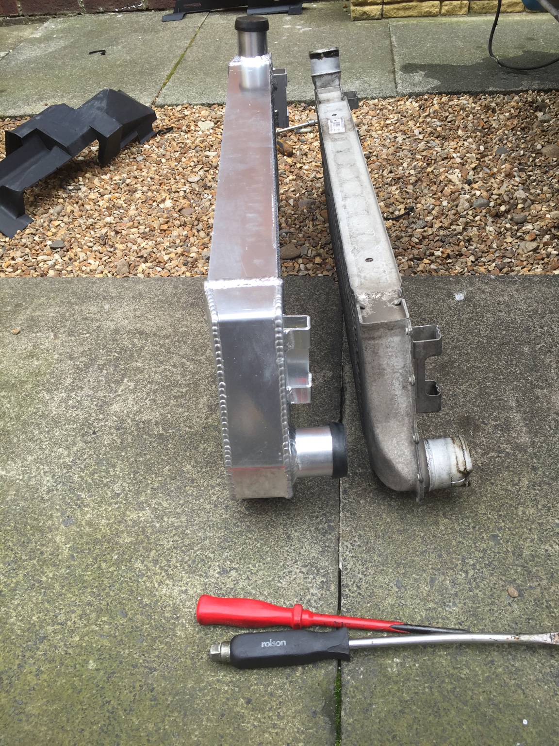

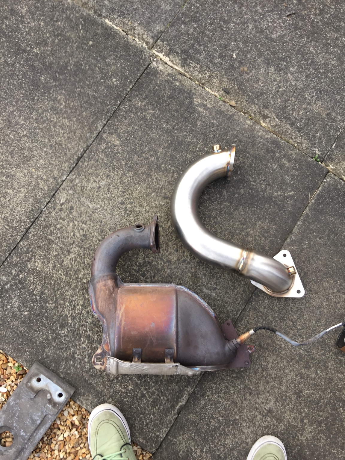

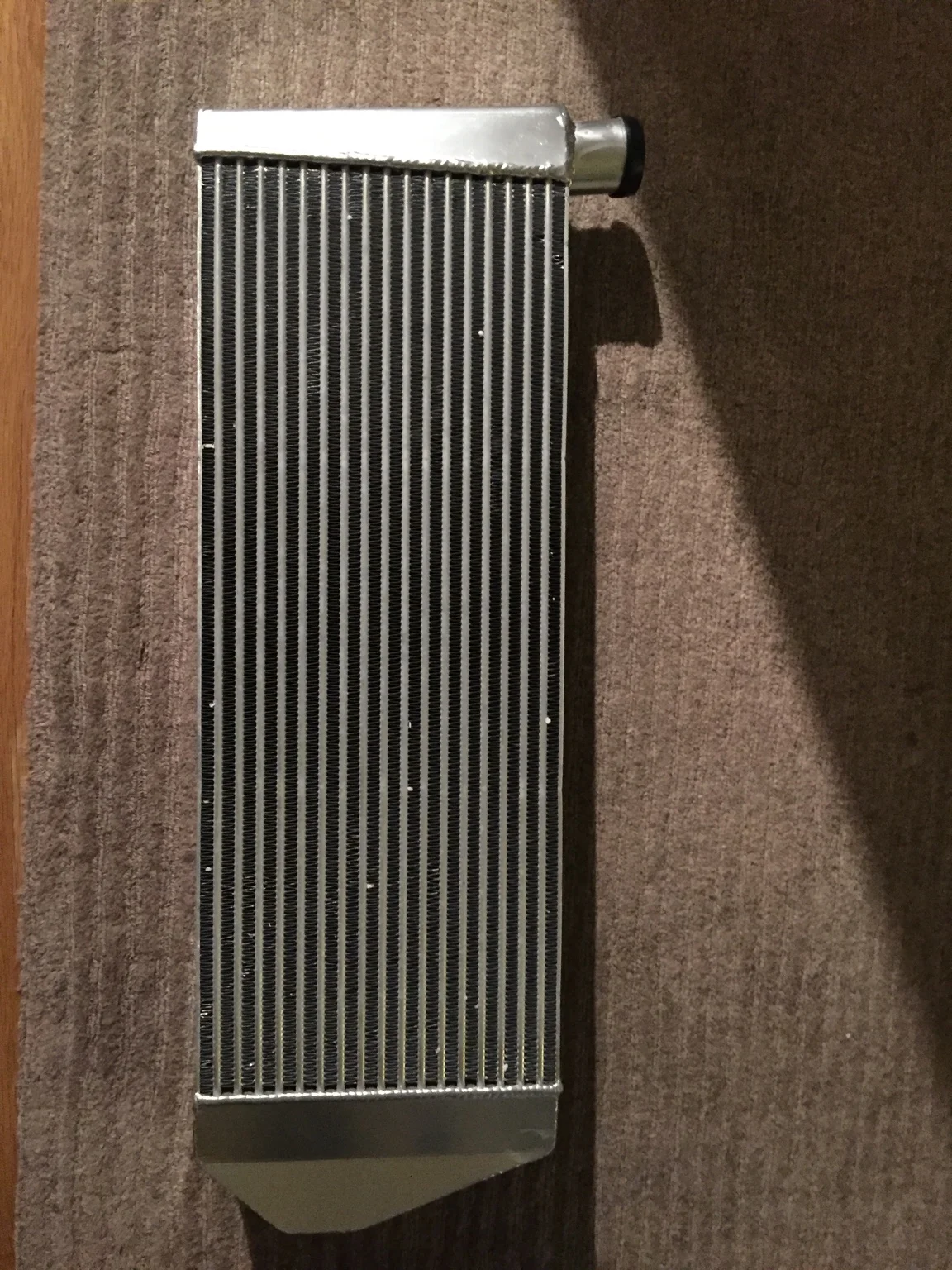

A RS Tuning 3" decat was ordered, K Tec 3" exhaust, FMIC (17 row), silicon intake pipe and ITG Induction kit, vibratechnic engine mounts and a short shift kit.
I'm still awaiting a forge hard pipe kit to arrive and the force sensor holders.

Cat comparison

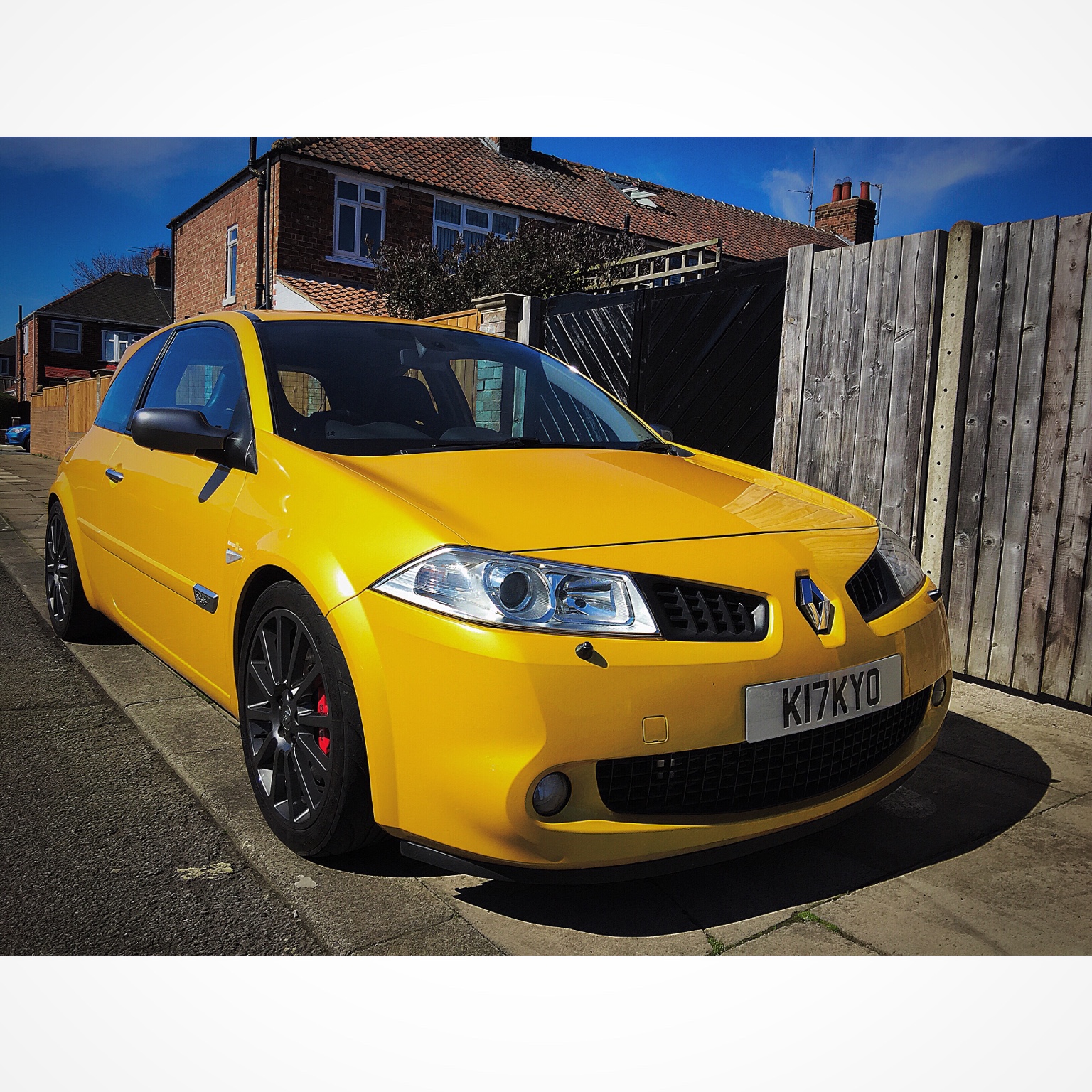

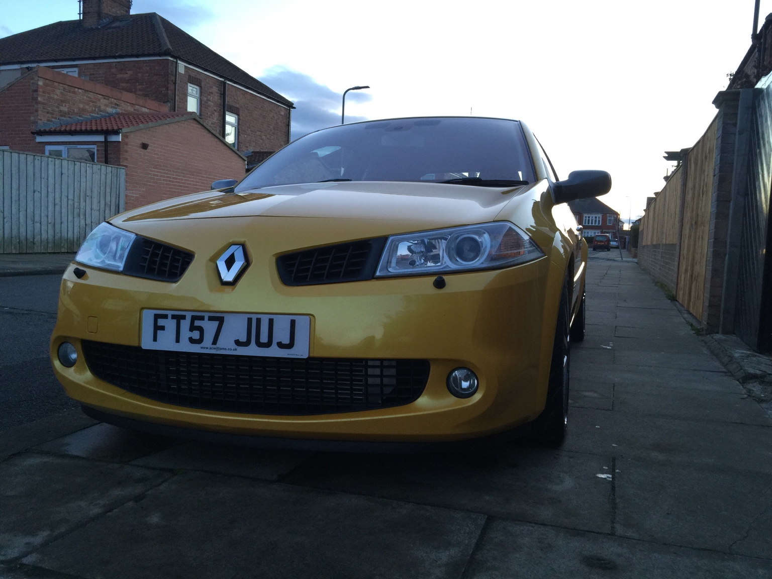

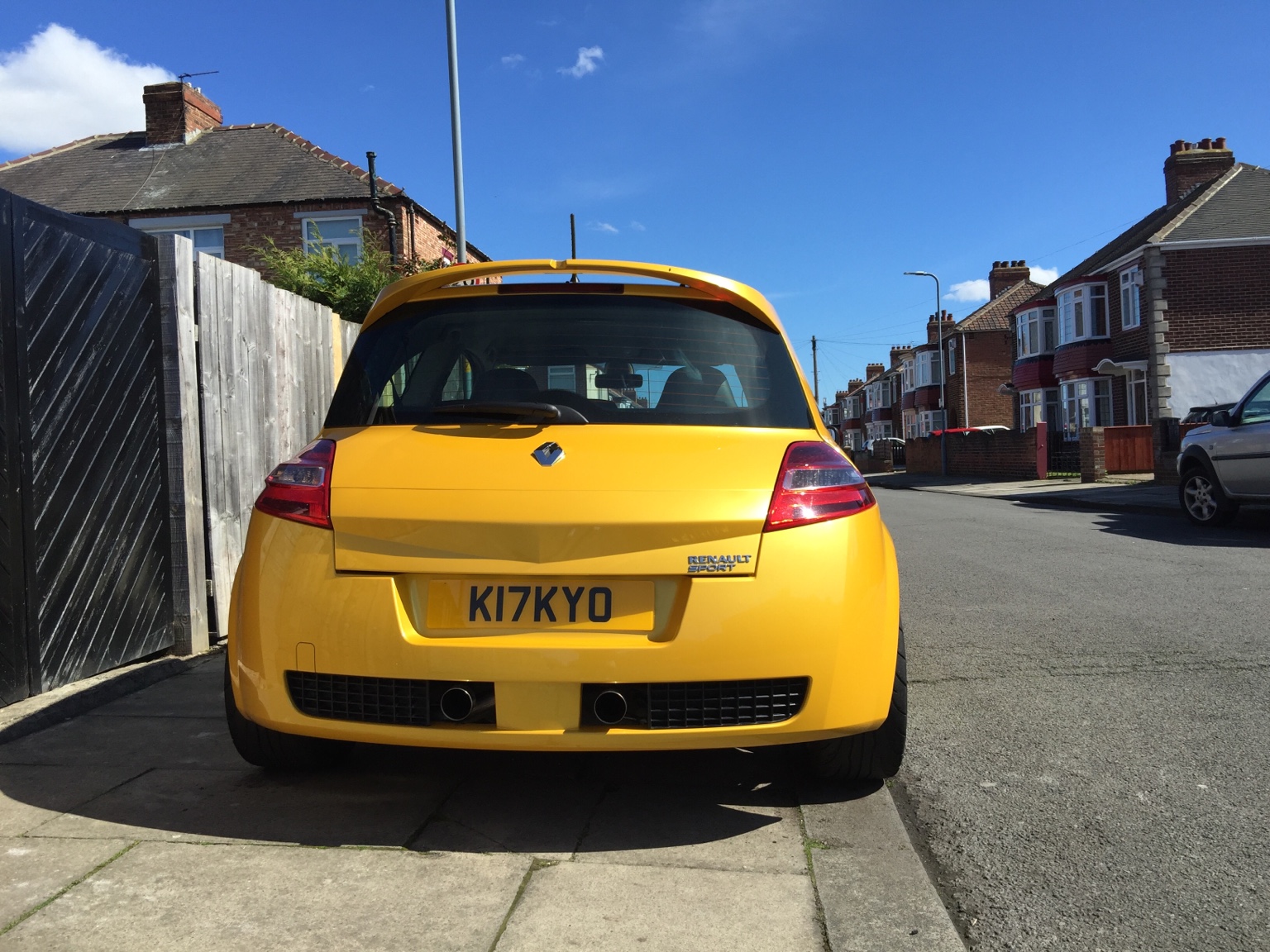

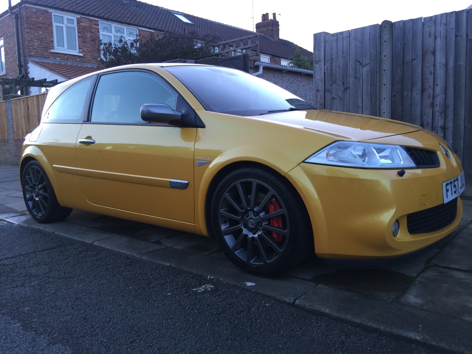

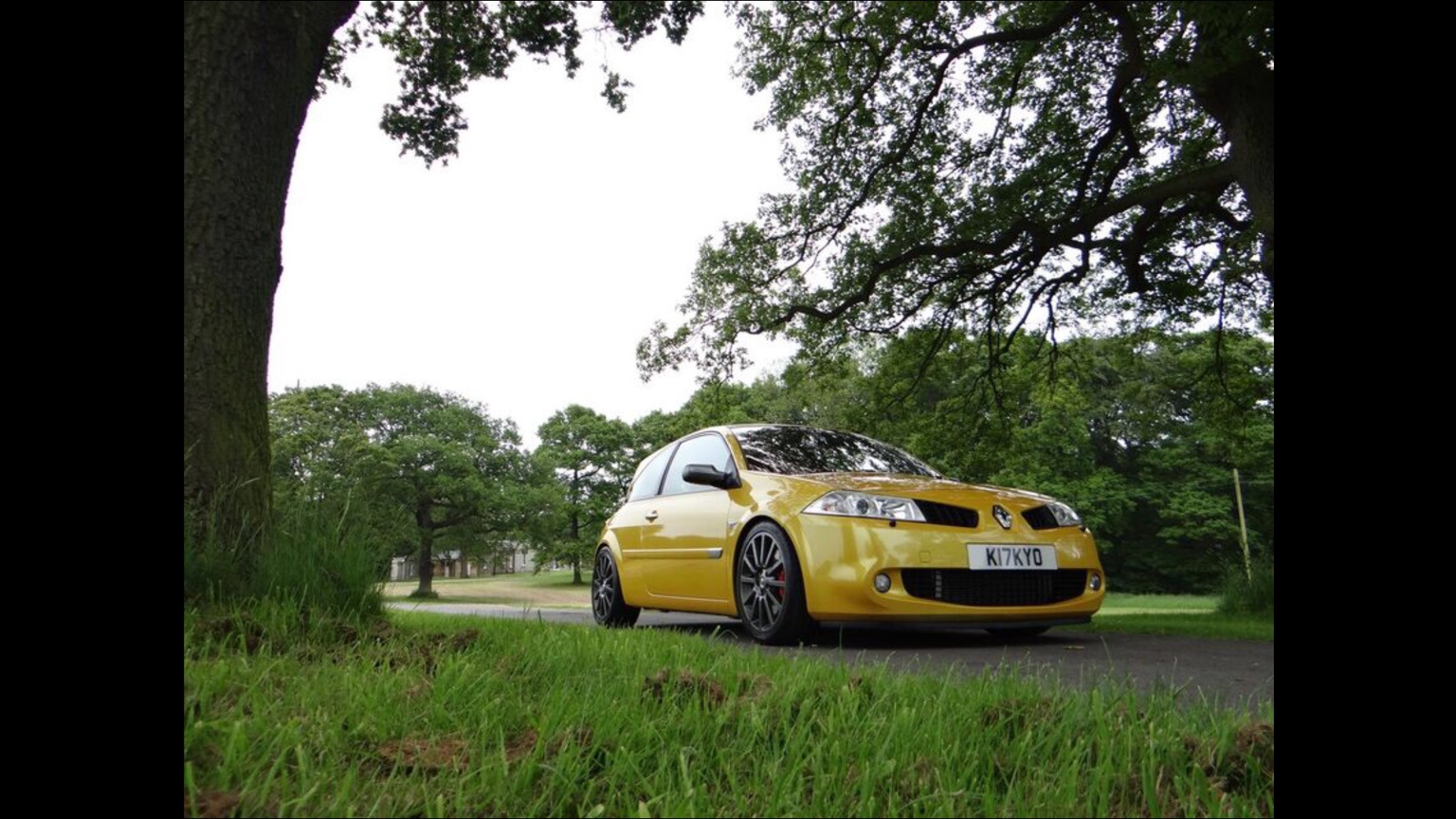

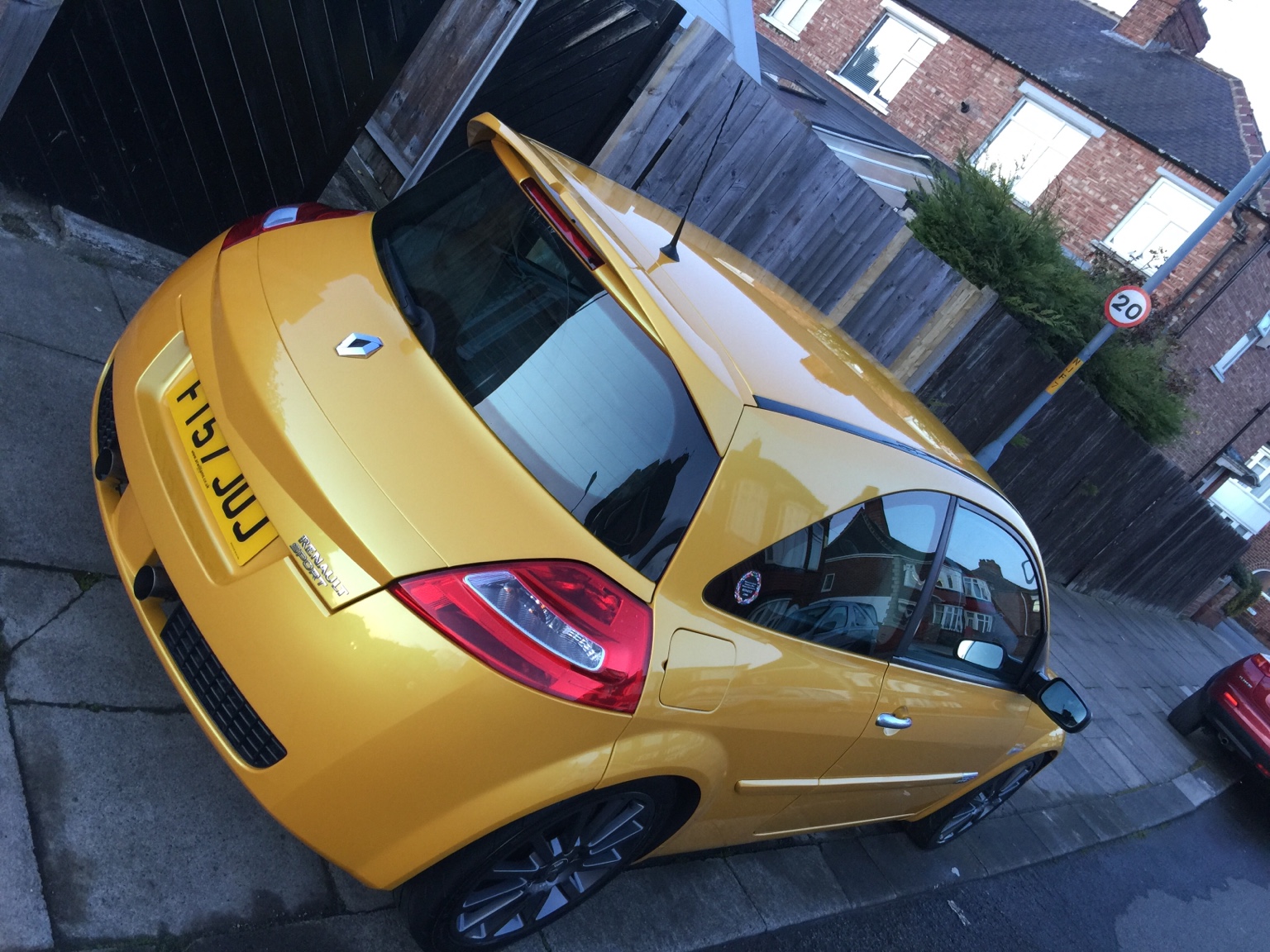

Couple of snaps of the Megane

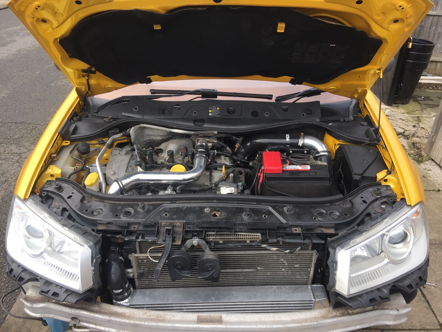

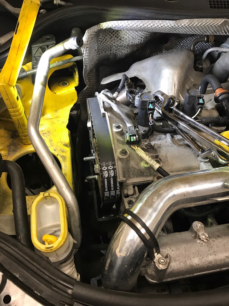

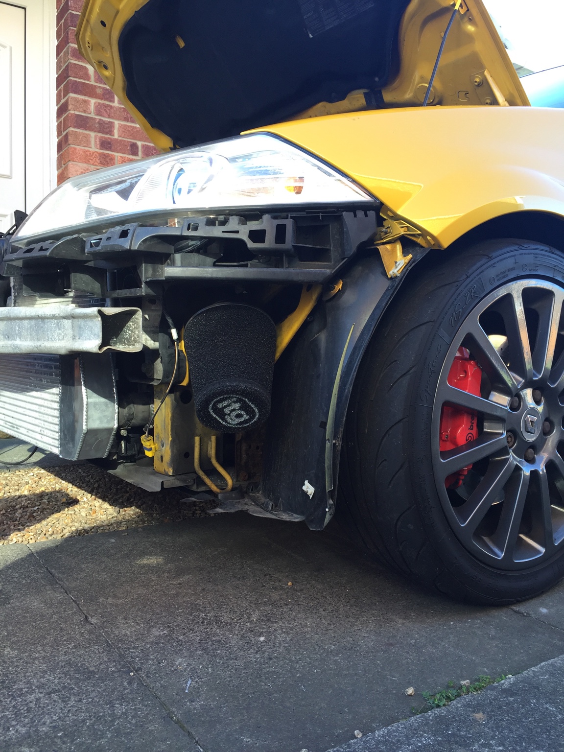

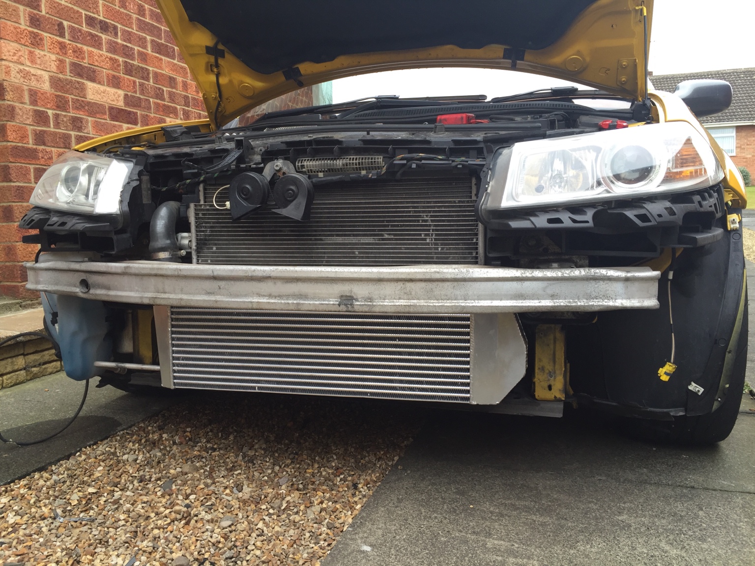

I fitted the forge hard pipes , they were a bit tricky and require the front bumper off for anyone reading this and thinking of doing them.

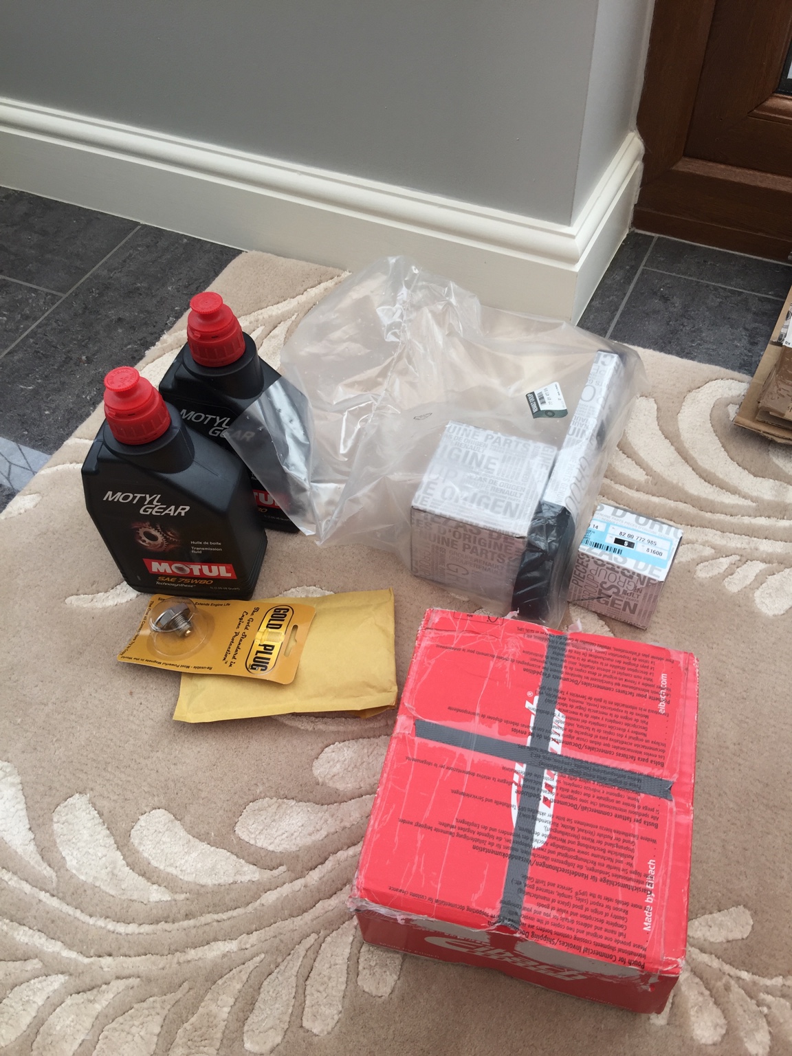

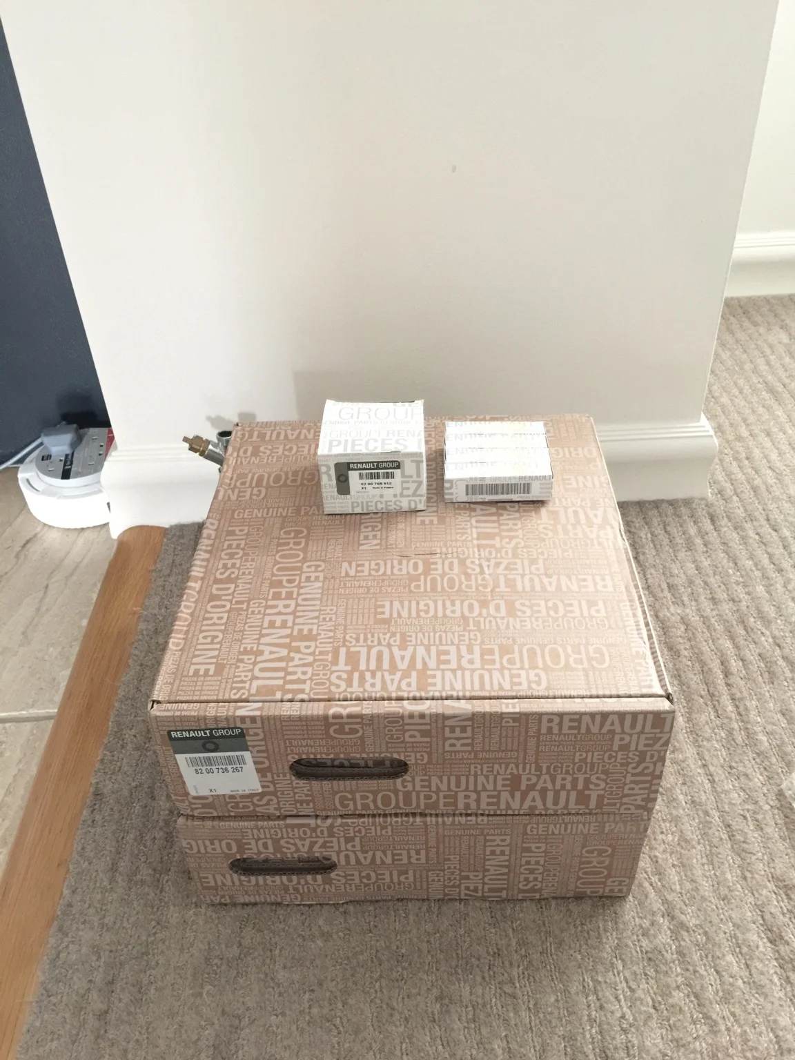

Solid rear discs turned up along with plugs and another oil filter

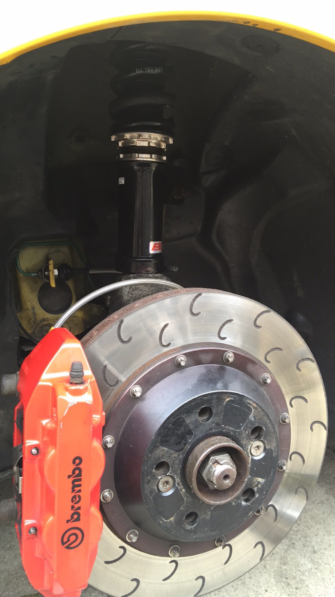

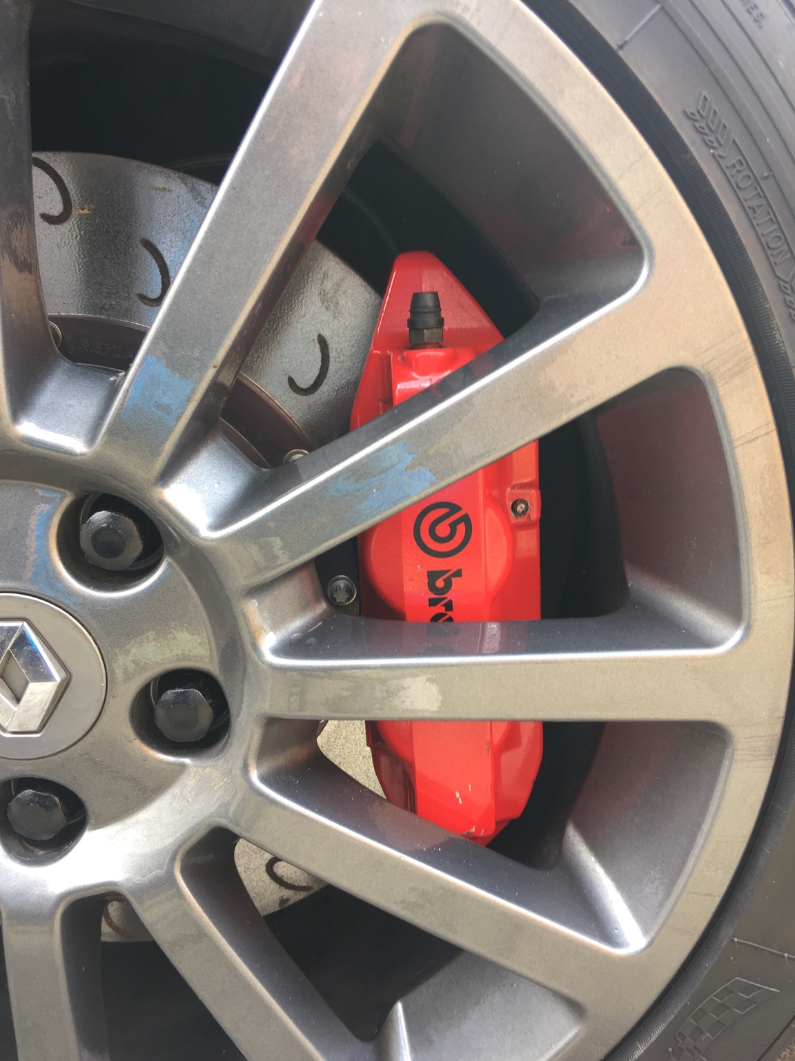

I fitted the 2 piece discs on the front with mintex 1144 pads, braided lines and 197 discs on the rear with brembo pads and braided lines, added some eibach 20mm spacers to the rear too and give all the wheel bolts a lick of paint, bled the brakes with ate 2000 and ran about 1.5l through it to make sure it got a good clear out.

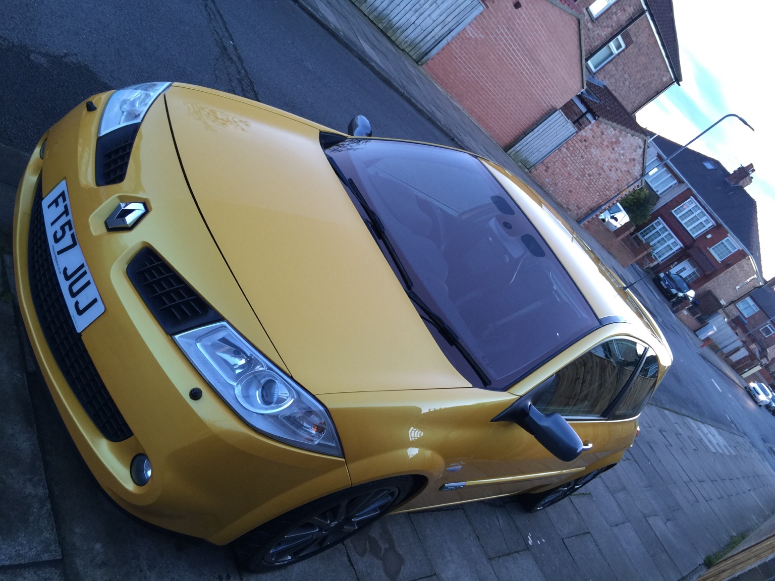

And finally a couple of of how the cars looking

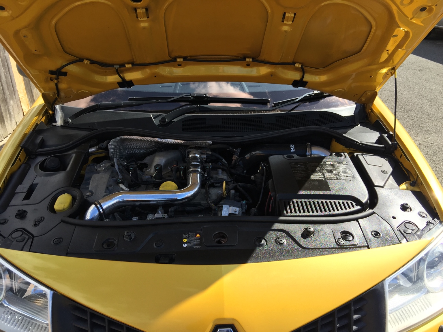

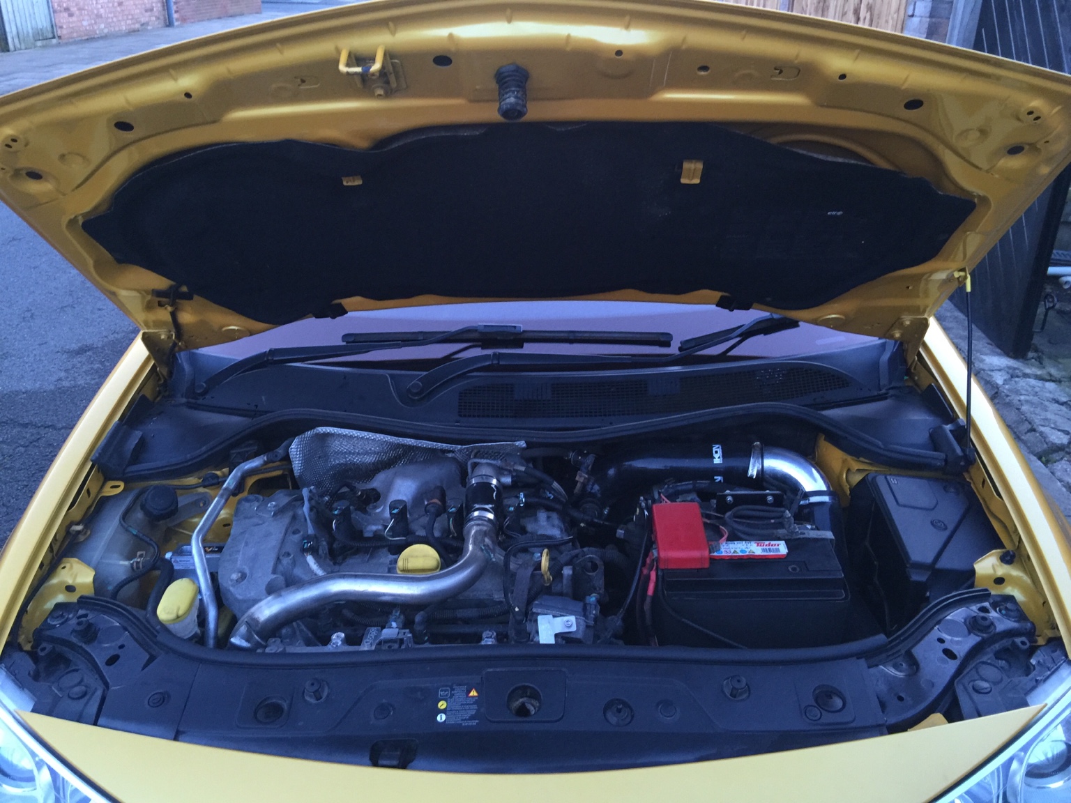

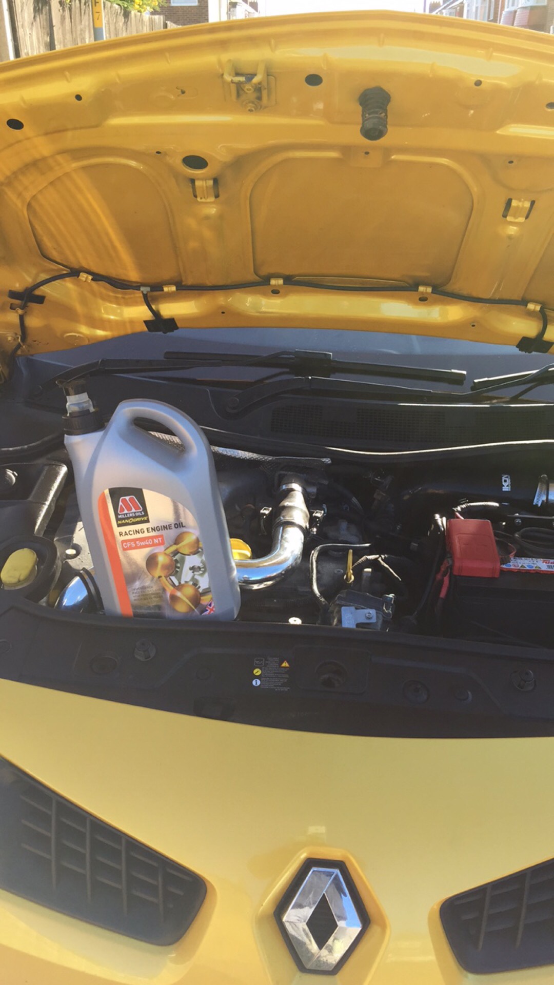

I fitted all the plastic trims in the engine bay, modified he battery cover slightly to make it work with the Itg kit
Oil and filter change ready for mapping.

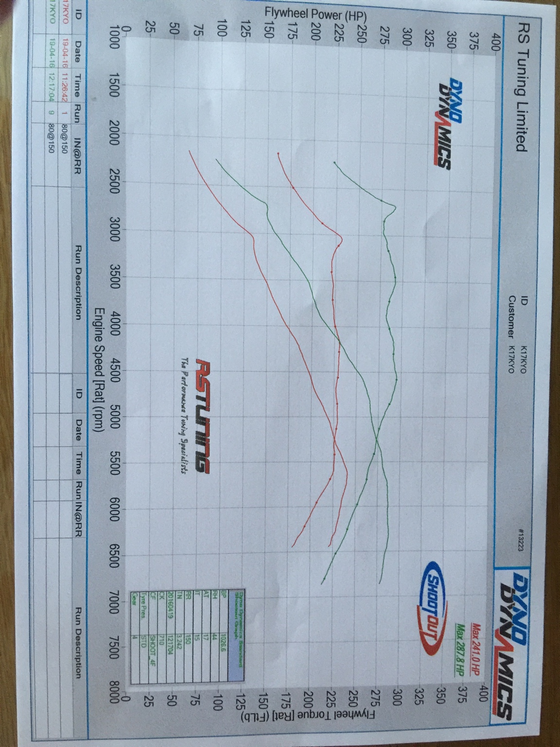

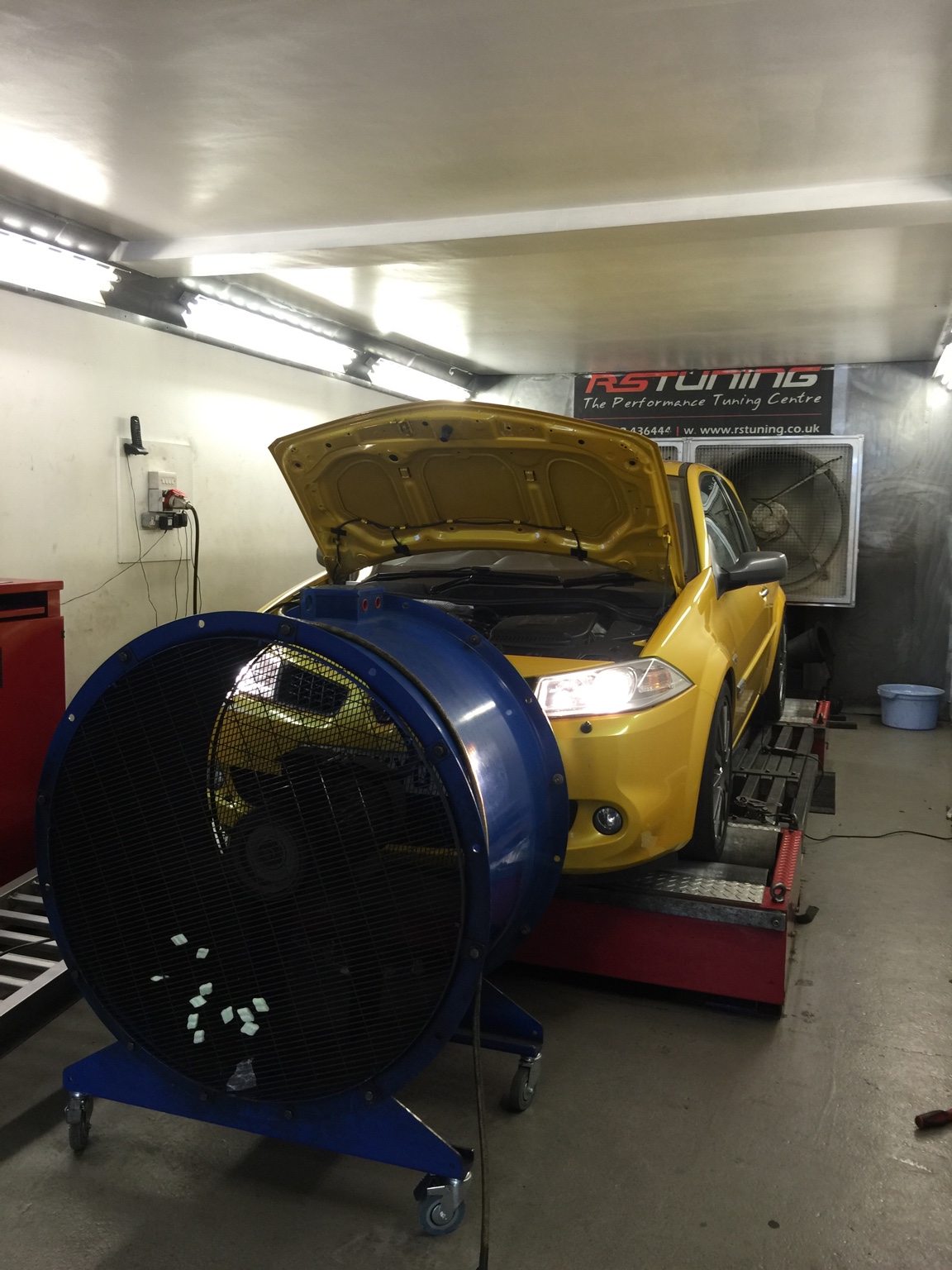

Car was at rs tuning for a map and 630cc injectors, it made some good numbers, finished at 287.8 BHP and capped the torque similar to stay in a safe limit, the car is a total different animal now and great to drive, would recommend it to anyone!

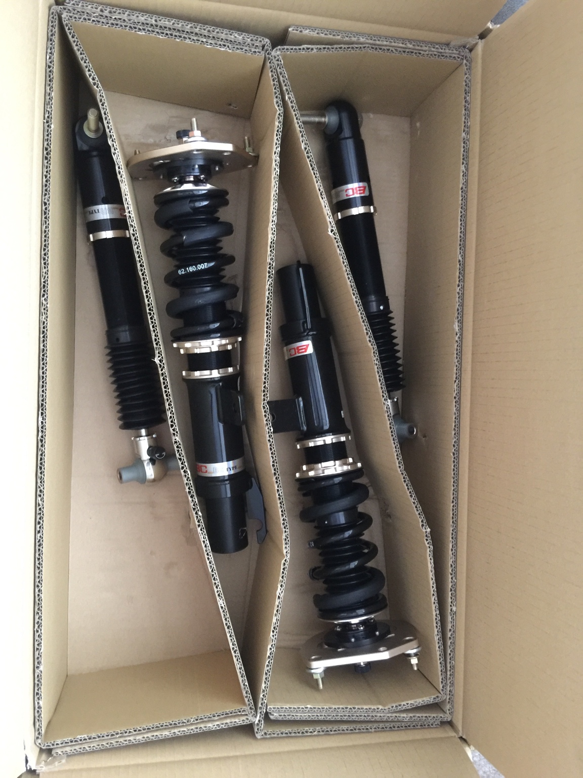

My suspension turned up , hopefully I'll get it on this weekend setup and on the corner scales then adjust the geometry to suit.

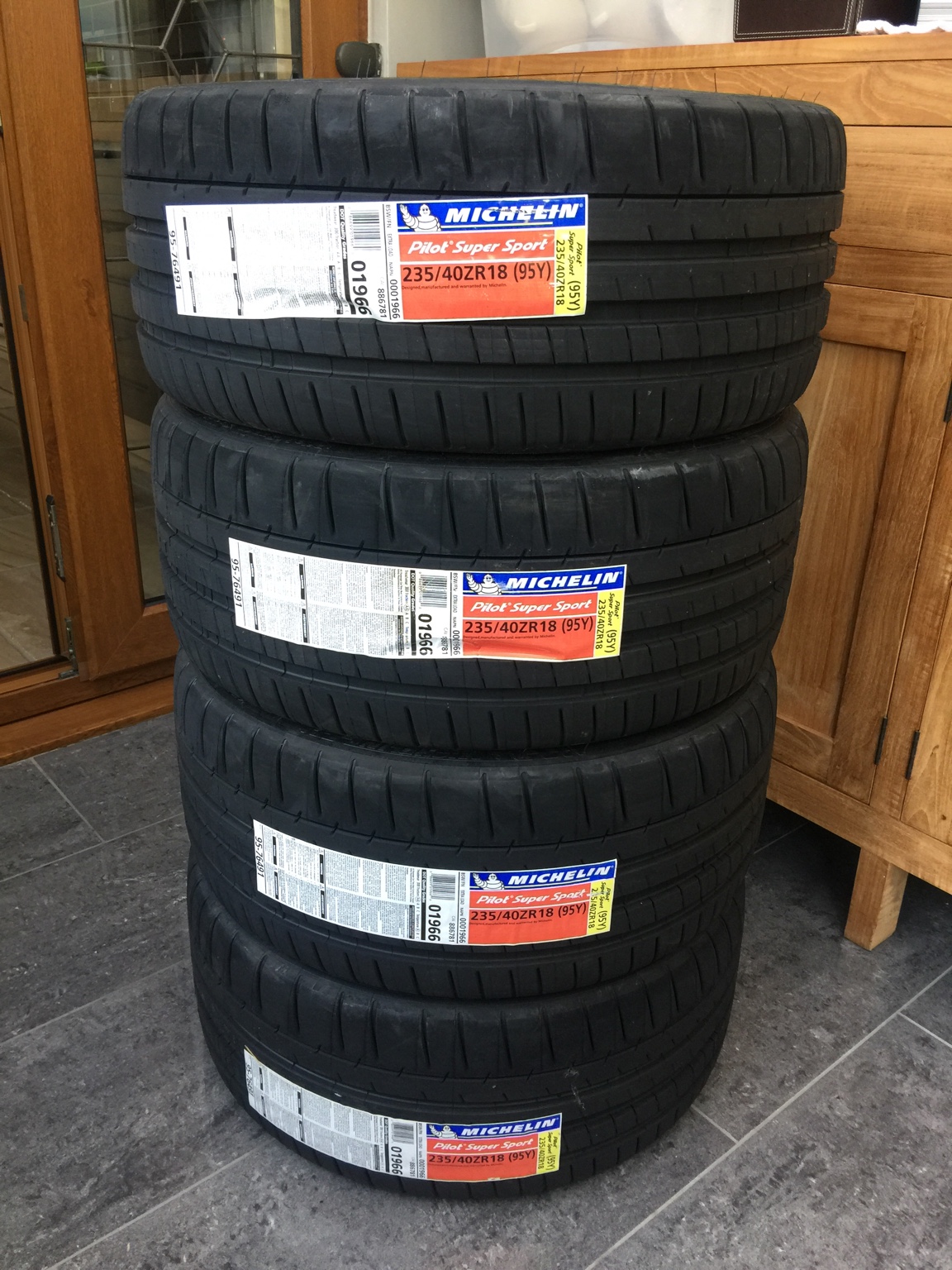

And new tyres turned up 4x 235/40/18 95 Y Michelin pilot super sports

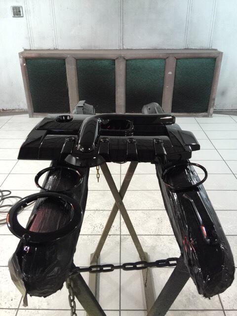

The front bumper was painted and blown is as there was a crack in it, the wing mirrors were painted liquid yellow too

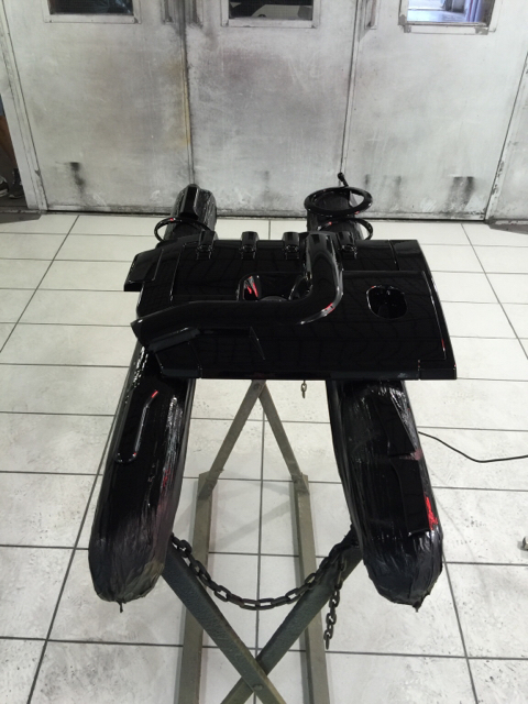

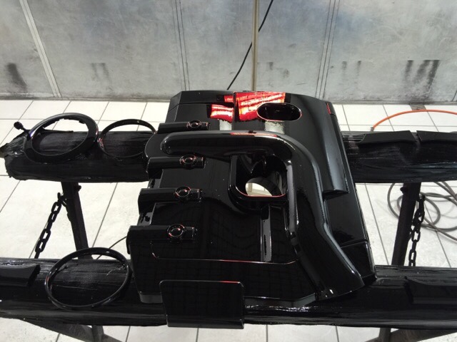

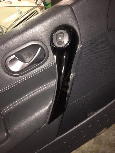

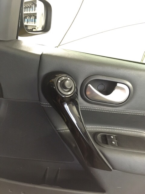

Along with some interior pieces painted gloss black too

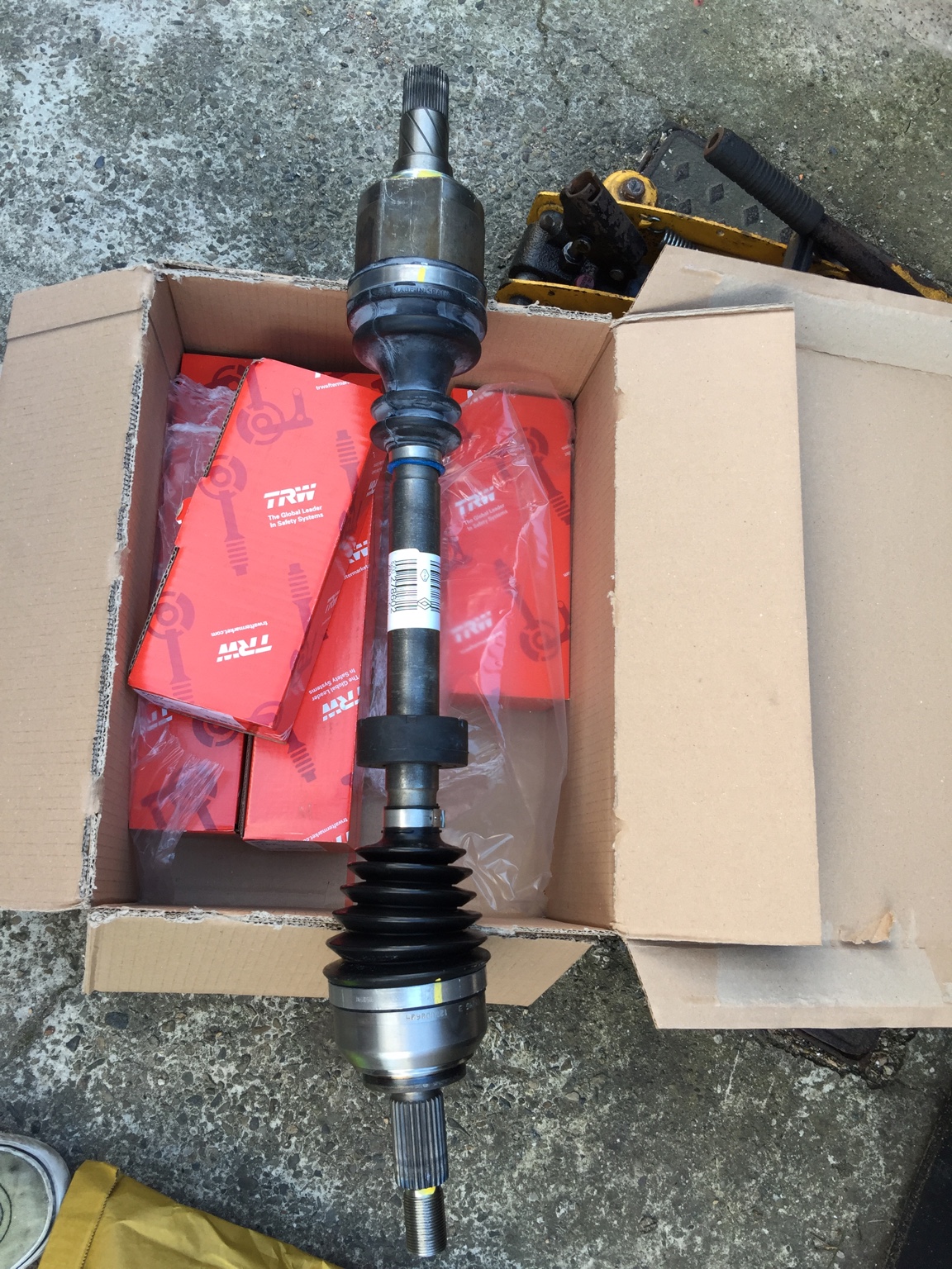

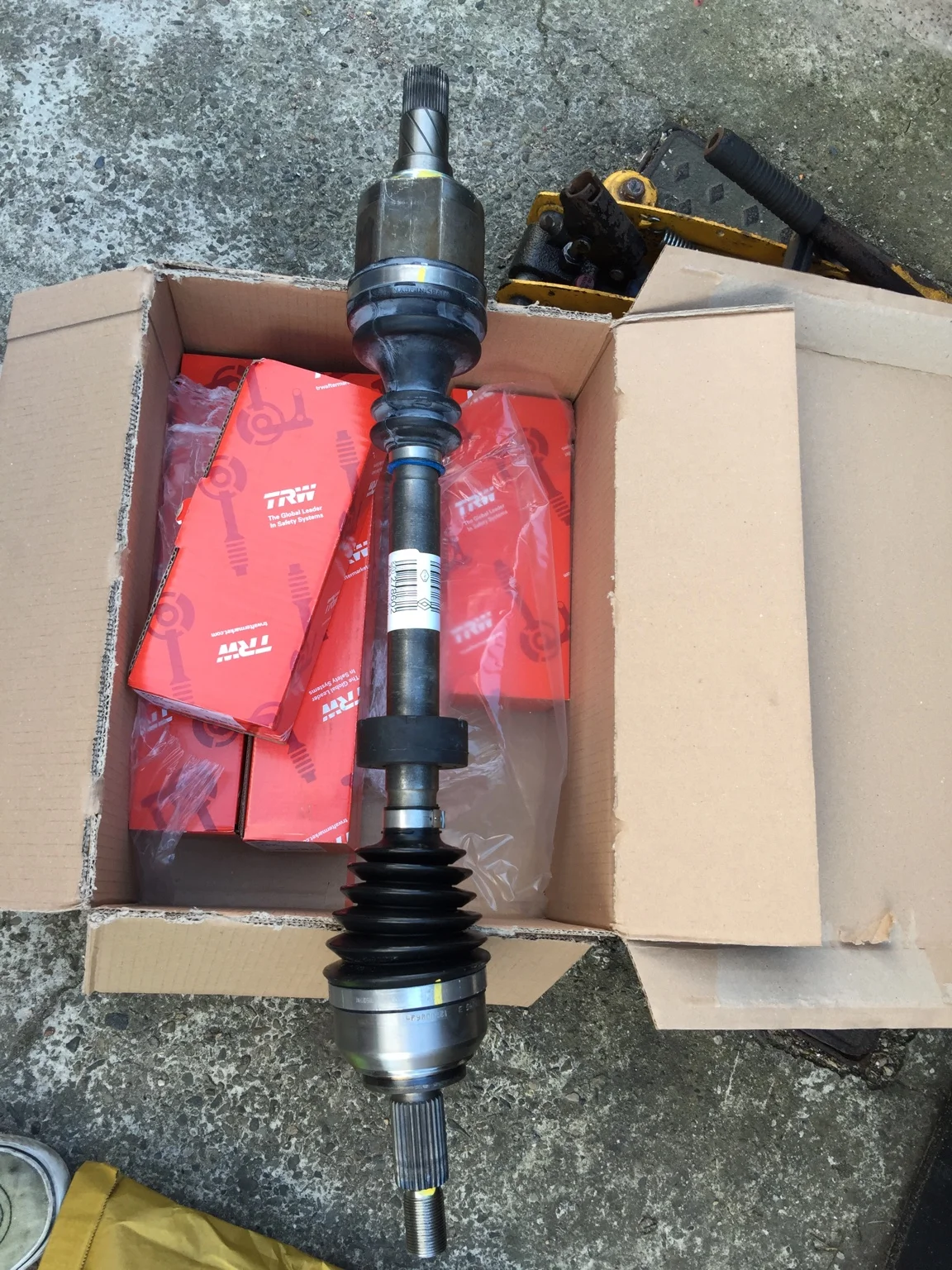

The Megane developed a clicking from the near side driveshaft, I've ordered a replacement from Renault, drop links and anti-twist links.

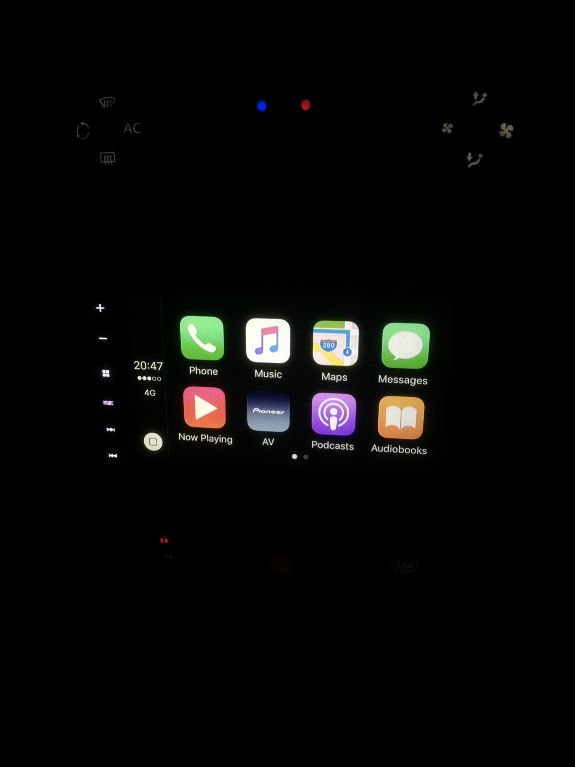

I have also bought a pioneer SPH-DA120 double din with Apple play, I'm just waiting for the fascia to arrive, after reading up about Apple car play, you can run Spotify, maps, take calls and read/reply to texts via Siri without touching your phone which is great!
Drive shaft on, drop links and twist links, I opted for the trw ones as they are the manufacturer of the Renault ones, car feels as if there is a lot more feedback from the front now, the old links were past their best and seemed loose.
The only picture I have of the new head unit too

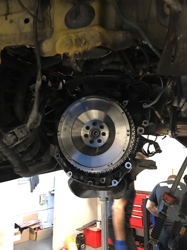

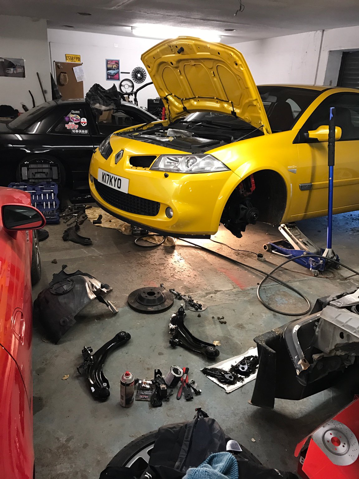

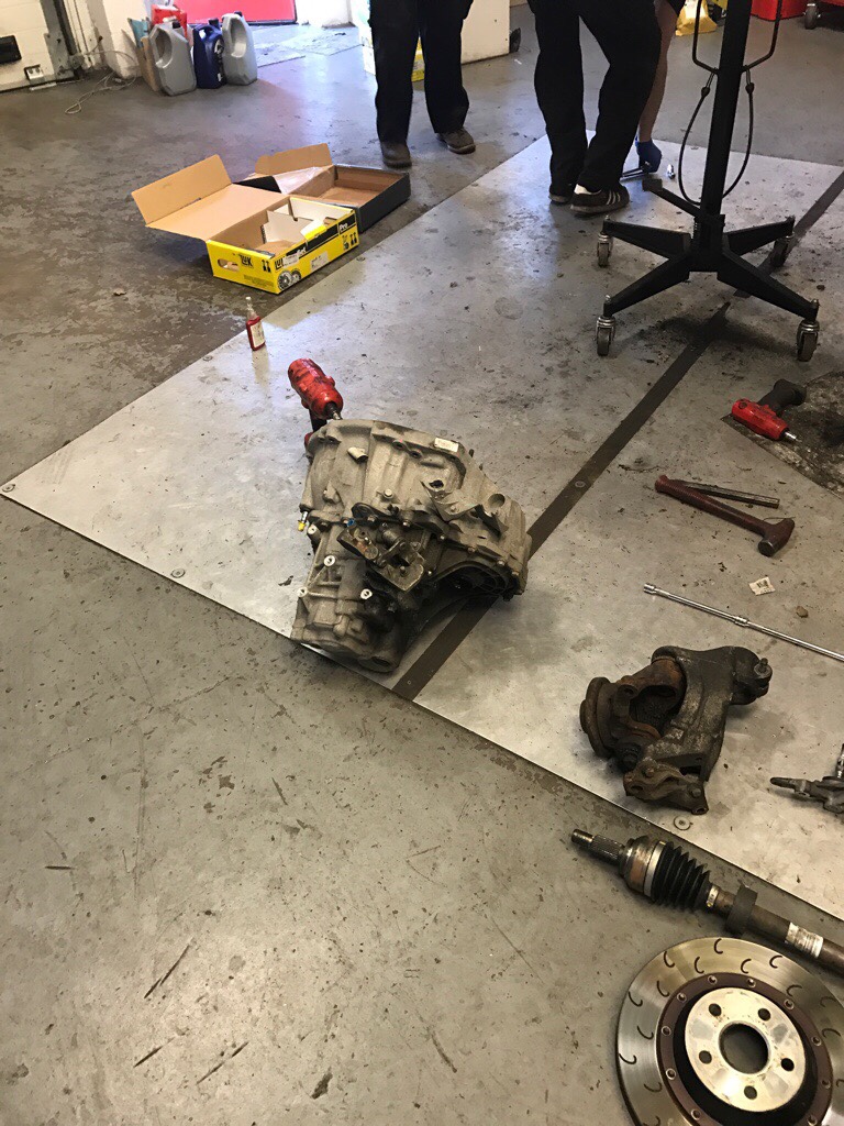

The Megane is in for R26R clutch with TTV single mass flywheel, release bearing and slave cylinder. Additional to this it will also be getting a cambelt change, this isn't due till next year but whilst it is there I would rather just get it all done at once. Mark has machined up some grease nipple bolts for my hubs too. I have ordered all the additional bushes and steering parts that I haven't fitted already so that whilst the subframe is off these can be changed too.

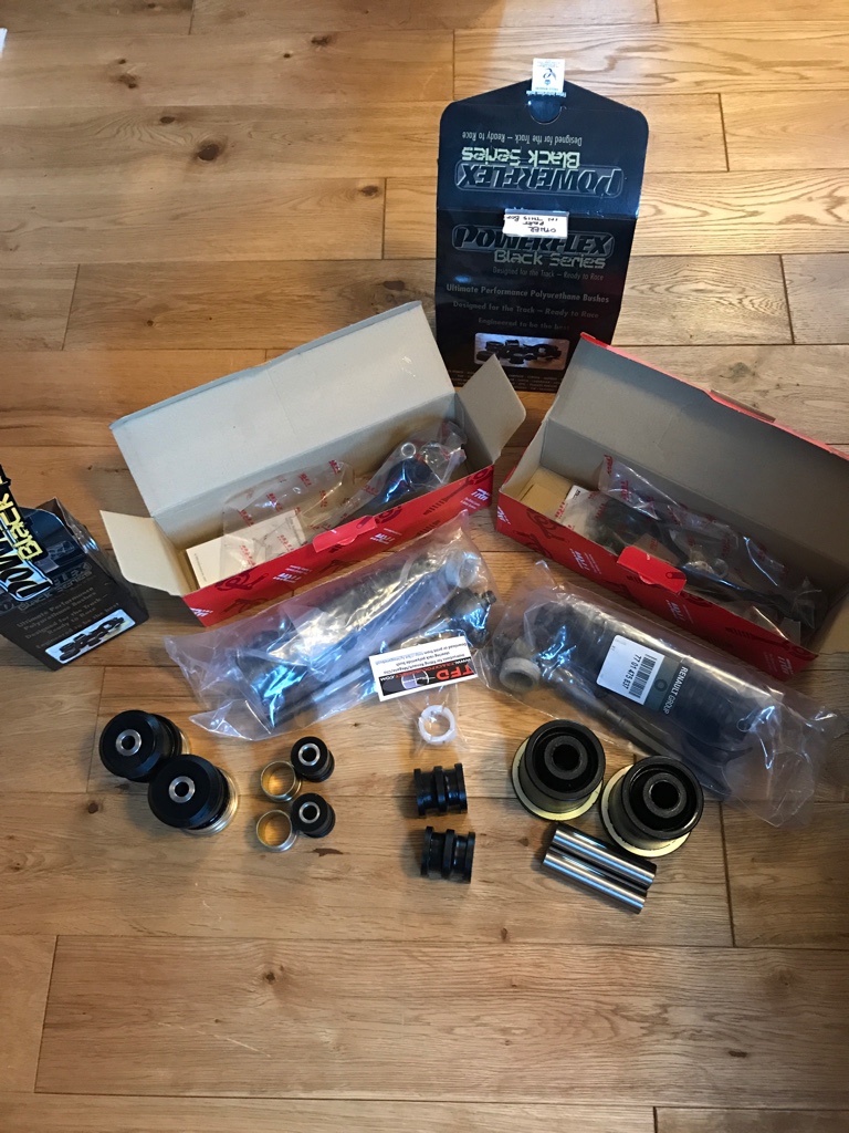

Powerflex Black Series Bushes (from K-tec)
http://k-tecracing.com/show_product.asp?id=5219&appid=12
R26 Antil Roll bar bushes 21mm 803-21BLK £38.16 (225 buses 20mm 503-20BLK £8.16)
Front wishbone bush 60-501BLK £69.48
Rear wishbone bush 60-502BLK £76.44
Swivel Hub Bearings BK4520A £22.86 Each
http://www.hendersonbearings.co.uk/...oller-bearing-closed-end-ina-45x52x20xmm.html
Swivel Hub Bearing Seals £4.42
http://m.ebay.co.uk/itm/331886490832
Rear beam bushes if anyone is interested are 60-510BLK £73.80

MY car went into Mark Blacks for a major service the following was carried out:
R26r clutch and slave cylinder
Genuine cambelt kit
Genuine water pump
Genuine auxiliary belt kit
Millers nanodrive 5-40w oil & genuine filter
Powerflex bushes on arb and rear beam
Genuine inner & outer tie rods with steering rack bush
Hub bolts with grease nipples
Great guy and answered any questions I had, the old clutch and flywheel were ducked, it hasn't worked out much more than doing it myself either! Would highly recommend!

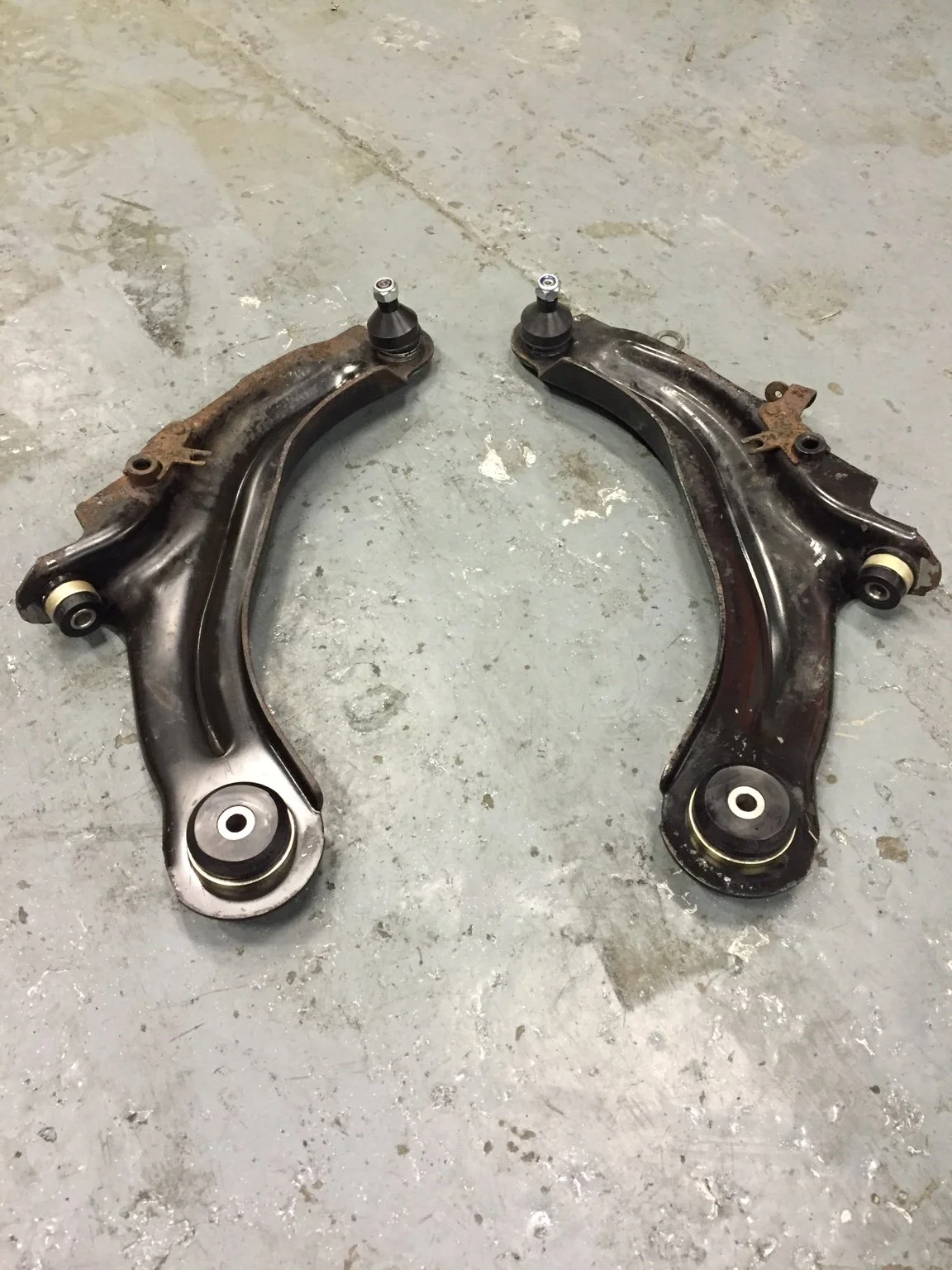

Should have spare wishbones soon so they will be off for powdercoating then new ball joints and the other black series powerflex bushes.

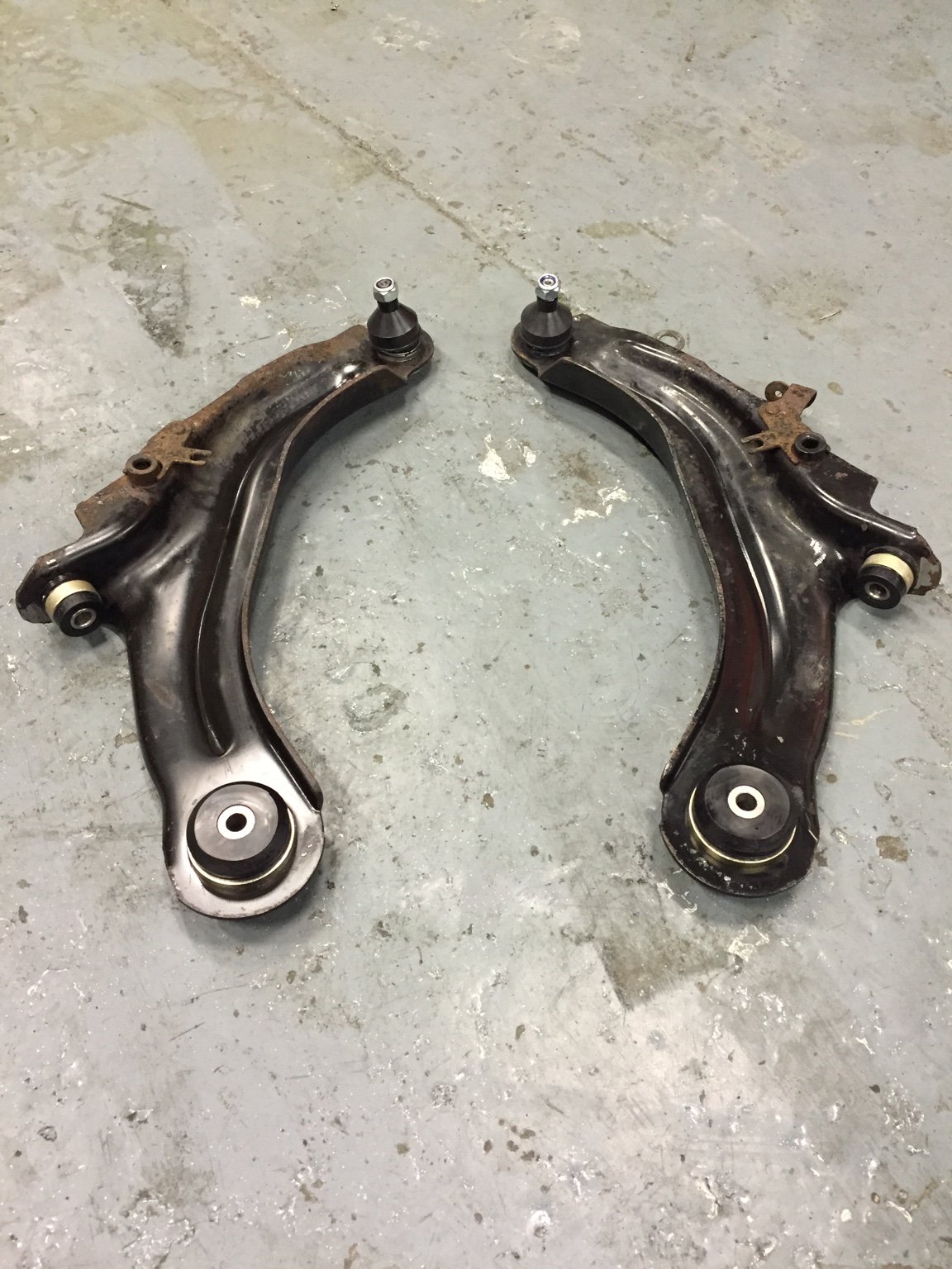

So a friend of mine, Craig kindly pressed the new bushes and ball joints in the spare wishbones I have, they just need slick of paint before they go on this week.

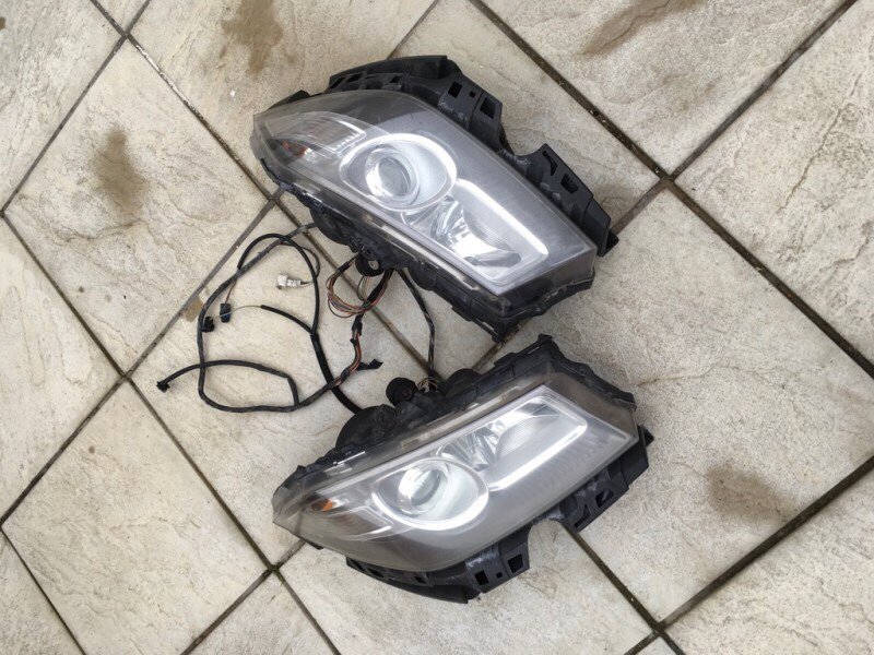

I also have so xenons to go in I'm just waiting for the rear level sensor loom from Renault as the one that came with them has been chopped in half! But of course this part is on back order and has to come directly from Renault in France. One I have it I will install them and program them in on Clip.

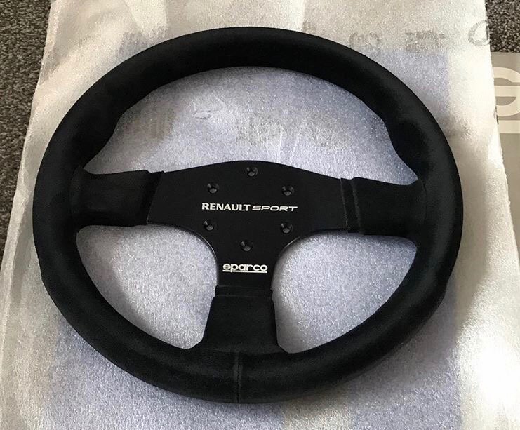

I am also debating a retrim for the 197 wheel or the new cup racer wheel? Opinions? Note the car will probably get a set of pole positions or sportsters at some point.

So today I fitted my wishbones which were the final piece of the puzzle, this means that every bush, link, joint and bearing has now been replaced.
The powerflex black series are very stiff and were a nightmare to manoeuvre into place on my own.

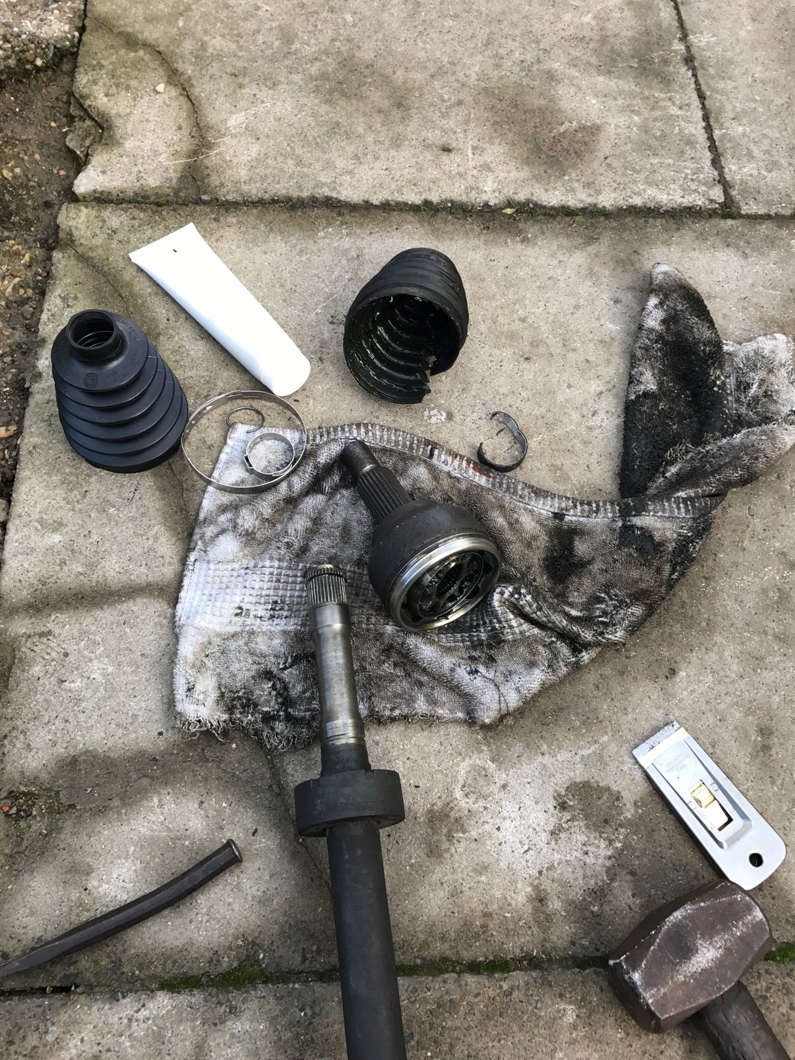

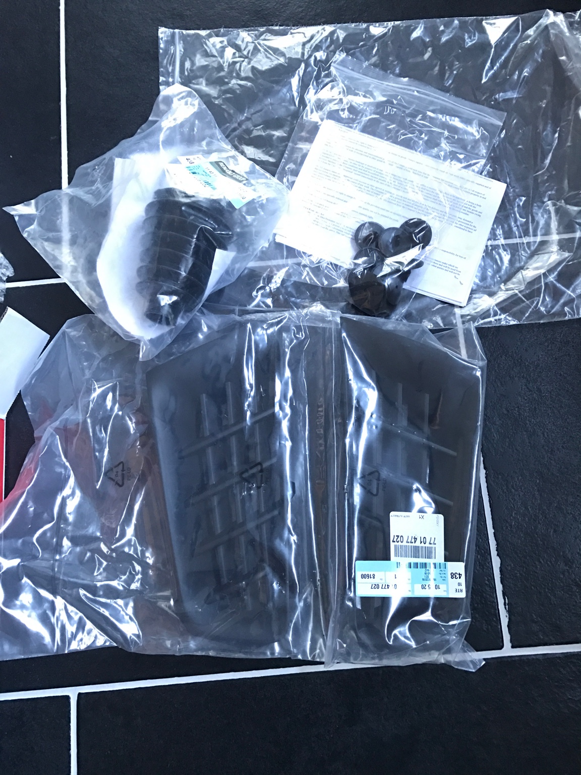

So some of the clips had snapped on one of my grills so I ordered a new set from Renault, a new outer cv boot because of of mine has a little nip that I think will eventually tear and some push clips for the wheel arch liners.

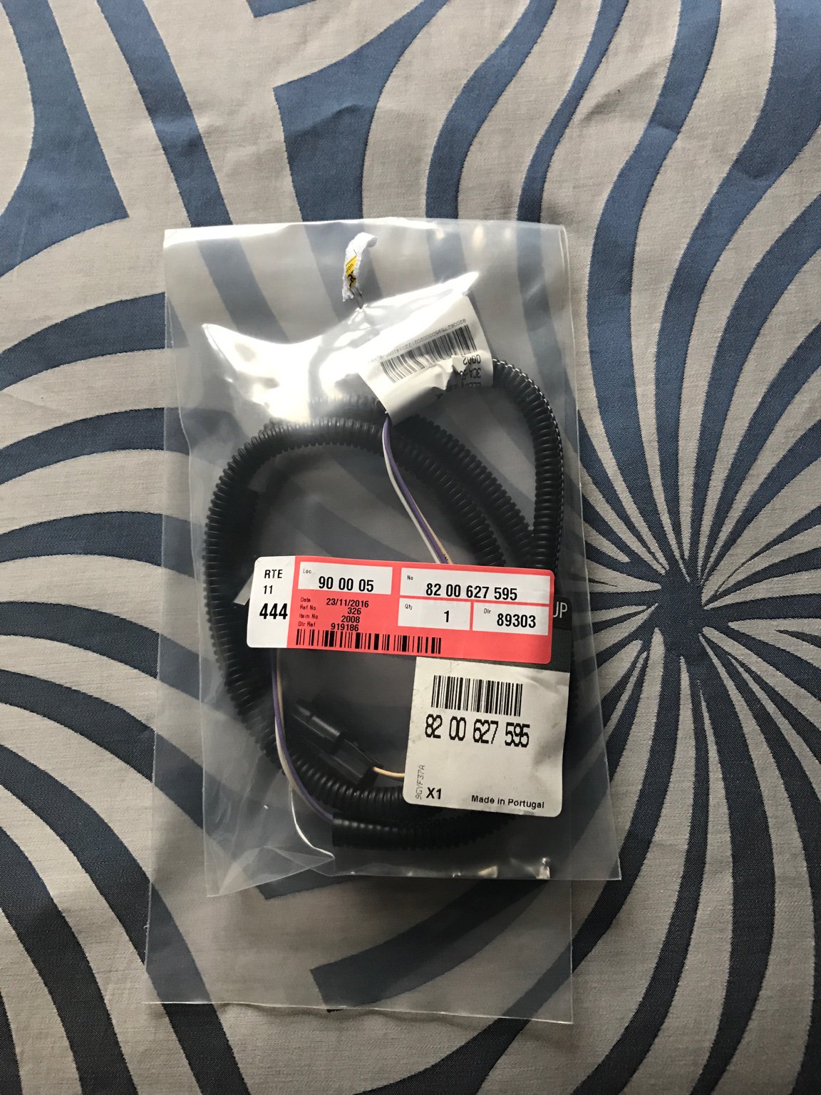

So the loom for the rear xenon level sensor arrived, hopefully this is the correct one, along with some genuine front mud guards to try reduce the beating the rear arches take.
