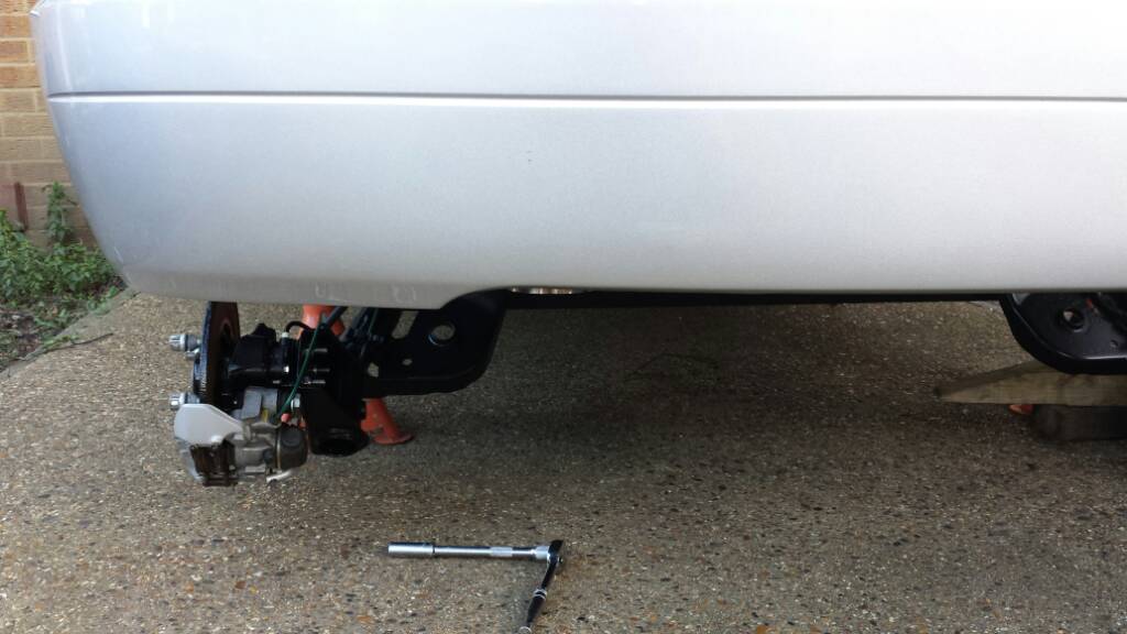

My one's fine. :D

My one's fine. :D
Says the man who's car is on axle stands... :P
