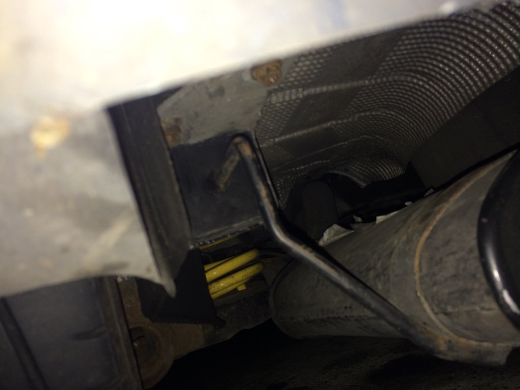

My exhaust seems to be knocking on the rear axle. I have a ktec stealth but I'm sure it's not properly aligned so was wondering if anyone has any recommendations for somewhere to take the car for the exhaust checked and adjusted if needed. Local to Newcastle ideally. I do have new hangers but it keeps slipping off the middle one. I've split the middle one within 100 miles of use as well. When jacked up the exhaust is about 1.5 inch from the beam itself hence unsure if aligned properly.

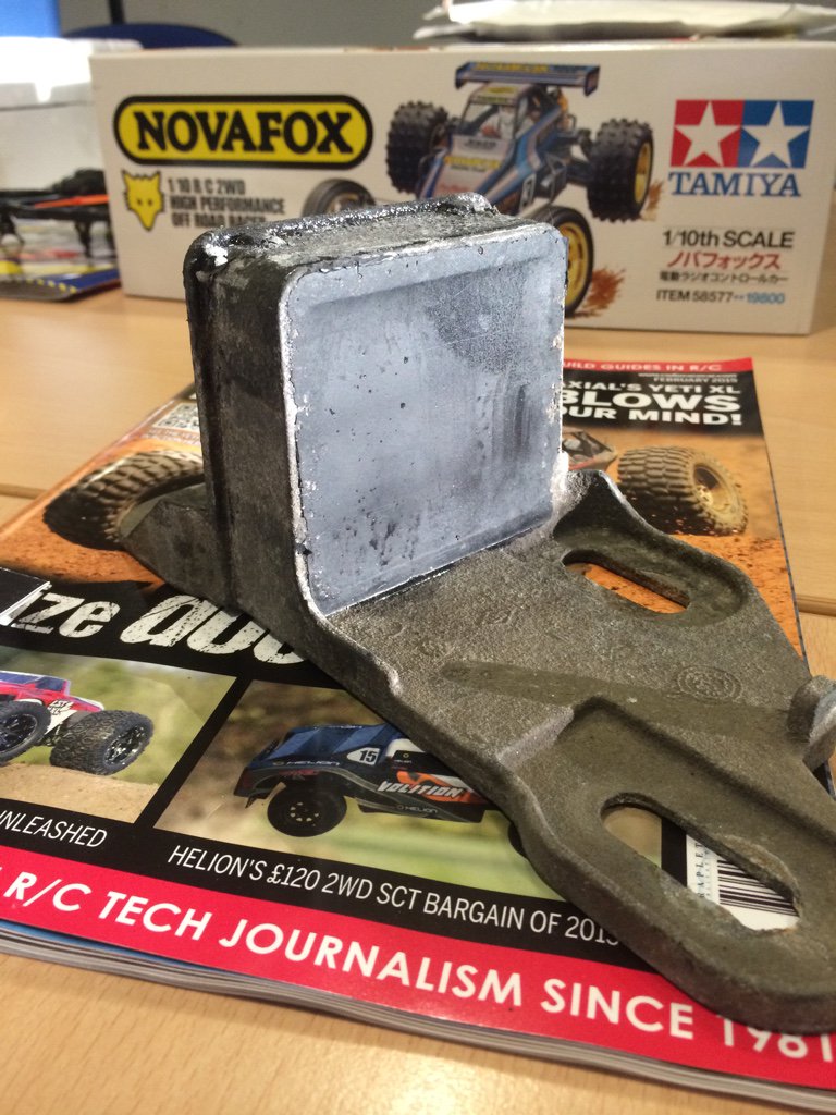

I make these.
It's made from 70 shore polyurethane (for comparison, powerflex purple wishbone bushes are rated at 75 shore)
I've been using one on my daily for the past, there's a few guys on the CSOC fb group using them and I've sold a few on here recently.
It does away with the stupid rubbery spider in the mount and is a block of polybush that I can either pre-drill centrally, or leave blank for you to drill yourself (giving you the option of setting backbox height and positioning etc.)
I do them for £35 delivered (with a £5 refund on return of your old one) or a pair for £60 delivered (182's etc)

Could I put some soundproofing or something on the rear beam and exhaust where they touch, or nearly touch to reduce the knocking and vibrations? As a short term temporary solution?
  dan's cast offs.
no, will make it even closer and be worse.
get a standard exhaust mount, stand a 21mm nut on it's side in the bottom section of the mount and then fill all the gaps with windscreen adhesive. leave it to go off and it will be fine then all you have to do is re hang the exhaust.
also check engine mounts as when they are sort the engine will drop, lowers the angle of the exhaust in turn bringing it closer to the rear beam.

Could also be that the middle mount has gone making the exhaust bounce too much. What sort of condition is yours in ?

Did you ever fix this problem @j4mes-c as i had this to,but then got the exhaust adjusted and it went,but now since i fitted coilovers and its obvs lower its knocking again but only over speed bumps.So guess it needs re adjusting.
  monaco 172
My ktec stealth doesn't knock but it's just not stealth at all lol.
Re adjusted the band but I just can't get the exhaust to be stealth, it's so annoying. The tail pipe hangs about and inch below the bumper.
Next step is a powerflex mount but I didn't really want to do it as I read they cause resonance through the boot floor
