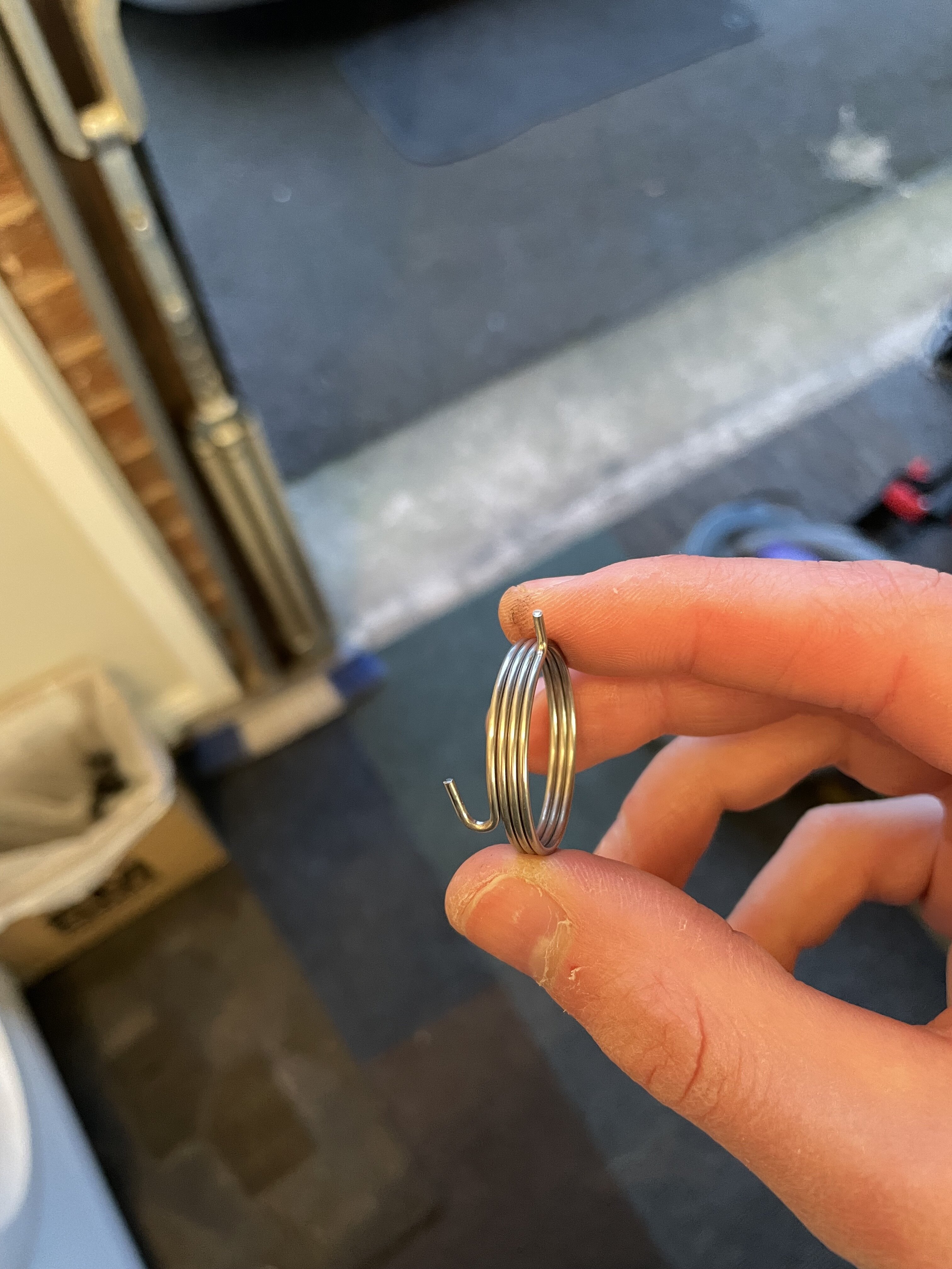

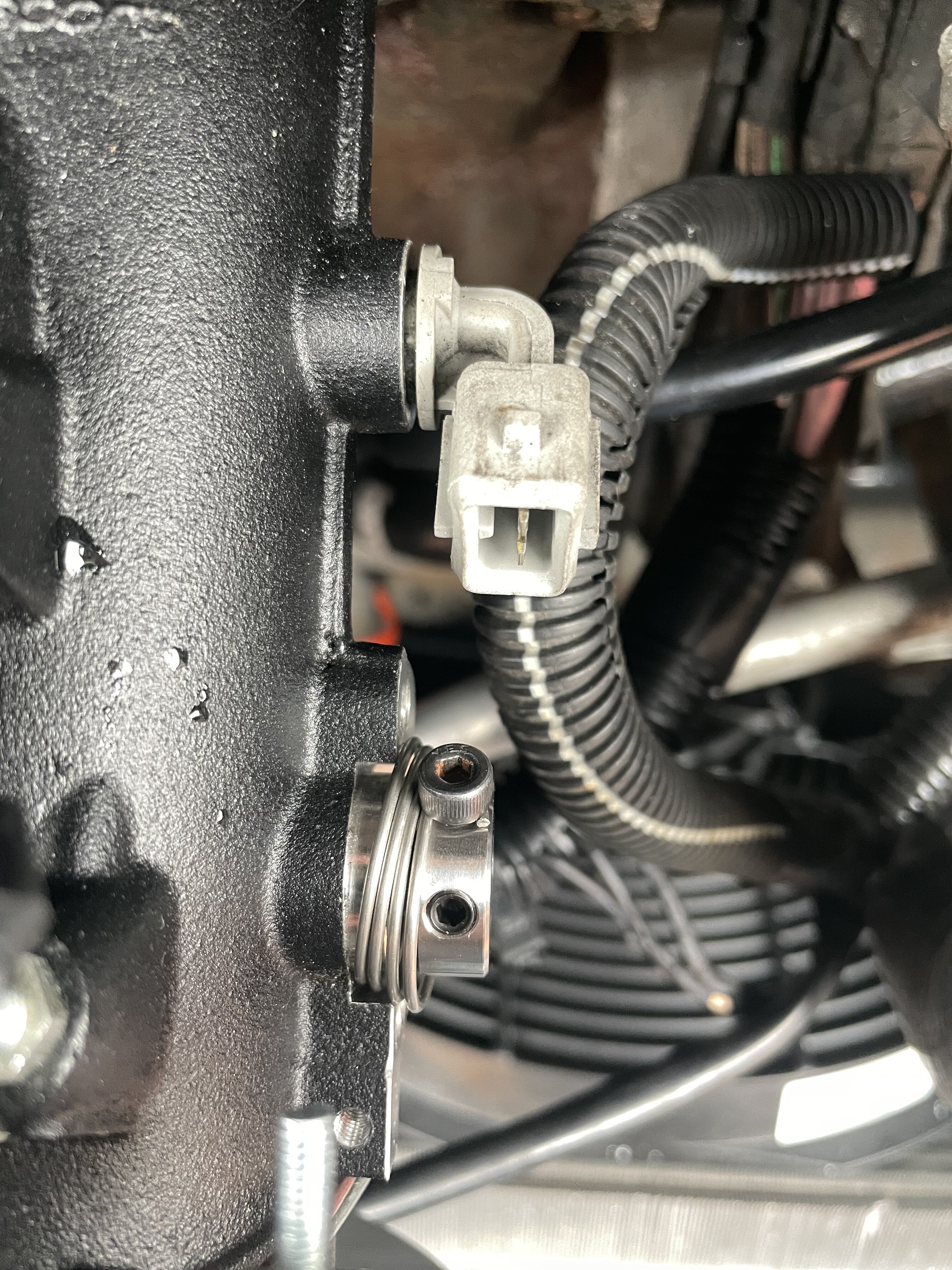

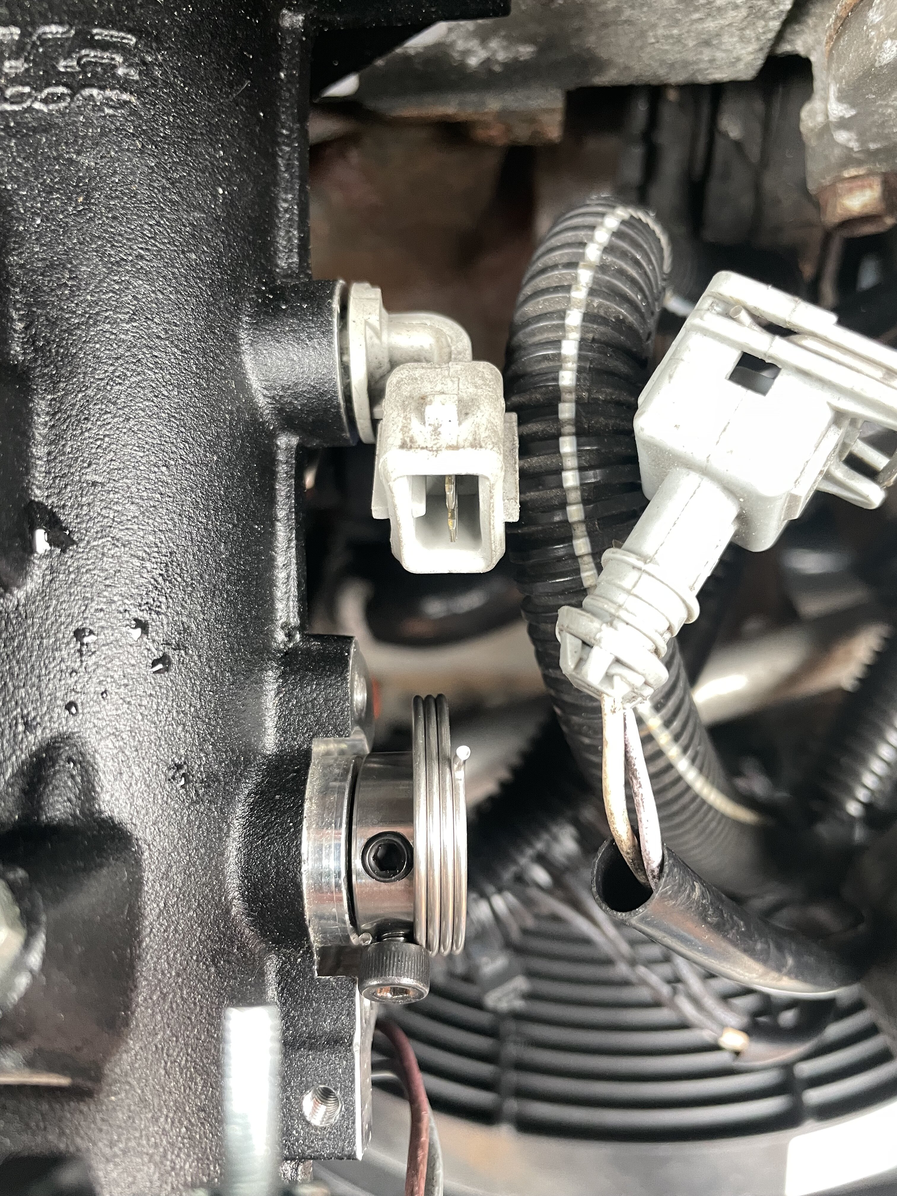

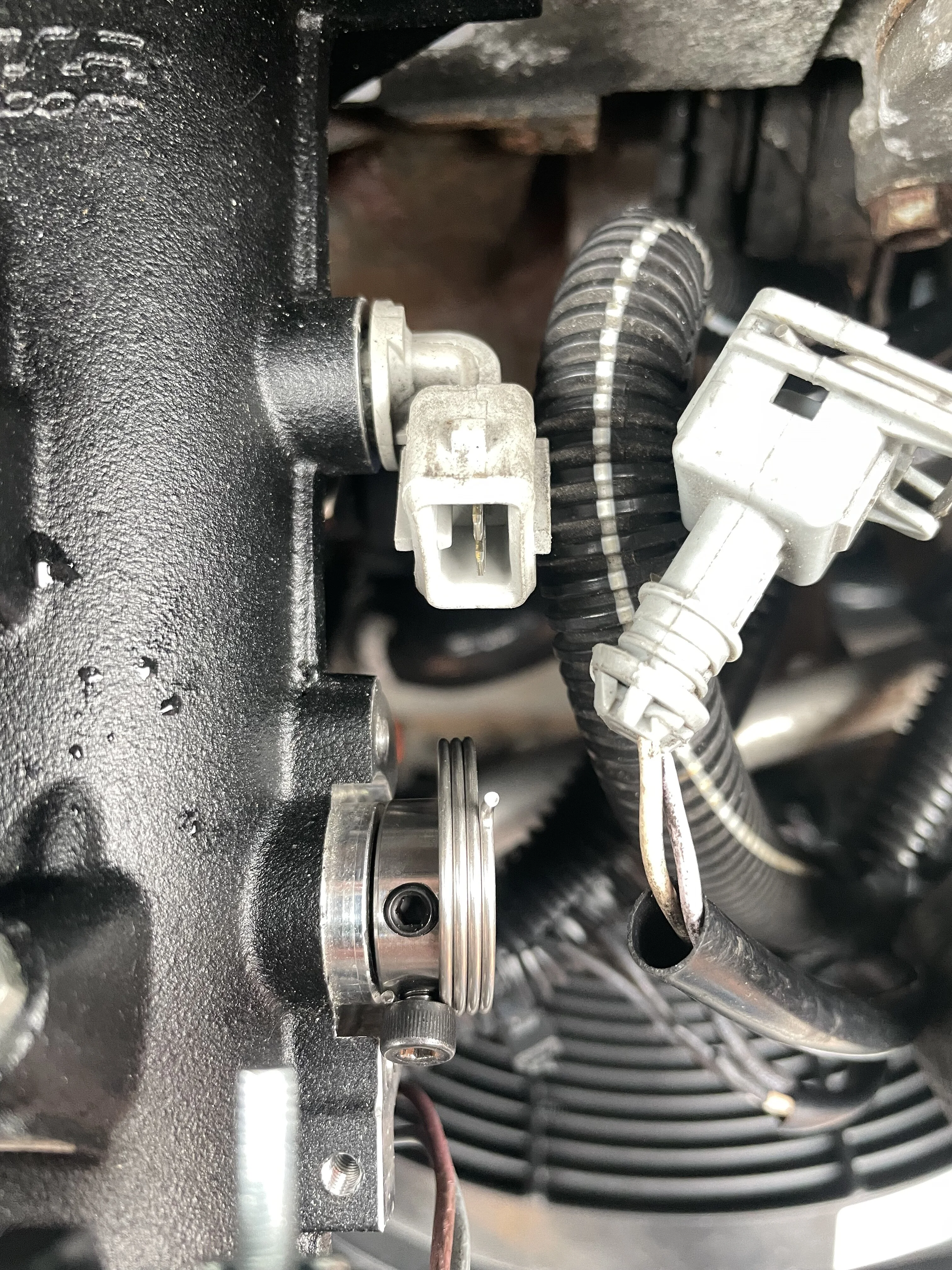

Spoke with KTec and they said there was another spring to fit on the other end to the TPS....so there is!! Got it out and went to fit but from what I can see it is all wrong and the way this spring coils is backwards - so when the throttle opens the spring un-coils.
View attachment 1638000 View attachment 1638001
View attachment 1638002 <-- this doesn't even work!

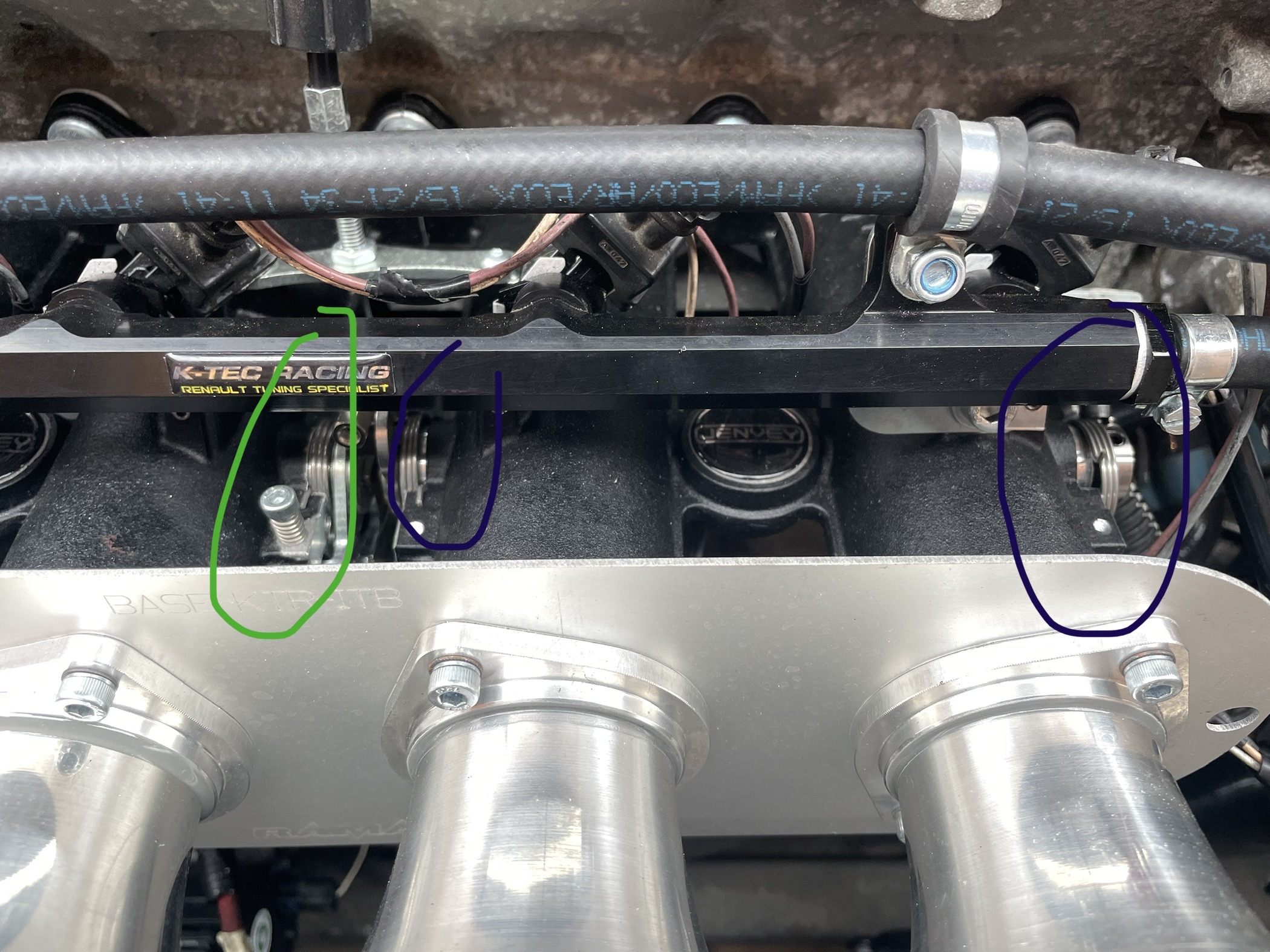

Looking at the linkage between the banks of the bodies there are two springs, it looks like I have been given the oposite (blue) one to what I need (green)

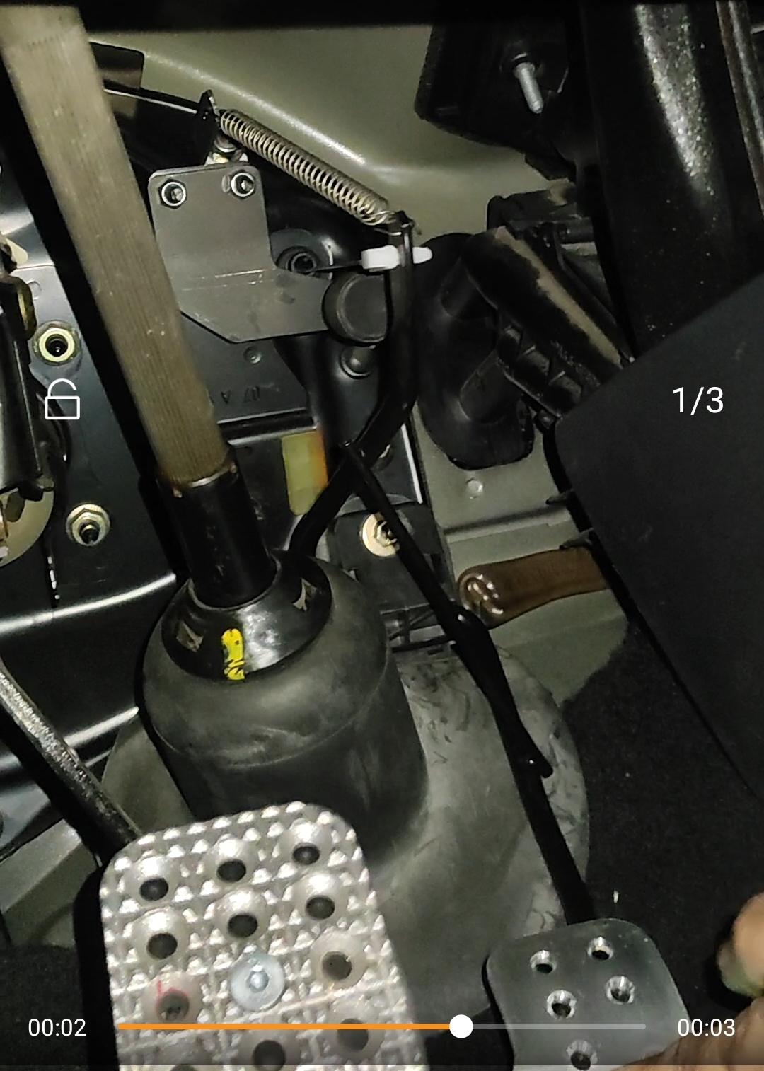

Attached a spring where? On the back of the throttle pedal? Got any more details and info on this?
Sure, I attach a picture of it.
Gas pedal is from non sport because I have non sport pedalbox, but the idea can work also on std 1*2 pedal.
The L shaped thing is an adjustable travel limiter I made, it has a rubber stop.
Anyway drilled a little hole just above throttle cable and then fabricated a little L with a hole to attach the spring.
i fitted that L under one of those oem nuts (replaced the bulky oem with a nyloc to compensate L thickness).
Works as a charm for me.
