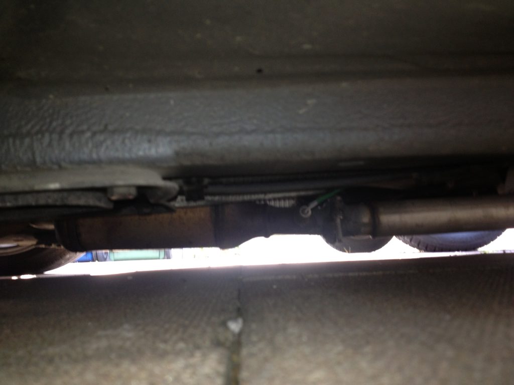

As it come to speed bumps mine catches all the time it's not sitting up in the car.
Any advice would be good cheers

yeah mine sits low as hell too, and rattles like mad on the rear beam, even with a brand new rear hanger, it still bangs like mad on the beam!
Centre section to back box needs adjusting if its hitting off the beam.

mine has dropped but I know I need to adust mine
best advice is get the back box up as much as possible and adjust the rear clamp to suit

Get a jubilee clip round the centre mount to pull it up a little, and shove it as far forwards towards the cat as you can on the split section
