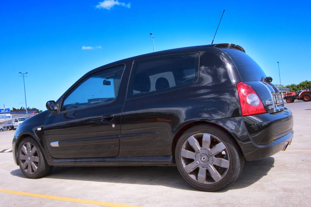

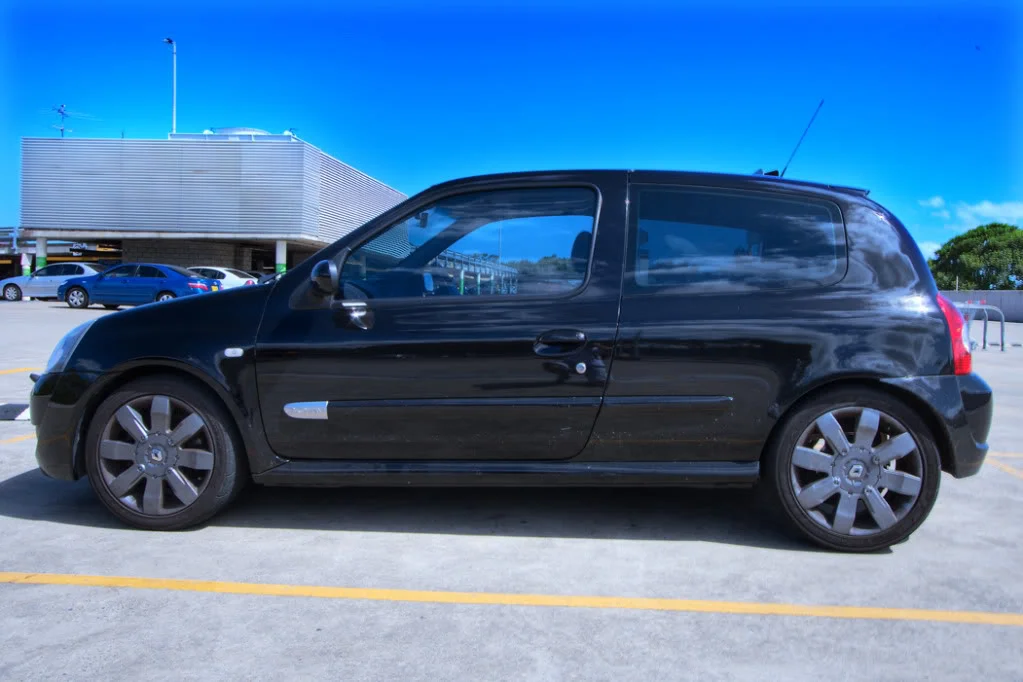

anyone with pics of the car with the springs on?
I want eibach springs, that I'm sure. it's ok for the mot here and what I want is just less bodyroll and a bit firmer ridequalitiy
I'm just not sure yet which ones, the pro or the sport. I'm affraid that the sports with the 30mm make it to low...
so if anyone has a pic and is wiling to post it... ;)
Da
  Less
There's pics of mine from when I had Eibachs on. Have a search in the media section.
Found it - click me
  RSC 182 Cup

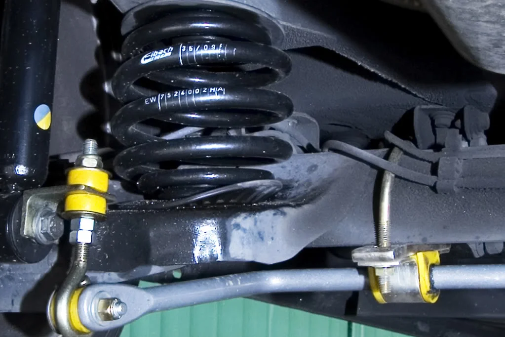

Here is mine with Eibach Pro kit and Whiteline ARB
