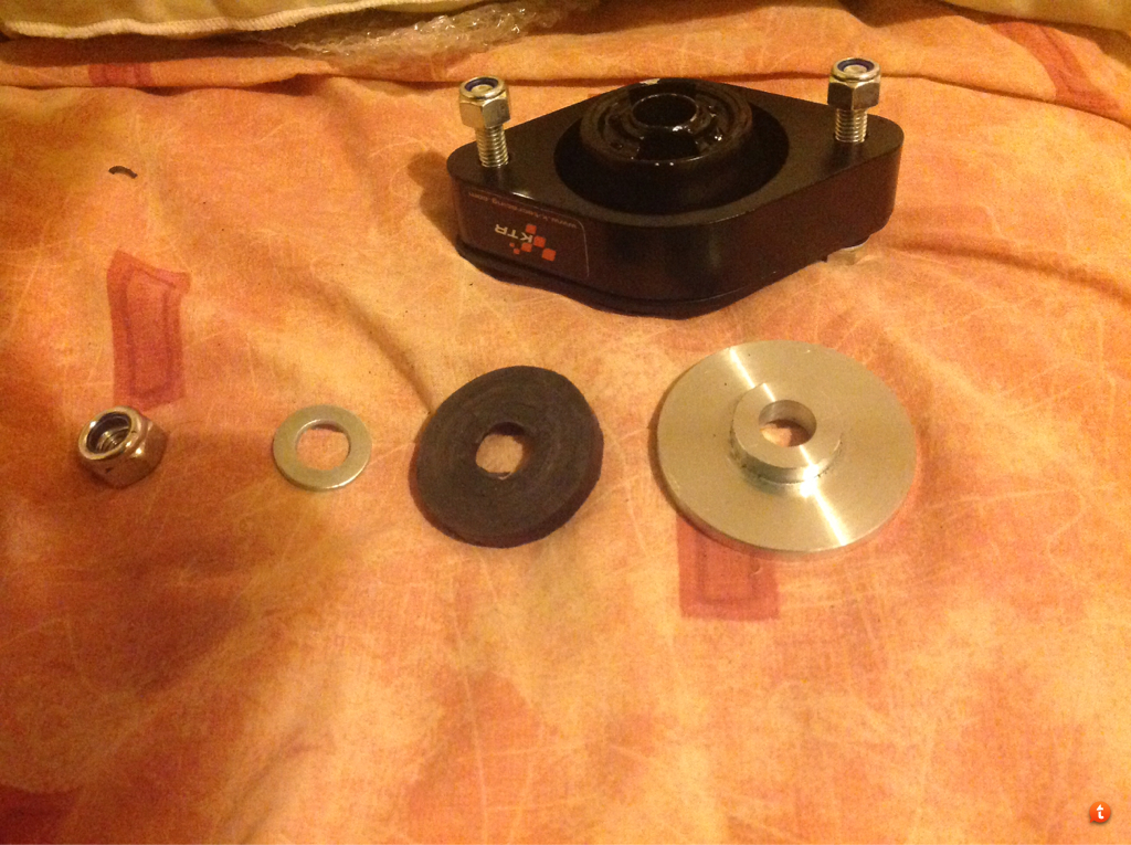

As per title, I was just wondering what order this little lot goes in?
Jonny
Ok can anyone tell me if the round rubber piece (3rd bit from the left) is supposed to be detached from the main mount?
I'm pretty sure it's meant to be detached, I received my yesterday (brand new and it was detached. I can check the order tomorrow.

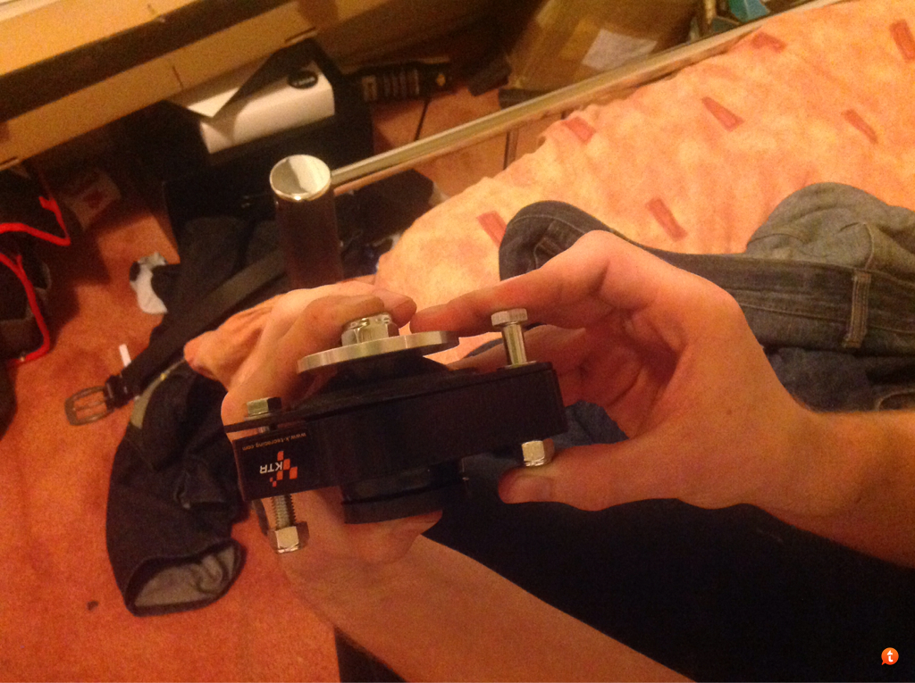

order of fitting
rubber ring with the flat edge facing down, curved ring facing up
solid casing (the bit with the KTR sticker on)
rubber mount
large silver disc
washer
nut
