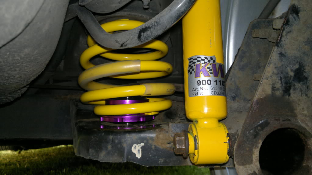

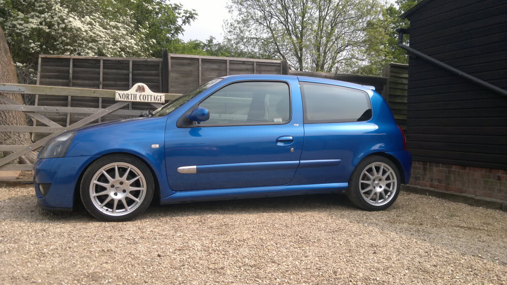

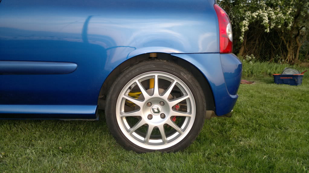

Just started to fit a set of KW V2.....completed the rear but thought it would be lower....

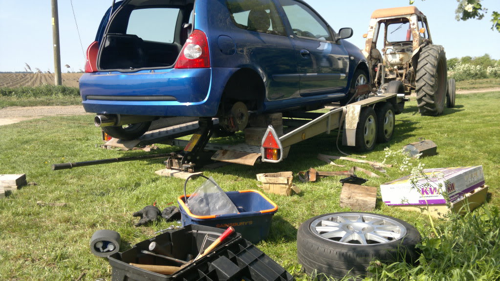

Part way through..
Completed rear and view from side....

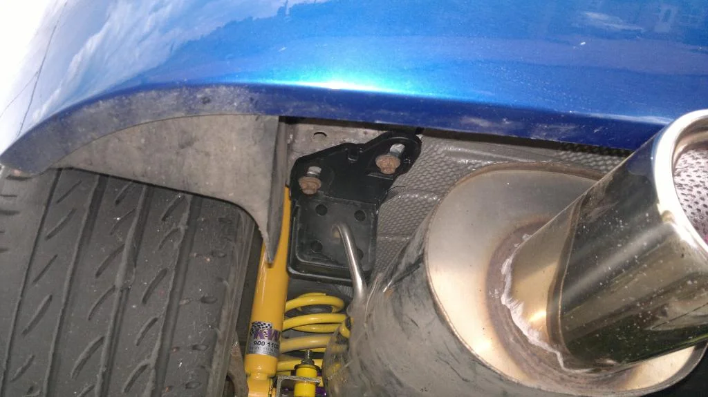

It is lower but have the springs adjusted to about 3-4mm off their lowest setting.
Is this about right....also should I have removed the plastic tubing around the spring??

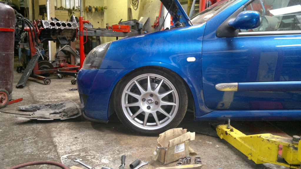

Using my mates garage and lift to do the fronts on the 28th, though still waiting on new AST top mounts to arrive from kamracing. Going to Bedford on Sat 30th April so more than likely they won't arrive in time and I'll have to fit later.
Any comments, are the fronts easy to swap? Fitting rear was ok seeing as I normally pay the garage (who's lift I'm borrowing) to do work on my cars.

Below pic isn't even on the lowest setting, I have them a lot higher than this and the tyres still rub on outside of the wheel arches when turning so will raise another 5mm tomorrow.

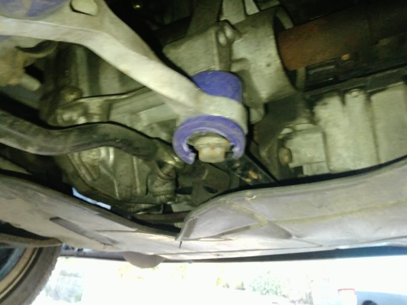

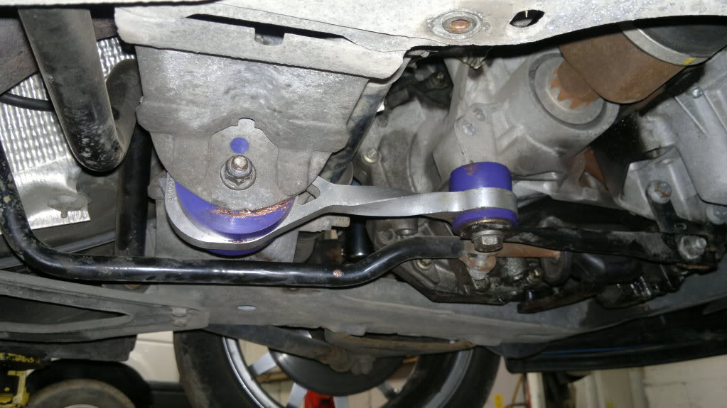

Dog bone done too............glad i did it in mates garage as needed a press for this. Otherwise would've taken ages and lots of cut fingers and maybe a damaged dog bone.

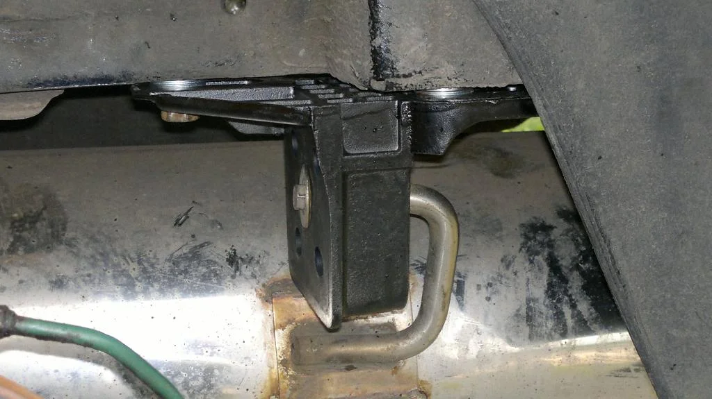

engine side bush is upside down on the dogbone. you want the smaller part of the bush against the engine.
Got to raise the front tomorrow so will flip the dog at the same time, did fit with the smallest part on top first, didn't look level (if that matters) least I put the washers on.....cheers for the help.

HI MATE IVE GOT THIS SET UP ON MY 172 AND PN THE REAR I TOOK THE ADJUSTERS OUT TO LOWER IT AS MUCH AS I COULD AND THEY WORK FINE BEEN LIKE THAT FOR BOUT 4 MONTHS JUST AN IDEA PAL

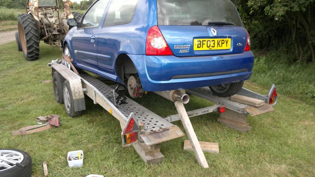

Loving the jacking on the trailer technique;)

It didn't get on the trailer so had to used bits of wood to get it on...managed it in the end.

the problem with fitting it the same as the picture, is that the dog bone itself is further from the gearbox and the upper part of the bush will flex about. that's my take on it
  172/1.2/E30
there is no washer, that is the problem and the cause of the split bush. big bush needs to be on top to absorb more of the vibration.
  172DD Cup
i can see a washer :rasp:
but the more i think about the bush the more i think you're right and the taller end should be against the gearbox. if you look at the oem bush, it has a taller side, and that side is against the gearbox. i've had mine fitted with the shorter side against the gearbox for 8 months and no problem so i don't plan to change it, but i'm curious now

I run my KW's without rear adjuster as well.... has been like that for about 2 years now and done 2 trackdays and been fine :)
the problem when its like this witch i had with mine is it makes the hole in the gearbox end egg shaped

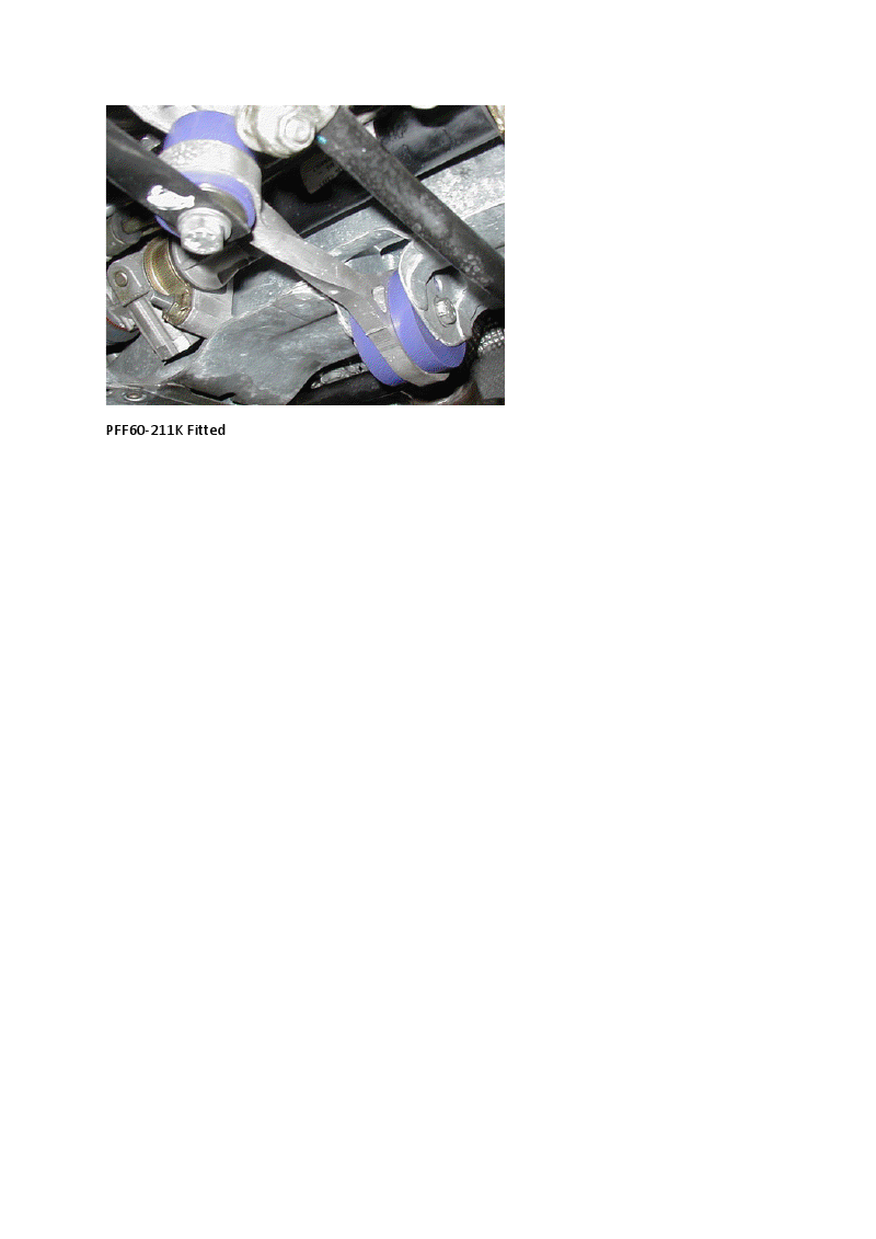

back to the dogbone, i had a reply from powerflex who tell me that it should be fitted with the taller part of the bush against the gearbox, they sent me this pic. i'm still not convinced to change mine though! i've never heard of problems with it fitted with the shorter end against the gearbox, only problems with it fitted with the taller end. here's the pic.
apologies for the big gap after the picture, blame powerflex :rasp:

I also inquired of the fitment of the standard dog bone mount and was told that has the taller part to the top. I did have a look every time I jacked the front up to raise the ride height when at Bedford and could see no deformation, will just keep an eye on it, gave a good noticeable change to the feel of the gearbox\changes etc.
Just heard from the garage who are fitting my KW's today and they are saying they cant get the back low enough. Is this the only way to do it by removing the adjuster? Is it safe enough?
I never took off the adjuster as the spring can move (safe or not is personal choice), looked at getting the adjusters cut to get extra 4mm..then thought not worth it....horses for courses. Though might change my mind if I put 15 inch wheels on to go tin topping next year (then I'll move up to AST's anyway).

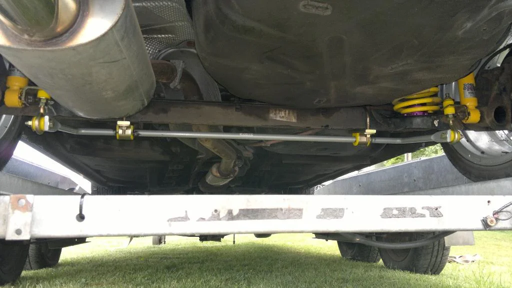

ARB fitted....
