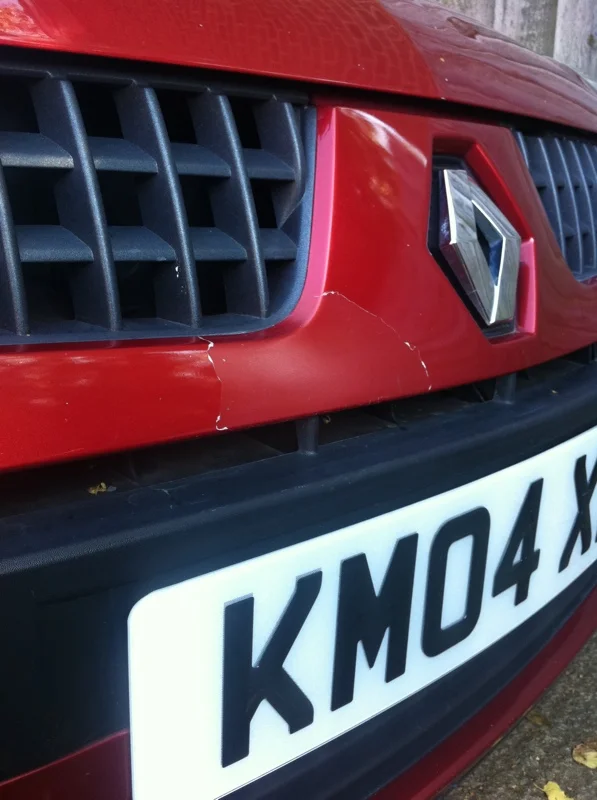

Hey guys..
Any advice on what I should do with this?
I got 0 clue, all I know is that it needs sorting, before it gets any bigger

nothing you can do really, its needs a repair.
The chances are if its coming of in one spot it will be starting to come away in others.

my door did that last week thank god i could sneek it through the oven at work just needs sanding back and blowing in its a easy job

Let me know how that goes. You can't just "blow in" some lacquer.
You still need to coat the full door.

Sure it does mate.
If you haven't coated the full door it will look s**t. This is fact.
Lols at "blowing in" a door, I'd put my car on being able to spot it a mile off. For a start it would need feathered out, good chance you'll break through doing that so it'll need priming and colouring up to stop it ringing.
To the OP, get the whole bumper stripped and re-done, its clearly been done on the cheap at some stage and that's why that's happened.

I dread to think what the companies work is like if they're blowing in lacquer on doors.
Yeah I think it's had a little front end crash in the past, as the 'background' of the drivers side light is grey not black and the drivers side wing has also been replaced as its super shiny.. on top of that the drivers side fog light hasn't been put in properly.
Ok guys, i'll get it re-done, I'll send off for a quote from spray shack
