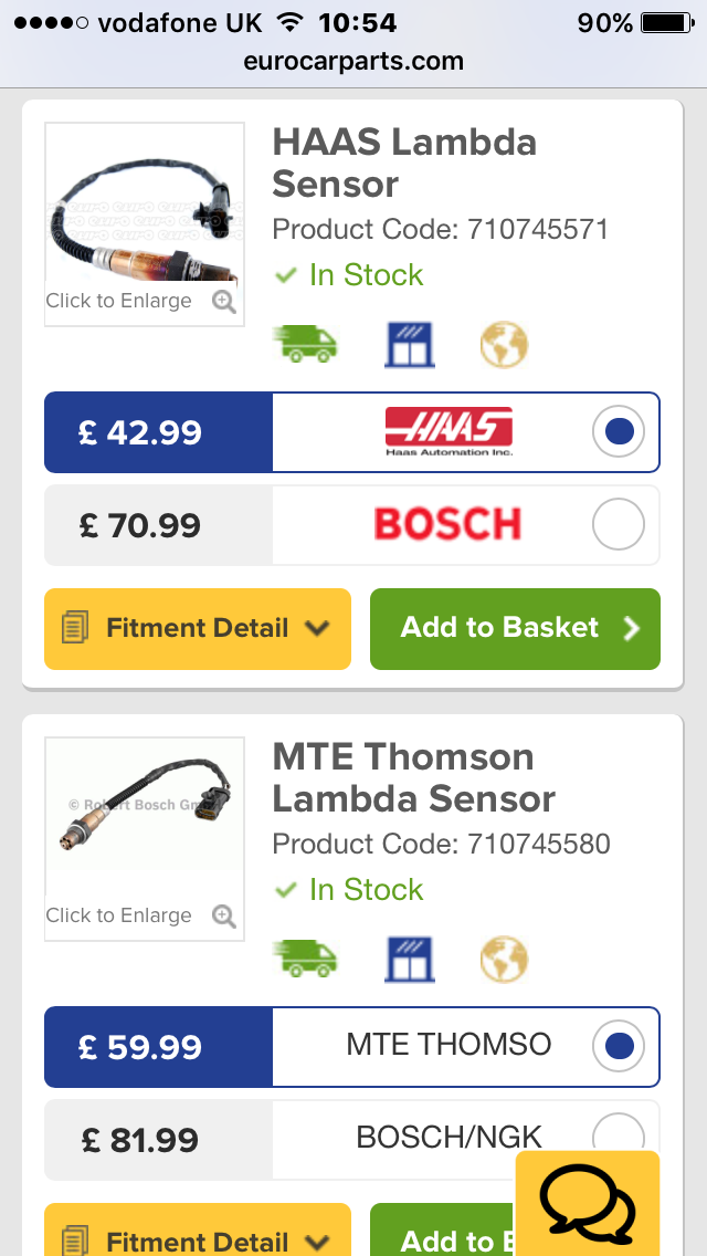

I got my lambda senors from europarts , bosh ones. I bought 2, they are 480mm.... I have to fit a brake senor..maybe clear the fault,what reader did you buy?
Yes i heard to only ever use the bosch ones.

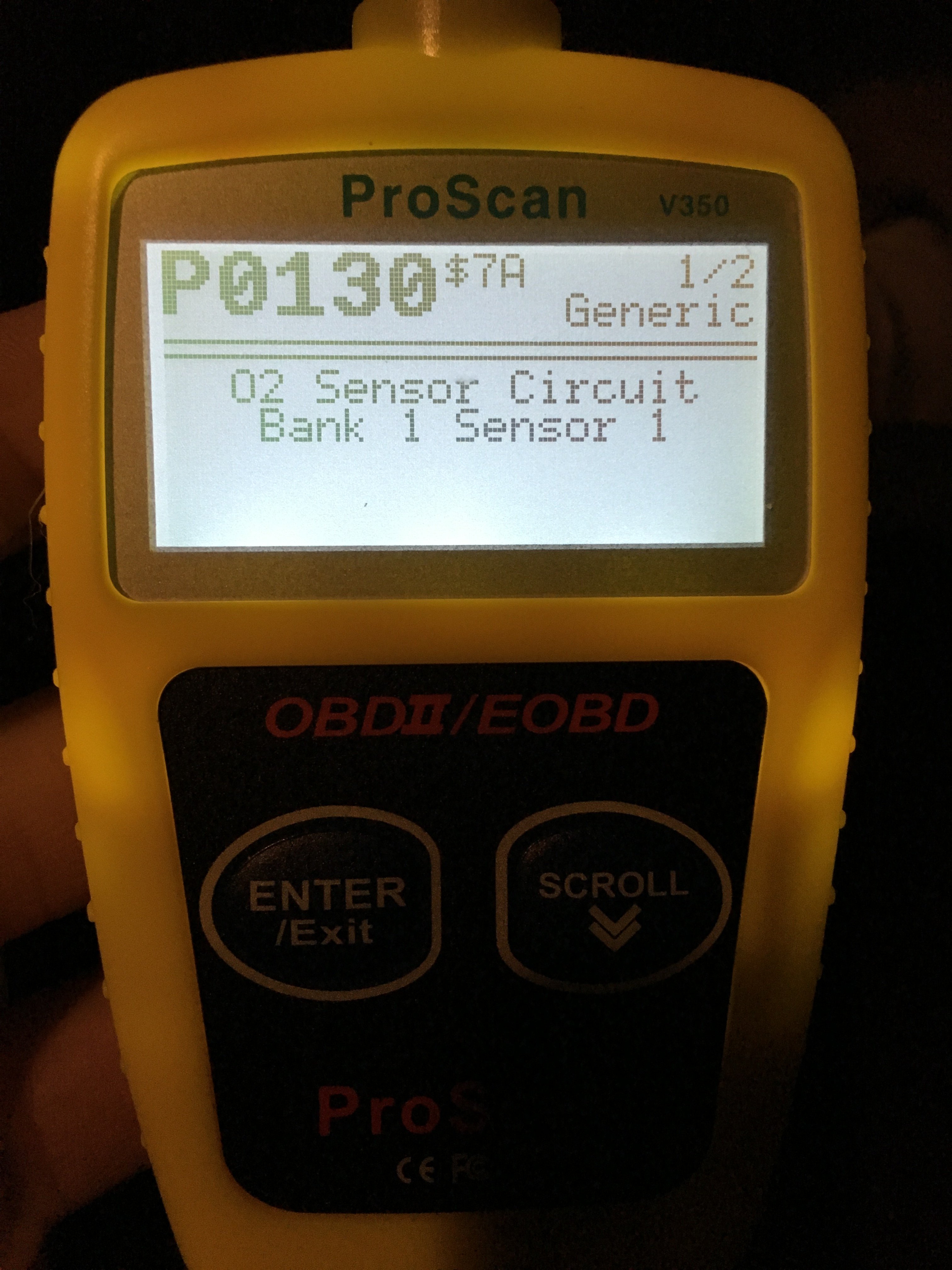

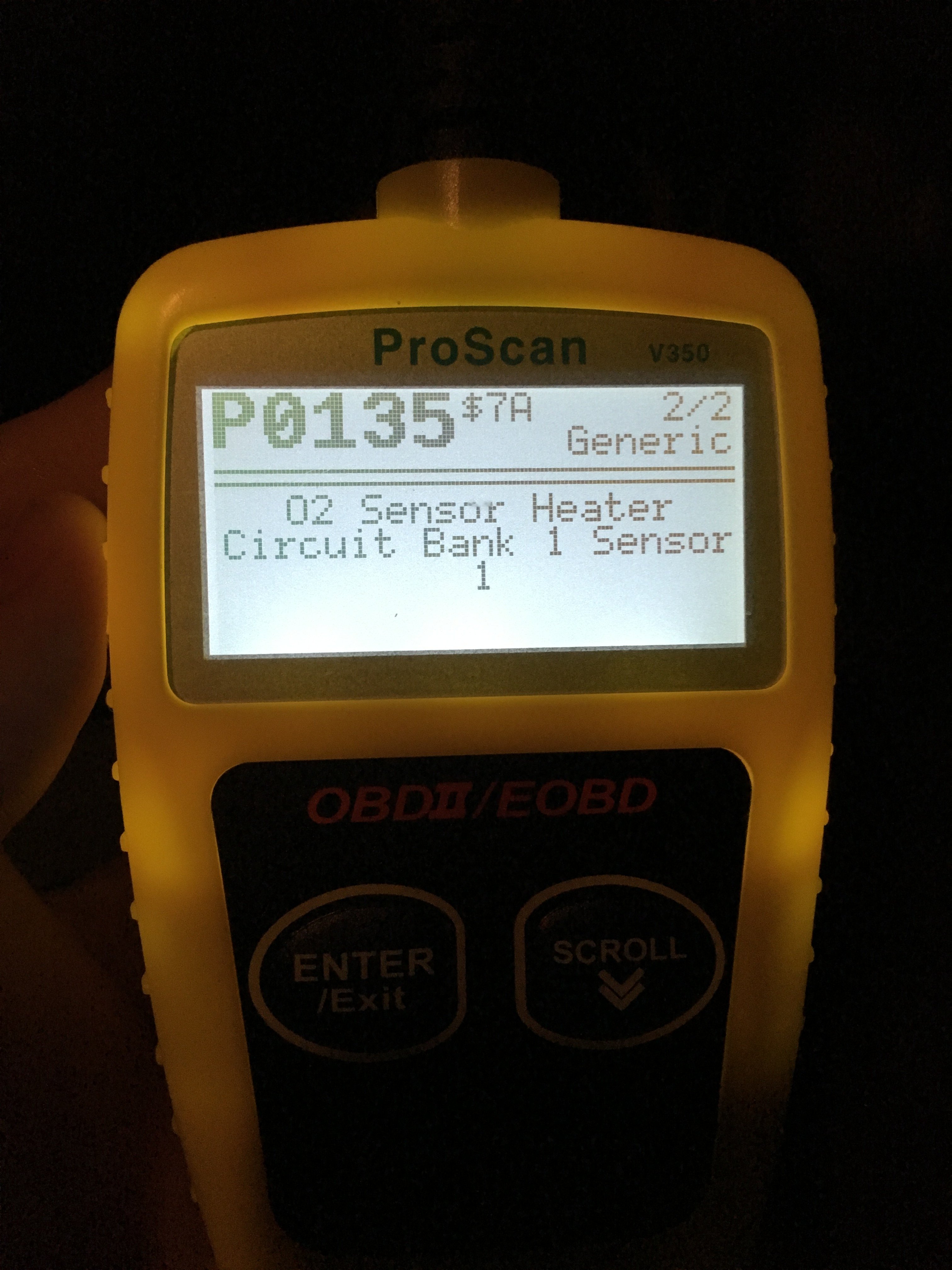

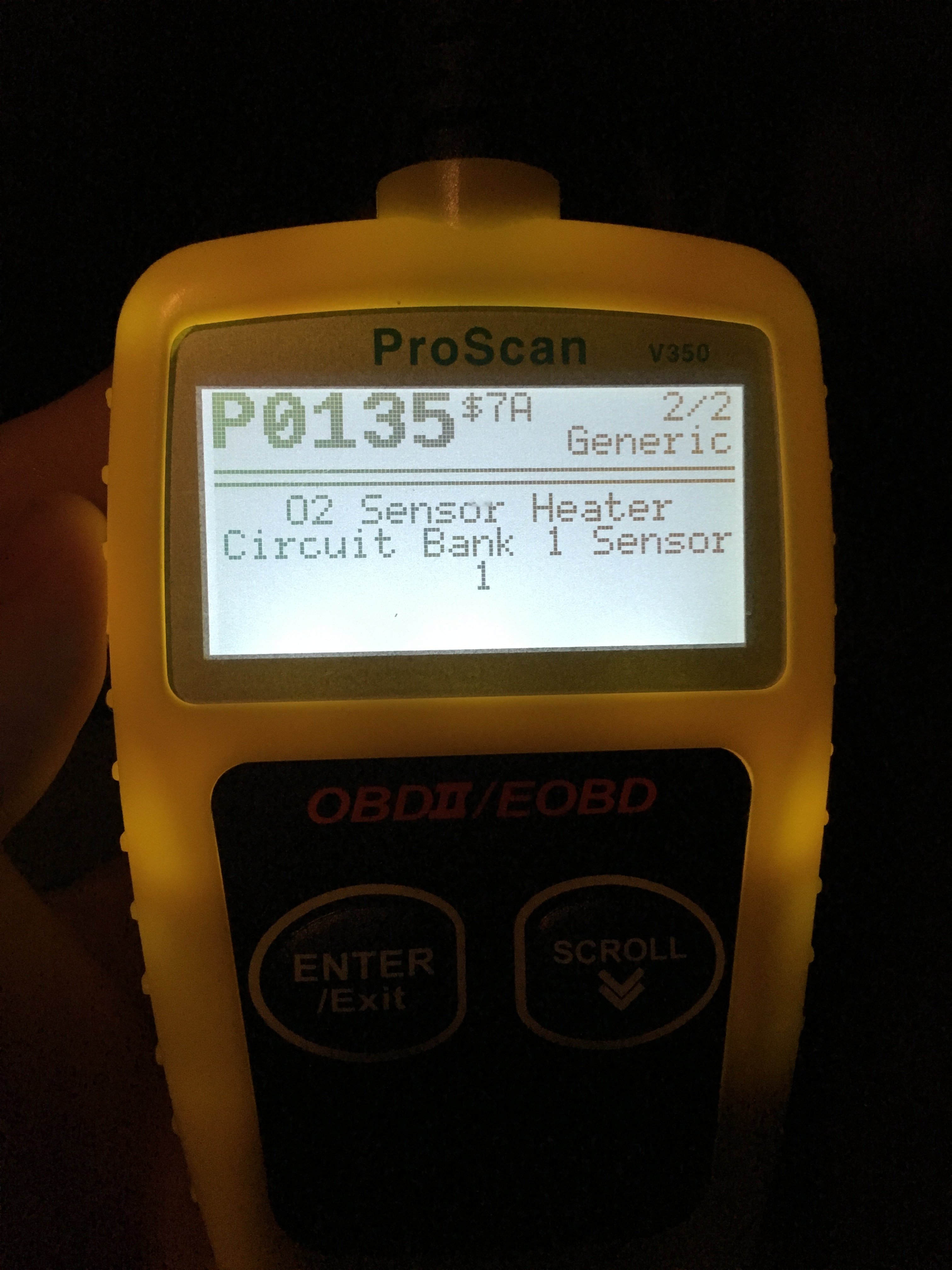

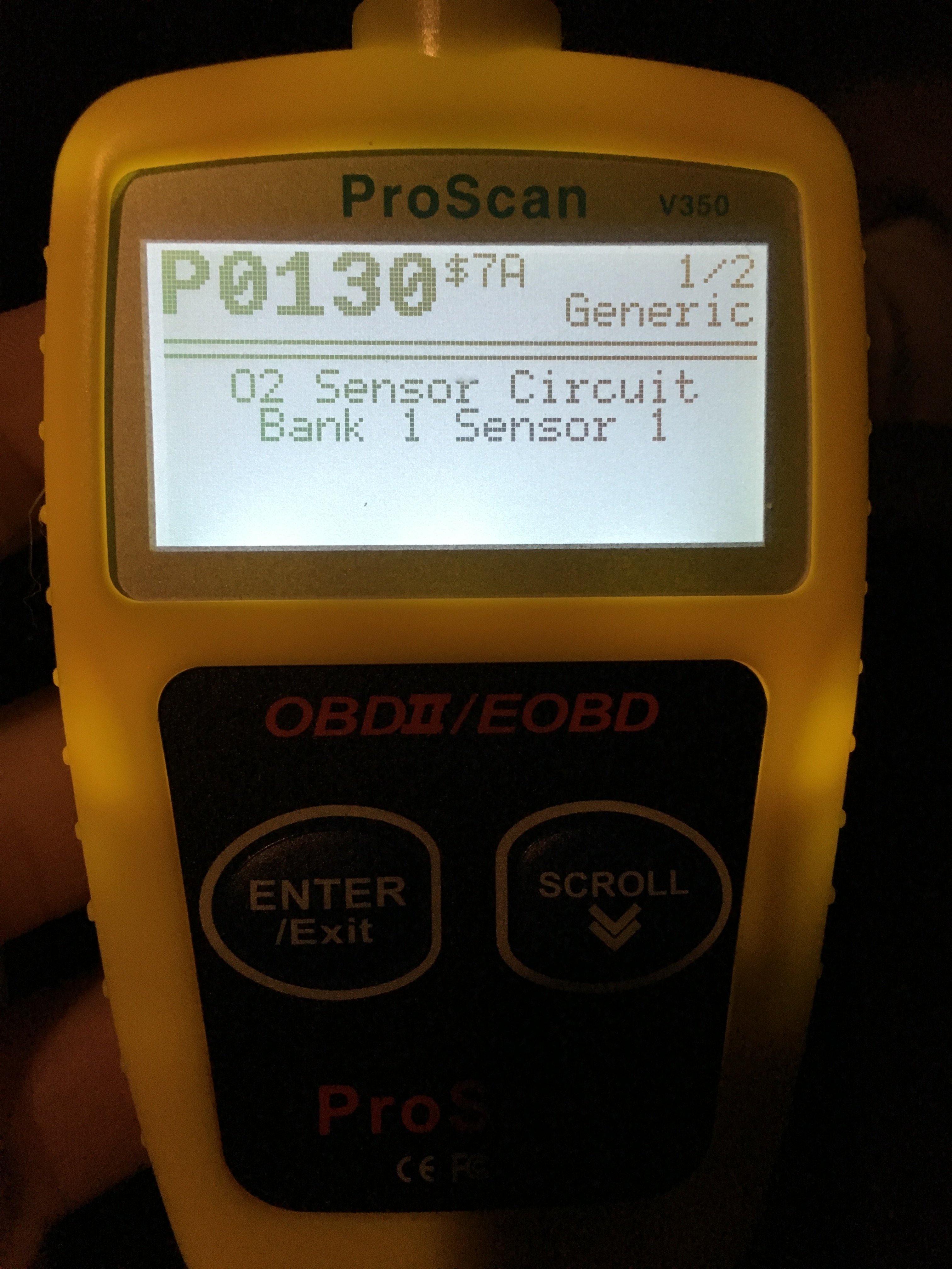

The fault reader arrived today so i have had a go. It brought 2 fault codes up, both Lambda although im not sure which is which ...
I have erased the faults and the light has gone off.
I will see if it comes back on before i change the lambda sensor.

View attachment 146989 View attachment 146991

Nice one . Well at least you've now tracked down which sensor threw up the fault code . Are you getting bad fuel economy ?
