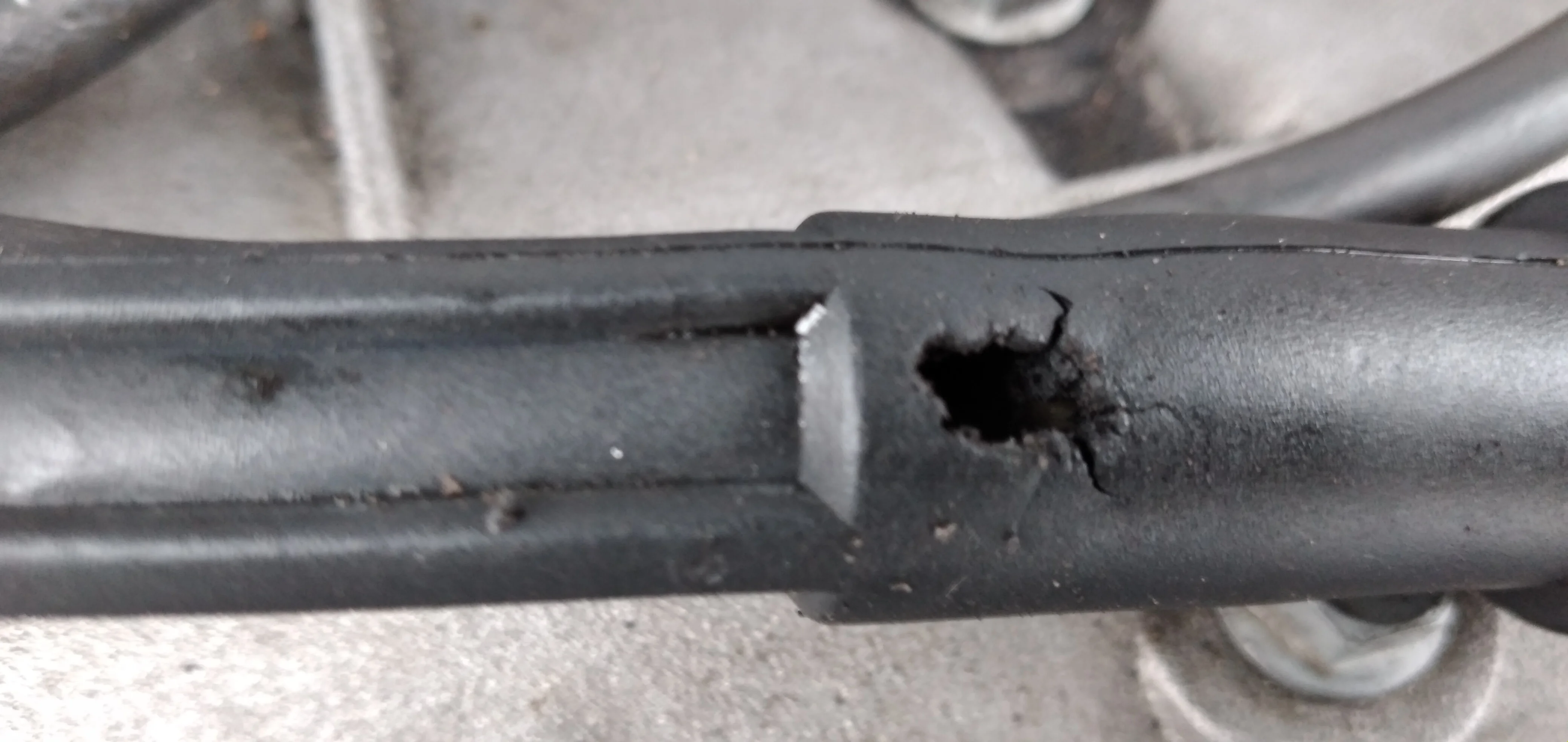

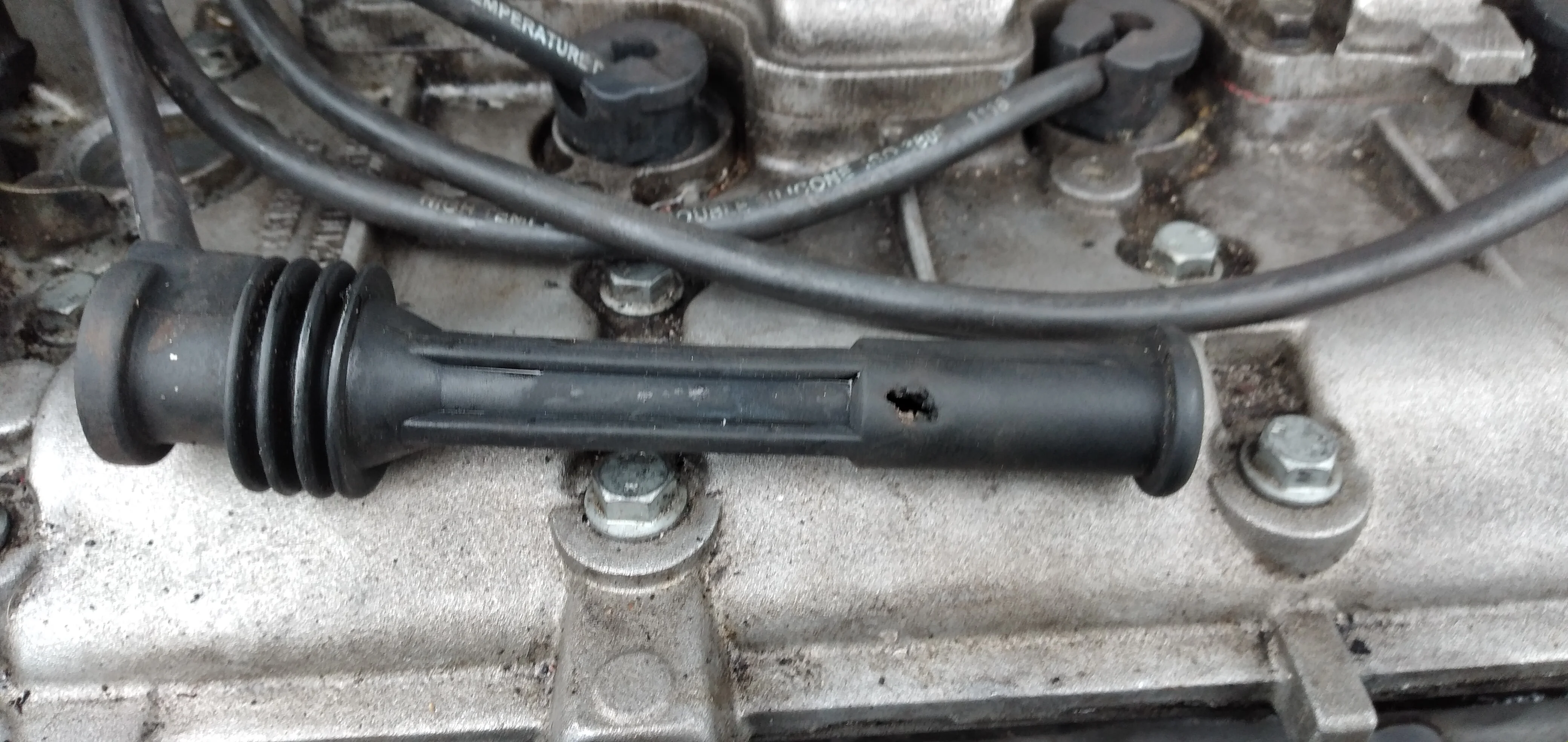

I hadn't noticed this when I cleaned the oil out of the spark plug well and re-fitted plug and lead.
The car started missing again and no wonder!!
I guess that when the well was full of oil the spark tried to divert through the oil, eventually blowing a hole through the rubber.
It must have either burnt away the socket in the lead that fits over the plug terminal, or blown it back, as when you fit the plug it there is no contact with the socket.
The second photo is with the plug pushed fully into the lead, but there is still a gap where the hole is.
This is my amateur explanation, but I would welcome any other ideas
