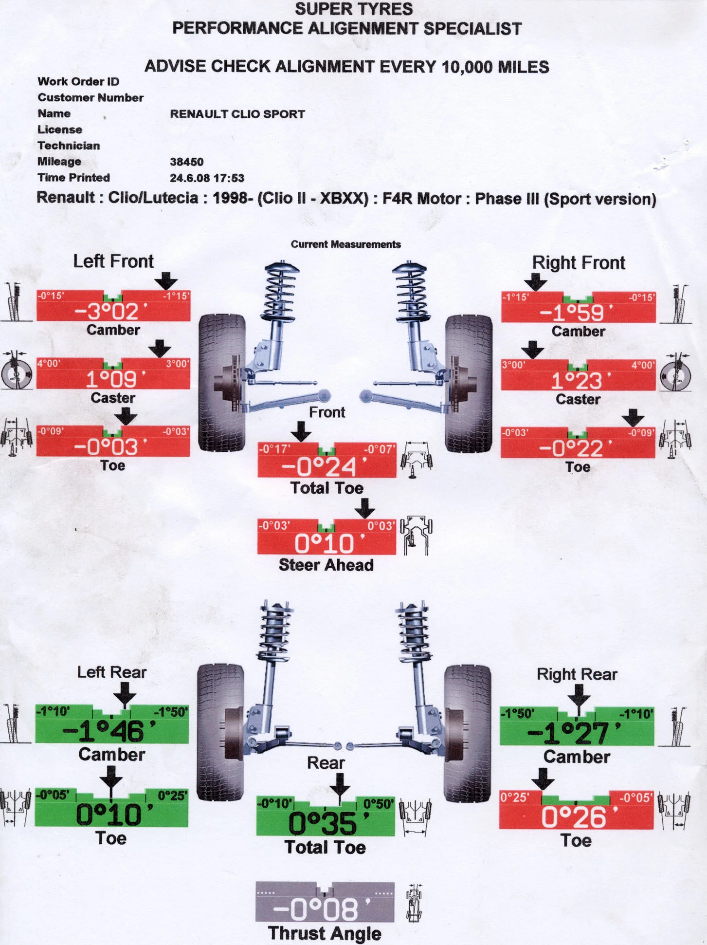

I went to get my tracking sorted today and ended up needing new front tyres as the ones on at the time were badly worn (the inside of one tyre was completly gone and the other was getting close to that). Had the new tyres put on and then the laser alignment looked at....
The printout below shows how bad the camber issue is and the bloke said there was no room for adjustment with std suspension even with some camber bolts. He recommended I went for coilovers to resolve the issue.
Is that my only true option bar to keep replacing the tyres? He quoted me £850 for a set of Spax coilovers all in, no idea if that is any good.

got to be something wrong with whats on the car as to be that far out and not even be modified seems a bit sus to me
no need for coilovers to fix that, he´s trying to pull yer trousers down, that needs some looking at
my betting is snapped springs, knackered top mounts, knackered ball joints and a knacered rear wheel bearing, not much really!
