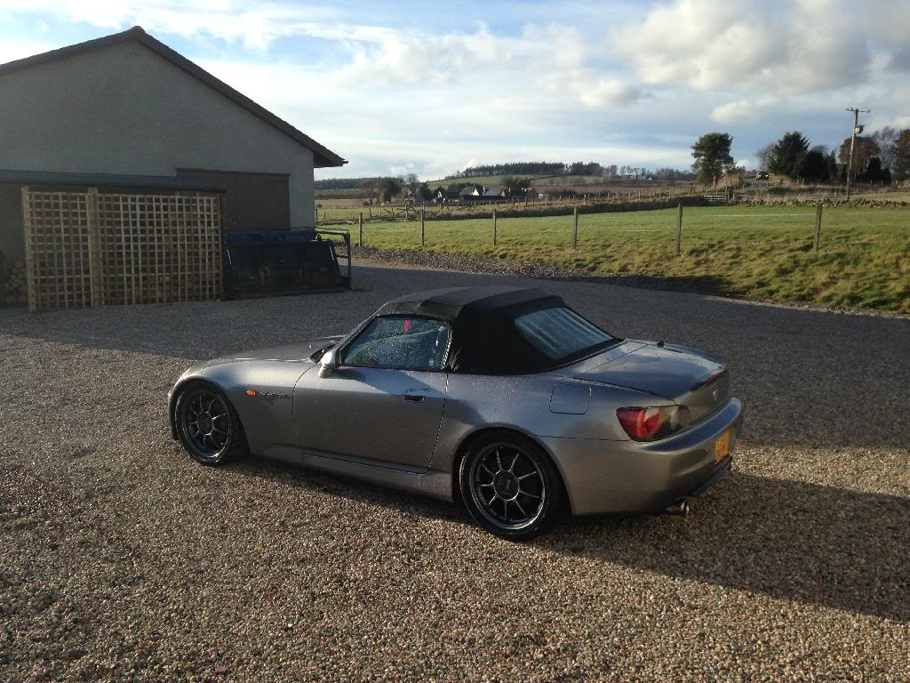

it is a standard 99 import other than the wheels. I was very happy with it but as always I started to modify it to best suit the track!

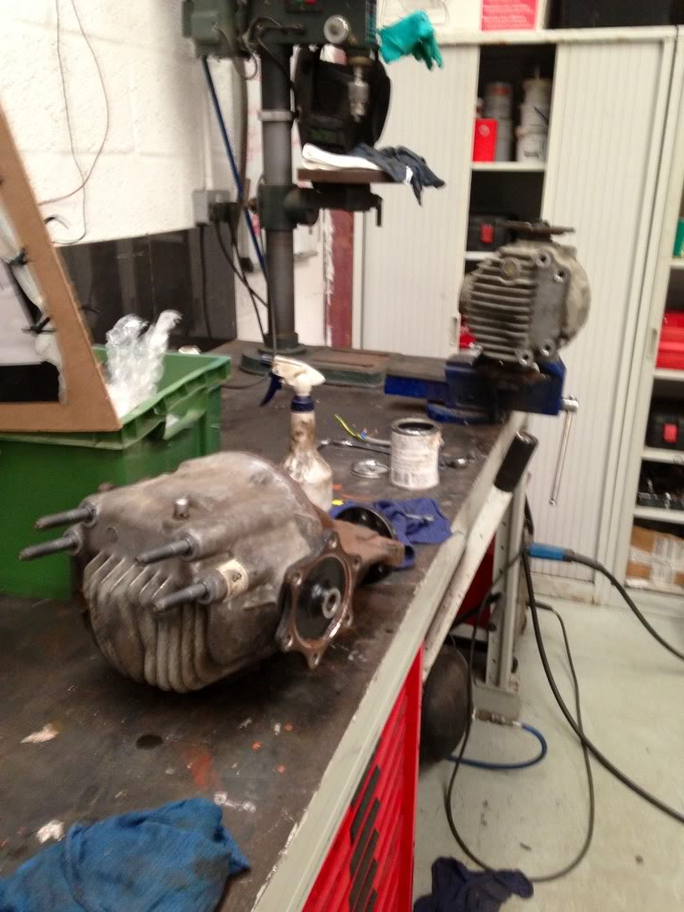

First up was a new rear diff with a 4.44 final drive. Totally transformed the car. I'm my opinion they should have come from the factory like this! Suits the engine so much better and really flies up the box now!

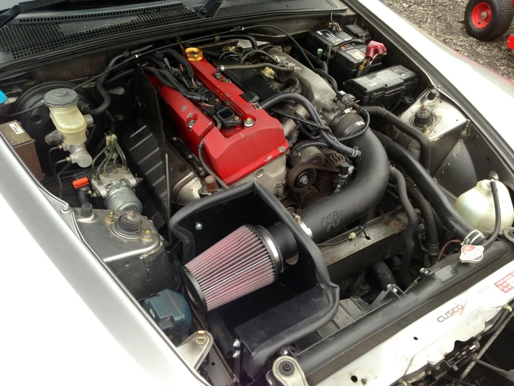

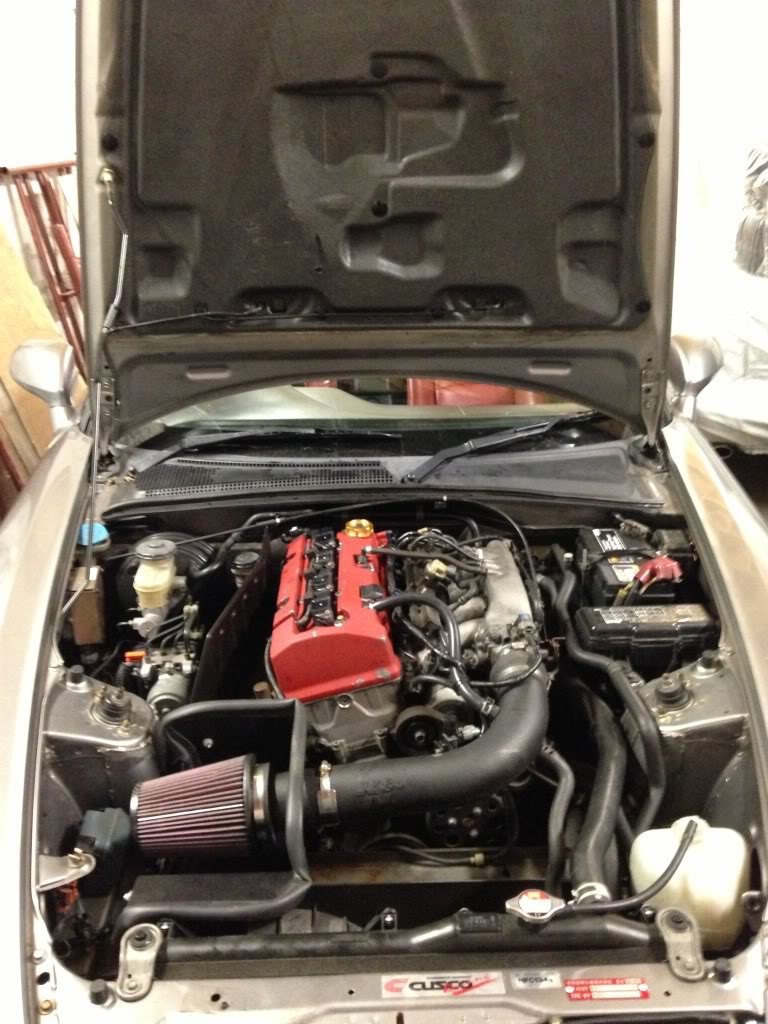

Next up was a k&n, probably does nothing for power but sounds much better in v tec

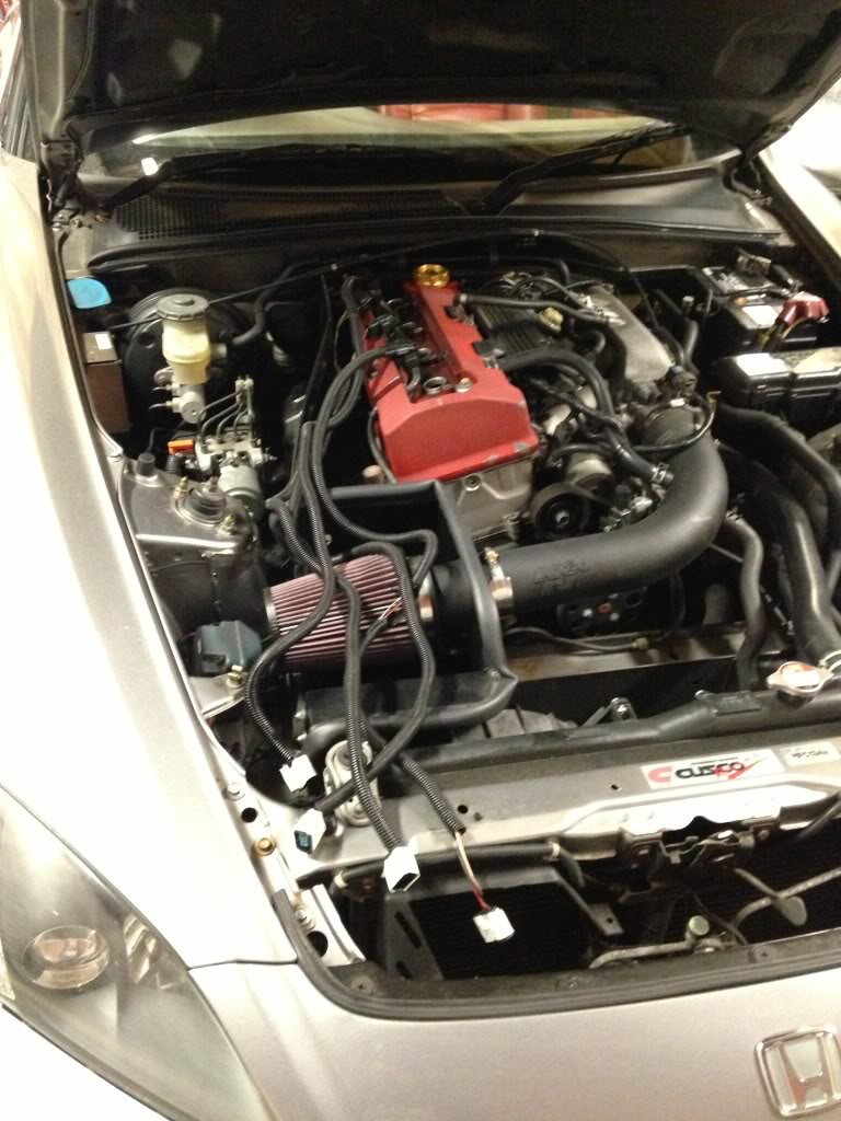

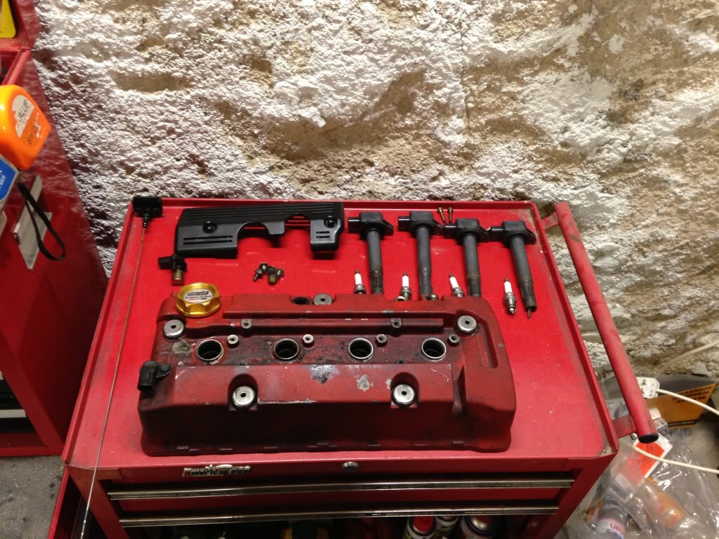

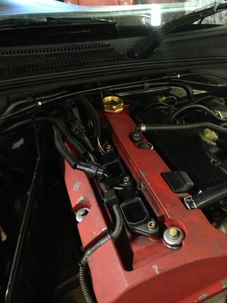

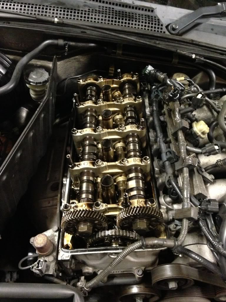

so, after this I started getting a misfire, investigated and found it was number 3 cylinder. Ordered 4 new coil packs and new plugs and got on with fitting them...... That's when I found this lot
the coil pack wiring had been extended by about a metre?!? I have no idea why this would have been done, it's not just a 2 minute job to do? It was all duly ripped out!
Whilst I was at it I cleaned the rocker cover up and set the valve clearances

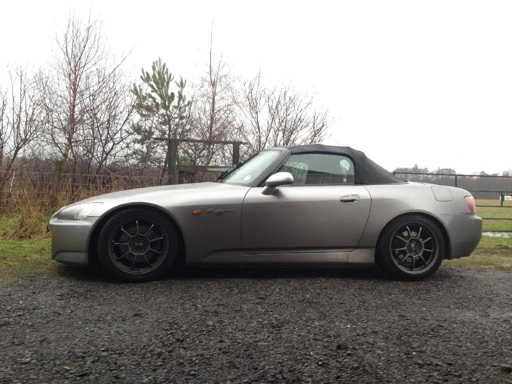

Drove her it like this for a couple of months then Ordered some meister r zeta coilovers. Totally transformed the look!
Before
after

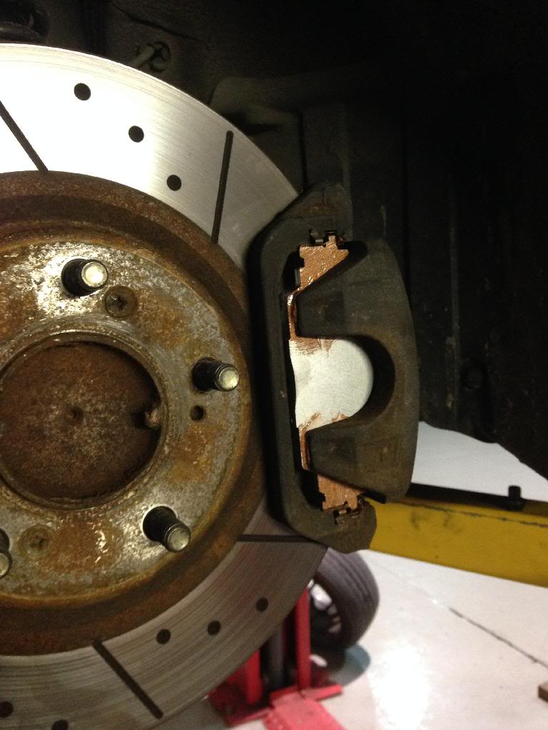

next up was new brakes and tires ready for its first trackday. Went for carbotech xp8's all round with rbf600 fluid and ad08-r's.

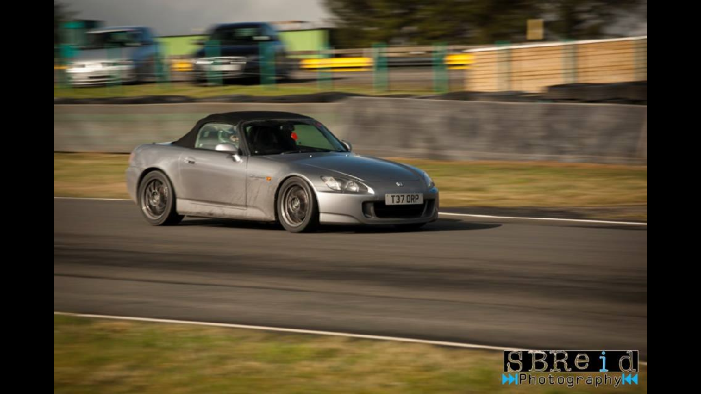

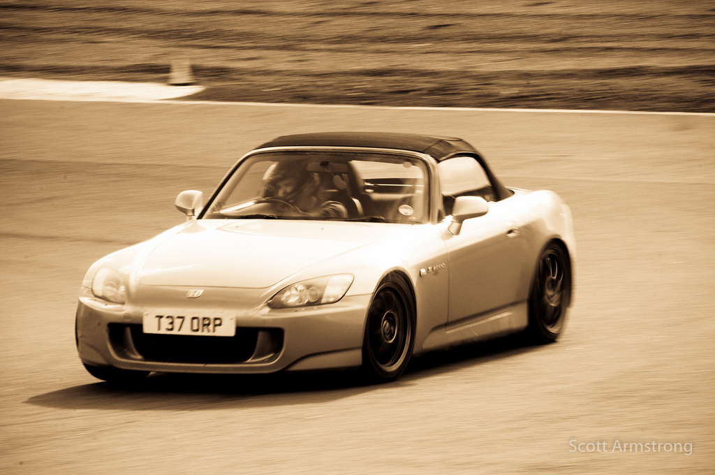

Few pics from the trackday

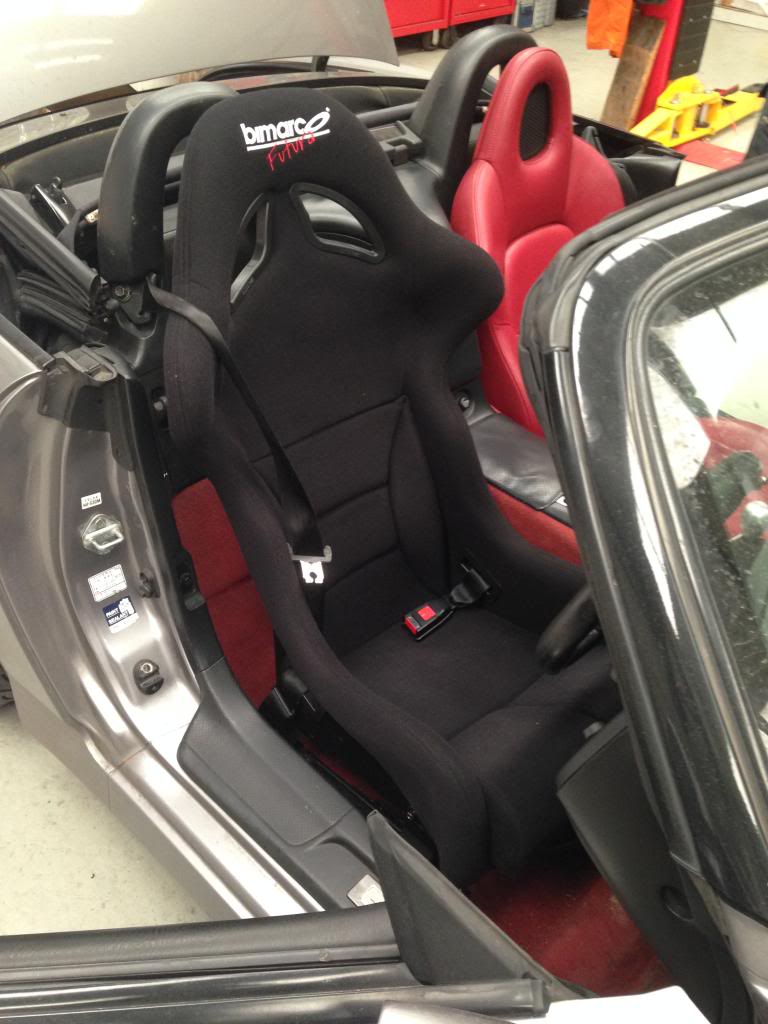

got out my new seat and snap off Bos fitted

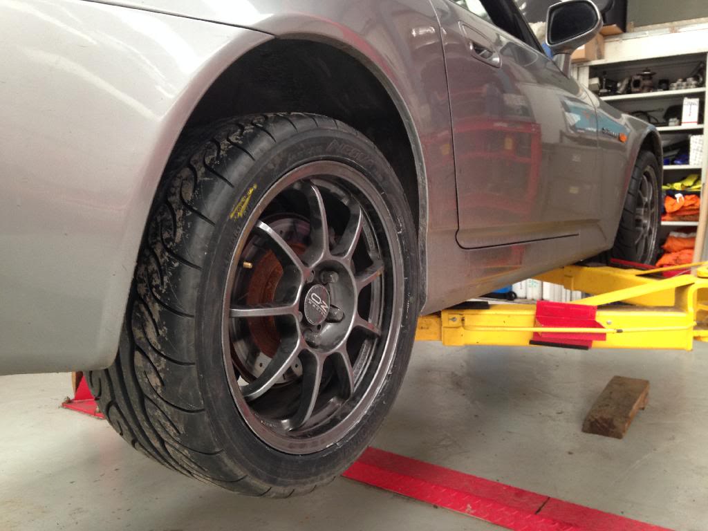

fitted the powerflex arb bushes front and rear, the solid steering rack bushes and a tow strap front and rear ( both hidden as they look stupid on the road!).

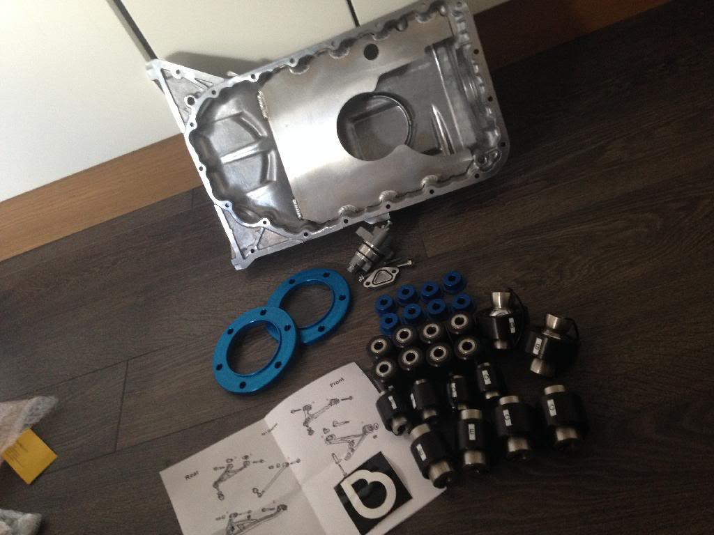

next up is knockhill in reverse next weekend, by which time I should have my new bushes and baffled sump fitted, along with some more aggressive geometry settings! Looking forward to it!
Cheers
Small update,

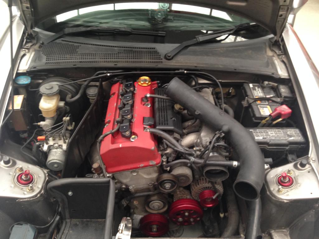

got my bushes all fitted along with the baffled sump. Also fitted the drive shaft spacers and some hard race rear diff mounts.
Done another track night a few weeks ago as well. The car was a lot better than before but I need to play with geo as it was very unpredictable! This is being adjusted before my next track time and I will just keep playing with it until I get it how I like it!
Few are pictures for you as just words are boring!

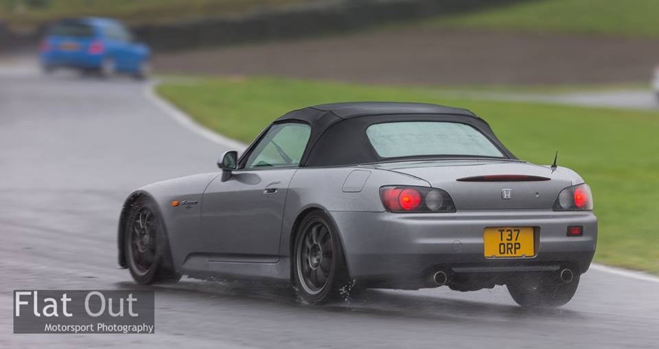

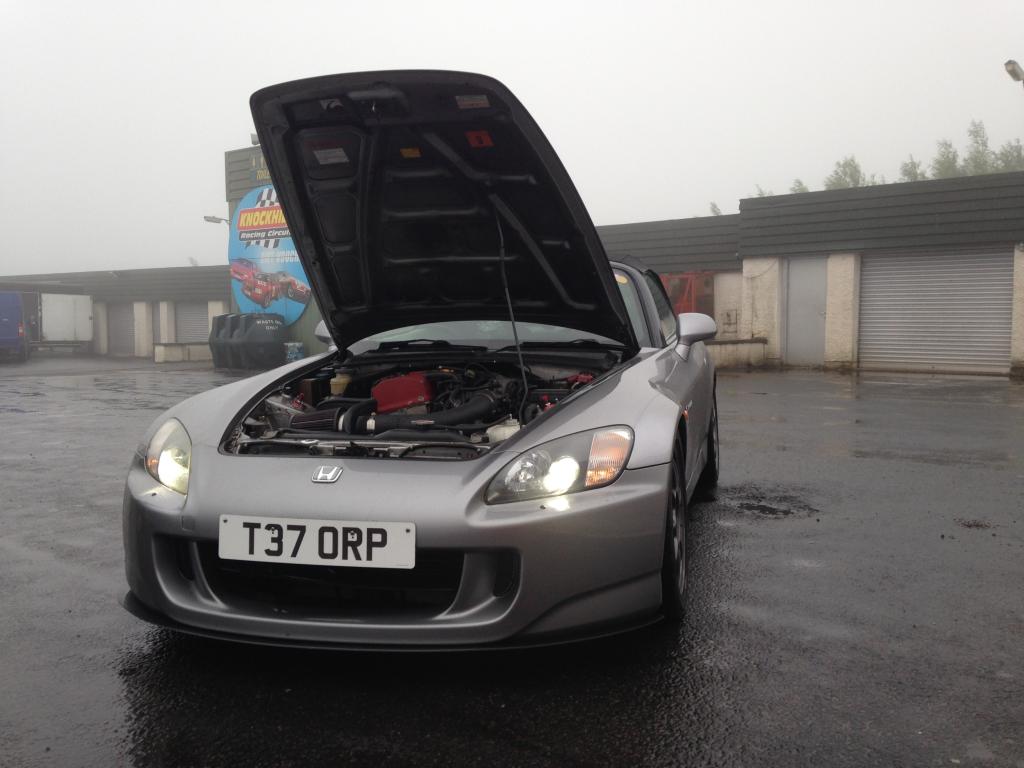

Another track night done and happy to report my geo/handling issues are sorted. Tweaked the settings to how I thought I would like it rather than what I read on the Internet and low and behold it worked... Don't believe everything you read kids! Car was going well in what was terrible conditions! 2 red flags due to fog!

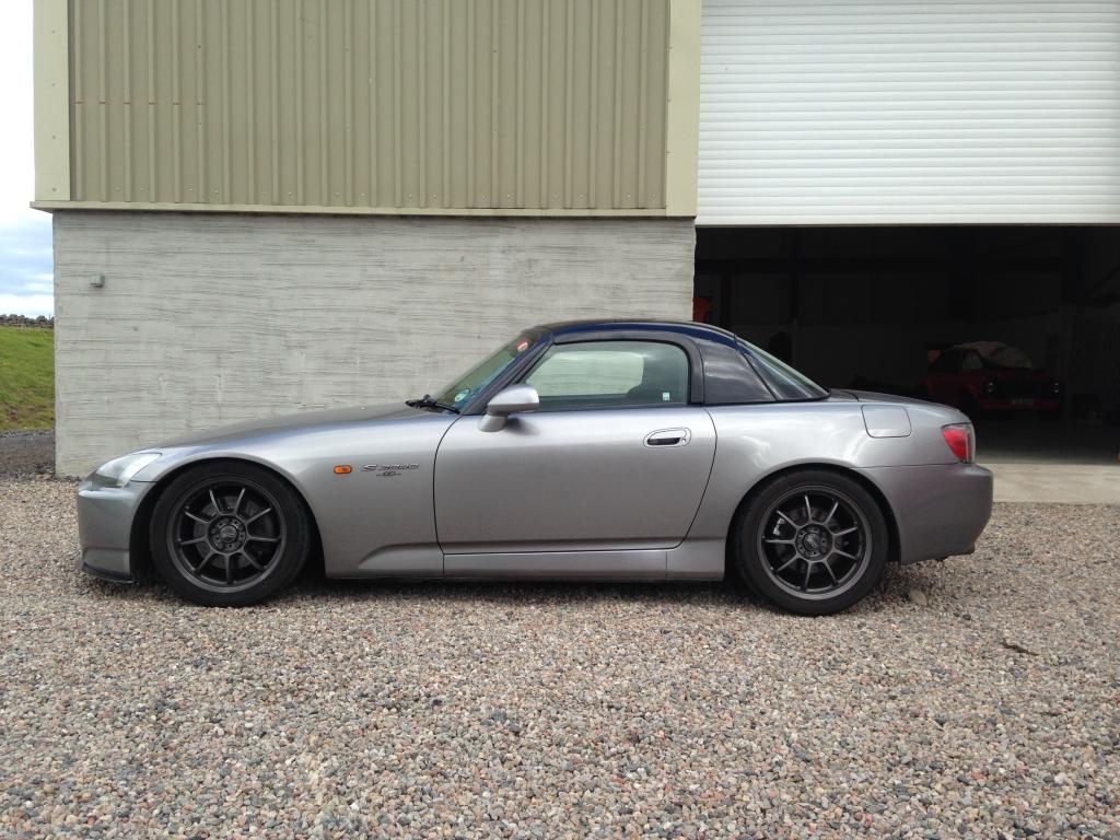

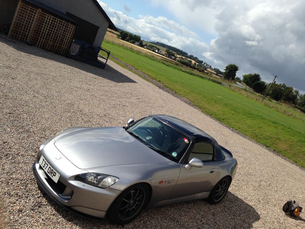

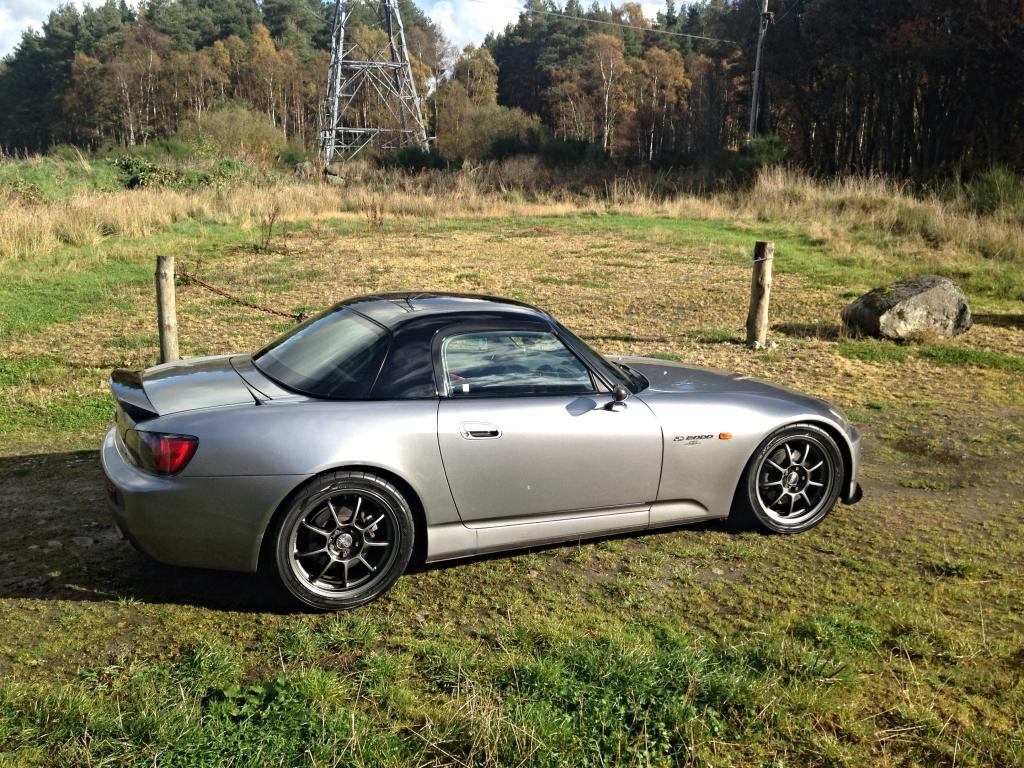

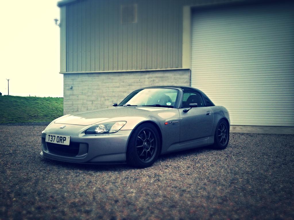

Hardtop fitted

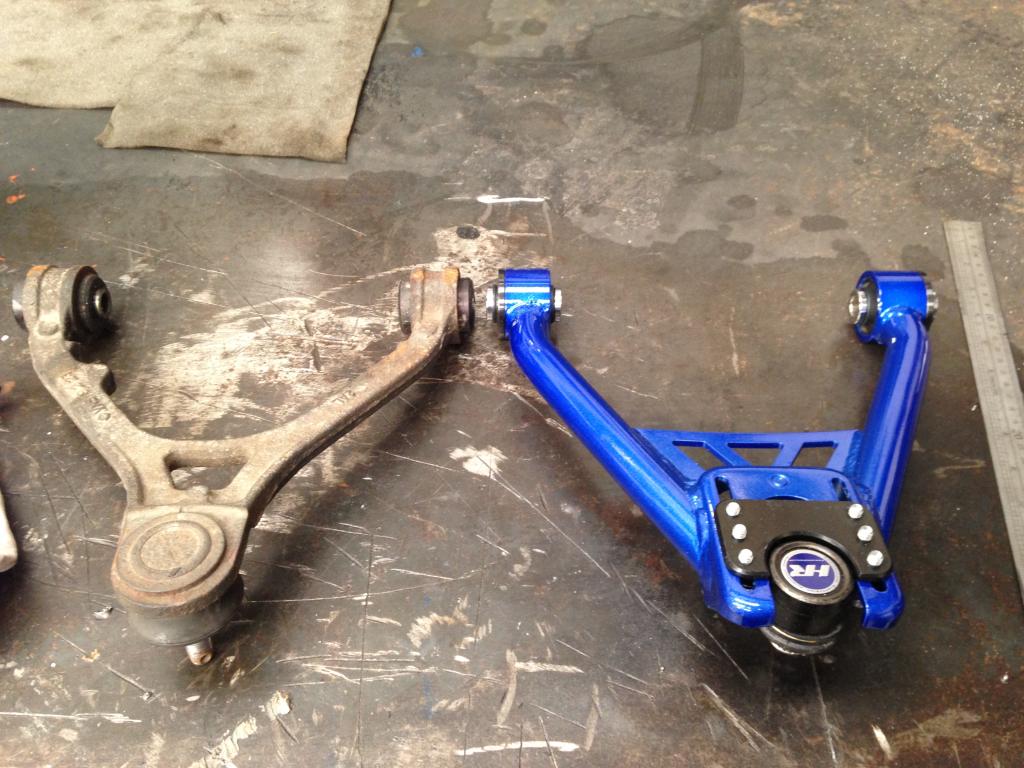

hardrace front upper arms
toda pulleys (aircon deleted as well)

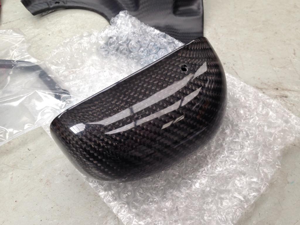

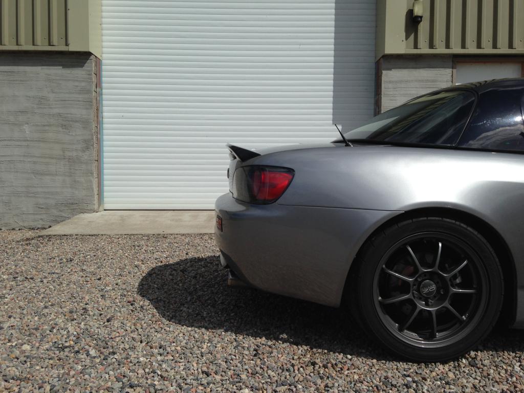

New low level spoiler

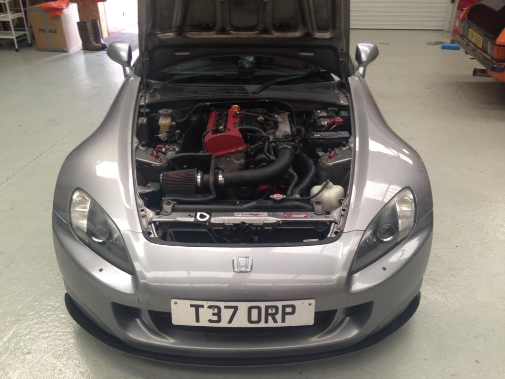

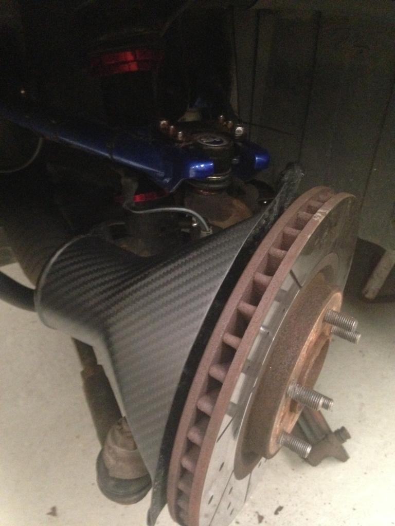

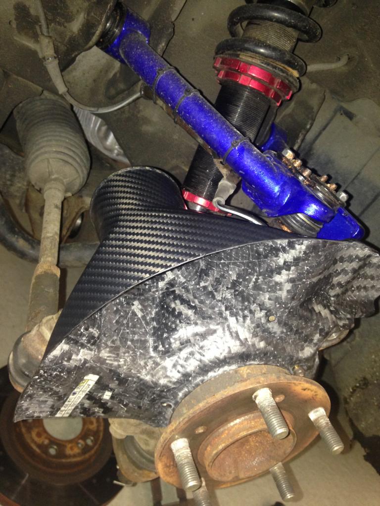

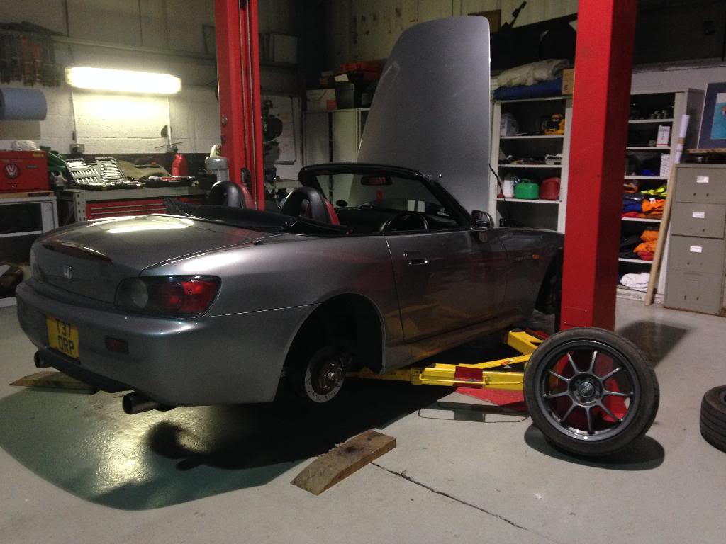

Fitted my rotor ducts, no ducting in yet as I'm still waiting for the front bumper ducts

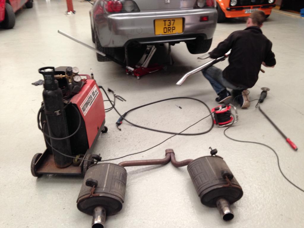

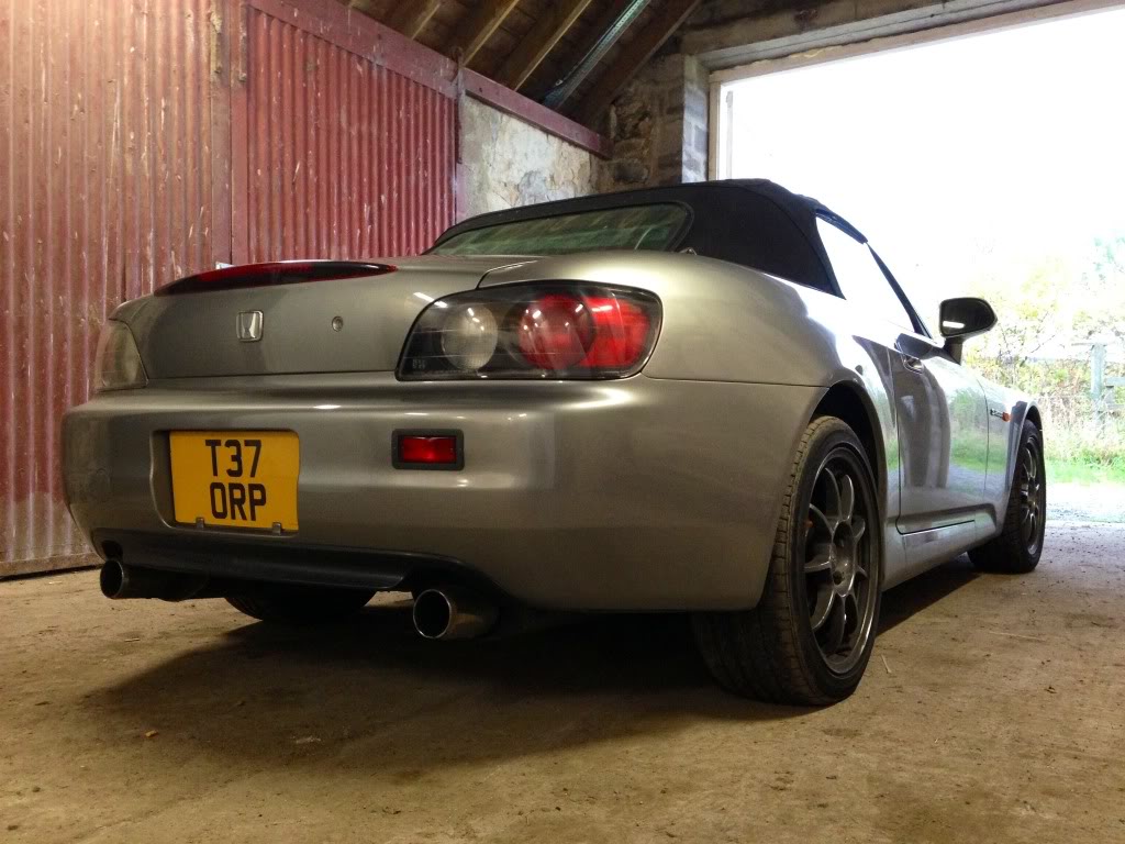

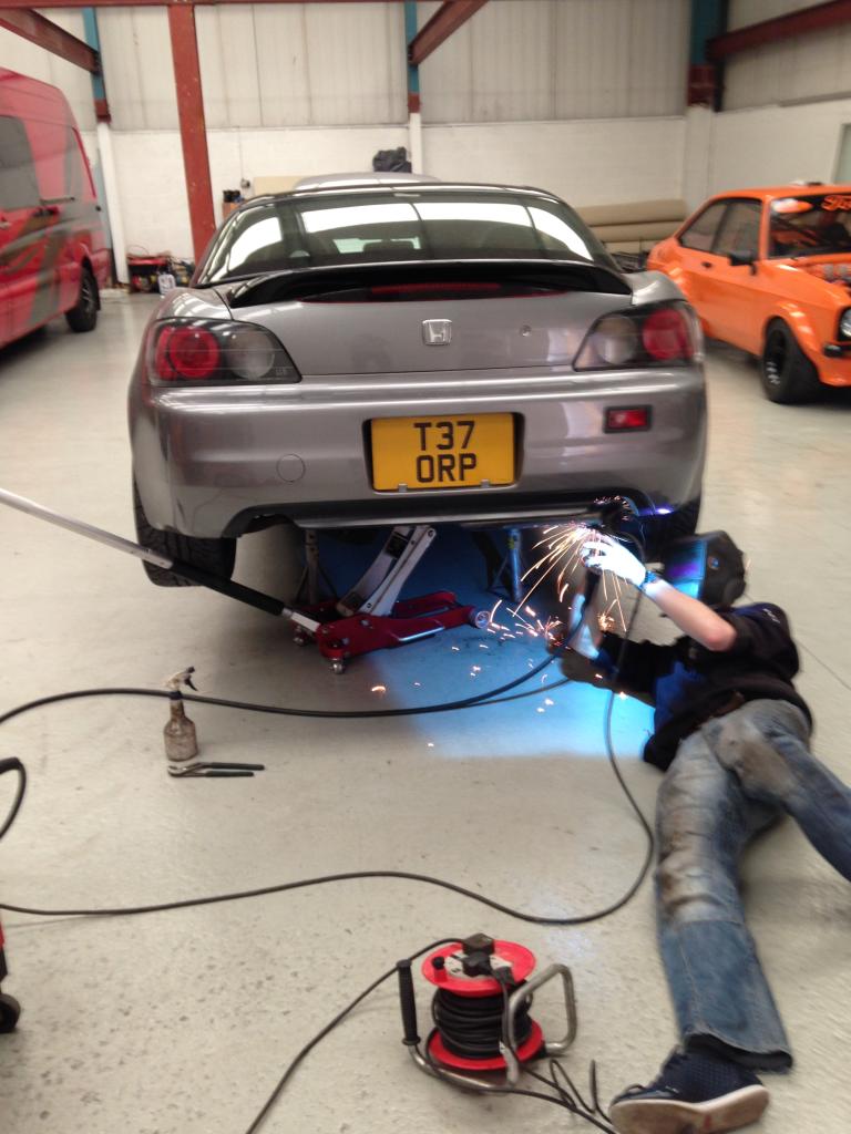

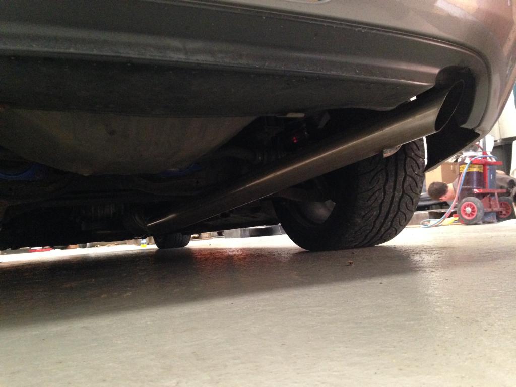

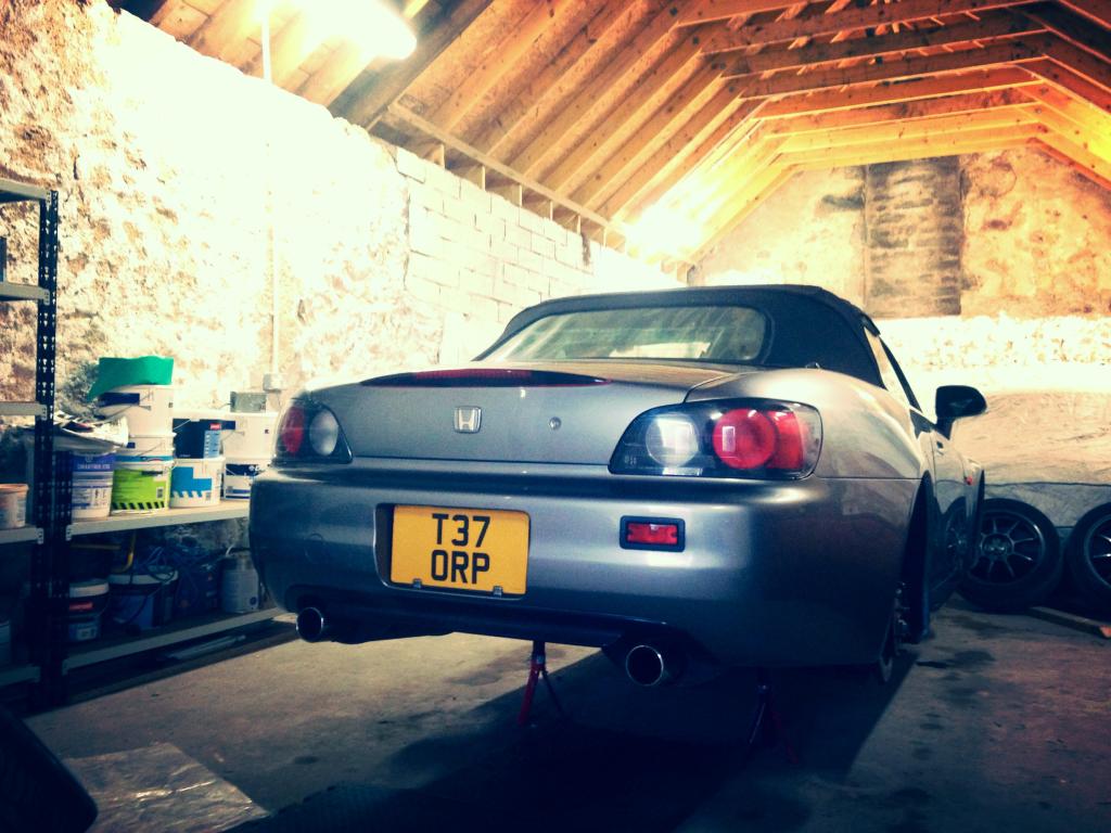

Then decided to make a custom exhaust, seen this done in the states as a lightweight mod, so thought I would give it a bash. One piece of 2 1/2 inch stainless, one 20 degree bend, a bit of fab work and it's done. It's pretty loud on full throttle, but as it retains the standard silencer, resonator and cat it's bearable and pretty quiet when driving normal. Saved around 15kgs of weight and cost £18!
