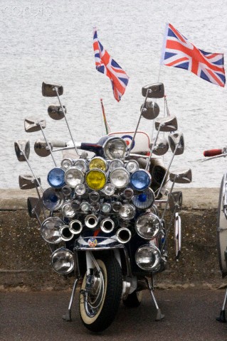

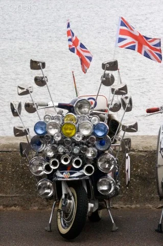

seems a lot of messing,for 2 little extra lights,that wont do much anyway.. just buy a mini cooper s,put loads of lights on the front.. or buy a vespa do the same thing.. if you have to have a lot of lights, take the fog lights out,and place 2 little candles in there.. when you want them on,stop and light them.. or drive holding a torch..
