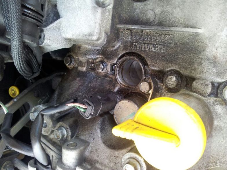

I have found an oil leak when changing my plugs just wondering if its common on the clios in this area and what needs replaced .
that looks like it's mostly coming from the breather cover. Remove it, bin the gasket and seal with silicon. Also you could do with a new seal on the vvt solenoid
