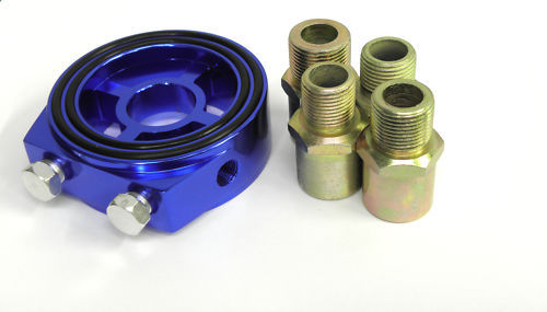

I fitted an oil sandwich plate (r-tech one I think off ebay) with my oil temp/pressure sensors in it
It came with a rubber gasket that fits between the block and the sandwich plate - but when its warm it's leaking quite a bit of oil on my driveway :banghead:

is this one of the anodised blue ones? very common to see that gasket tear when the center bolt is tightened
Arghh just seen there are some that use a double o-ring design
Looks LOADS better - it was an absolute pain trying to get the flat oil seal to stay in the right place while I was tightening it up
Might have to get one of those
Althought saying that - the actual sandwich plate looks the same it just seems to use 2 o-rings instead of the weird flat thing that came with the plate

I've taken the sandwich plate off - it's definitely leaking from the rubber gasket between plate and block
The only thing I could see was that the the nut holding the plate on was not particularly tight - I'm not sure if that's because the rubber seal compressed - or if I undid it slightly while trying to remove the oil filter
But I've done it up "f*cking tight" now - to the point where the rubber gasket is bulging out the sides - hopefully that will solve the problem
