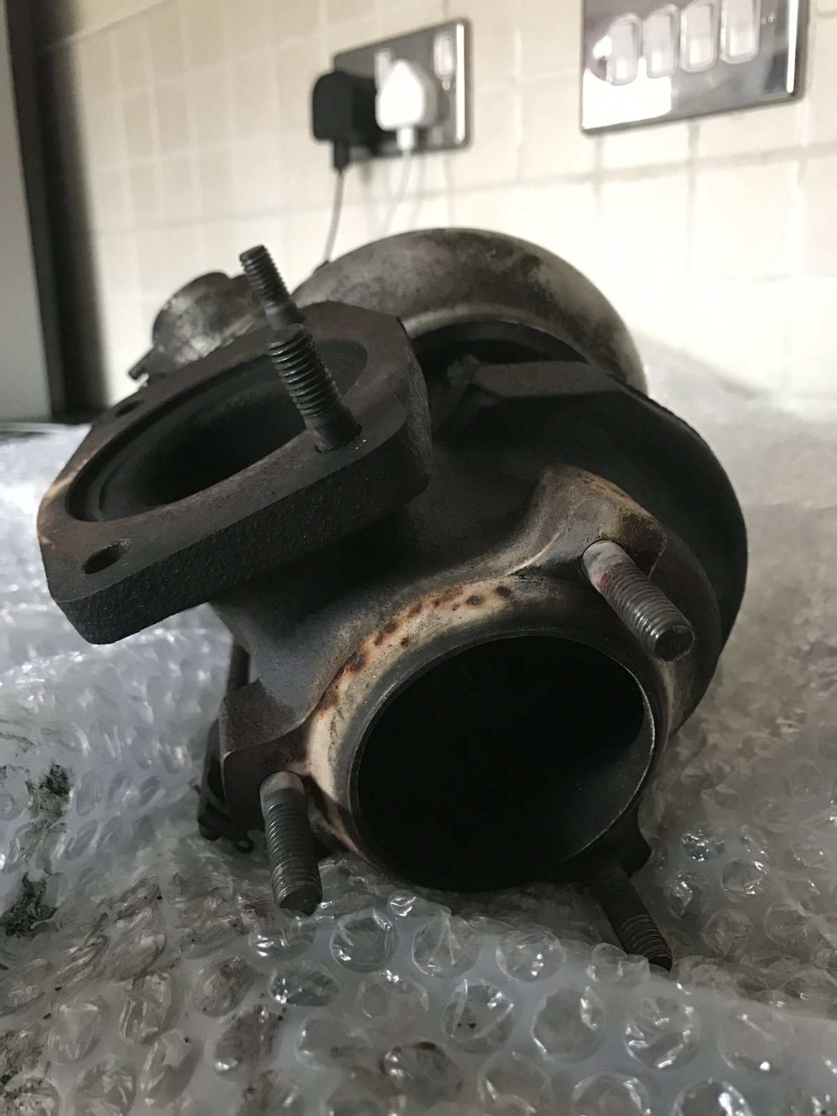

Another day, another 7hrs on the Volvo! This time it was the turbo. I had a 15g from a Volvo 850 and also a 16t from a v70. After taking all three turbos apart (including the stock 13c) we ended up with one which is basically the 16t using the exhaust frOm the 13c.
Unfortunately, something does not feel right with the turbo. There is very little boost under 3k and then the boost builds beyond that. It feels nippy when you Rev the nuts off it but nothing low down. After speaking to some forum people, this is clearly not right so more investigation is needed!

Twas an issue with the actuator and the homemade bracket. When this has been adjusted its boosting like a beauty! Only issue is keeping it in the correct position for monster boost so that's the next task.
