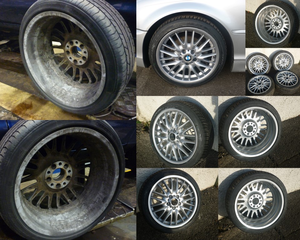

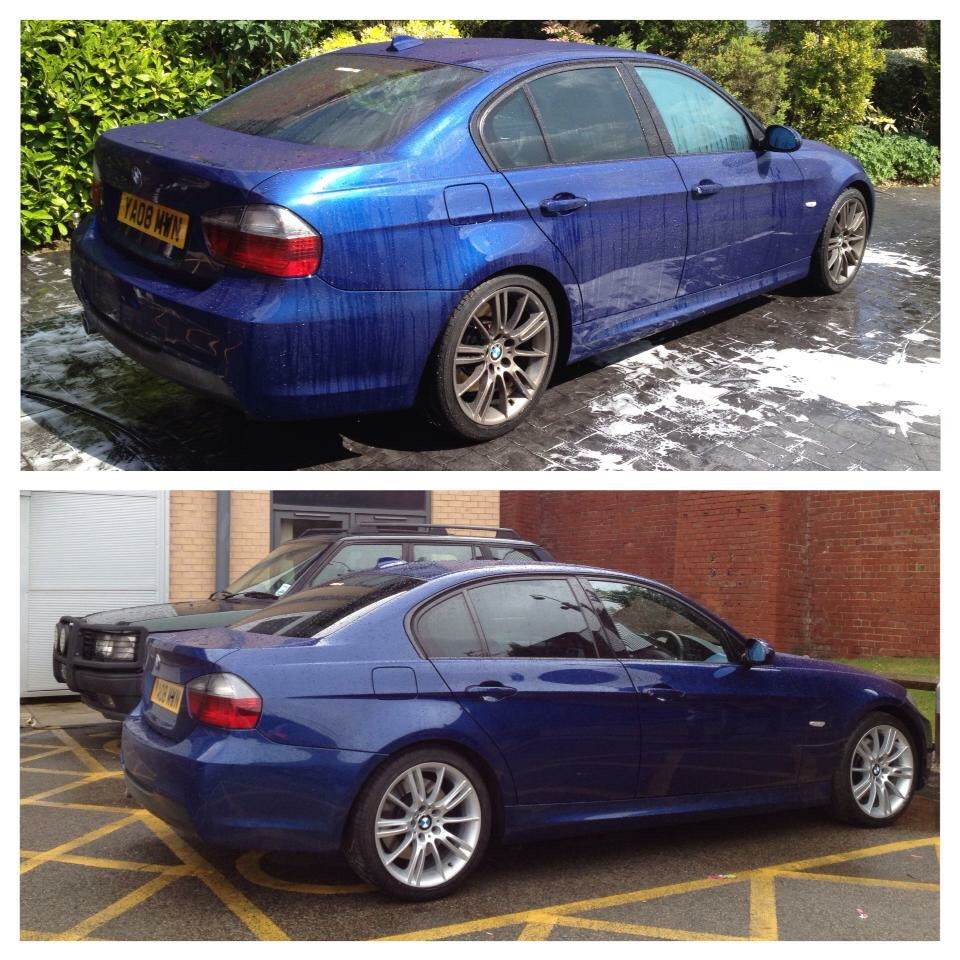

I have finally had my wheels refurbished, I was off work last week so I had them done then & they couriered them back to me. It was easier to just give them the wheels & tyres rather than the car as I wanted to refresh / replace a few bits on it.
I've got the wheels back on now & I went for new bolts & lockers etc, plus I sealed them with DLUX. Lepsons did a fantastic job, I'm really pleased with them. Before & after pics to come later at some point.

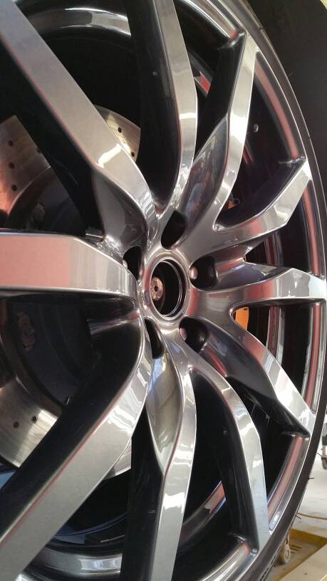

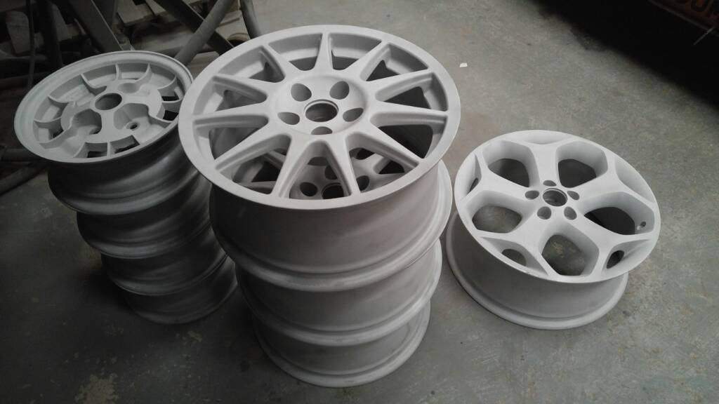

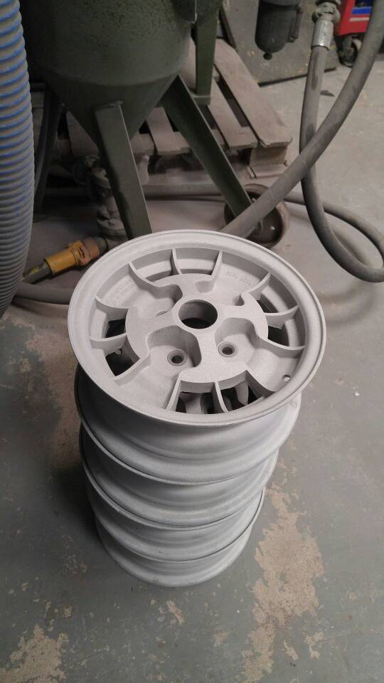

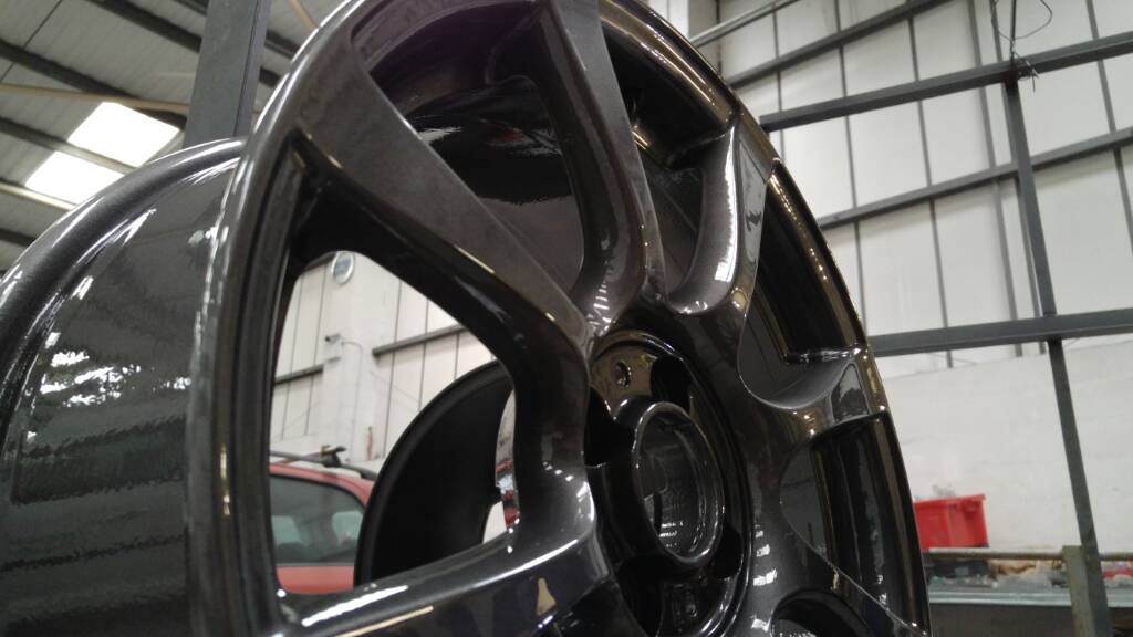

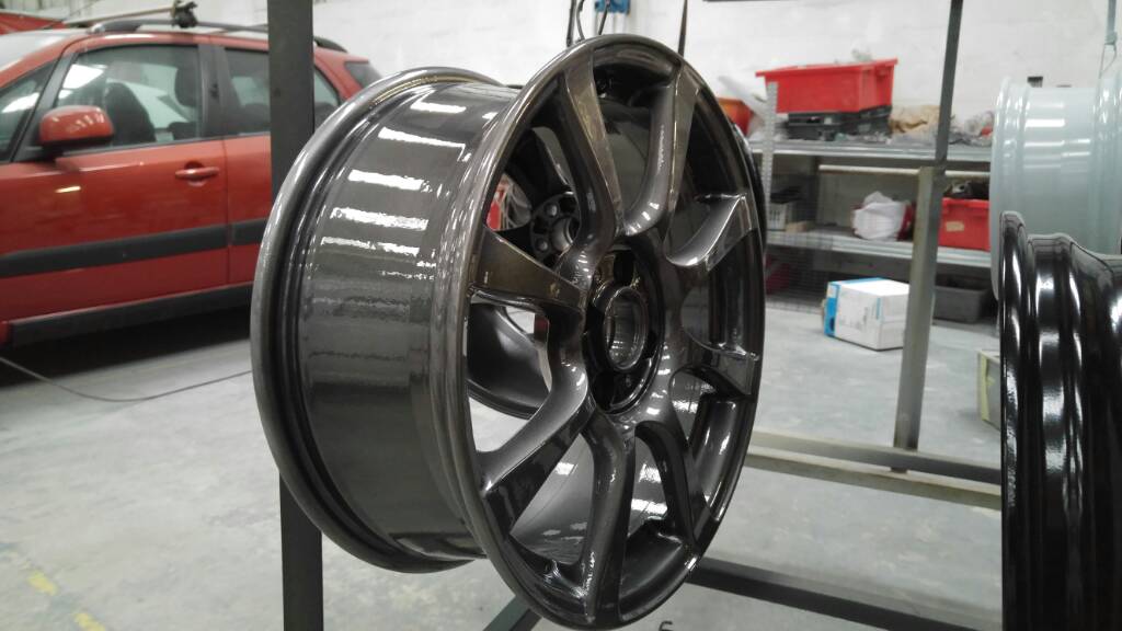

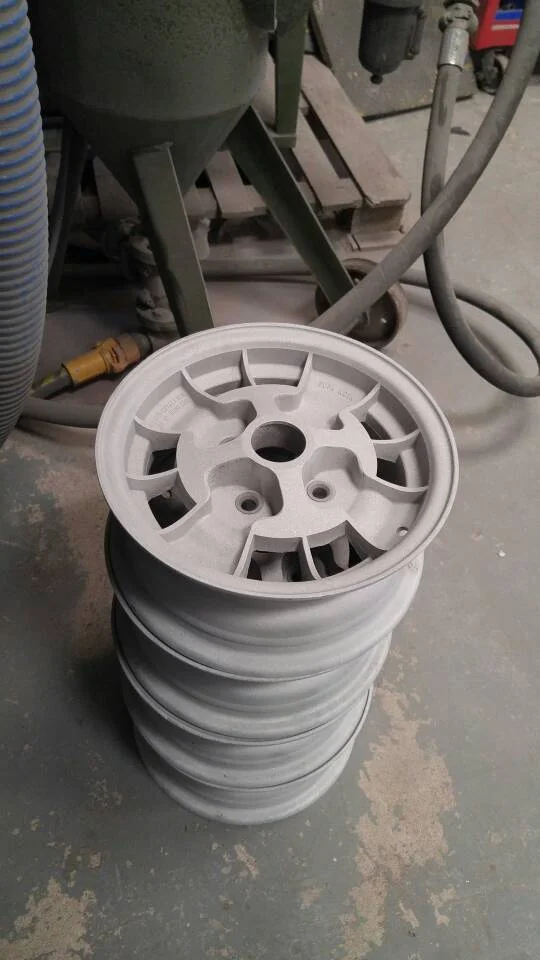

Just blasted a load more wheels today ready for powdercoating this week. Got a few more to do including some GTR wheels.
Just started using a dipping tank here too, can't put the GTR wheels in that though lol.

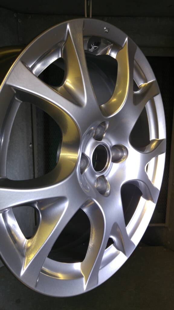

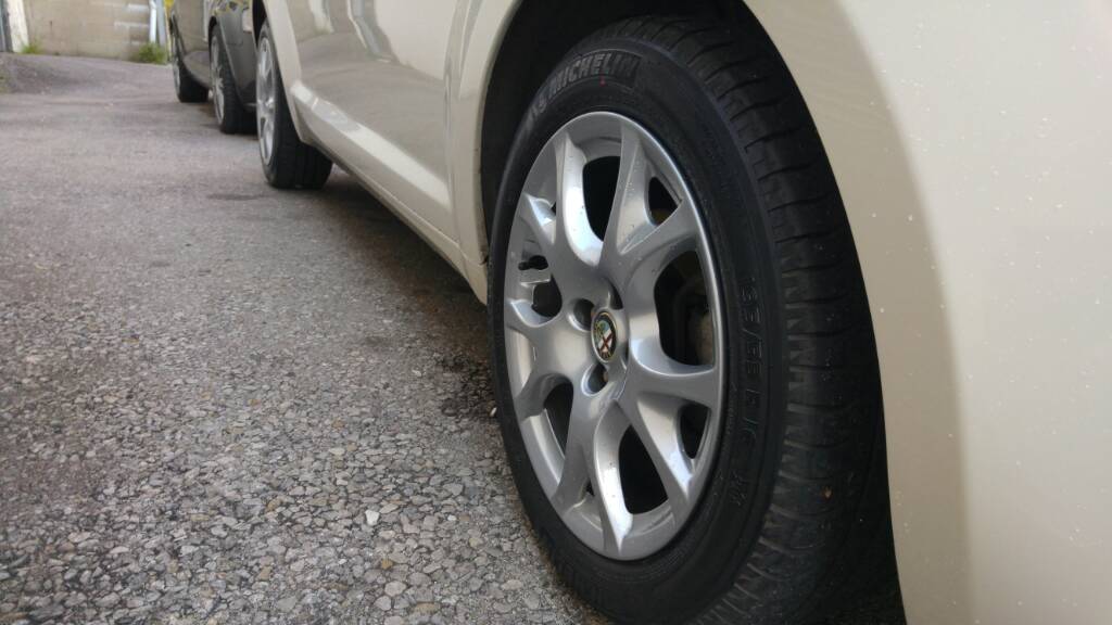

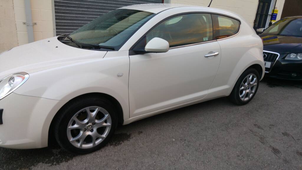

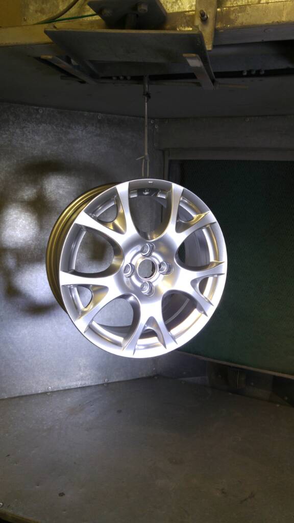

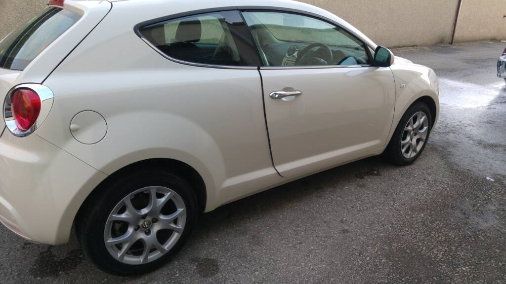

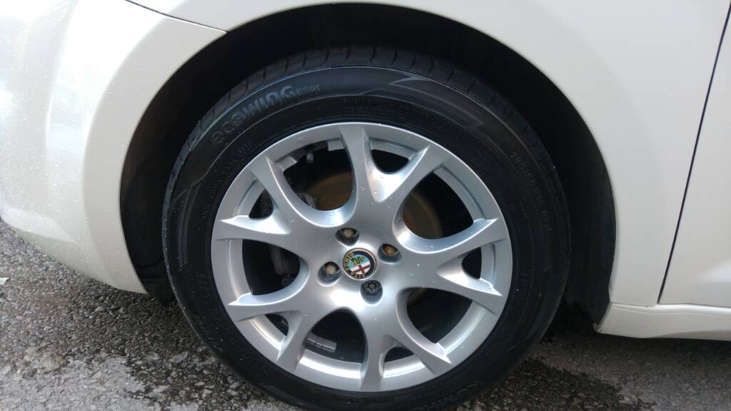

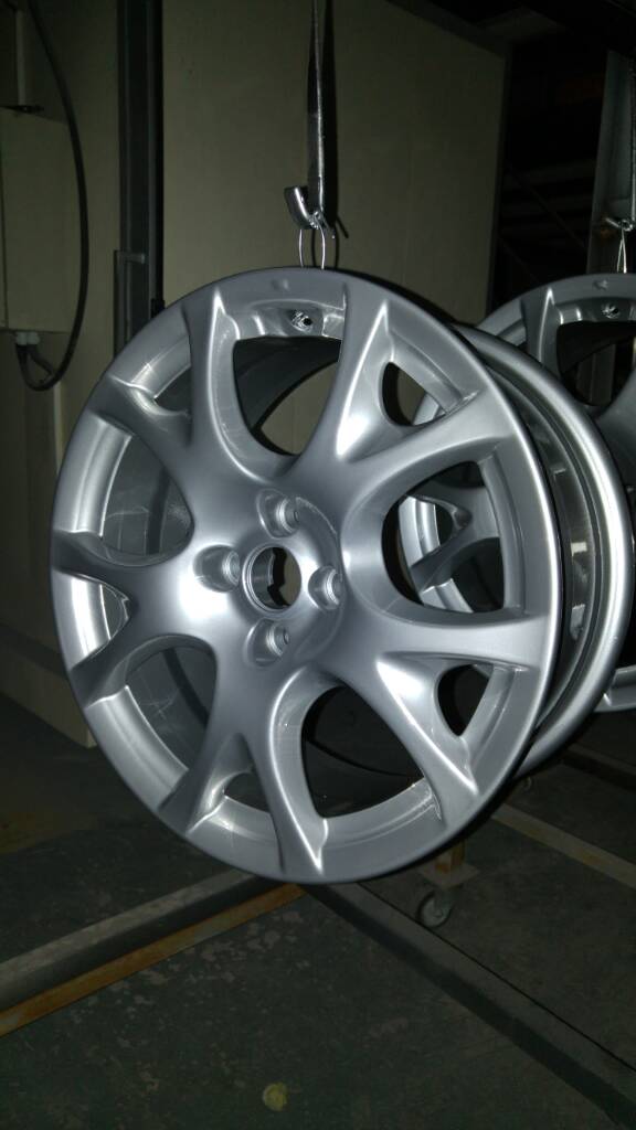

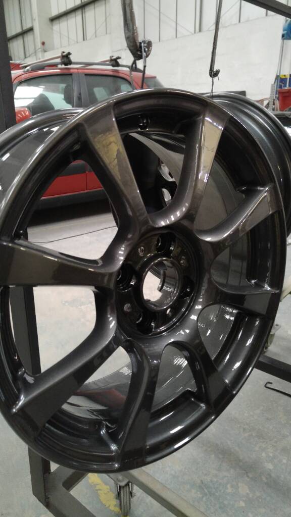

Some Abarth 16" alloys done the other day in our new grey we got in.
Some Alfa Mito wheels done in Chrome silver.
  Turbo 182 Alfa 159
They look great, if you weren't so far away I'd have come to see you.
Cheers mate! Getting the hang of it now I've been shown the ins and outs of it all. Just doing it to help a friend out with a huge bodyshop who doesn't have time to sort the powdercoating side of things out.

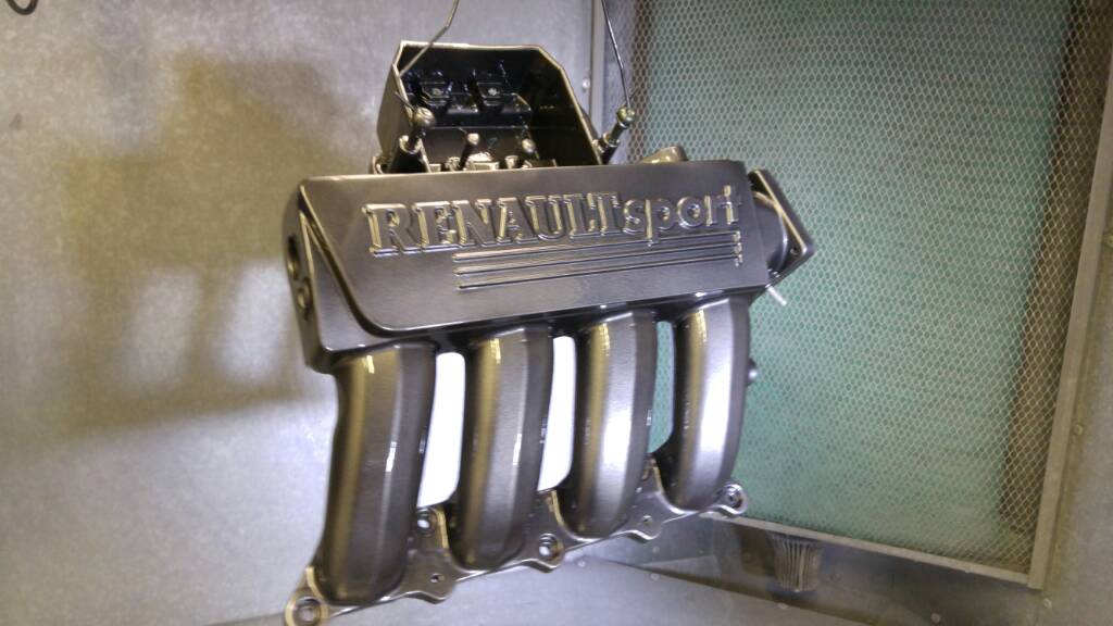

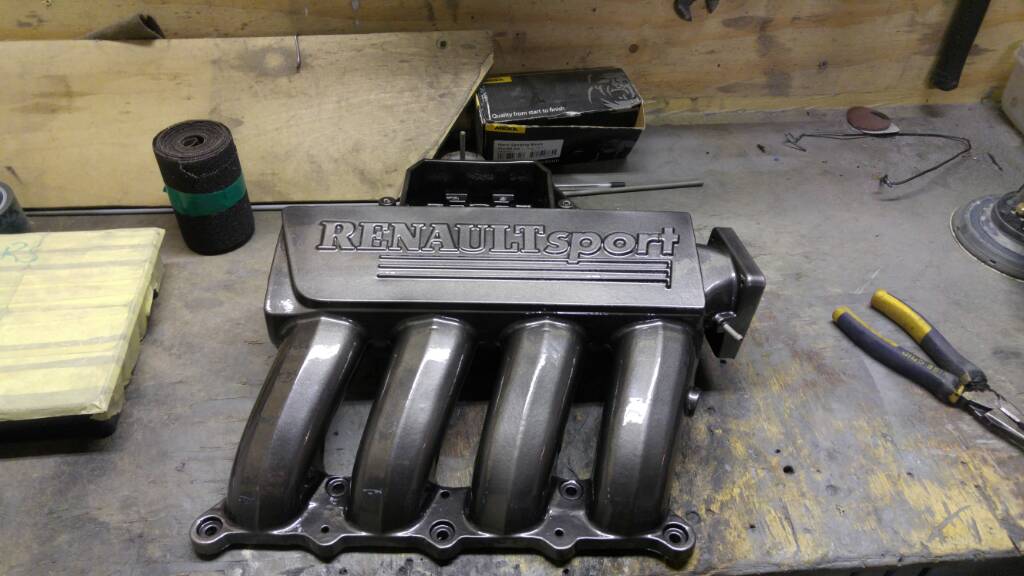

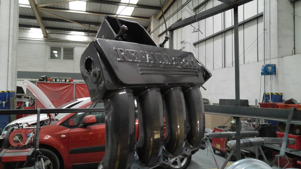

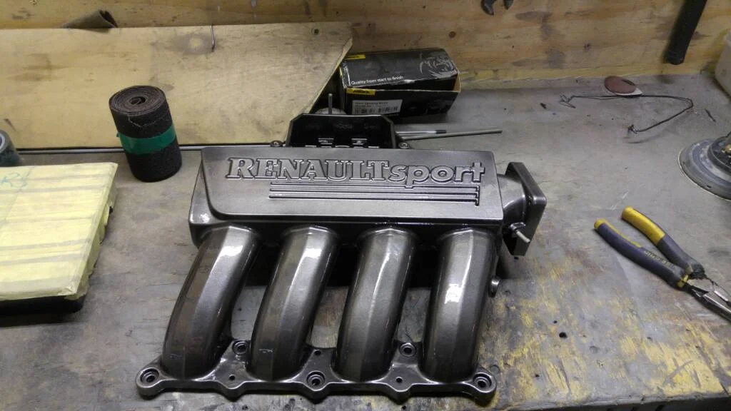

Just done my Renault inlet for the boost bus [emoji12]
In the nicest possible way, Lal B3n, that's the reason I don't want powder coated wheels. This will make me come across as a dick (Craig, before you chirp up and make the joke, "it's because I am a dick") but the orange peel on those is just not the look I want on my wheels. Darker colours show I more, I appreciate, but mine are wet sprayed and the lacquer is mirror finish, not "bobbly" like those.
Engine parts, ideal.
  A special one.
I here where your coming from bud, but those engine parts are cast alloy. Not a smooth finish to start with.

Can you talk us through the process please?
Sure, the general processes depending on colours etc has been,
In the blaster until they are perfectly clear of all old paint/powder.
Then in the oven at 200 for at least 30 minutes. Pull them out and primer powder them and then back in oven for around 20 minutes and then back out check they are all ok finish wise and no air bubbles showing etc.
If they're ok then they are given a coat of their chosen colour all over then back in the oven for another 20 minutes or so.
And depending on the colour they're then pulled out and lacquered and back in the oven to bake for another 30 minutes and then checked over. If they're ok then they're left out over night to cool down.
No idea if thats the right or wrong technique to be using but seems to be working so far.
Im sure other people do it other ways.

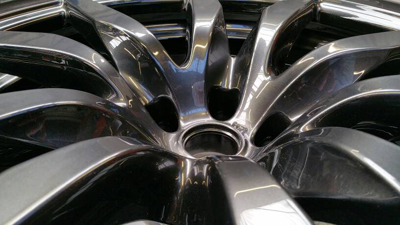

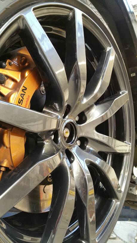

Just wanted to post another bit of praise for them.
Even when the wheels arrived they called. I spoke to them several times on the phone about these wheels which for a Gtr were in shocking condition and they carried out a number of things free of charge.
Some images of the set returned to us...
They are utterly flawless after checking them over. Better than the factory gtr wheel we currently have.
